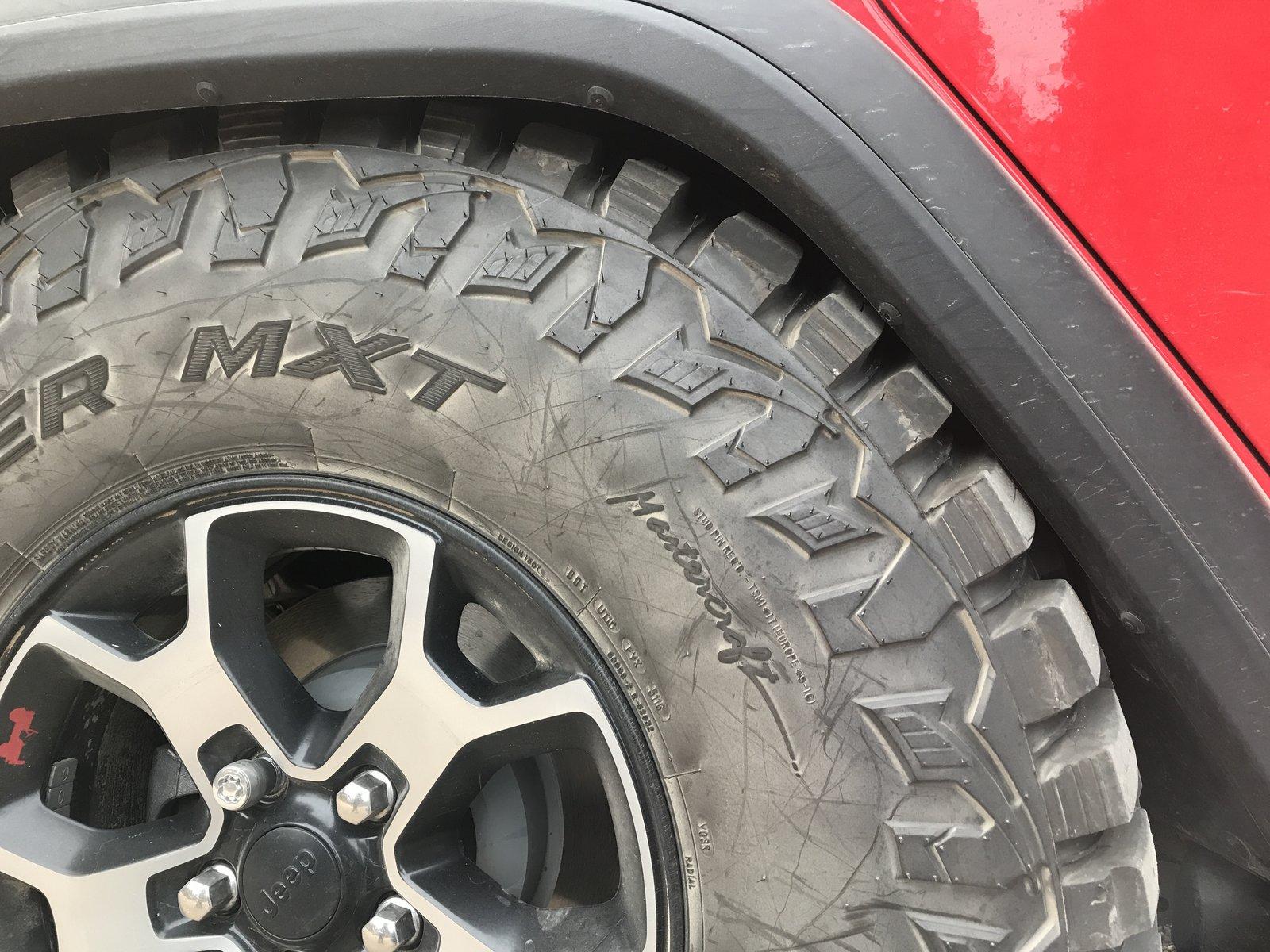

Before any comments on how "Spacers are Bad" start coming, I'll say this is just a temporary solution until the current tire set sees their end of life and I consider new Wheels along with 35s (and a regear lol)...
I'm looking at the https://www.quadratec.com/p/spidertrax/1-34-wheel-spacer-jeep-grand-cherokee-wrangler-jl Spacers as a solution to some very light rubbing at full turn (both ways) on my Anti-Rock Sway Bars.
Just wondering if anyone else out there is running this spacer, etc.
Note: Current setup is a Mopar 2Inch Lift, w/33 Rubi Takeoffs & Anti-Rock Sway Bar on a JLUS

I’m surprised you have rubbing with 33’s and a Mopar lift? I have a RC 2.5” spacer lift with 37x12.5s, on a Rubicon. The front doesn’t rub at all and the rear just kisses the edge of the fender when fully flexed (stock shocks with extensions).
Bora 1.5” spacers.
