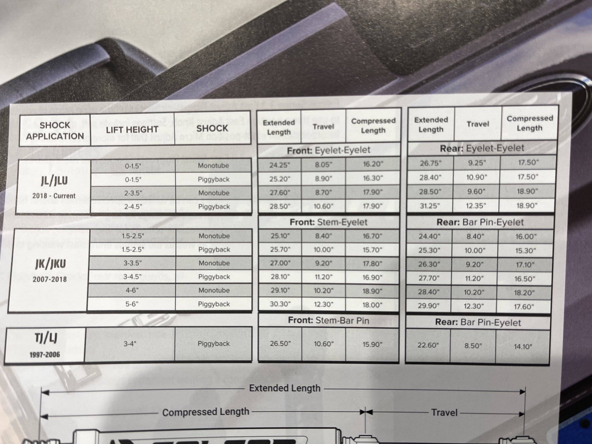

Falcon shock specs Collapsed/Extended lengths?
