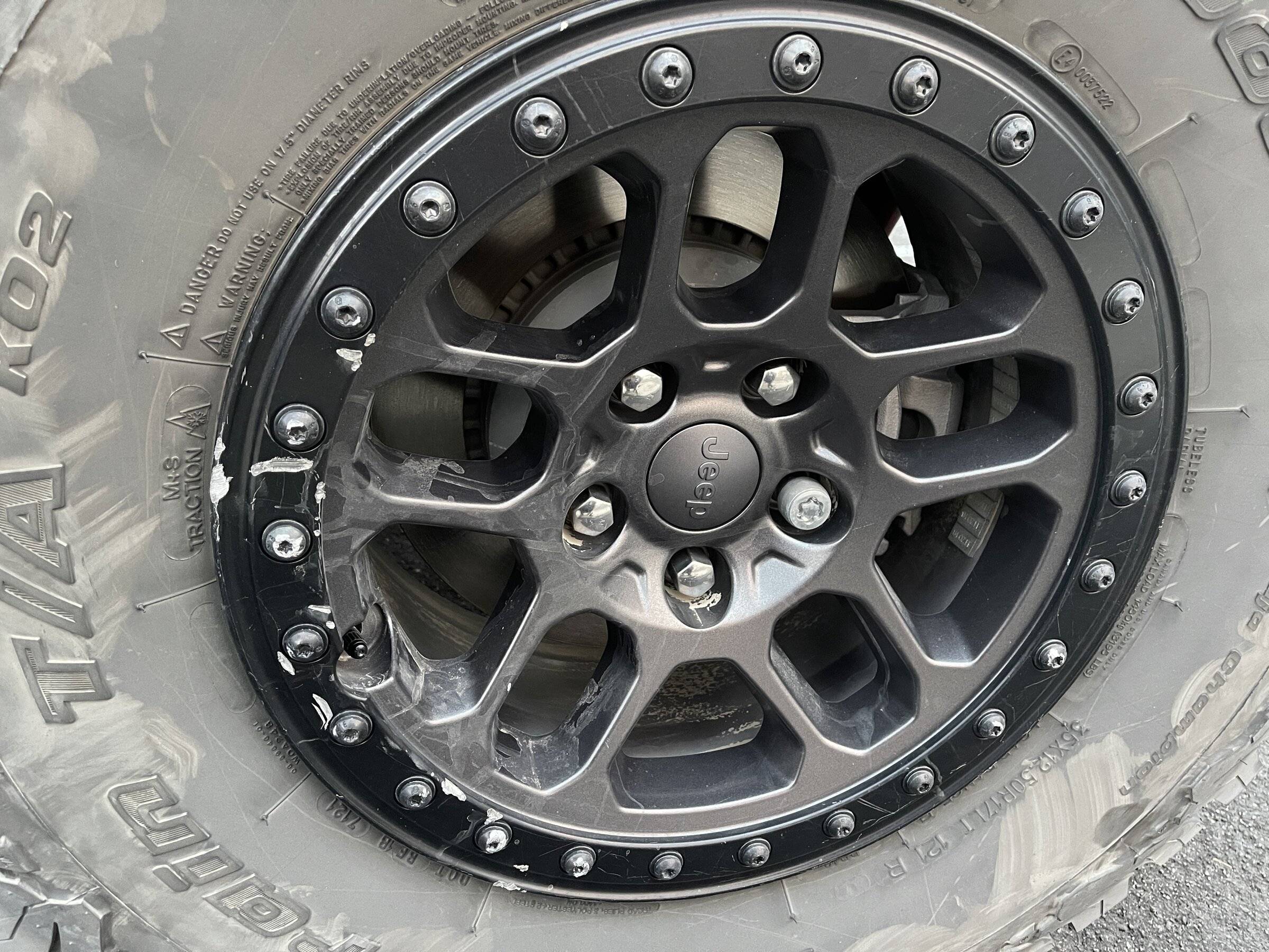

Oh boy. Are they safe for the road?If you want to beadlock the tires you need to buy the beadlock rings separately (they come with rim protection rings) and youâll have to do it yourself because tire shops wonât do it for you (not street legal)

Iâve never used beadlock wheels and I donât plan on using these as beadlock wheels either. They look great and the rings protect the rims from scratches but the bolts that hold the rings strip easily and most folks have had issues using these as bead locks. Iâve never felt the need to actually get beadlockedOh boy. Are they safe for the road?

Mopar beadlock rings. Theyârea DIY project, as theyâre not technically DOT legal. I donât suggest this for your use, but itâs a nice feature if youâre trying to squeak every bit out of your rigHow do you beadlock them? They come from the factory not beadlocked?
Guess a tire shop needs to do it?
