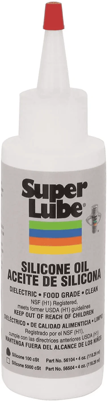

I used a bit of silicone low viscocity lube on the outside of the OEM pipe and the inside of the axle-back, slipped on pretty easy after doing that. If your axle back is pretty heavy you might need a helper. Mine is the Magnaflow Street Series dual FWIW. Might also help to get a 3m pad and clean up the OEM pipe if it's got some soot buildup.
Like this??

Should be fine
