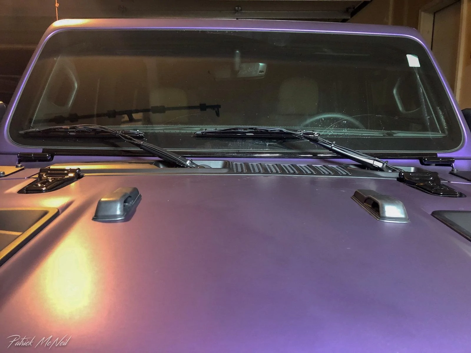

It has been awhile since our last post. There are so many things in the coming weeks and months. But, Football season has put a bit of a damper on mods.
With that being said, today we added heated wiper blades. These are manufactured by a company called Everblades. With winter upon us, we needed to do something to help with the ice and snow that we get here in Minnesota.

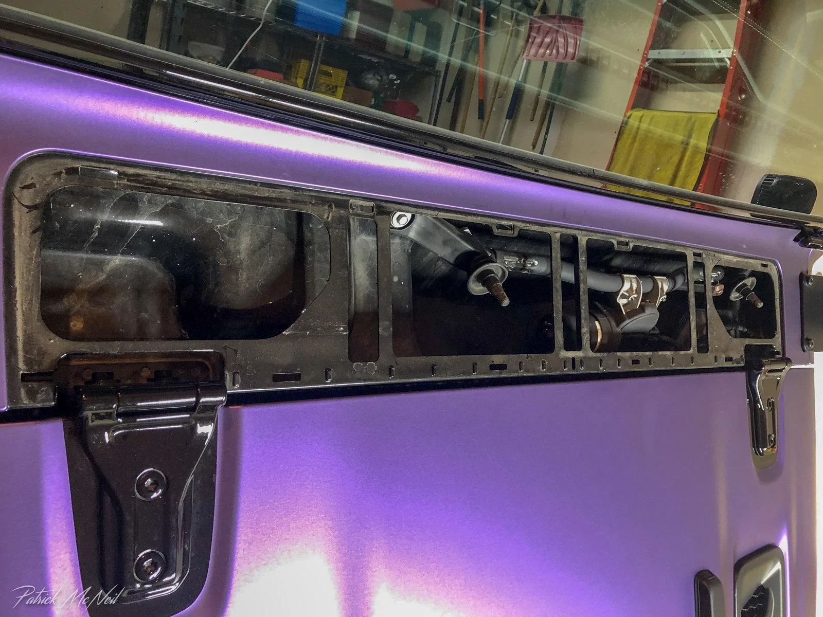

The install was very easy and took about an hour. We removed the wiper arms from the Jeep. We then used a pry tool and removed the black plastic wiper tray. That came off very easy.

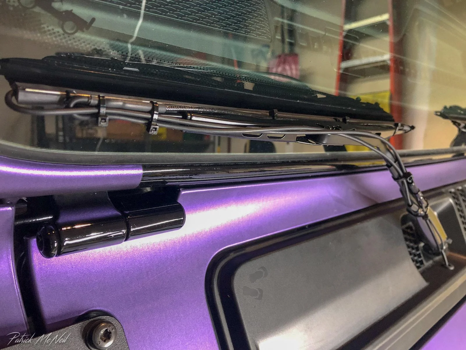

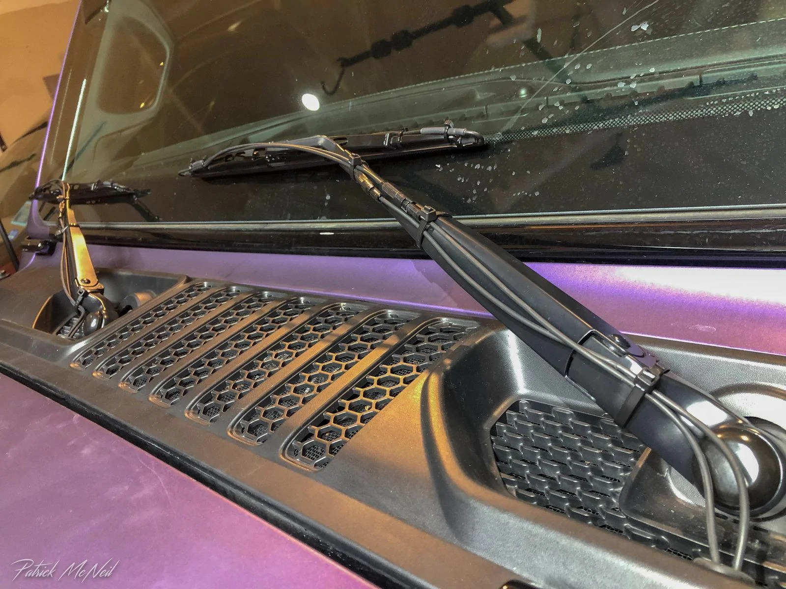

We ran the wires through opening into the engine compartment and determined the correct length that we would need to facilitate the new blades. We used zip-ties to secure the wires.

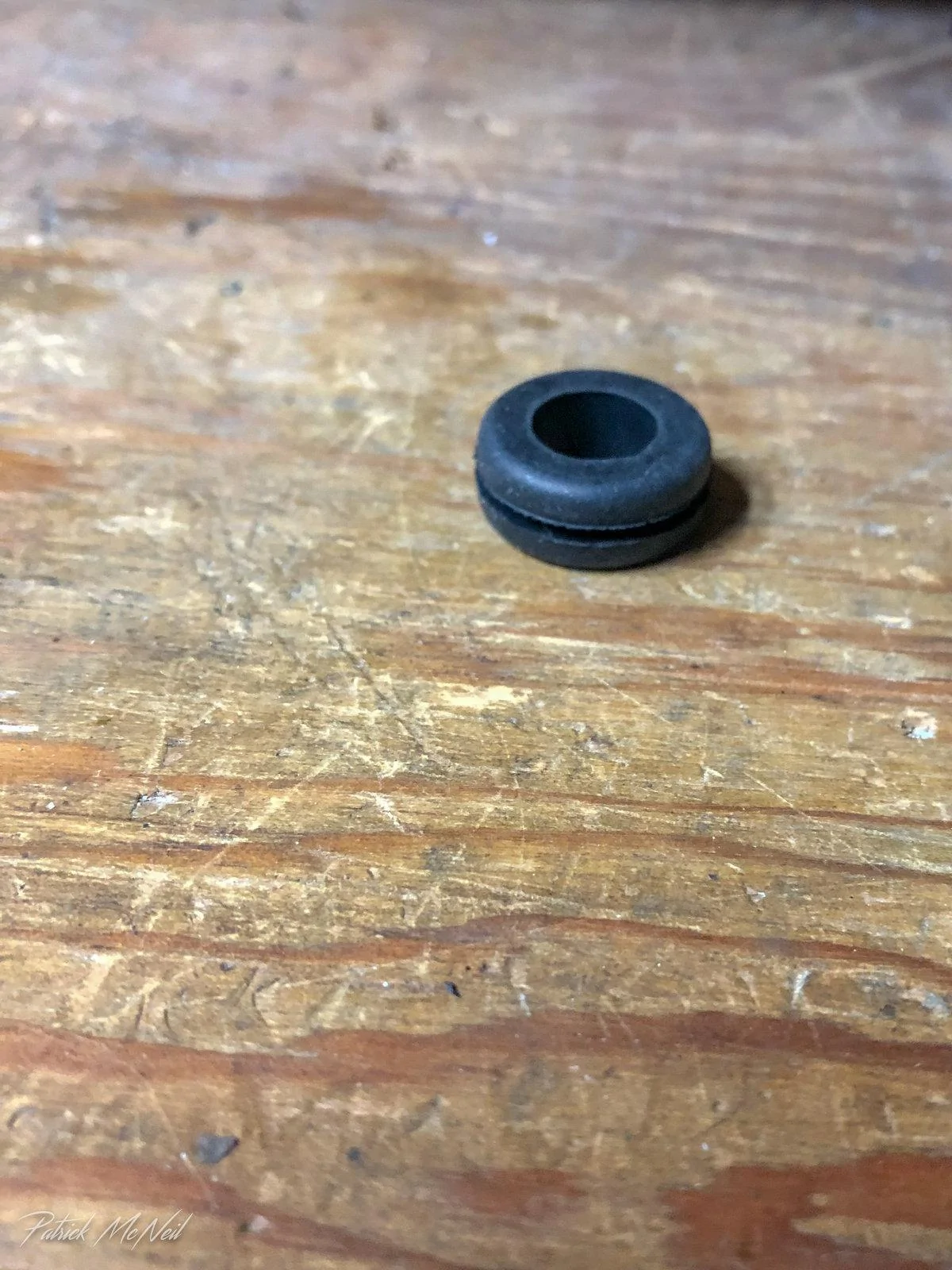

Next we used a 1/2" drill bit and made holes in the wiper tray. After inserting 3/8" black rubber grommets, we fed the wires through the grommets and replaced the wiper tray.
Next we grounded both of the ground wires and connected the "positive" lead to the orange "AUX" wire. This wire is controlled by AUX switch #3.
We programmed the switch to "Ignition" and turned them on for the first time! Everything worked wonderfully! Once we get some new snow and ice, we will post more photos!
