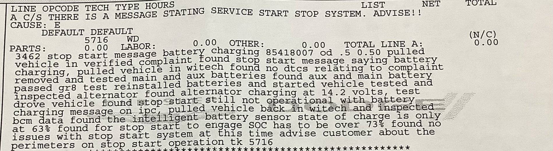

I was getting the start stop battery charging messages I took my Wrangler in for service yesterday. I don’t drive my Jeep daily and have driven less than normal the year. According to the tech both batteries checked out OK. The message seems to be generated by the intelligent battery sensor state of charge. Dealer charged both batteries and I ordered a battery tender for future use. I need to drive the Jeep to reset the message.
Do you guys think I’m good to go?
Comments? Thanks.
Comments? Thanks.
It is possible. Just so you know I had a similar issue. System will always be charging, work after long drives, then itll break again. Twice I took it to the dealer and they said "it is fine". Well it eventually crapped out. I had to jump the car and I got the "service ESS light". Took the Jeep to the dealer and aux battery was dead, needed to be replaced and apparently something was draining it and it wouldnt charge properly. I asked the. to replace both batteries, but FCA told them to just replace the aux battery. So I know this is gonna fail again.
I dont know what to say. They might be telling you the truth, but you cant trust then. FCA dealers lie. They lie a lot.
