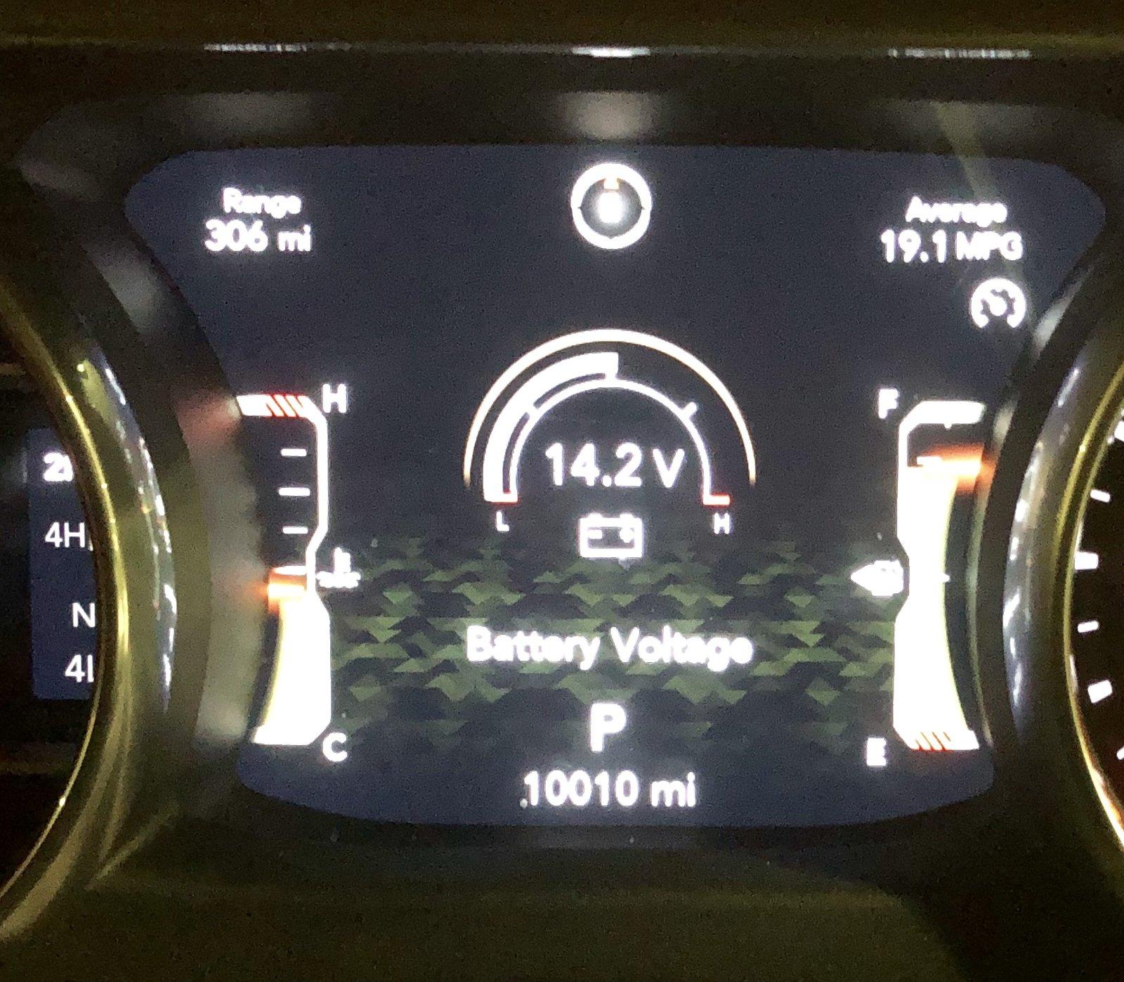

Well I am thinking I need to take my Jeep in for a battery issue, I have made a few posts about my battery voltage reading high all the time but several said you can’t go by the reading on the EVIC and the battery system have a IBS ( Itelligent battery sensor) that senses when the battery needs charging and then allows the alternator to charge accordingly, well when I first got my Jeep the voltage use to jump up and down and I found out that this is normal but now it’s a steady 14.1-14.3 all the time but always has started and it’s been this way for months

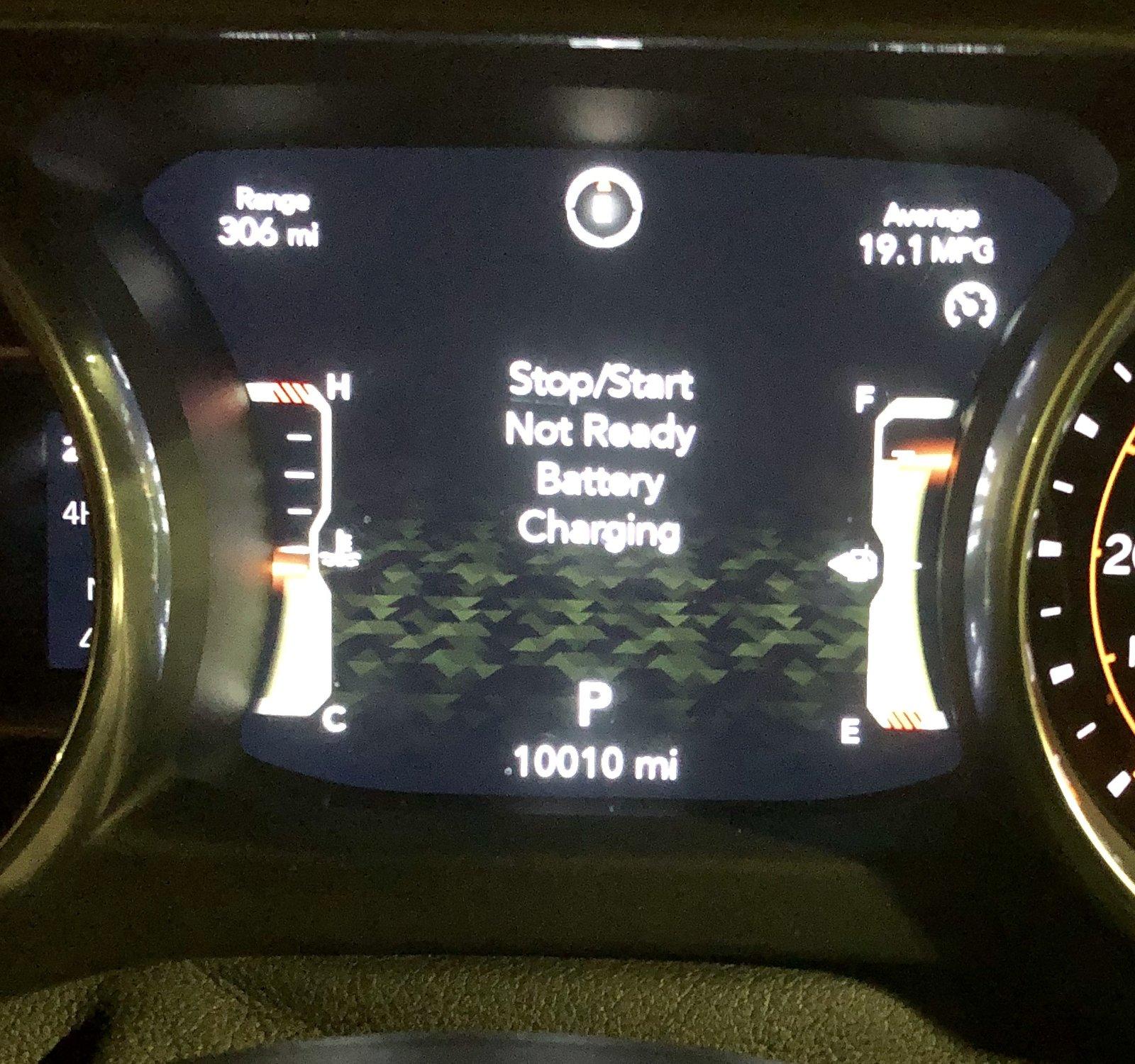

Well after seeing lots of posts on ESS issues and then hearing about bad IBS sensors and bad ESS batteries I did a test, I went into my Tazer and turned the ESS function back on and after doing so I now get a message that says ESS not ready battery is charging and I’m guessing since it’s showing 14+ volts all the time that something is wrong like maybe the battery sensor is bad or the battery itself is bad but it’s never not started and the voltage showing 14+ has been like that for several months so what say the battery ESS experts out there

I actually never really gave any thought into having the ESS system disabled via the Tazer and it having an effect on how it charges the batteries, like I have stated in past posts on my battery voltage, it’s been reading 14+ volts for several months and used to run 12.7-13.9 depending if I was driving steady or accelerating or decelerating but now it’s a constant 14.2 +/- .2

My ESS system has been bypassed for months using the Tazer and like I said my Jeep has never not started or generated any error messages but then when I go thru the menu system it says ESS is off as it should due to it being bypassed using the Tazer so when I enabled it just to do some checking the message changed from ESS off to ESS not ready battery charging so my thinking is since the voltage has pretty much read 14.2 +/- .2 that it’s been charging all the time but I have not seen the message due to the ESS being turned off.

My voltage when first getting my Jeep as I said would go as low as 12.7 and as high as 13.9 and jumped around depending on what driving conditions were but that from my understanding is normal but then one day I was going thru the menu system to reset mileage or something and saw it reading 14.2 so I was thinking dam that’s pretty high but never paid much mind to it since it’s been staring and running fine but after reading some of you have had batteries die and IBS sensors and fuses blowing I turned ESS back on to see and that’s when I saw the message Start/Stop not ready battery charging

14v are what the agm batteries charge at.... Take a multimeter and check the batteries at the sources. .... Should read 12.5+

Usually when you see voltage around 12.5 volts your reading battery only. To charge a battery properly the voltage needs to be at least 1.5 volts above the battery stated voltage to charge. So 14 volts would indicate the battery is being charged by the alternator, Now I'm not sure how Joe disables the ESS (I initially showed Joe how to manipulate the FCA Can Bus over 12 years ago before an FCA tool ever existed). But if Joe sends a "ESS not equipped" command that may screw up the charging strategy. If he duplicated the every cycle button push "ESS Off" that may not screw up the system. You need to chat with Joe from Tazer to determine whats happening. Tell Him "Blown7" sent ya,
