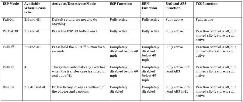

I have been doing some reading on the ESC & TC of the JK. Looks like it doesn't fully disable unless you preform something called the "Wheel Dance," (keeps ABS on) and that seems like quite a process. I have been wondering, would the JL most likely be the JK? Or would they change it to where there would be a 1sec press to deactivate TC but keep ESC on, and a 5 sec press to disable everything (even in 2H, 4H, and 4L above 40mph)... that would be I deal. Now as I understand, some have been pulling the fuse but that would disable the ABS as well. It would be best to have the ABS active but not the ESC & TC.
I have attached a photo of the different Stability programs of the JK for reference.
If anyone is interested to know how to perform the 'wheel dance' here it is:
Procedure To Turn ON (or OFF) The Permanent ESP Disable Feature:
a. Verify that the automatic transmission selector is in the “Park” position, and that a manual transmission is in neutral gear.
b. Shift the transfer case into the 4H range position and ensure parking brakeis firmly set.
c. Turn the steering wheel until it is centred and the wheels are pointed straight ahead.
d. Turn ignition on (and optionally start engine to make turning the wheel easier – will work with or without enginerunning) and wait approximately five (5) seconds for the system bulb check to complete.
e. Turn the steering wheel one-half (½) turn to the right (clockwise).
f. Press and hold the “ESP OFF” button for 7 seconds exactly then release and wait for chime.
g. Turn the steering wheel back to centre, then continue turning the steering wheelone-half (½) turn to the left (counter clockwise).
h. Press and hold the “ESP OFF” button for 7 seconds exactly, release and wait for chime.
i. Turn the steering wheel back to centre.
j. Press and hold the “ESP OFF” button for 7 seconds, release and wait for chime.
k. Cycle the ignition switch to the “OFF” position.
