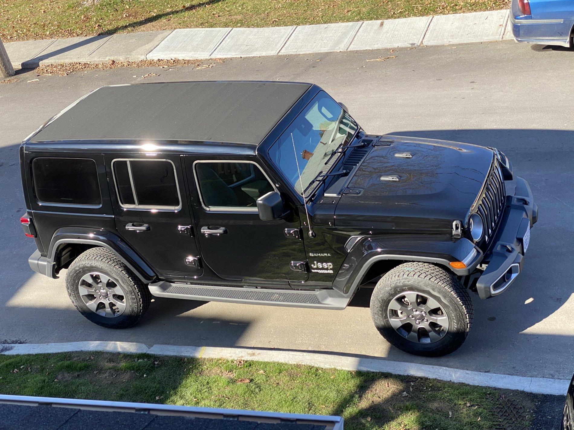

Hey guys, just picked my Wrangler up last week. Love it so far.
I do notice however a bit of wander while on the highway. Constantly correcting to stay straight, wondering if it’s due to the combination of lighter steering and the extra weight of the diesel.
Ive got the Mopar 2” lift kit ordered, but I’m wondering if there’s something I could also add that might tighten up the steering?
Thanks in advance!
