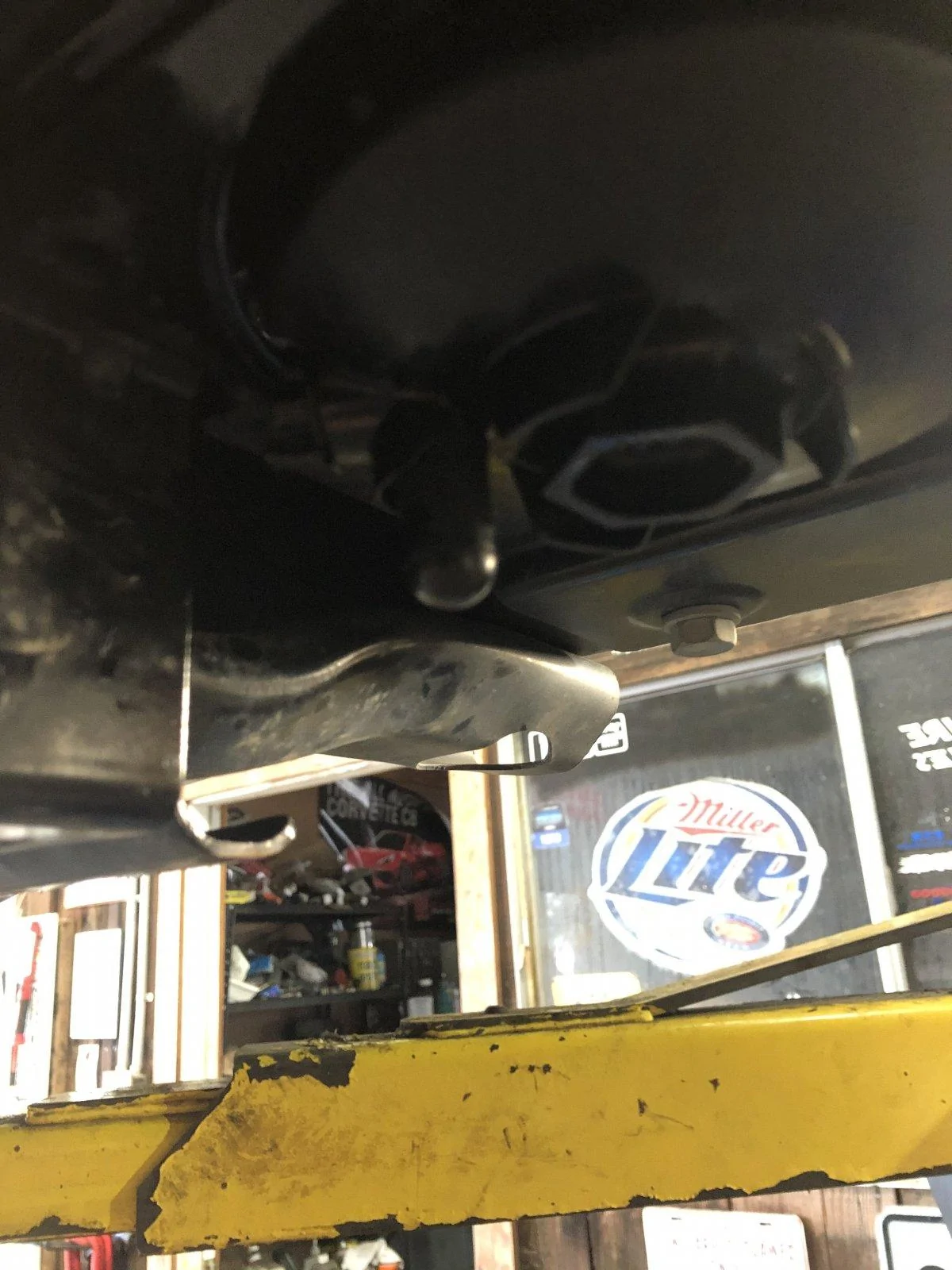

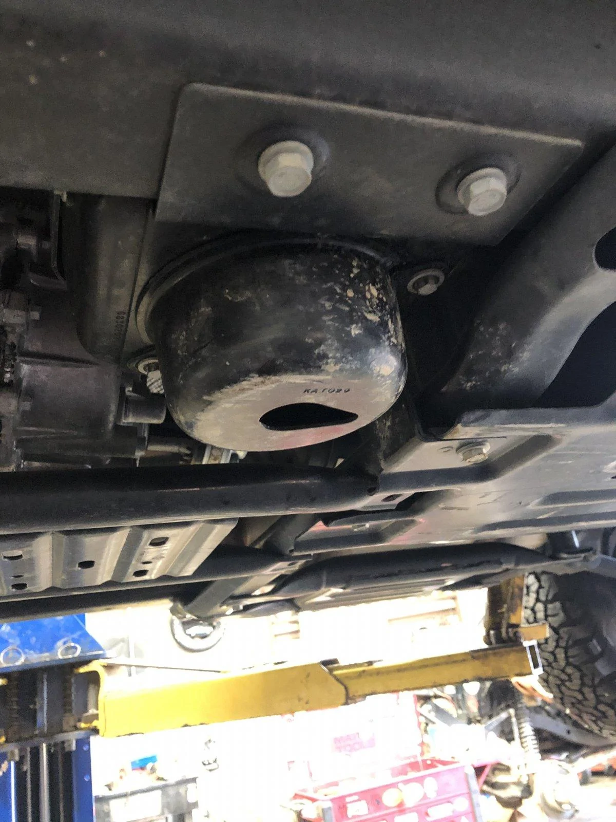

Filter is under this little skid. I also drain the water separator every time I rotate tires which is about every 3,300 miles

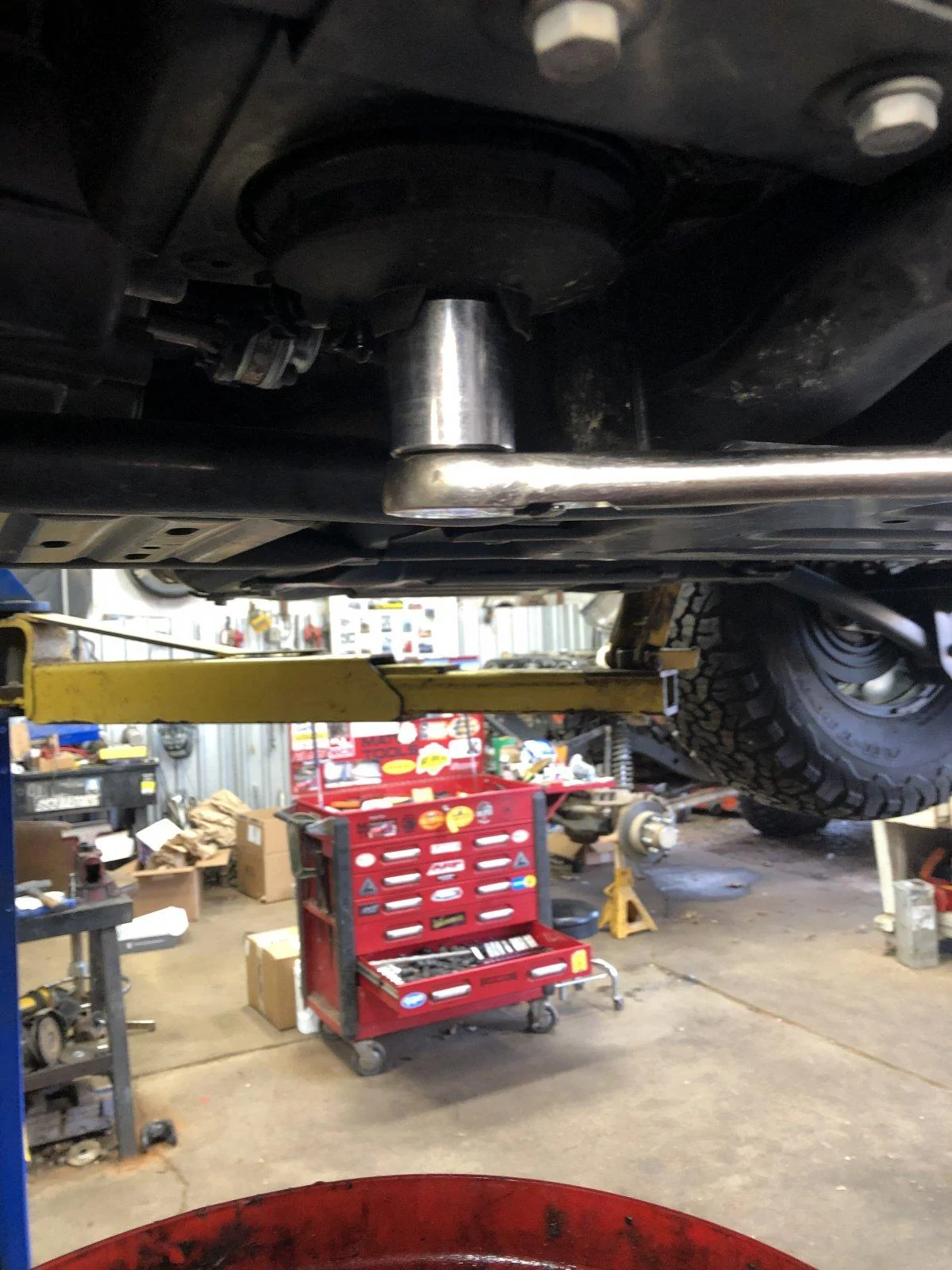

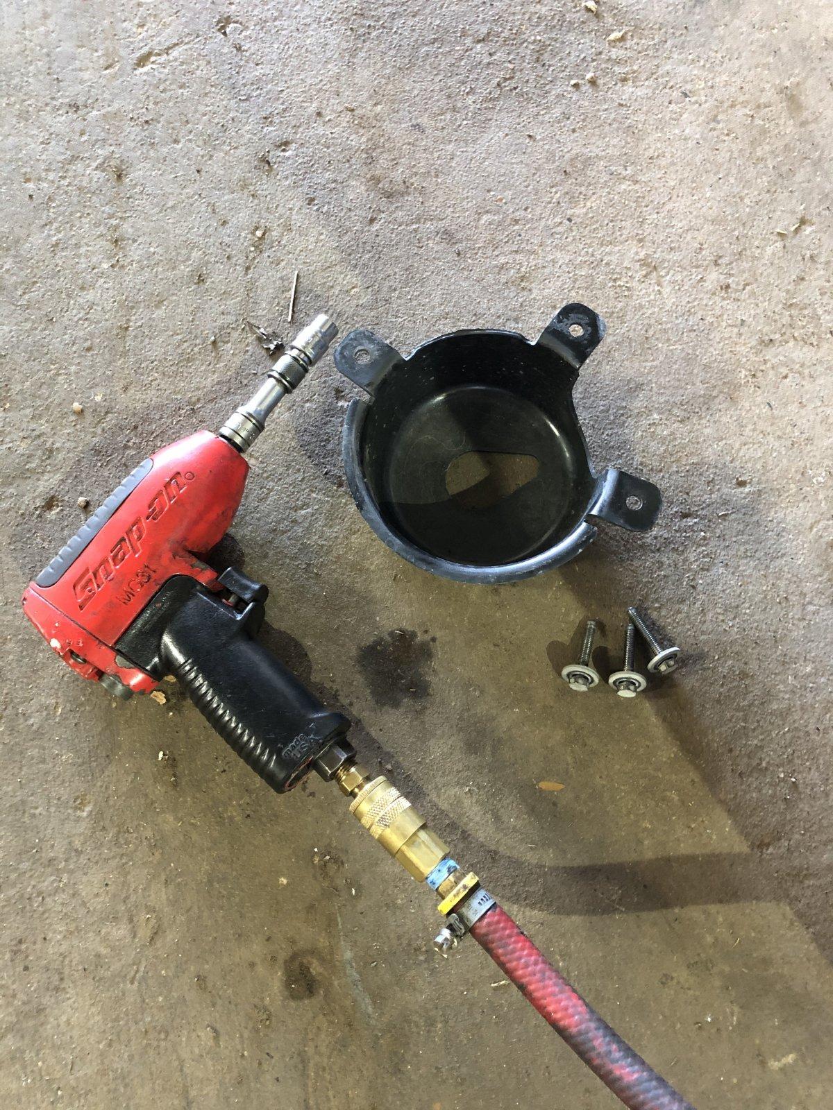

Pull 3 10mm bolts, pull skid, drain separator then remove housing with 28mm socket. It’s tight but not Toyota tight

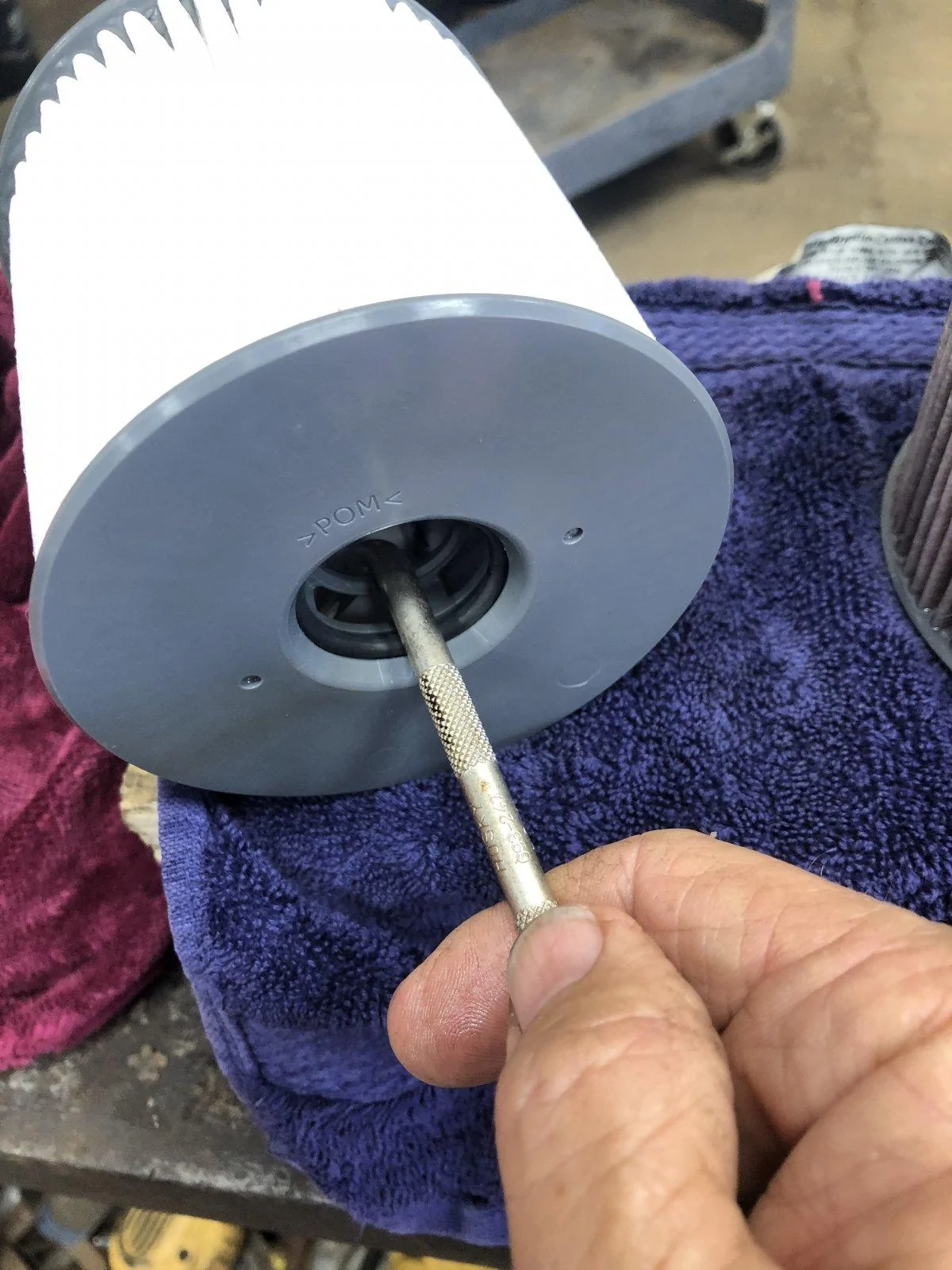

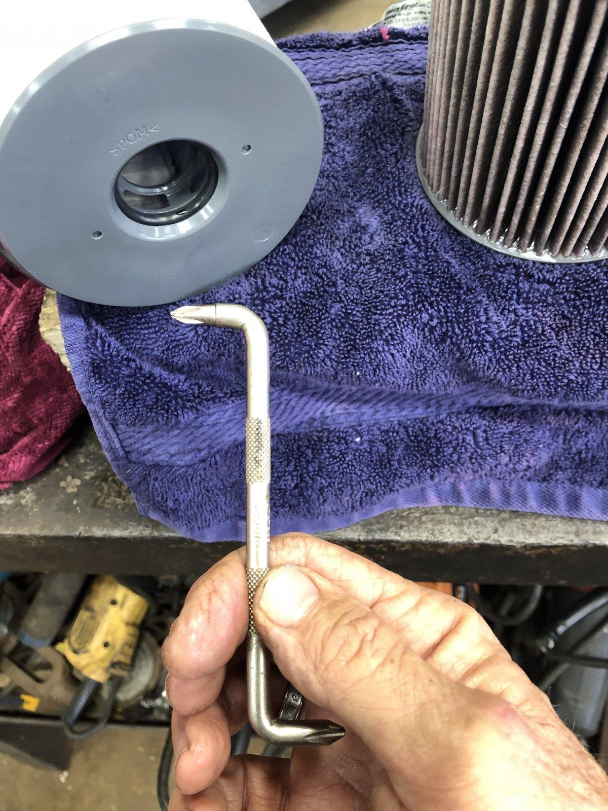

I hooked the old filter with a 90 degree screwdriver to pull it loose

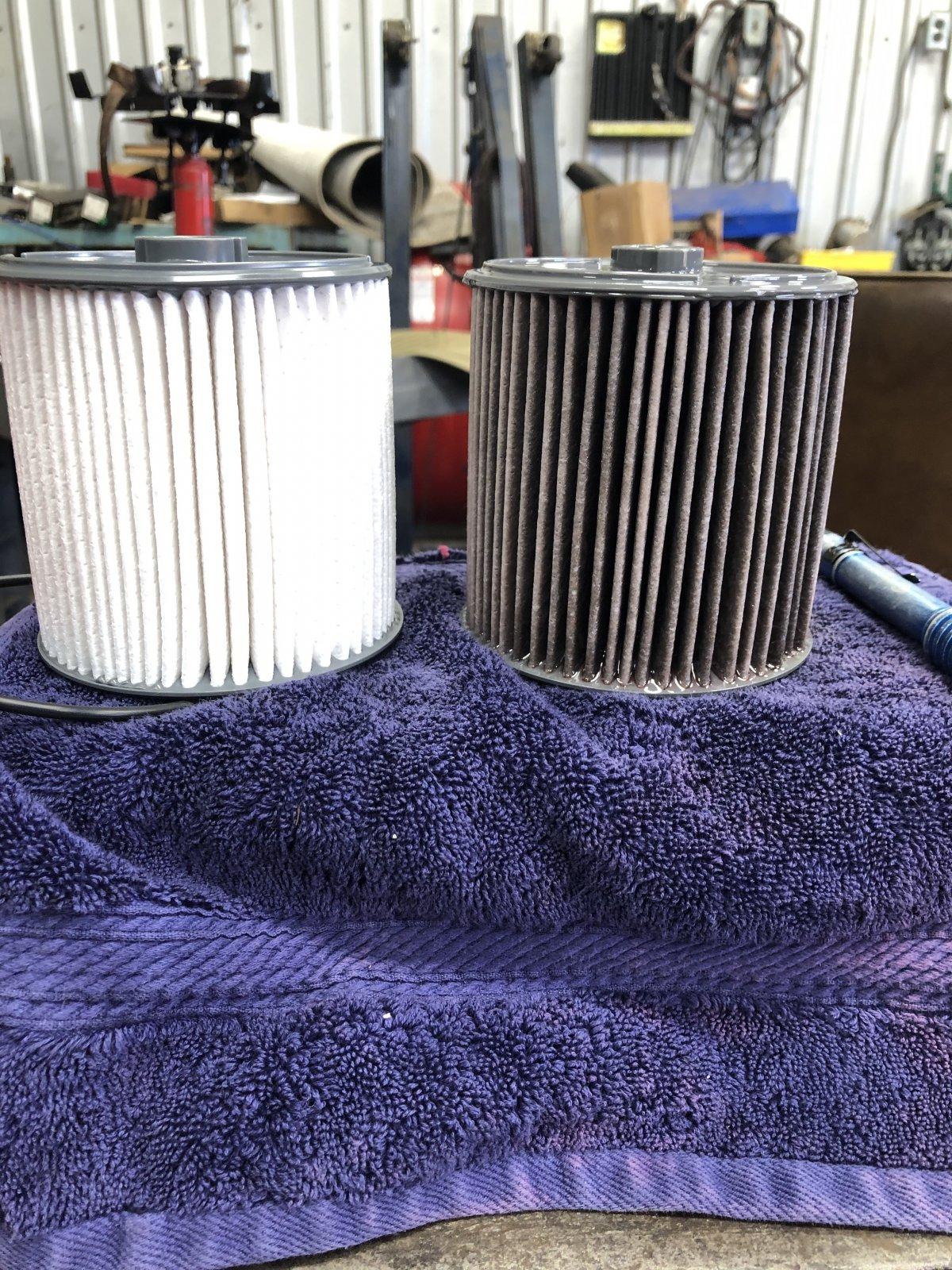

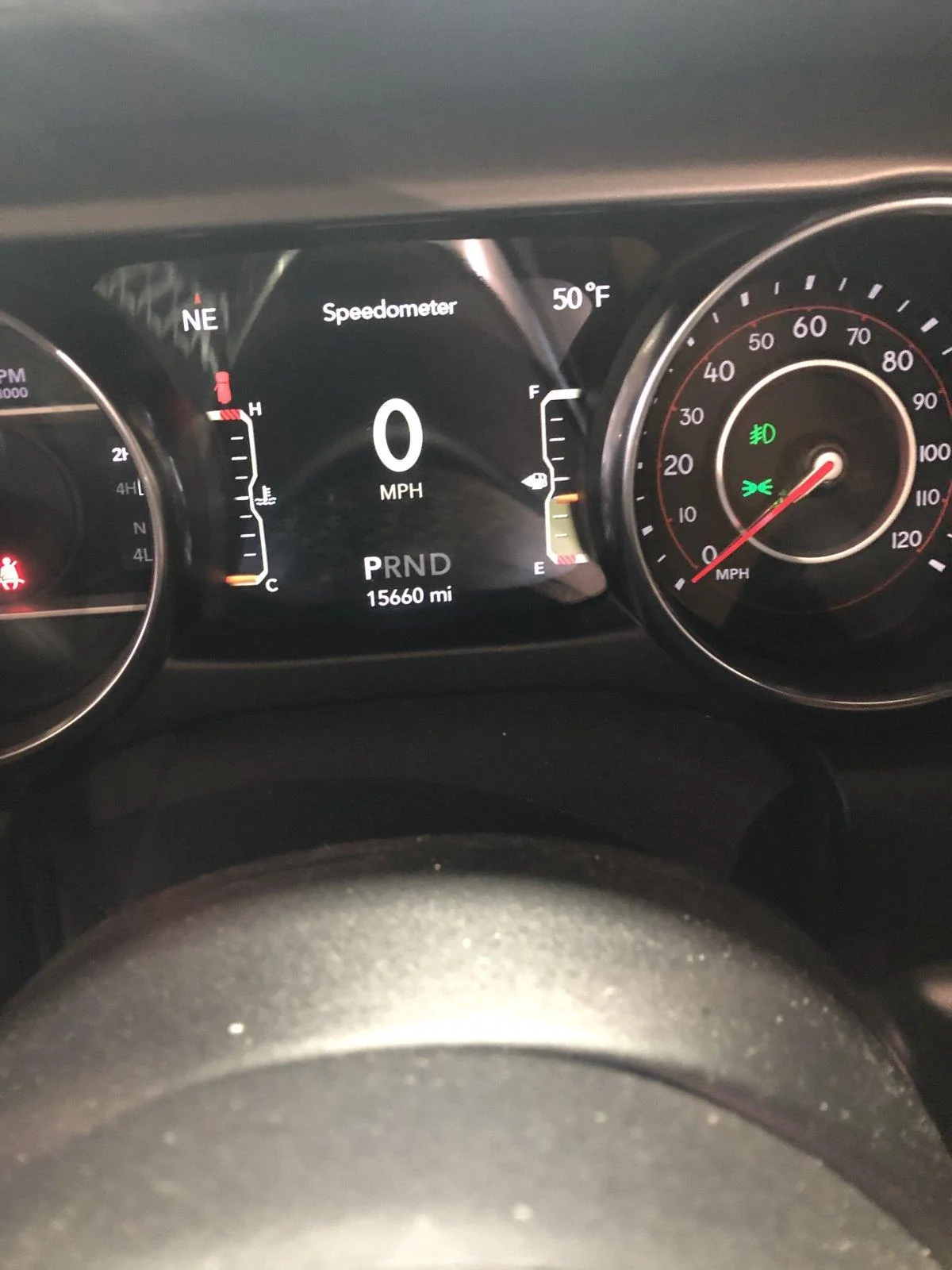

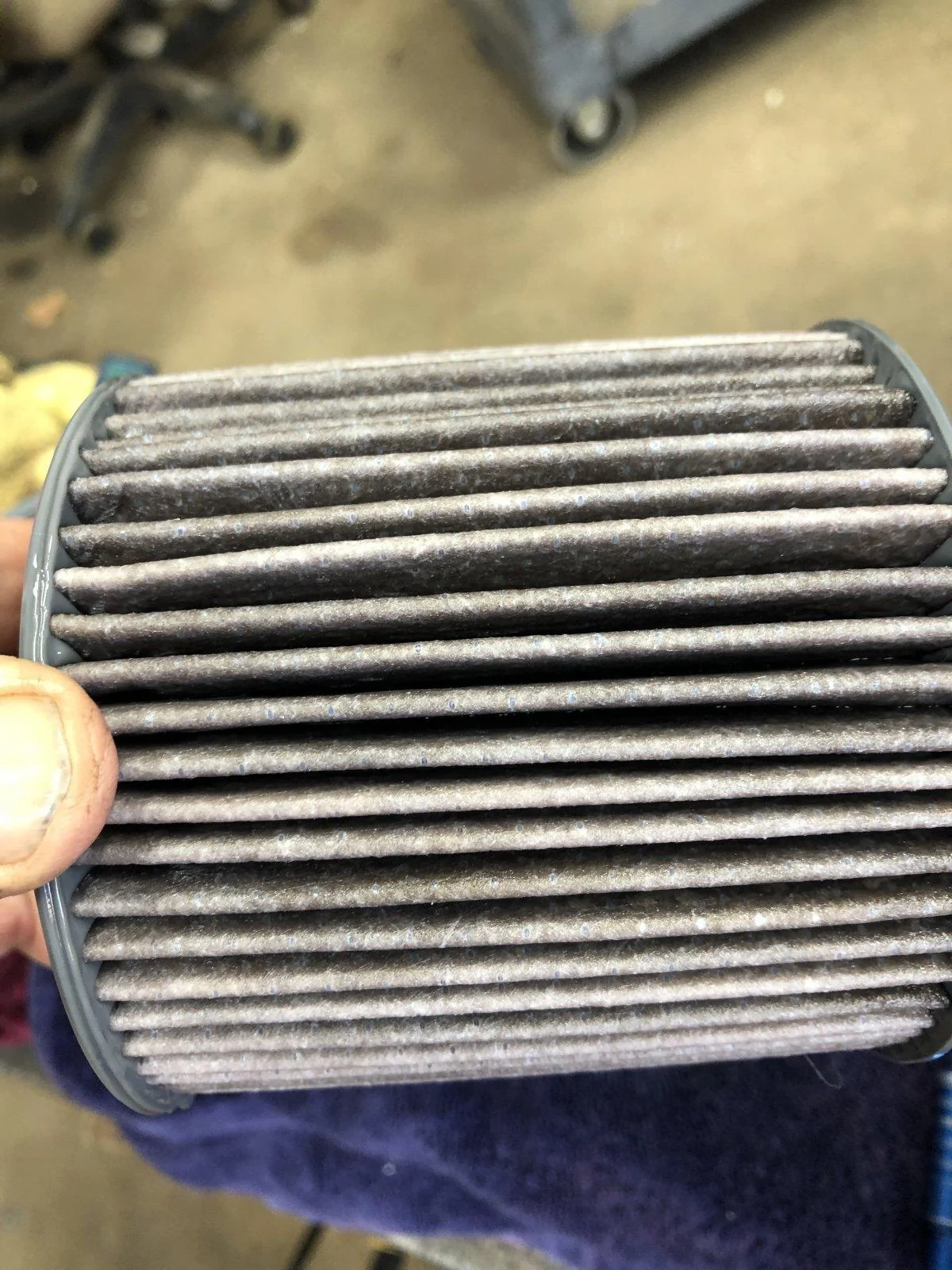

This is what mine looked like at 15,660 miles

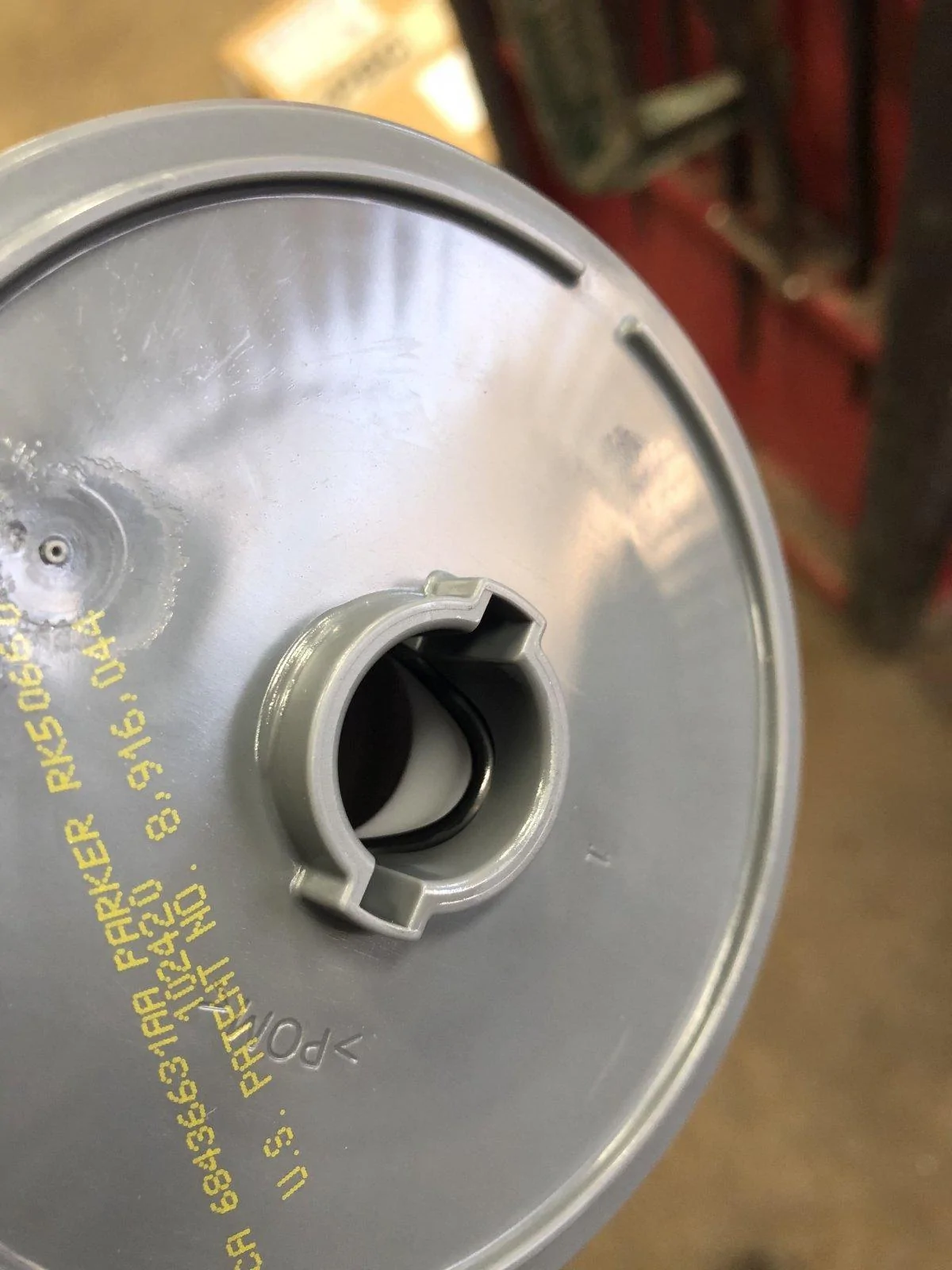

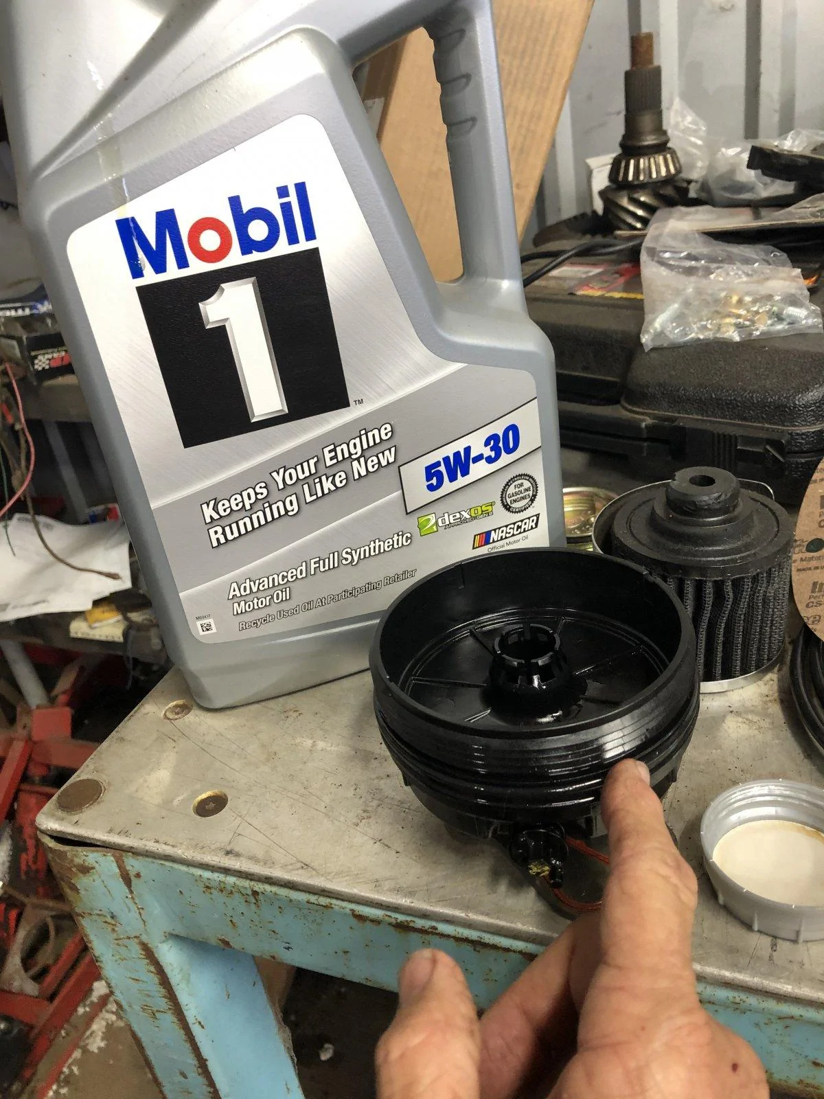

Change o-ring and lube it with clean oil
Jteakus
Jteakus
Apr 18, 2020
279
258
Oil City Louisiana
2020 Ecodiesel Unlimited Rubicon
Make sure you line up the 2 slots with the ones in the housing, push it up, screw separator cap back on and snug it.

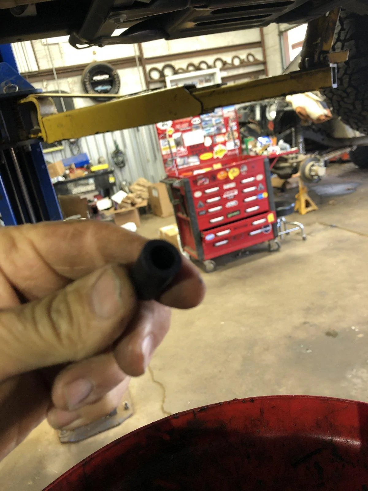

I keep a vacuum cap over water drain to keep funk out
Since there is a hole or opening by the water fuel separator valve on the cover, can the water be drained without removing the cover?
Jteakus
Jteakus
Apr 18, 2020
279
258
Oil City Louisiana
I think you are supposed to be able to but every time I tried I got aggravated and just pulled the skid/cover
