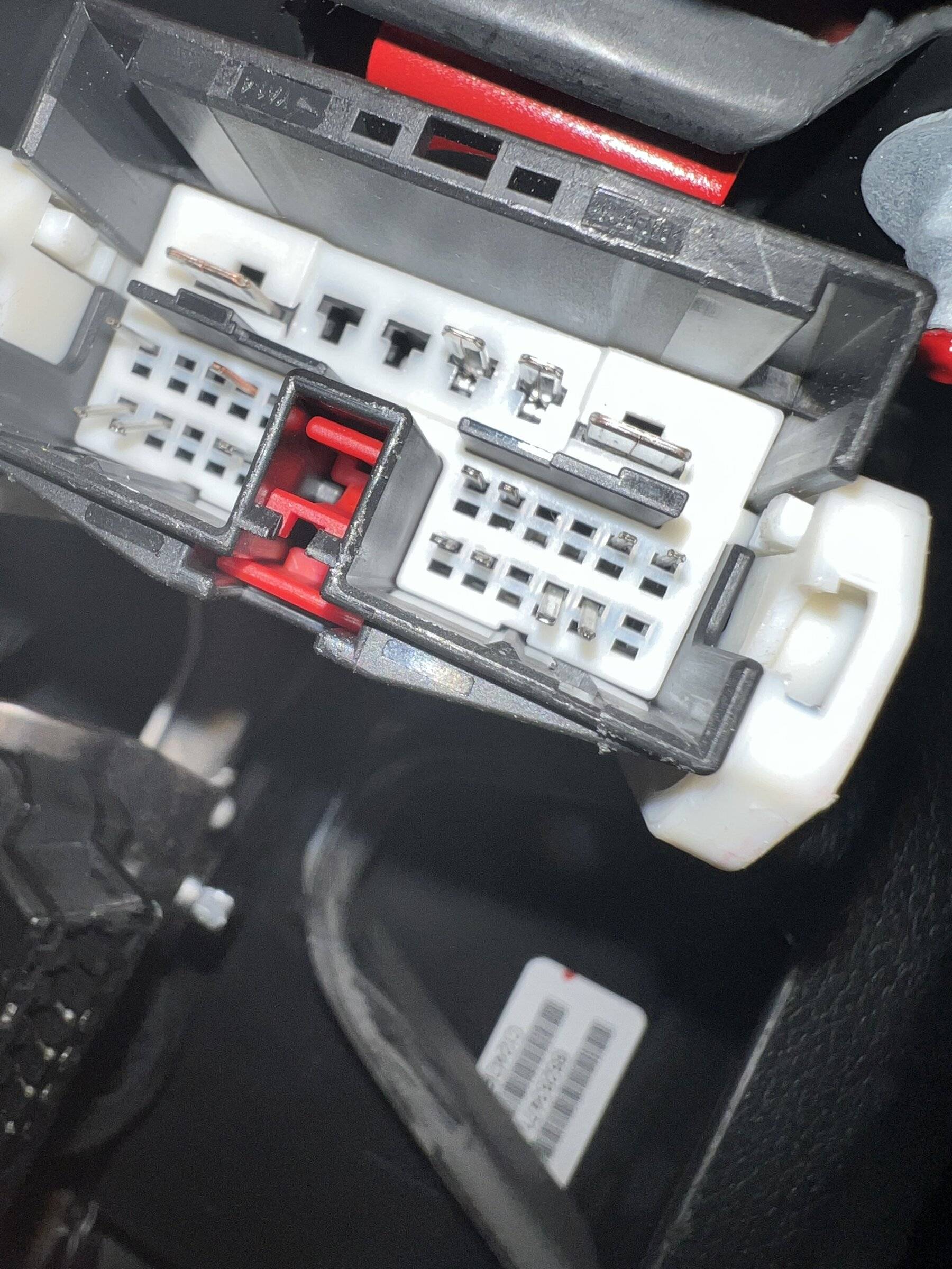

Door wiring harnesses are very fragile...lost a pin in my passenger door second time I put the doors back on, lost vertical control of my mirrors. Not worth a trip to the dealer on its own, but will be mentioned if I have to go for other purposes.I figured it out was a bent pin in the door harness
