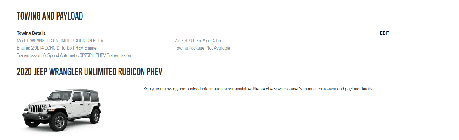

    According to the jeep website the PHEV will have the 2.0l DI engine with 8P75PH PHEV Transmission. Googling the 8P75PH transmission indicates some design parameters with regards to its use case with regards to a PHEV application.
    https://www.zf.com/products/en/lcv/products_50899.html
    Ranges of up to 50 kilometers and a top speed of 120 km/h (74.5 mph) in all-electric mode
    Compact electric motor with a peak output of up to 90 kilowatt and 250 newton meter torque
    The range of 50km or ~31 miles is roughly the same as what is in the Pacifica so it will likely use a similar sized 16kWh pack that is in the pacifica.

    yes the design of this transmission is for the electric motor to provide a boost to the ICE in tandem.... But be aware that that is peak output and likely at 360v nominal with about 13.6kWh usable.
    Max power would be about 5-6c (for 3 seconds) with sustained around 3c or about 48kw... This is different than an ICE... as the energy in the battery pack is depleted it will correlate directly to the sustained and peak performance of the vehicle (i.e a vehicle with a near depleted battery will not perform the same as one with a full battery). Bottom line, as voltage sags, performance will be worse.

    I dont see this at Jeep.com
    Can you share alink?
  12. diesel_jeep
    diesel_jeep Well-Known Member
    Vehicle(s):
    4bt Cj
    Joined:
    Jan 8, 2020
    Location:
    Ca
    Posts:
    51
    Liked:

    Good find, thanks!
    I notice that the Sahara says it comes with 3.73 gearing
