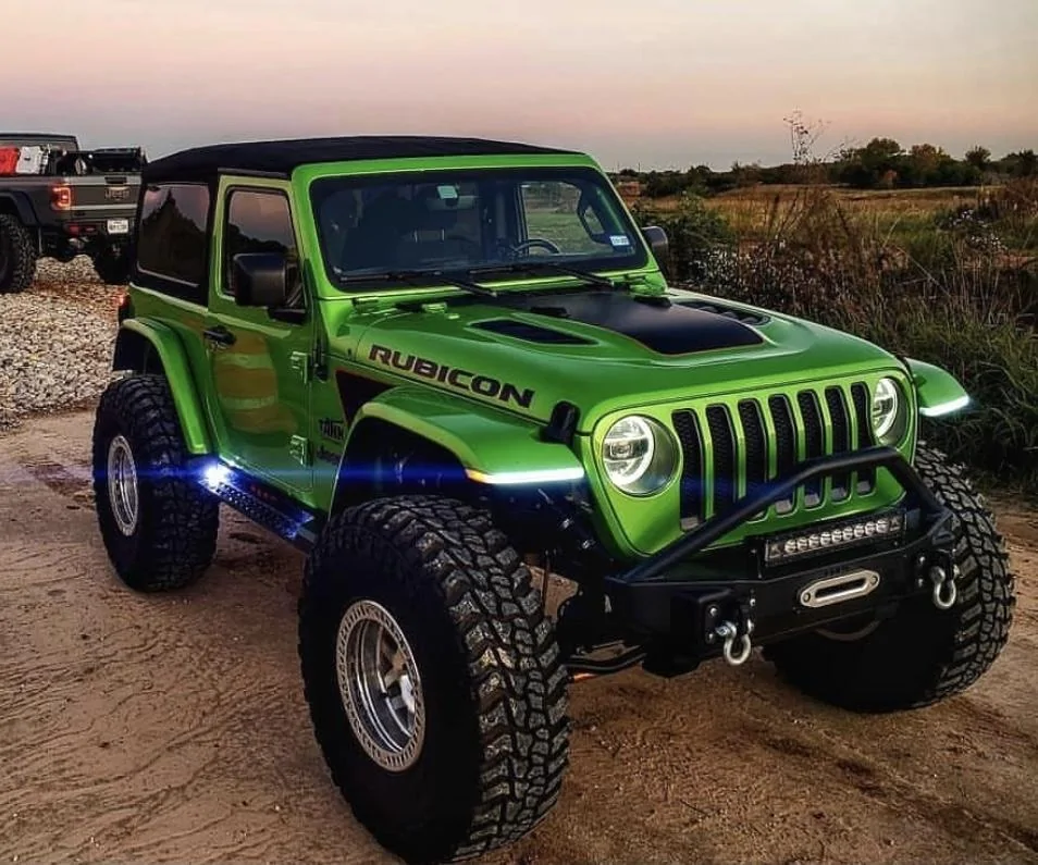

What fenders are these? Are they just oem fenders with the liners removed?

American adventure lab high line light kit paired with the factory Rubicon fender flares.
The lights on the rock sliders look sweet in this pic too which are the ROAM Rock Rails. I know because I have them

If you want to hide the engine components, do you have to get some aftermarket inner liners with this mod?

If you are handy with a razor blaze and tools the factory liners can be made to work.
Artec makes a fender hardware kit for about $30 you will probably want to add if you choose to go that route that replaces all the shitty plastic factory Christmas tree clips with 1/4 20 hardware.
Beware that Artec kit will be more work to install than you probably think as it’s a bunch of nutserts that have to be installed first.
Most people pair the AAL kit with aftermarket fender liners for a more upgraded look and an easier install. It’s just about 10x the cost of the Artec hardware kit to go that route. $35 vs $350 ish

Cool. Thank you VERY much, 👍

I think Eddie Oh of [Banned Site] and Rob from Quadratec did YouTube videos on this.
