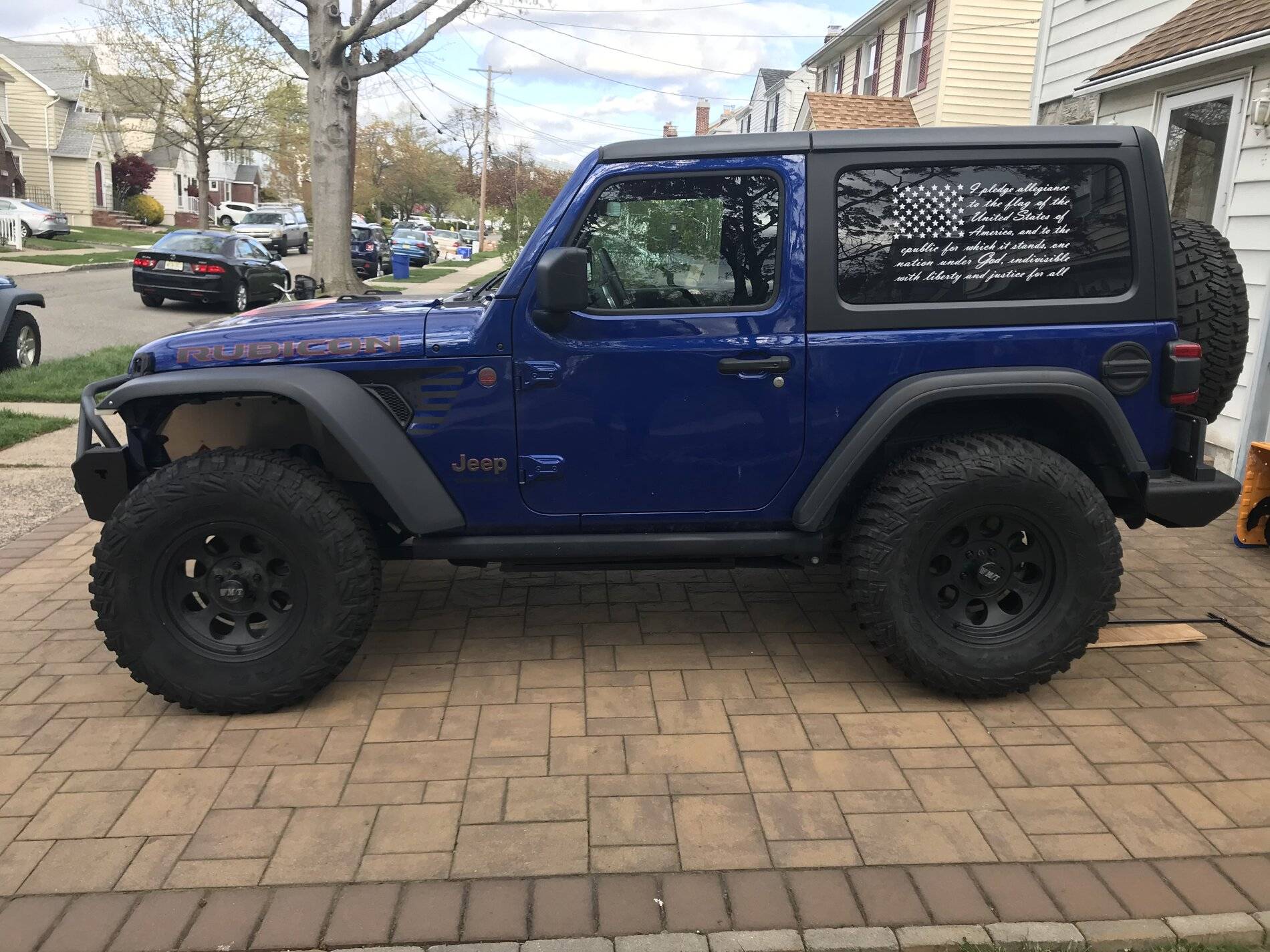

Here they are on the Jeep

I'm pretty sure those wheels are NOT hub centric. You likely need a centering ring.
