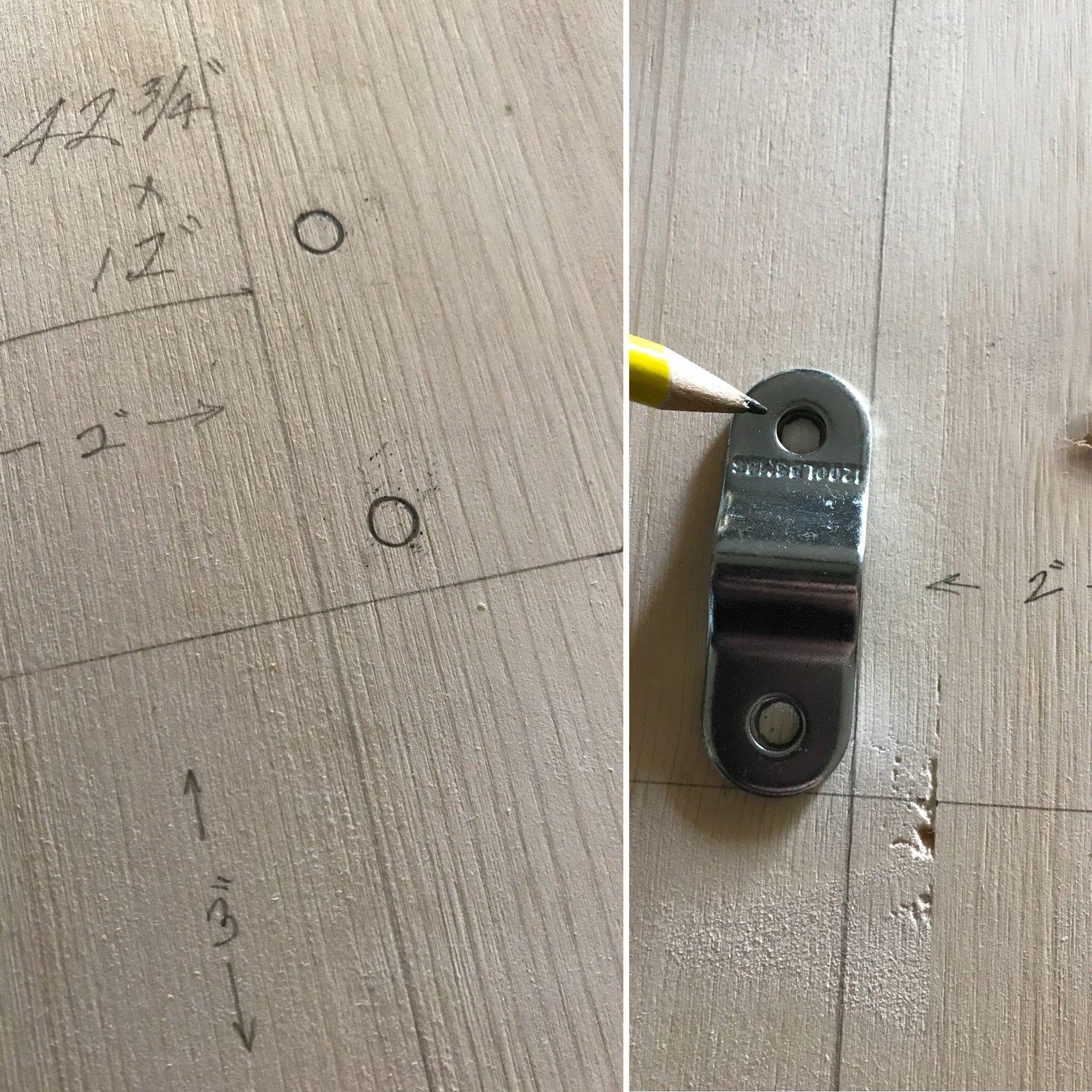

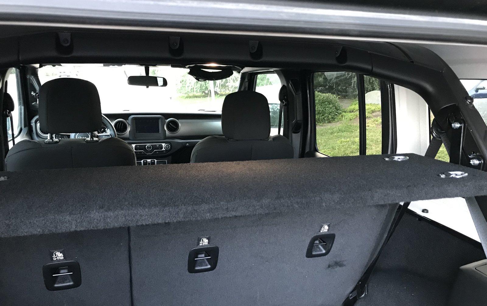

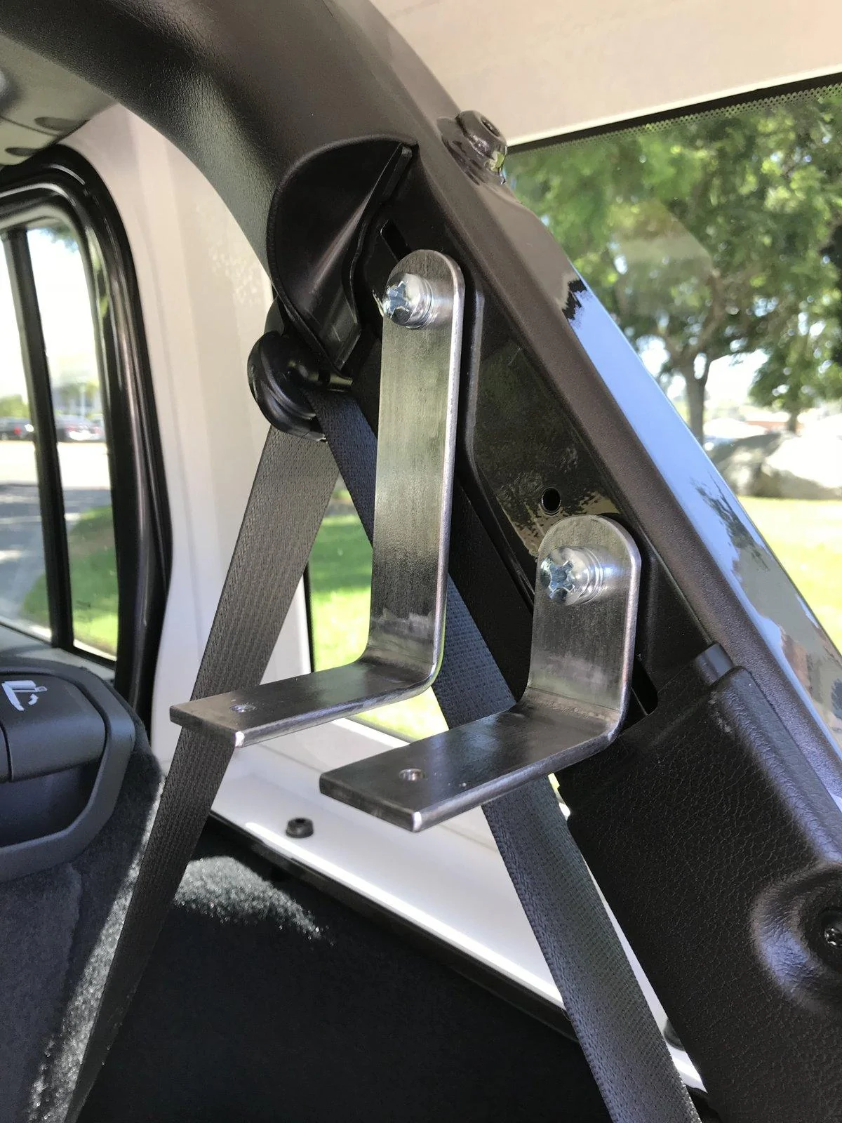

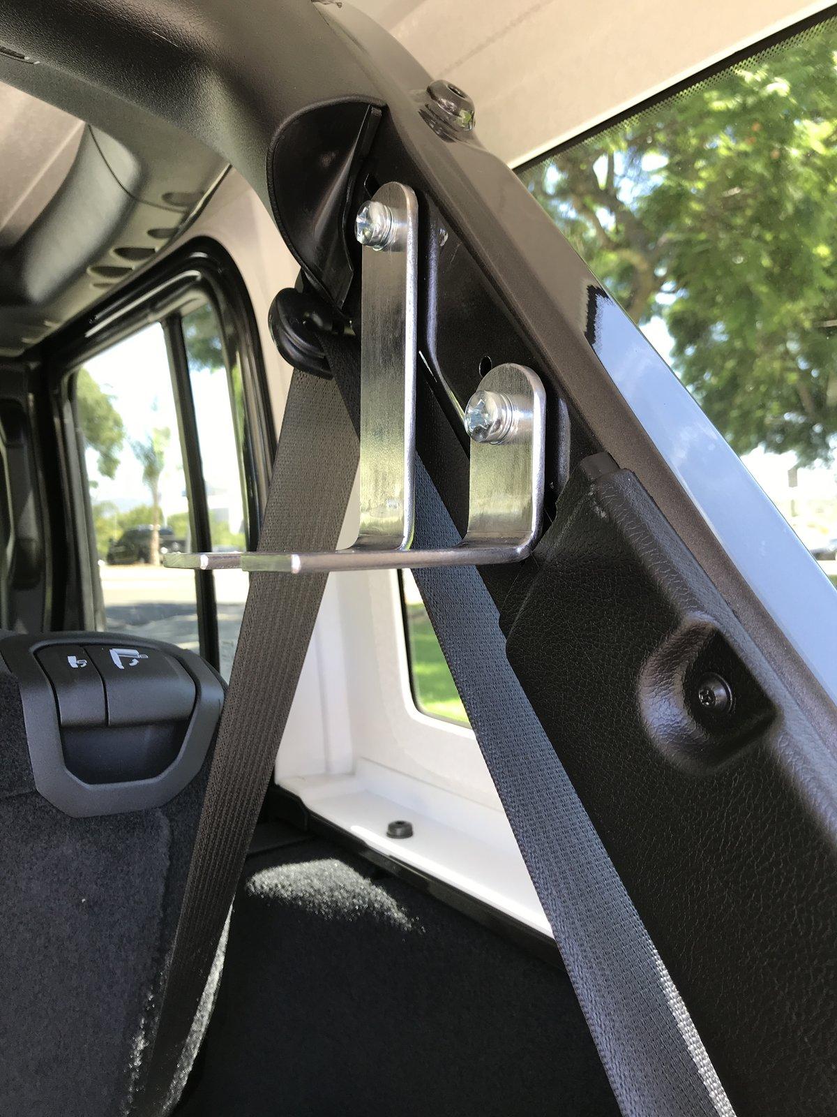

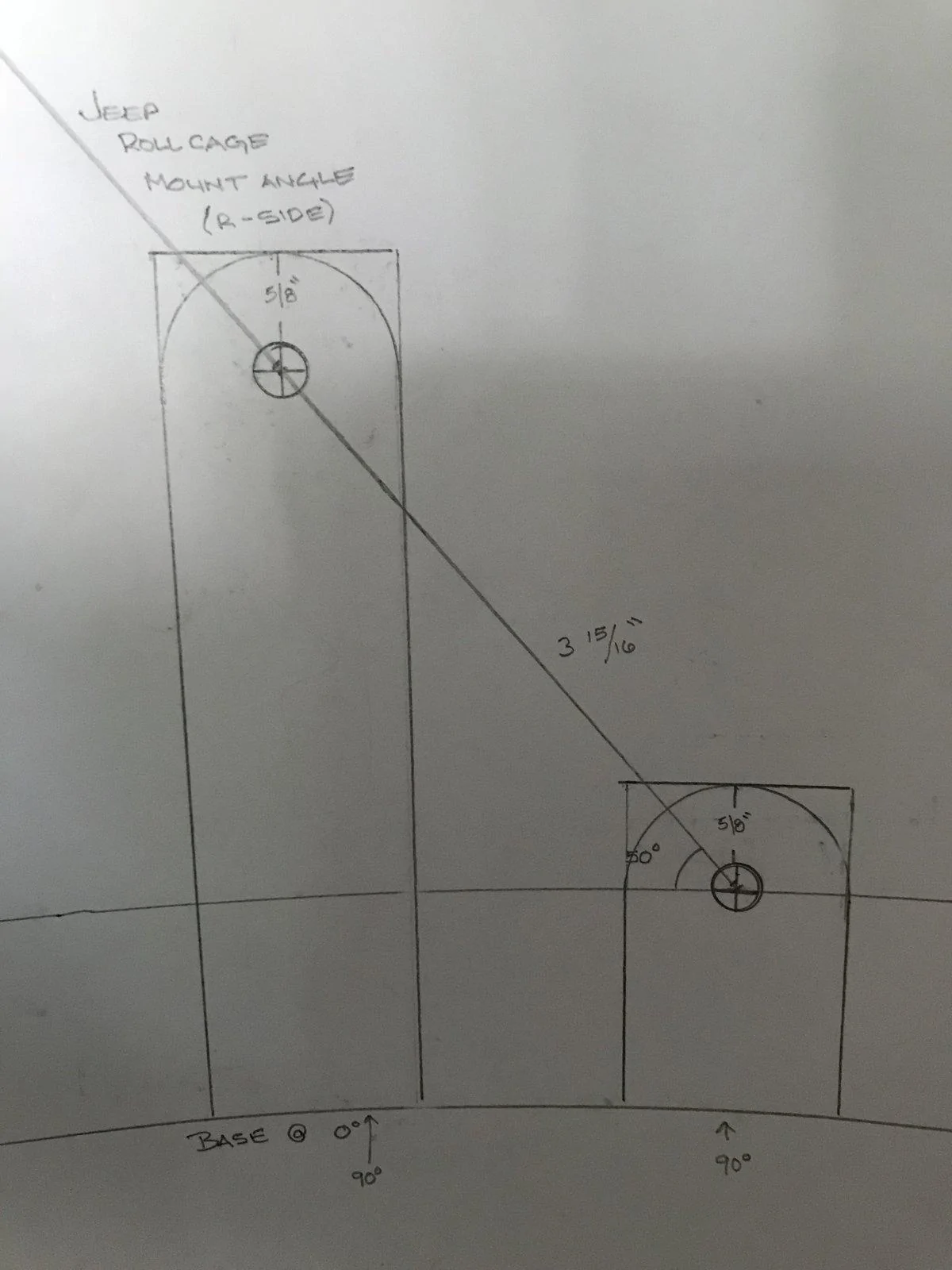

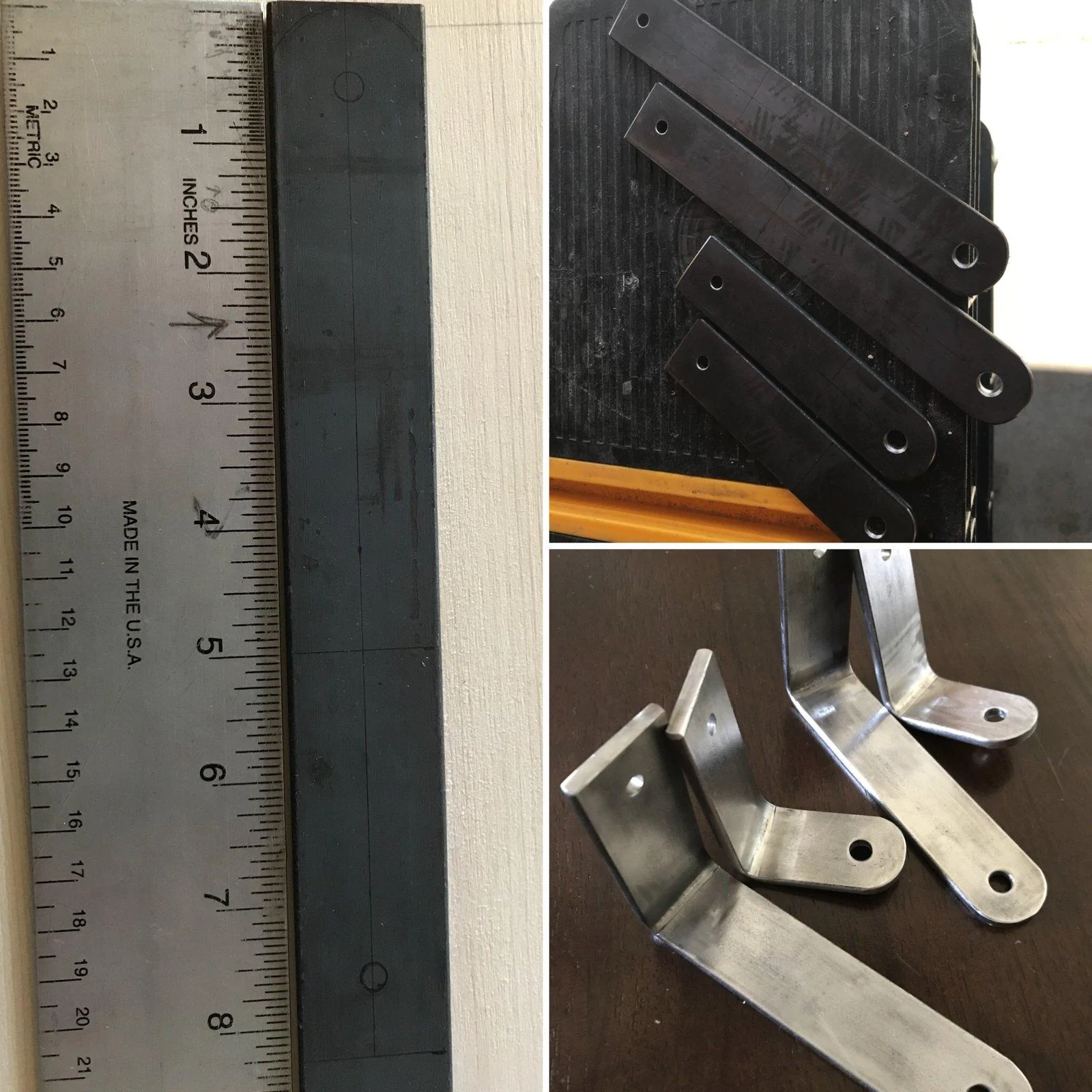

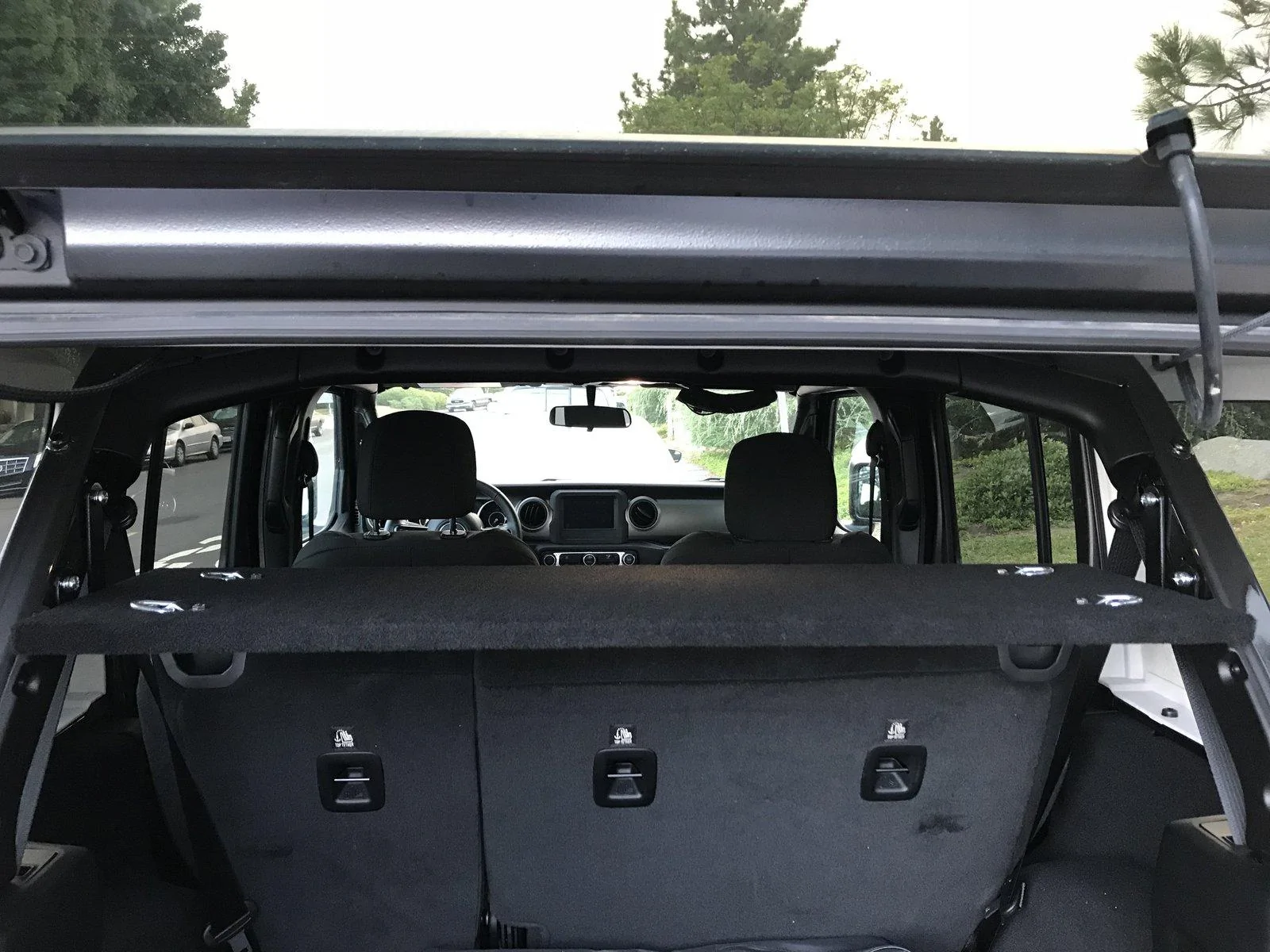

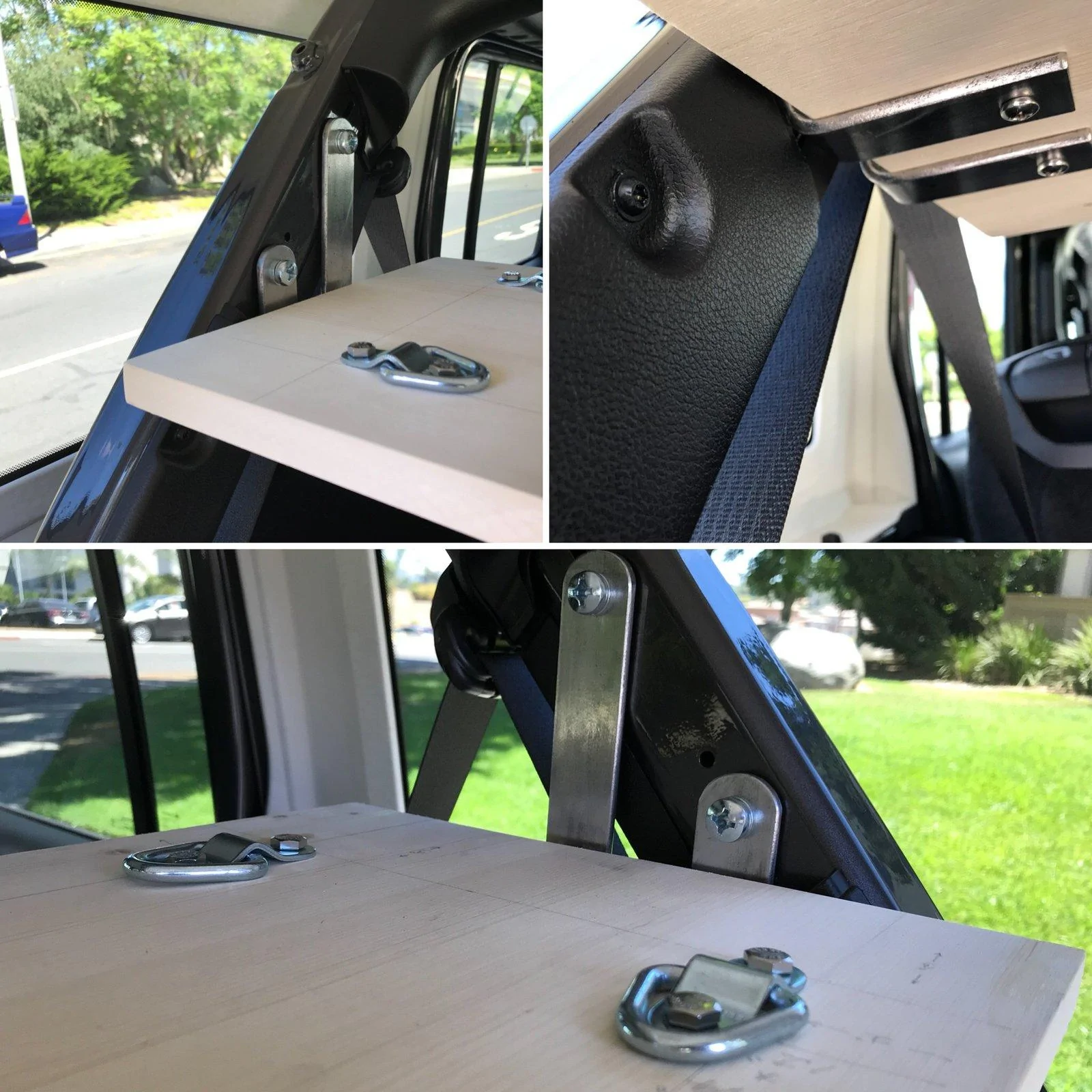

Hey Jeep JL fans. I created a DIY rack that I wanted to share using basics parts and tools from Lowe’s and what you have in your garage. My target cost was $50 but with everything I ended up at $58.12. Not to shabby! The benefits of the rack is it’s really a no modification to your Jeep that bolts right to your roll bar. It can hold to 200# of weight and it looks oem. It’s high enough to still sleep under it and it’s easily removed with four bolts. I couldn’t be any happier with how it turned out and have had a lot of feedback that has been all positive. I may even sell prefabbed hangers powder coated black with hardware in the near future since bending the flat stock is kind of a pain and has to be on point. Let me know what you guys think and I’d love to see this mod on your Jeep JL! Thanks, and if you want to see a short clip go to my instagram page @JeepTek
