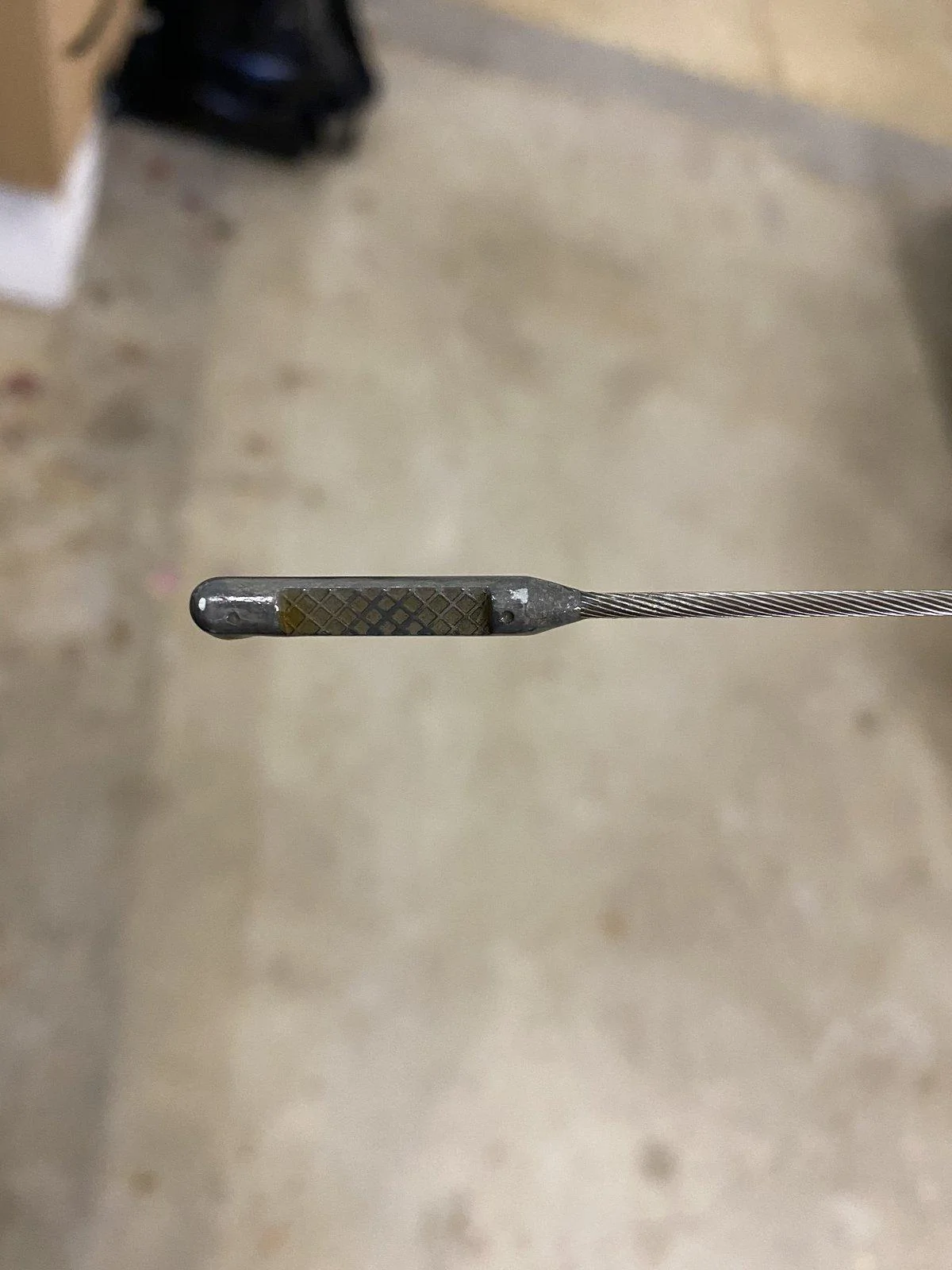

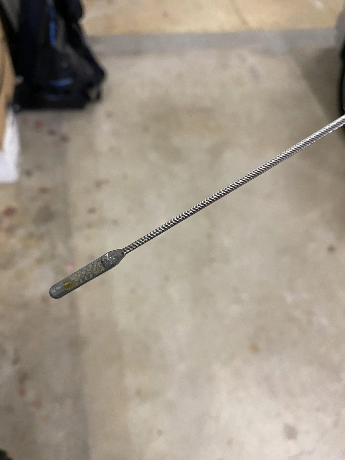

Is this what 5 quarts looks like? It’s so hard to tell. This picture was taken a week after I bought my JL, probably had 100 miles on it.

Hard to tell 100% by that picture, but if the oil is right to the top of that flat cross-hatched area of the dipstick you're right where I am after a full DIY 5qt change w/ new filter.
It's easiest to tell after letting it sit overnight and checking it cold, w/ a light on the dipstick you'll clearly see exactly where the oil stops on that stick.
Also be sure to use a 1/2" socket for the oil drain plug and a 15/16" for the filter cap, using metric sockets aren't a tight fit.
