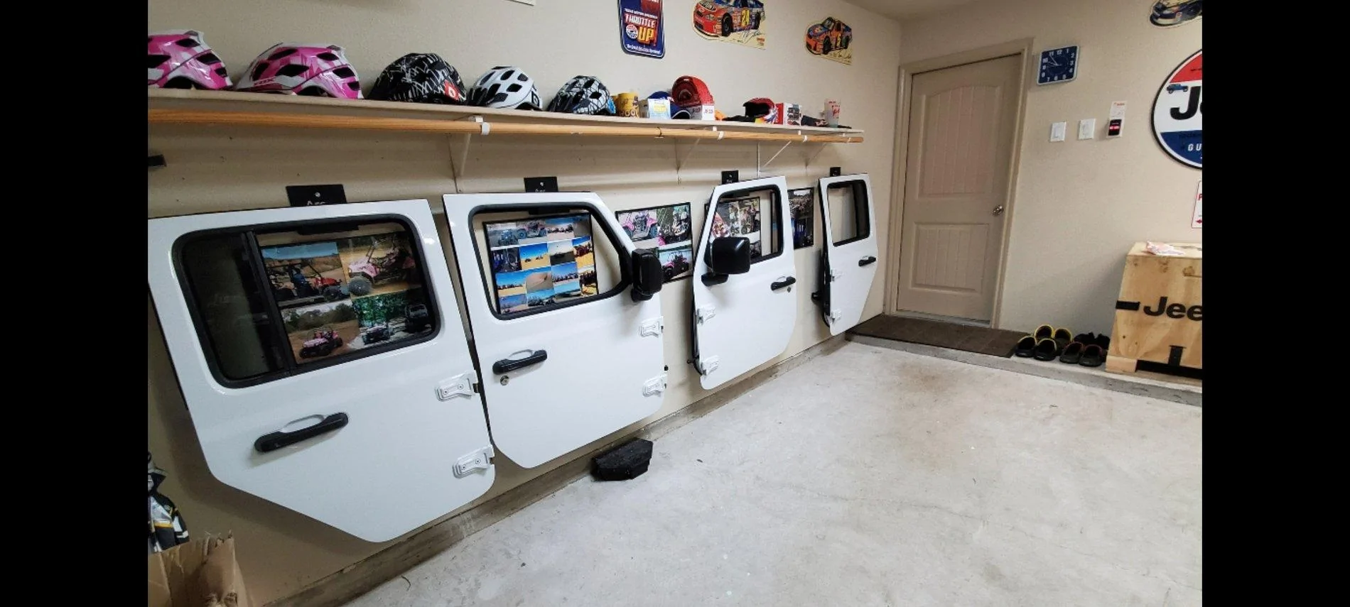

I saw one of those on the internet I don't know if that's it or if you made one yourself somebody probably could make one of them self but the balance would have to be just right it look like a car engine motor stand to me.push it out around if it was to move if you have to move it around until fall over it only takes one little dude I don't know why people just don't buy those wall hangers unless you don't have room in the wall I didn't have room I made room I move stuff around in my garage I mean if you don't have a ride so I understand. But I always make sure I get room to mount my doors on the walls in my two car garage.my doors are not going to get dinged up for myself much less how pissed off we get if somebody doesn't at the store I would be pissed if I get it myself I'd be really really pissed. Plus it wasn't very cheap the one I looked at those ARC wall mount is the way to go

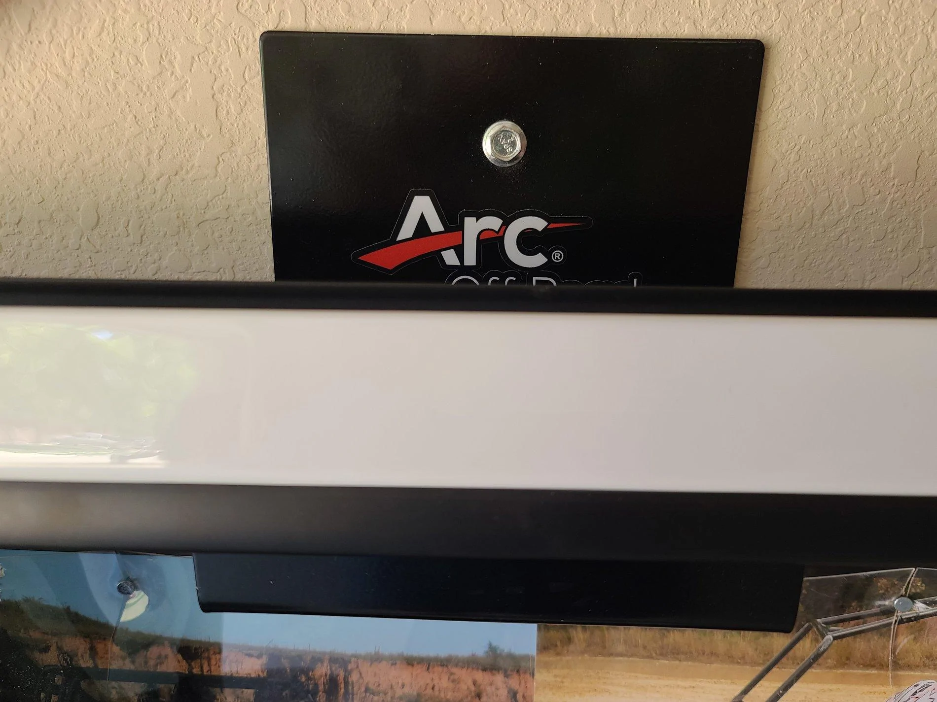

If you have room in your garage this is the way to go. You don't have to worry about them being moved around or getting banged up and you can put stuff back in front of them once you get them on the wall

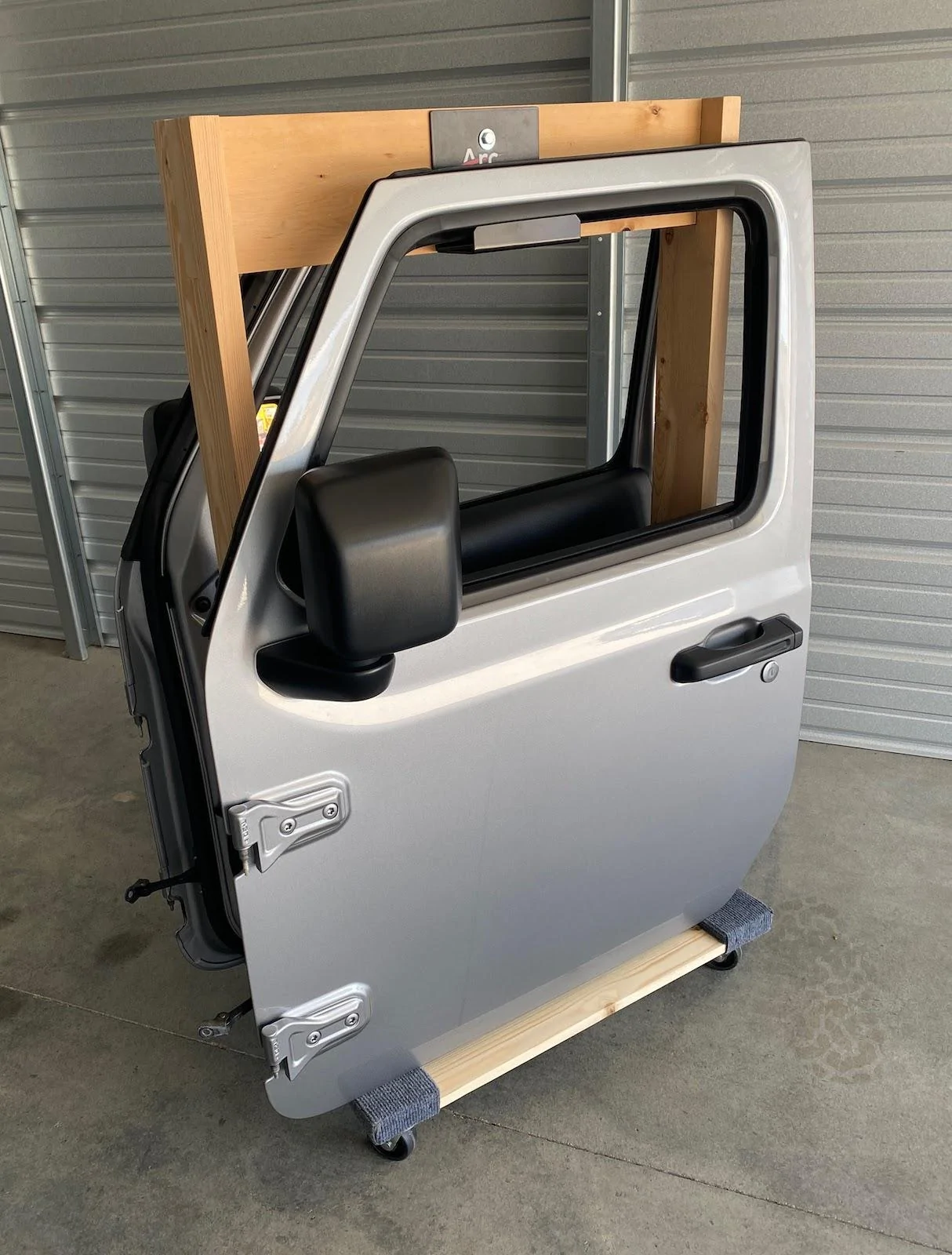

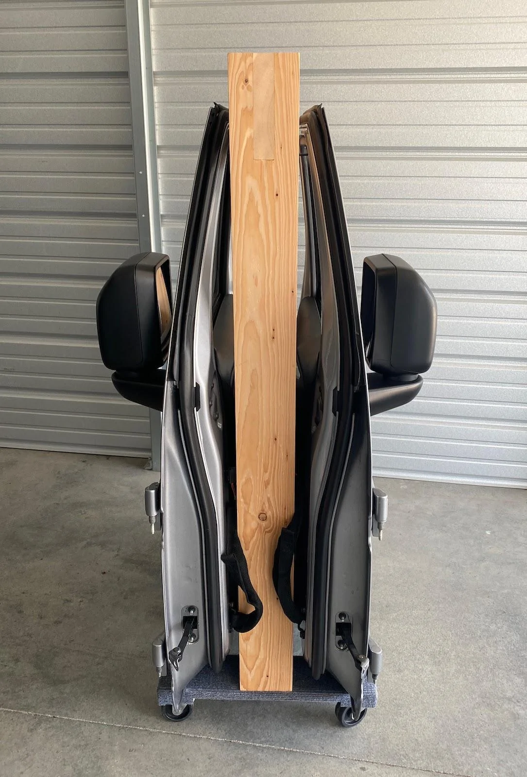

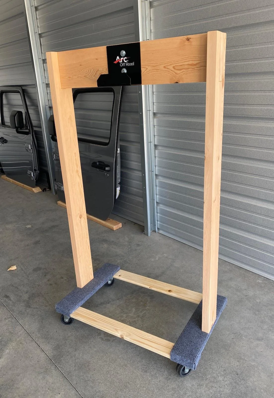

I wound up combining the Arc Off Road Hangers with a DIY furniture dolly door cart.
The Arc hangers are totally overkill, but I bought em before deciding that I'd rather have my doors on a cart in my storage unit than on the wall in my garage...
The weight of the door is resting on the furniture dolly. The Arc hangers are simply there to keep the door in place. This keeps the cart from being too top heavy.

The cart is a good idea and looks good. One of the best features about the ARC door hangers is it goes inside that groove of the window compared to a wheelbarrow or other kind of hook that can put pressure on the door rubber seal. I saw somebody that had a wheelbarrow hanger all summer but the door on there and it put it in dension on the rubber seal around the door that's why these are nice because it goes up inside and doesn't put pressure on the rubber seal. You put an indention or damage that rubber seal you can have water leaking in when your windows up as cheap as they are why not use them I don't see my wheelbarrow hangers to save a few dollars and twenty bucks is worth the risk of damageing the rubber window seal. I don't think 20 bucks maybe 40 bucks it's going to break anyone that owns a $40,000 to $60,000 Jeep. But for people that don't have room in the wall that was a great idea or that doesn't want to put them on the walls I like what you did better than putting them on a PVC cart

For the door holder, what are the dimensions of the furniture cart that is being used?
Harbor Freight has one thats 18"x12" on sale for $7.99. Will that work?

I used the 18”x30” furniture dolly for my door cart. I would think that anything smaller would be too tippy.

Did these dimensions work for everyone? The 2.5” sections make this so tight none of them fit. Would need to go 3.5” on those.
