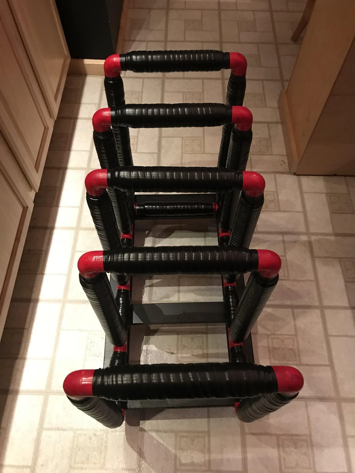

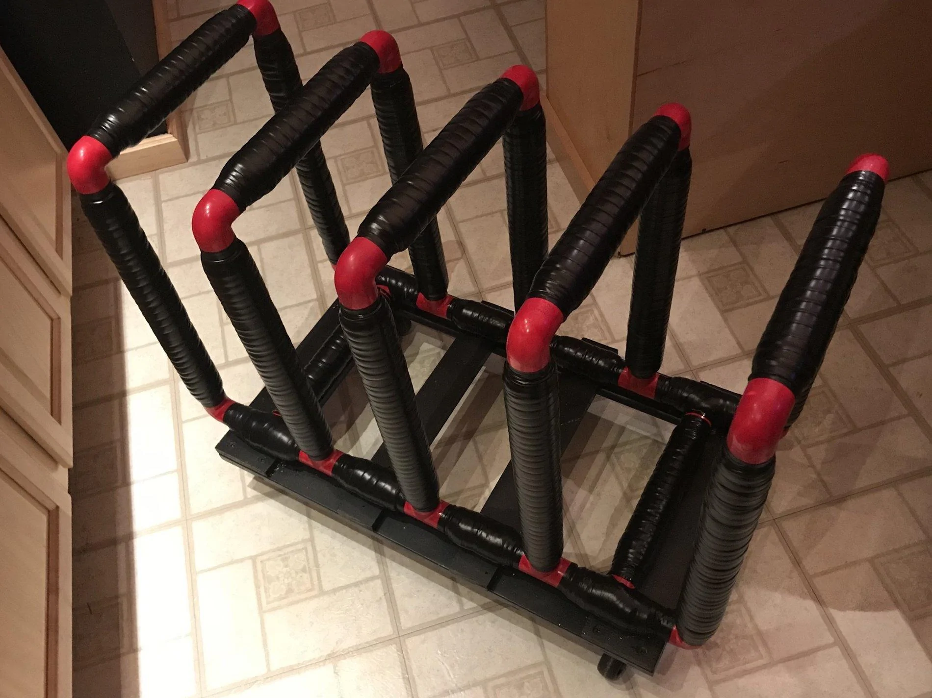

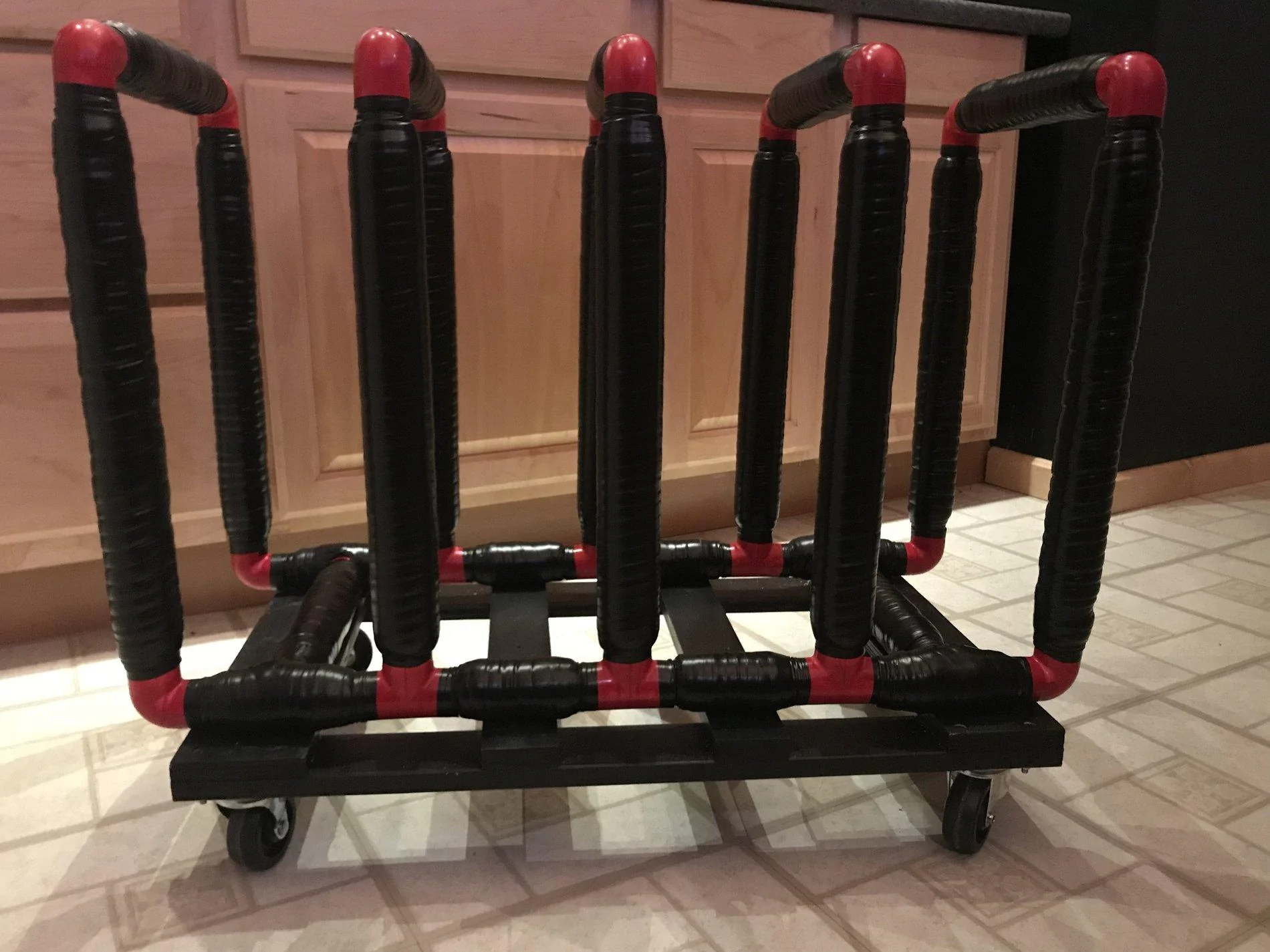

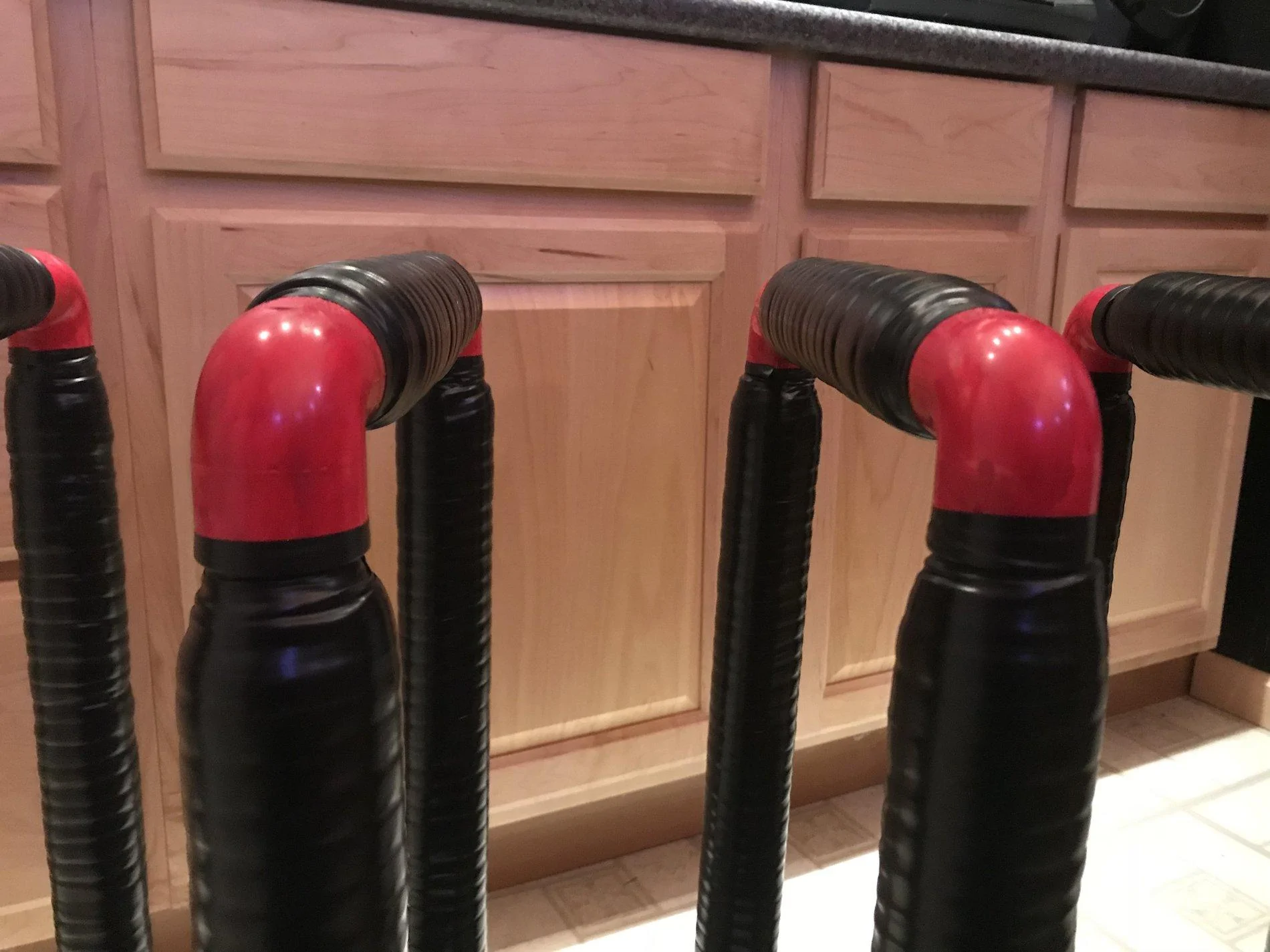

Thanks guys for the plans and pictures. I combined what you guys did with a craft project my daughter found to stain pvc pipe. I stained all of the connectors red to match the red accents on the Jeep. I probably wouldn’t have paid for the petroleum dye just to do this, but since I already had it...

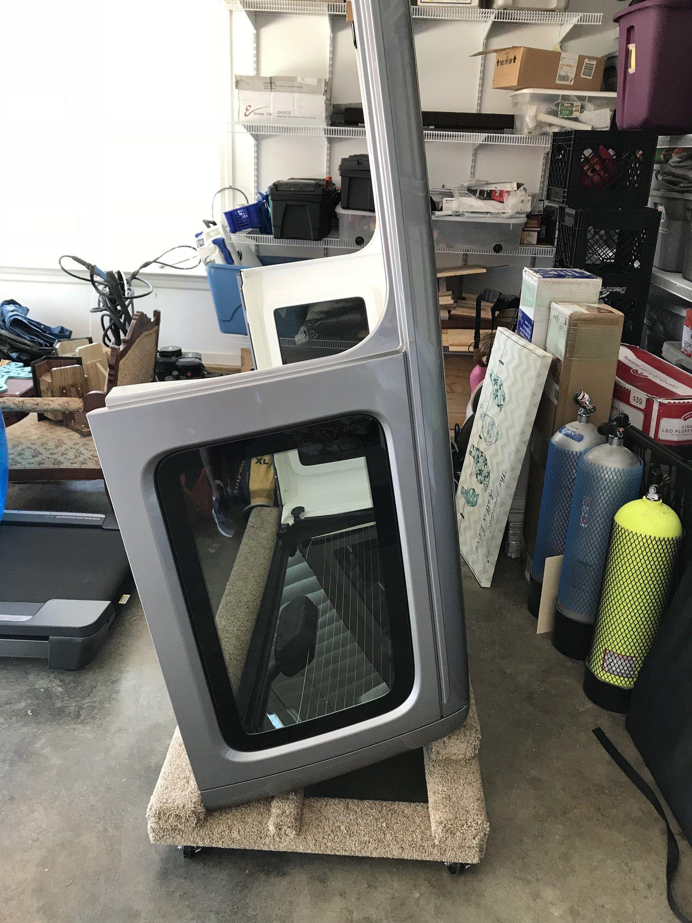

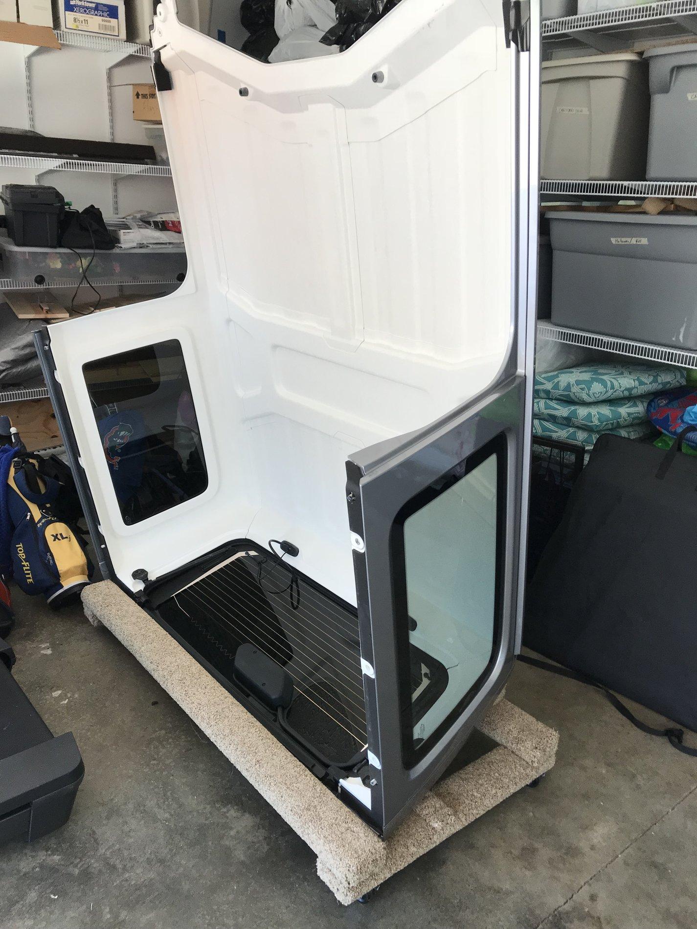

Just wanted to show the completed cart in action. Works great! Only problem is, I learned on Sat that my wife is not capable of helping me take the top off. So me be installing a hoist. If I do I’ll have a cart available for someone
I'd be willing to buy you a hoist for that cart you made.

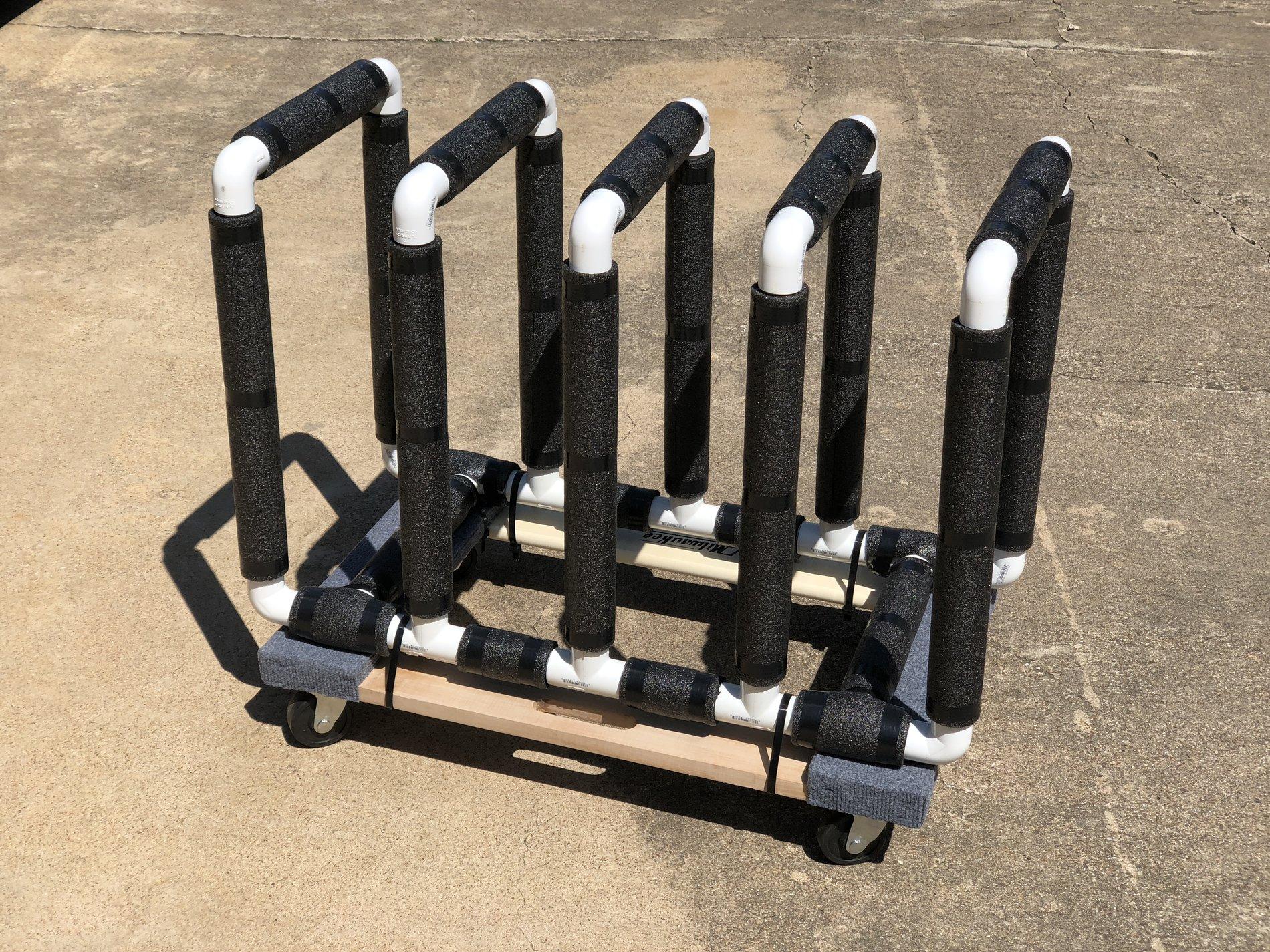

Here's my printable DIY Instructions for building your own Hard Top Cart based off of @Texas_Yote 's build and an updated Door Holder Cart based off an outdated "Instructables.com" build. Basically $165 Total for both carts! You save money and have your own touch on it! I was about to drop $200+ on a hardtop cart alone until I found Yote's thread https://www.jlwranglerforums.com/forum/threads/hardtop-cart.6581/#post-150265
This one they have on the internet for sale. its nice to. i like how everything closes up doors and all
To update the door holder I’d do 3.5” sections and 7” sections to give your doors a bit more room to fit into. It’s a bit of a squeeze with 2.5” and 6” sections.

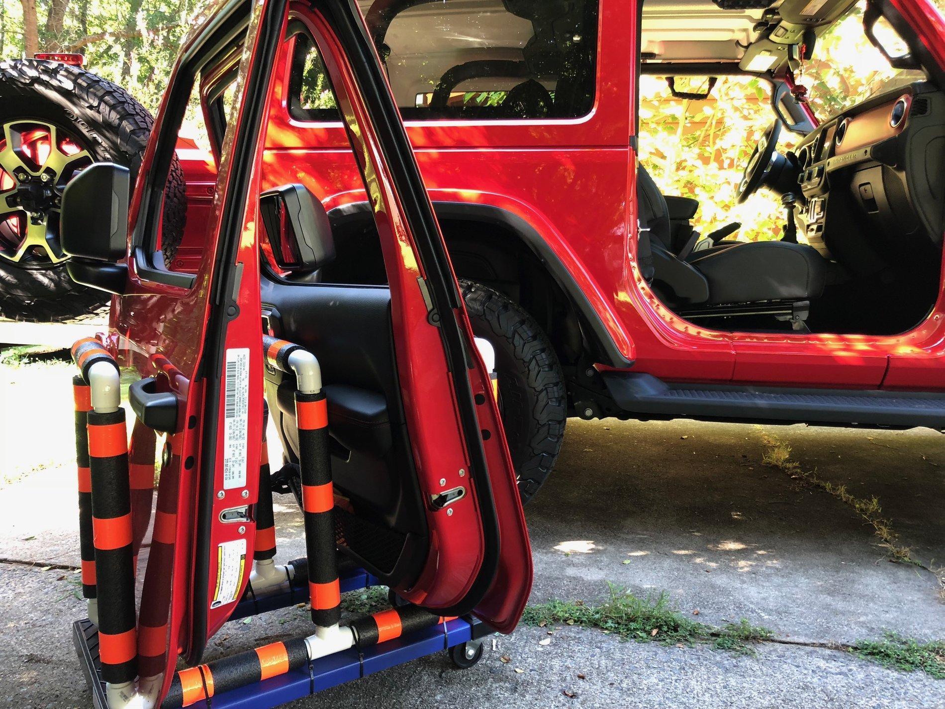

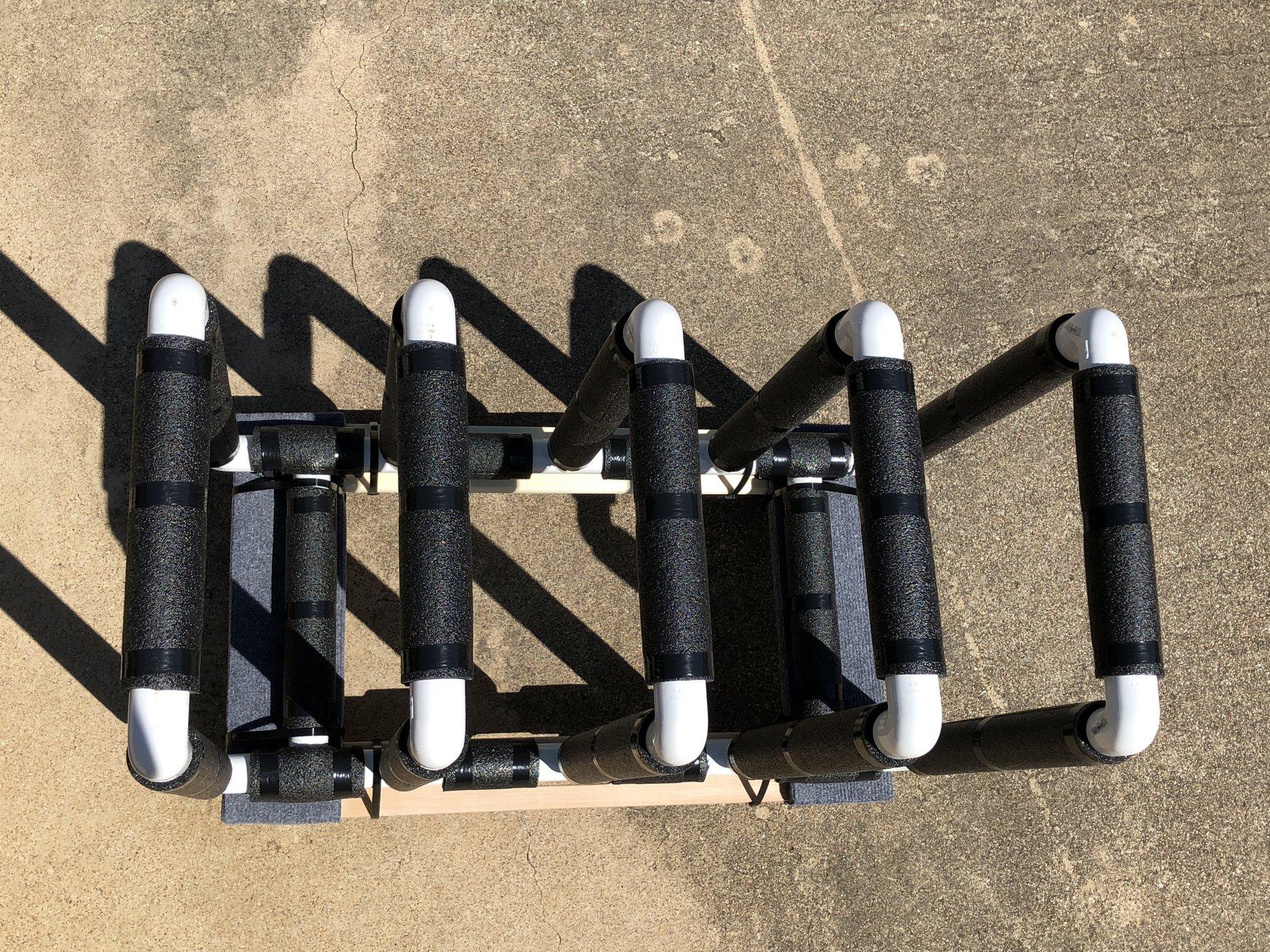

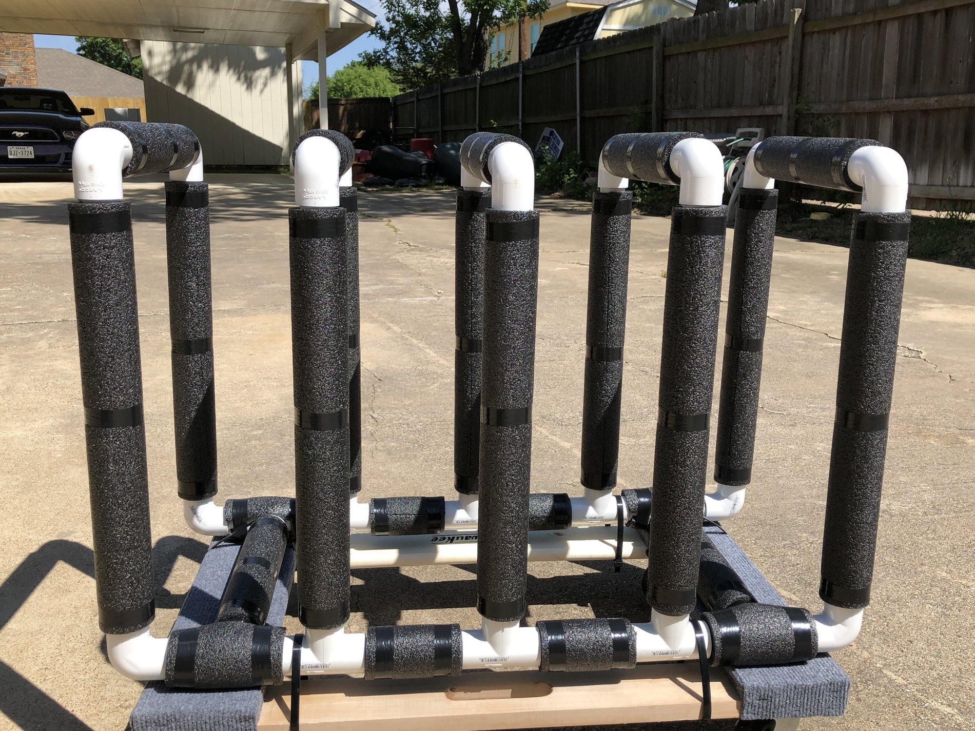

Just finished up the Door Holder Cart build!
Ended up only using 4 Foam Insulators instead of the five I bought. Also used Eight 24” Outdoor Zipties to secure the holder to the furniture dolly.
You, sir, are a true man among men. I'm a first-time Jeep owner and haven't removed the doors or top out of fear of damaging them. Jeeps are expensive Lego sets, and this is a great project. Thank you for the brilliant ideas.
Nah I just merely organized them together :like: make sure to double check my first post as well. The build instructions were originally for JK doors and the JL doors are a a few inches wider. Other than that, they’ve helped a lot and save the extra money for other things ;)

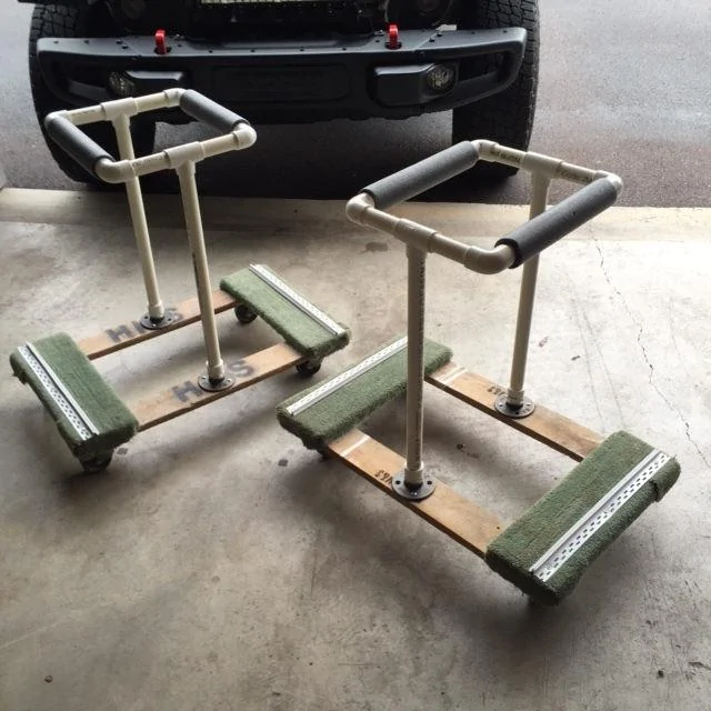

Here is my homeade door carts. This way I can wheel one on either side and just lift off the doors onto the cart.

Thanks but honestly I got the idea from a guy on the JK forums. I just modified it a bit for my liking.

Used door cart for the 1st time today. Yeah the arm rests are wider on the JL so its a tight fit, but that being said its perfectly usable for me; but if you have not build one yet, give each slot another 1-2 inches in width.

Finally got around to it... Just as good for 2 doors; less material to buy.

Thank you. All credit to you, my good man. I’m not creative enough to come up with such ingenuity. With 2 doors, i saved a l’il bit.
