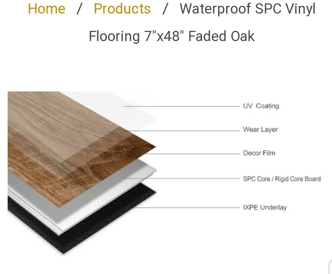

Try using hard wood plywood and waterproof laminate or vinyl flooring over that. Waterproof flooring has strong composite core.

If you go the vinyl route, don’t do the peel and stick. It’ll separate with temp changes.
