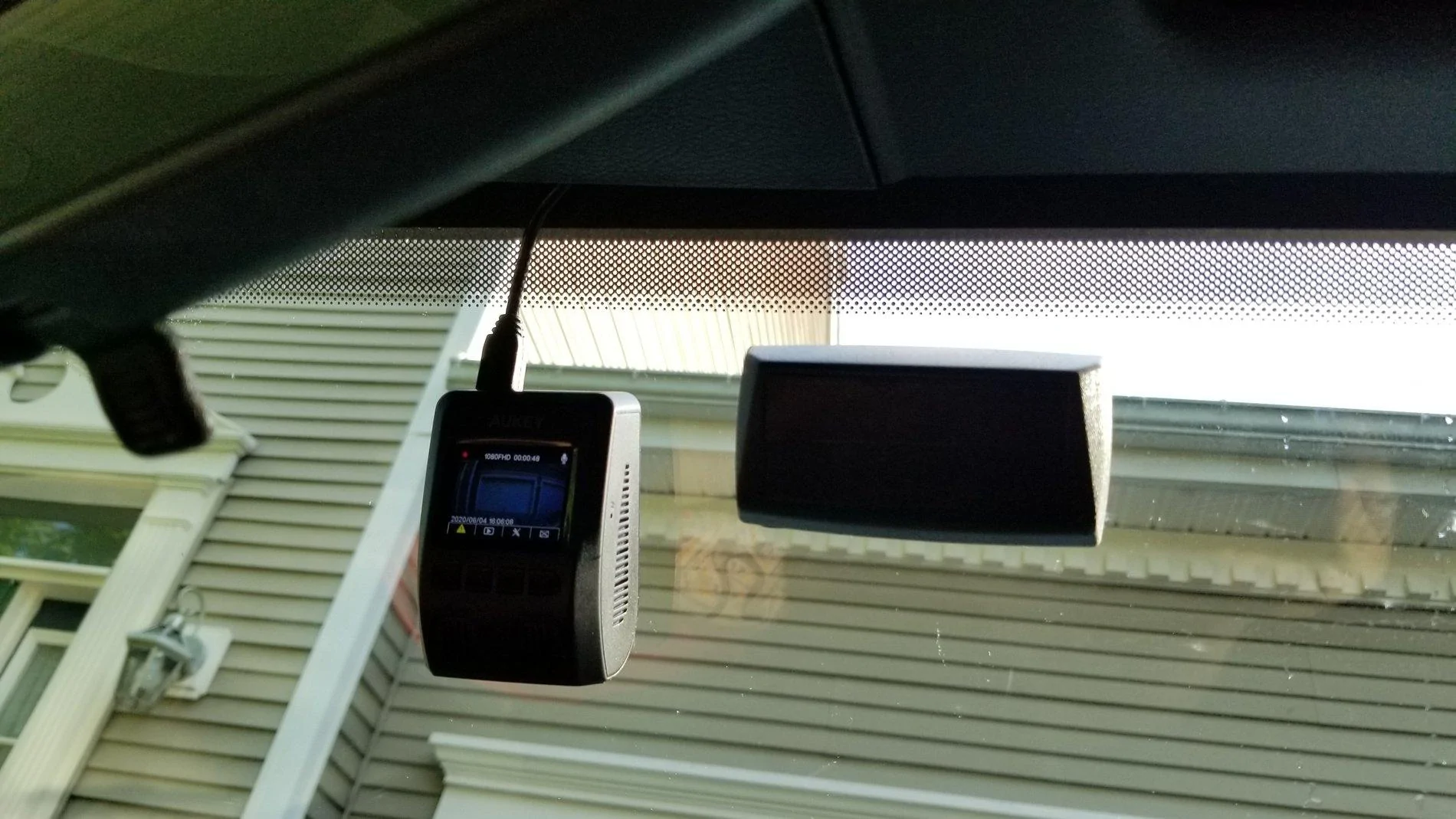

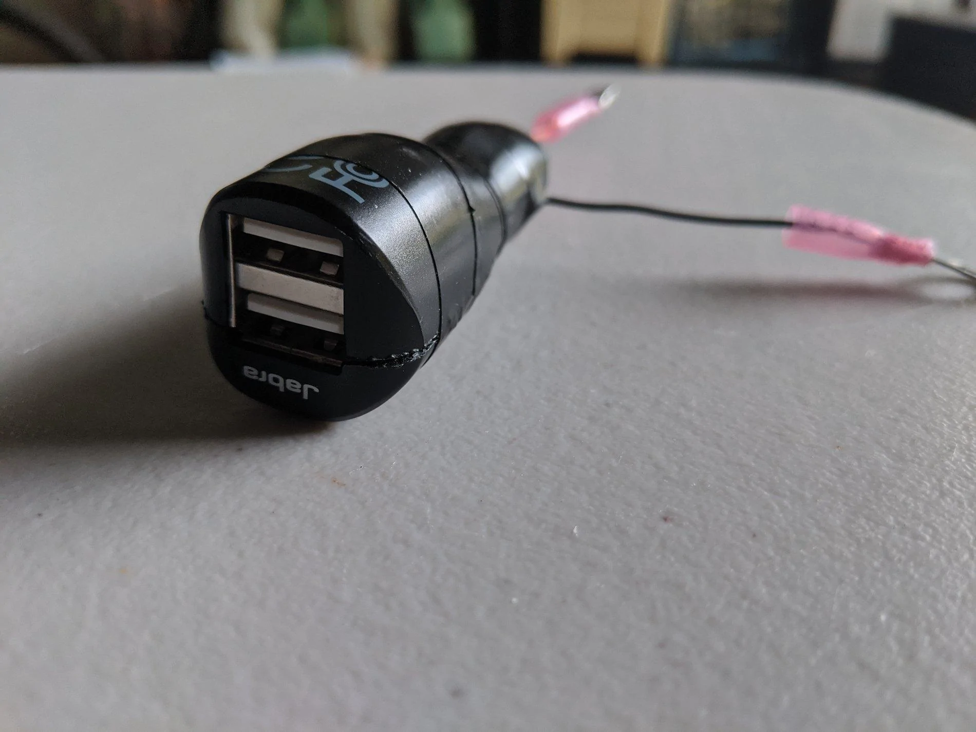

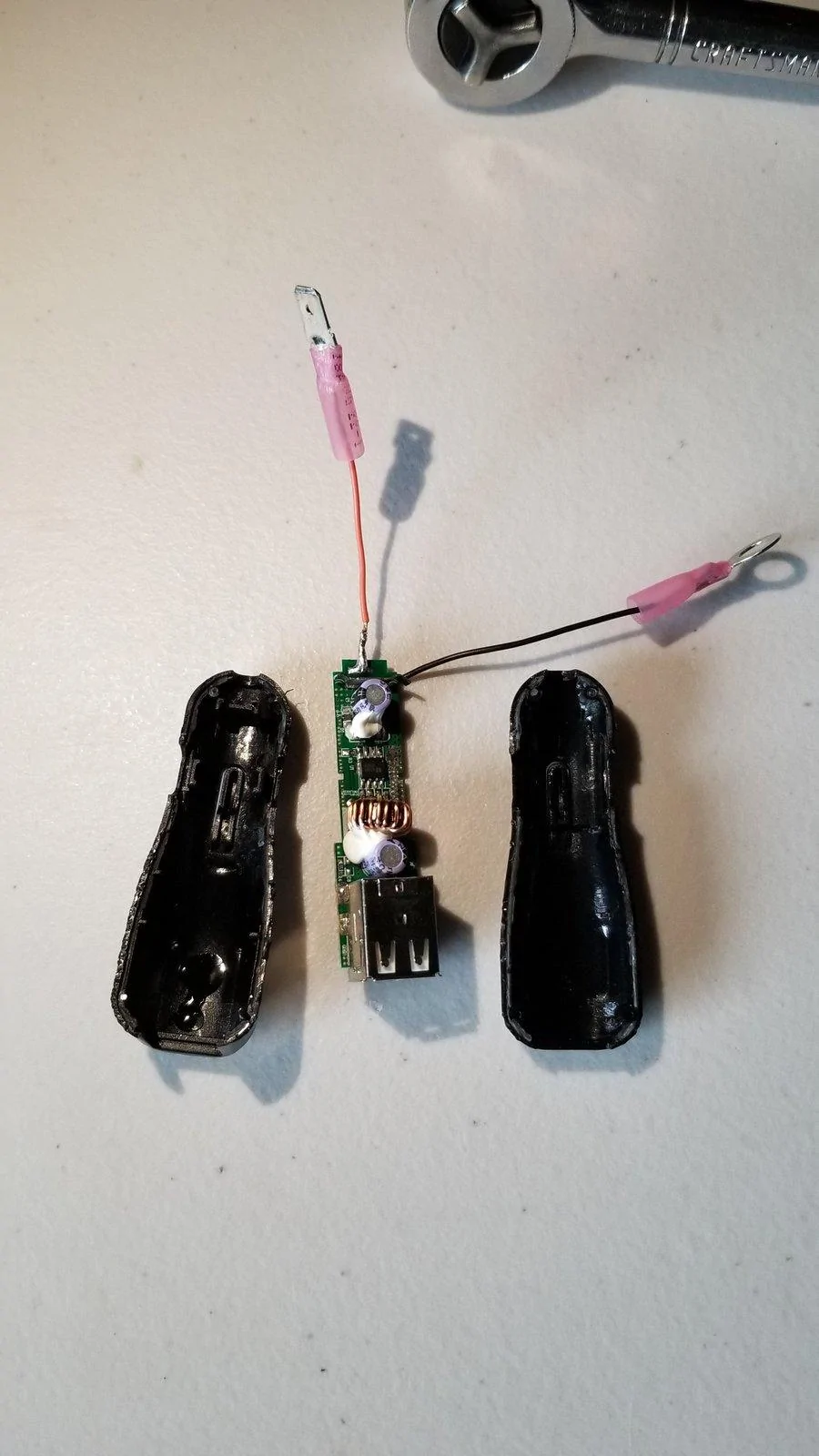

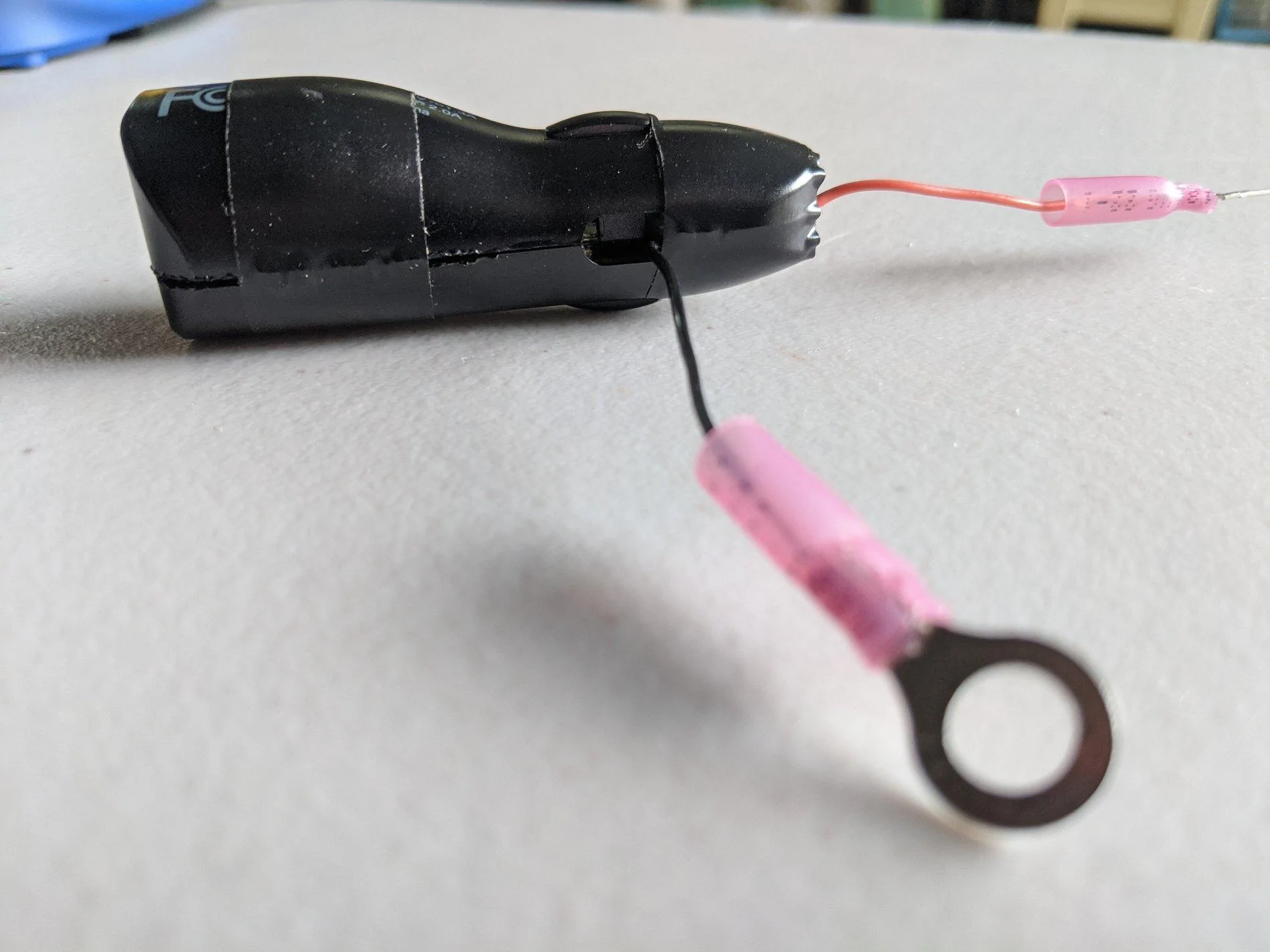

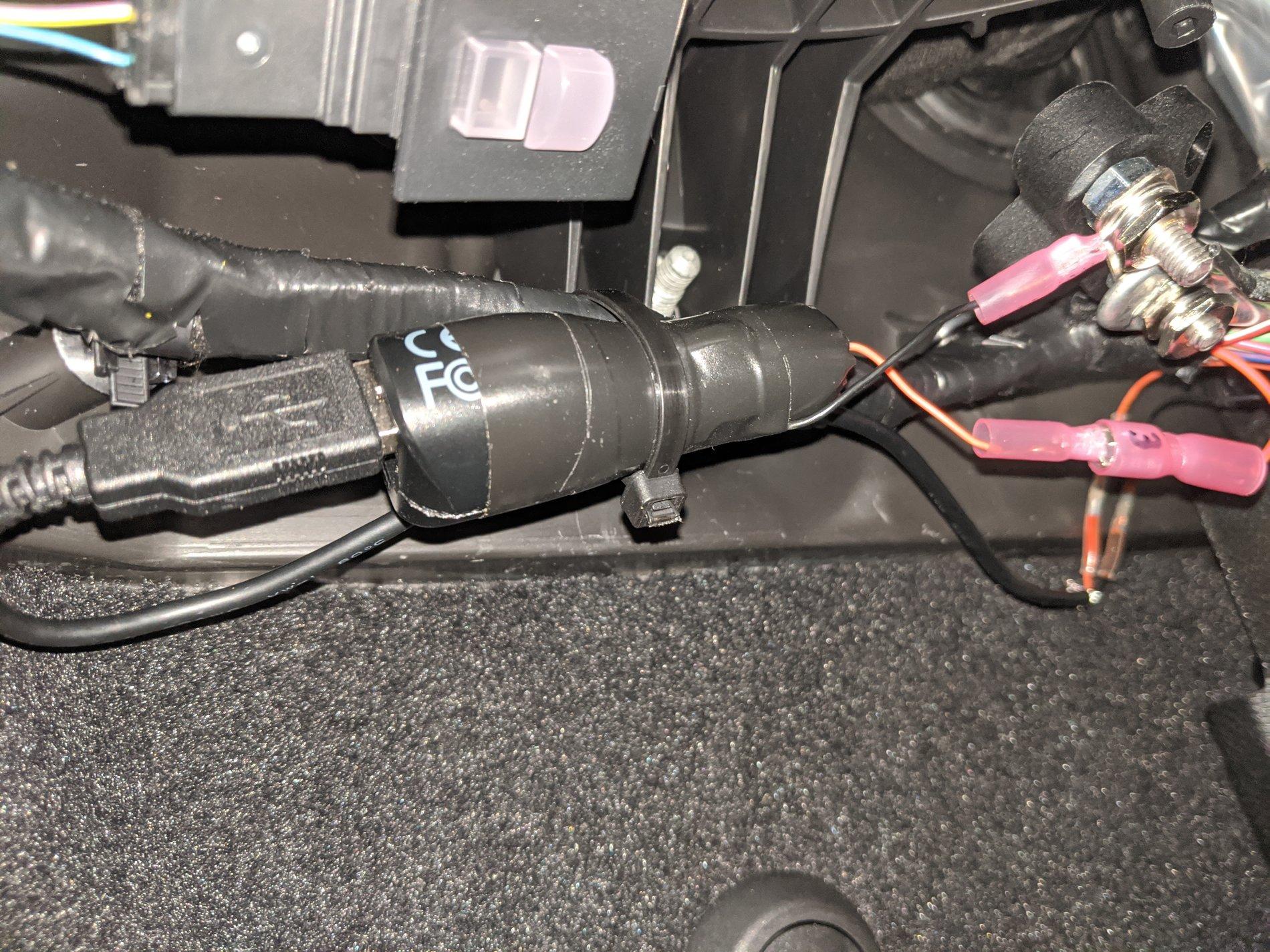

I was shopping online for a dashcam hardwire kit to use with one of the OEM Aux switches. My son suggested that we use the long USB cable that came with the dashcam and cannibalize an old car charger adapter to use as a voltage regulator. A couple of solders and crimp connectors later… Success!
