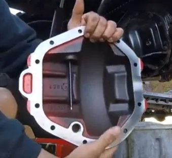

The Dana/Spicer cover still has a square area on it that bugs me. Honestly, I think ARB might have the best all-around design when considering both flow and protection of the bolt heads. They are just a bit more expensive.
Here's the inside of the ARB:
From:
