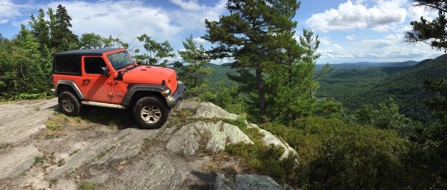

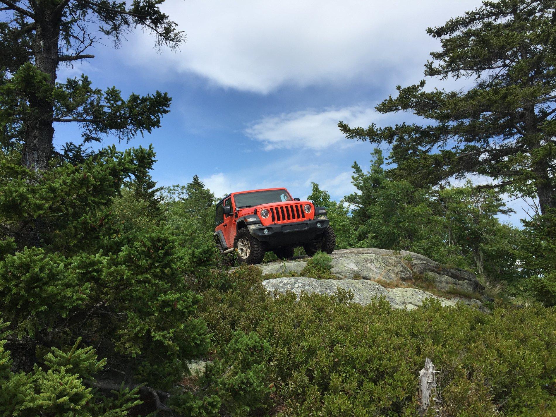

Brake lock diff function works in 2WD, 4H, and 4L. The button shuts off traction control as does 4L, but BLD always works. The traction control function is separate and reduces power when it senses one axle is spinning faster than the other and the spinning is detected to be excessive as compared to actual speed. Thats why you want it off in deep snow or in sand to keep the power from being reduced and it does not detect what one axle is doing compared to the other. The only use for traction control being on is in rain or packed snow and ice. Oh and I just went up a steep trail today in my Sport with no LSD. Over 5 yrs ago I did the same trail in a Rubicon and needed the rear locker to get up it (even though it had a LSD rear also).. Well I can say my Sport climbed it just fine. The only difference is technique.......when one tire starts slipping/spinning you just keep the throttle the same and if nothing changes.......gradually increase throttle and it will start to go.......worked beautifully as well as the hill decent feature and you don't want to lunge ahead abruptly in a spot like this.
Jeep Wrangler JL Didnt get the anti-spin diffs.. 50 percent copy
Jeep Wrangler JL Didnt get the anti-spin diffs.. 70 percent copy

Love the picture:like:

Very nice. Where is that?
