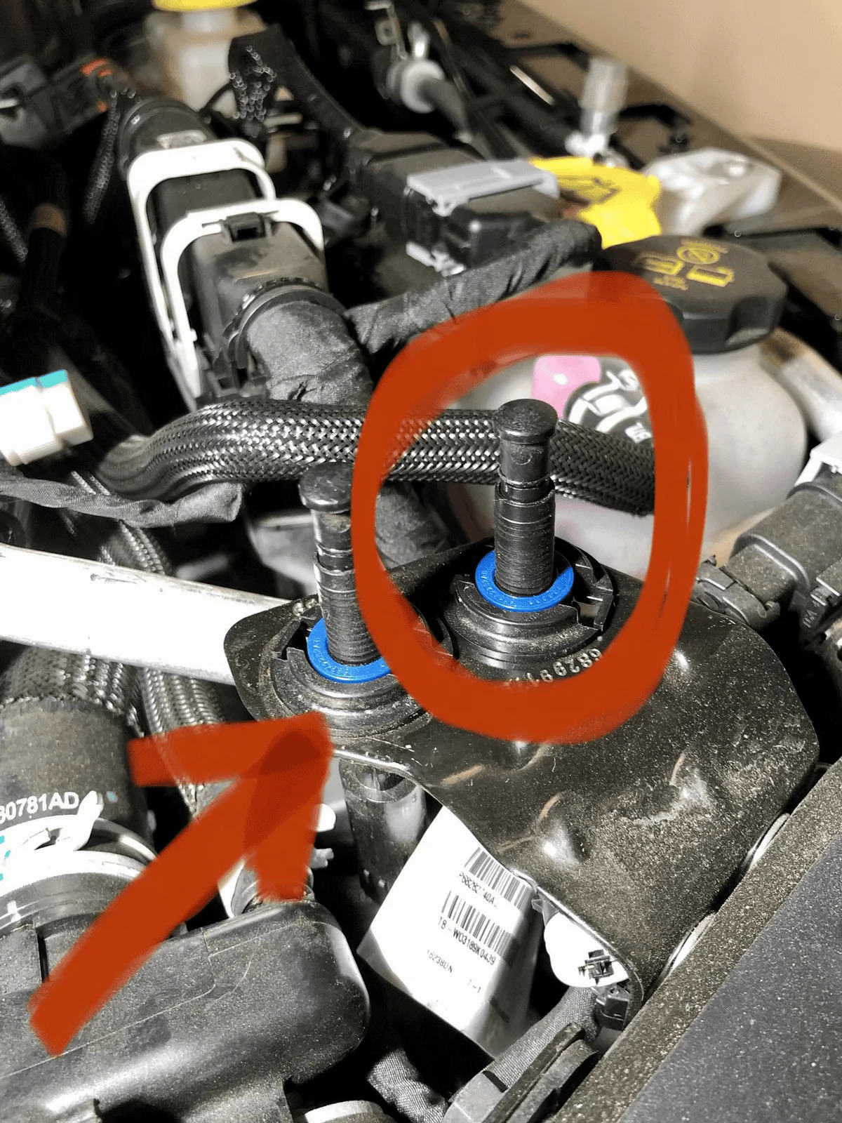

Careful there lil buddy.
so says the messenger (you) to the reporter (me) ...you're reply above: my prior implied thoughts exactly, which you're giving back to me....:movember:
Edit:
Here I was thinking you were referencing these blue components for funny double meaning.
Edit:
Jeep Wrangler JL Devices to bypass auto stop/ start 1609264264544
I totally forgot those were blue! Ha!
I dont see why anyone pays for something to turn off ess when pulling that lil bugger is free... oh well.
The only issue I had with this, is the error it displays on the cluster. It drove me nuts. I bought a taser, best thing ever.

Agreed, quite a few people are bothered by the warning light.
Also, some people want the capability to turn the ESS feature temporarily back on at times from the cabin, such as in heavy stop and go traffic, where it might actually save a measurable amount of gas.
Good option! That does the job.
Per my prior posts, I put a trailer light tester in the wiring connector on the Jeep and the computer reads it that I am towing. It disables ESS automatically and there is no error message. Works fine so far, so if a vehicle has a hitch/wiring connector it is another option. ;)
