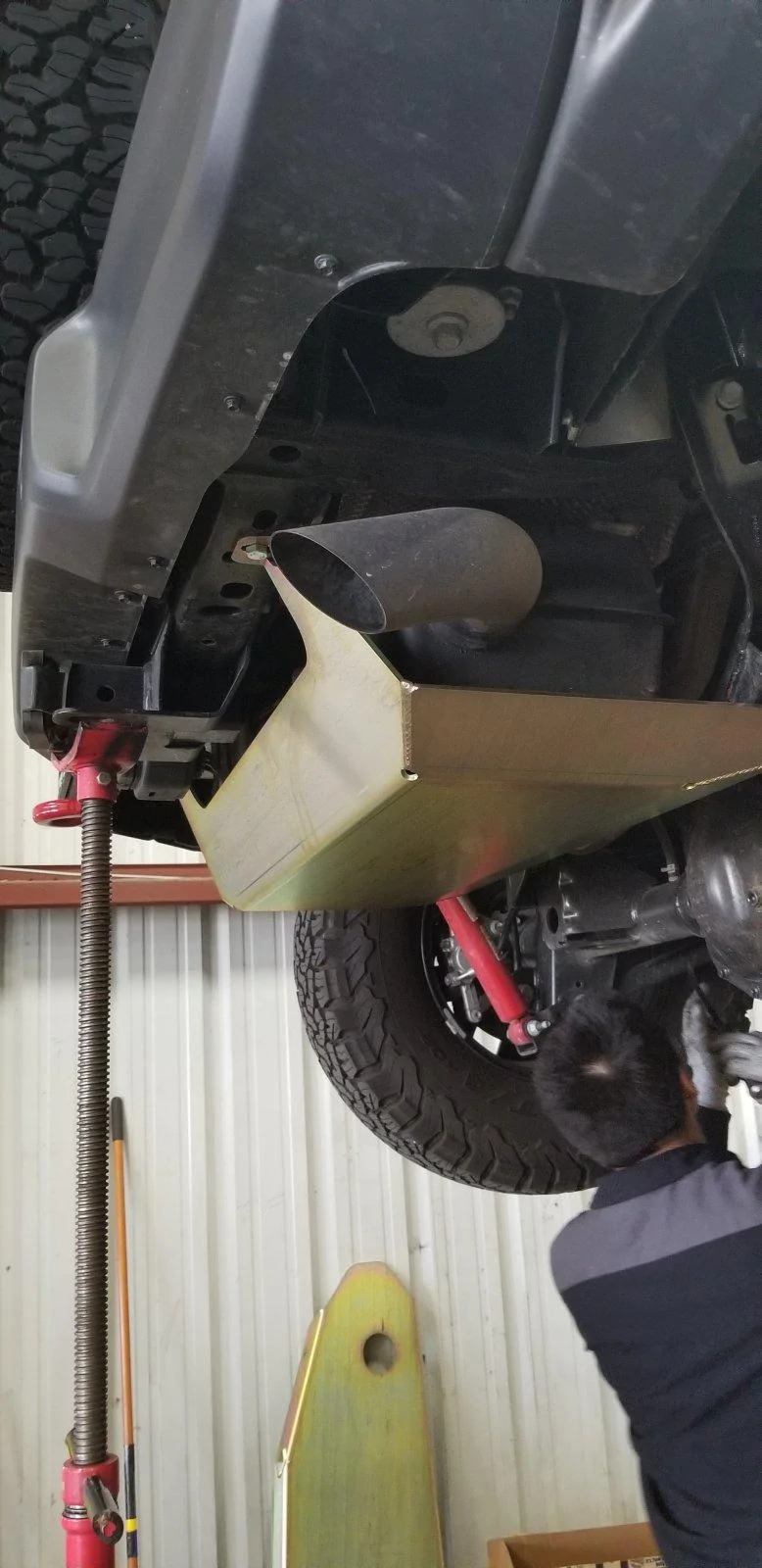

I have pretty much covered everything under the jeep. I have full Metalcloak underarmor, Rock Hard LAC skids, FAD covers, front and rear diff skids.
I have been on several trails and have hit the skids pretty hard as well as the rock sliders. Because I have so much protection nothing is damaged. One important thing to consider is when you go over an obstacle and the rear tires drop off, the DEF tank is extremely vulnerable to damage. This is why I opted for the MC covers.

I am not sure how much the skid weighs. I can easily lift the cover so I am guessing around 40 pounds or so. To me the weight isn't as much of an issue as making sure the tank is protected. The skid has several scratches from sliding over rocks. The stock cover looked way to fragile for me. Remember, the MC skids go on top of the factory plates. Double protection if you will. My primary concern was to protect the underbelly of the jeep first. Next comes the lift and 37 inch tires.

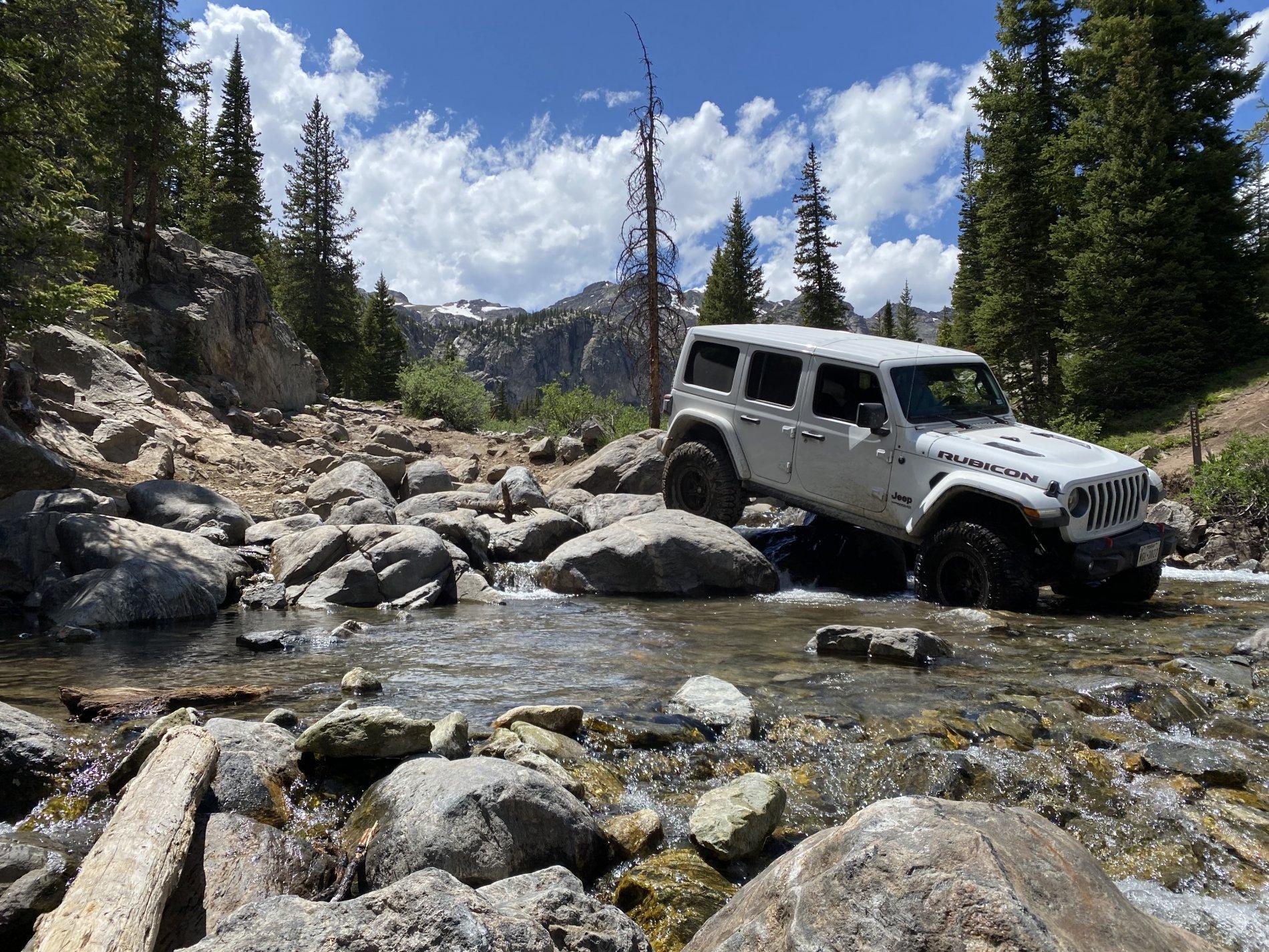

I’ve had mine EcoDiesel since March 14 of 2020 and it currently weighs in at 5400 lbs. I’ve taken it on 6 or 7 trails in Moab and Colorado, and it has more than 20k miles.
The Exhaust emissions crap clears most every thing, but yes, it is vulnerable to some smashing. For the most part I take it easy on the trails, but when I meet up with people out on the trail, I typically gain a little confidence and push the limits.

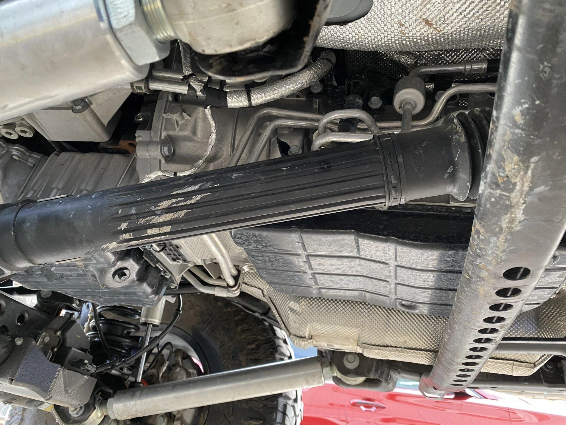

The only real trail damage I’ve gotten was on the Mountain of the Holy Cross trail. I meet some friendly Jeepers who welcomed me to tag along. At the time I had 2 issues working against me: 1st, I was really loaded down with gear, and 2nd, it still had the 3.5 inch lift springs in the rear, which sat 1/2 lower than the front. With this setup, the front, trans skid, got some light scraps on it, however, about where the T-case skid is and to the rear scraped on quite a bit. A misjudgment on my part almost killed the front driveshaft. And of course the rear bumper dragged over just about everything coming down off obstacles.

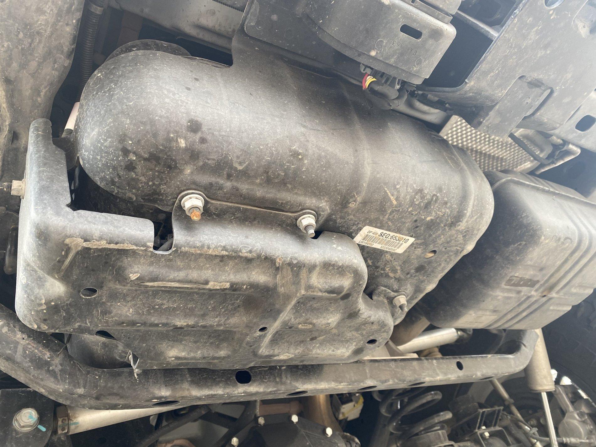

As Far as the DEF tank and stock skid. I was surprised at how little it got scraped. The stock skid seems pretty tough, and may be sufficient for a lot of wheeling.
In my opinion, I’d recommend full skids (either aluminum or steel) for anyone wanted to do a trail rates at a 7 or higher. 6 or higher to be on the conservative side. If this doesn’t sound like anything you’re going to be doing, you’re probably good without the full skids. There are a lot of trails with a lower difficulty rating that are still a blast to go on, and with some patients and a good spotter, even some tougher trails can be done without damaging critical components.

A word of caution. The DEF tank is behind the rear axle and wheels. When you go over a shelf the rear of the jeep will drop. Without a decent plate over the tank, you risk serious damage. I have impacted the skid plate to many times and the piece of mind that comes with the protection is, to me, priceless.
