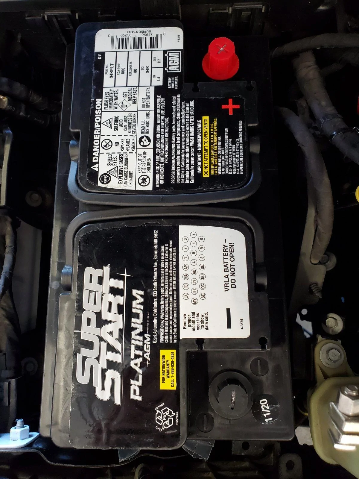

This is the battery I ended up purchasing, cost me $200.
