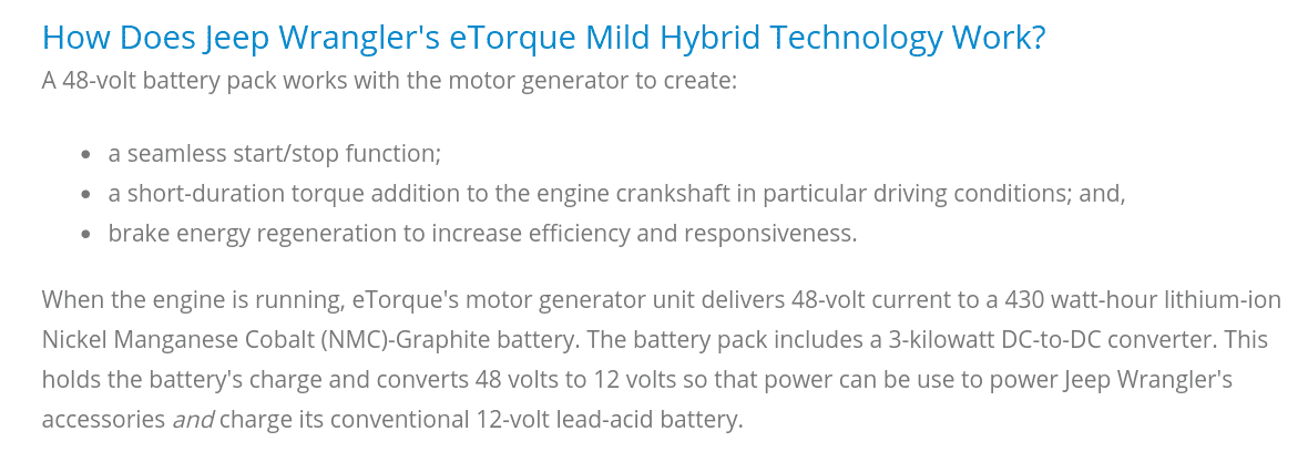

Woke up to completely discharged 12 v battery on etorque 2-door. I believe the Jeep was left in reverse when turned off last night. Why would this drain the 12v battery ? and why did the 48v battery not start the engine? Charged the 12v battery and all appears normal (if that term can be applied to this vehicle).
