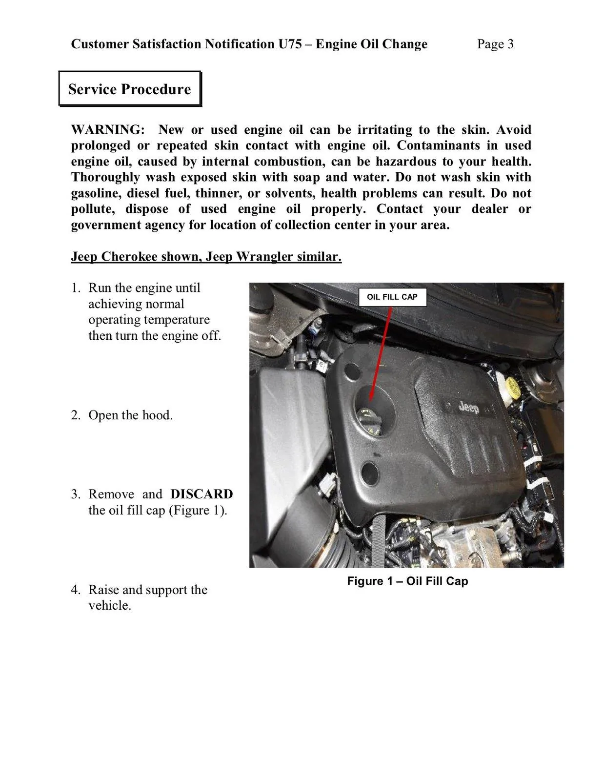

5w30 Pennzoil Full Synthetic .... Makes me chuckle.

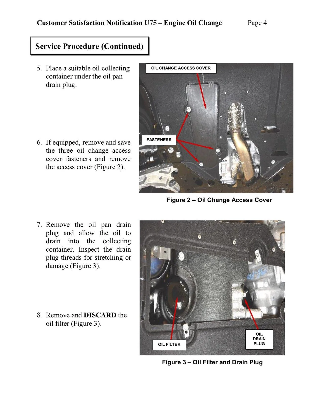

Notice the oil filter style... and drain plug location... Oh my......... well, at least it's 5 quarts like the 3.6L and not 6.

Yeah, I'm a little surprised at the drain plug location. Is that panel a skid plate, or just a plastic cover? Dexos 2 would also cover this issue, but no way FCA is going to plug for a GM certified oil in their engines. God forbid it would be a Mobil 1 product. Lol!

Why the chuckle?
Also, whats wrong with the drain plug location?

First 2.0, I come across I will be eyeballing... Not sure whether skid or what. but... looks like plastic to me.
I prefer the oil filter up top versus down under also. I like the paper cartridge filter and it's location in regard to the JK and JL.
The pictures are of a cherokee. That pan cover is probably not on the wrangler.

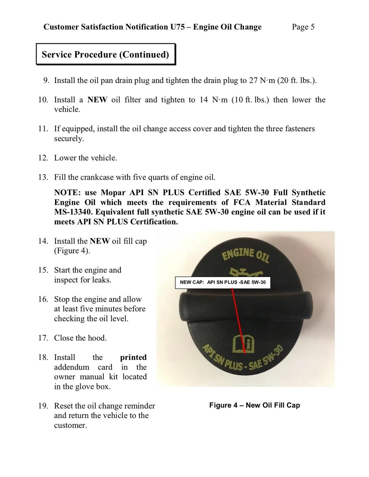

Btw, 2.0 owners, don't fret. This is exactly the engine that API's SN-+ and GM's Dexos 2 was designed to cover. It will run fine with those oils and should not experience the detonation. This is a very high performance engine and this is what I've talked about in other threads where the chemical engineering of oil is very advanced and is continually improved as engine technology and requirements, including higher fuel economy, are changed.

Drain plug location. Not my problem, but I do not like it in comparison to the JK or JL 3.6L location of that plug. And if there is an access cover plate that you have to remove and a plate with cover hole (the cover fastens to) that may get crapola in and...... Jury is out til I actually see a 2.0's..

They are. I think they just had the previous SN formulated factory fill and not the SN+. Easy mistake to make, and SN+ has only been out a short while. I'll try to explain why SN+ and why the issue, later. I'm using my phone and working late, so no time to go to that detail. The SN+ should cure it, though.

Here ya go...From Pennzoil.com. Also, GM's Dexos 1 Gen 2 specification addresses this, as well, so an oil with that designation should solve the problem, too. Italics are in place of quotes...
  • The API SN PLUS motor oil specification is intended to complement API SN and ILSAC GF-5 and aimed at addressing the increasing impact of Low-Speed Pre-Ignition in Turbocharged Gasoline Direct Injection (TGDI) engines.
  • The high pressures from turbocharging combined with direct fuel injection into the combustion chamber in these smaller TGDI engines makes them susceptible to a phenomenon known as Low Speed Pre-Ignition, or LSPI. While the mechanism of LSPI is not yet fully understood, research has shown that motor oil properties may be a contributing factor. Automakers can mitigate LSPI by adjusting the engine operating conditions, but in doing so inhibit some high efficiency engine operating conditions.
  • Amid growing concerns about LSPI among Automakers, the urgent need for a supplemental motor oil specification became evident. This new supplemental specification, known as API SN PLUS, includes the testing protocol for API SN and a special test for LSPI, the API Sequence IX test.
Don't rush to blame FCA on this one. It very well could be SOPUS (Shell/Pennzoil) that screwed up by sending the wrong oil, or even a mix up at a distributor. The supply chain is a very complicated ballet that can be compromised by something like this...a brand new oil spec hitting the market at about the same time a brand new engine with new tech hits the market. I wonder if the delay in the 2.o was not as much due to that fire issue as much as availability of SN+ oil, or a combination of both? Who knows? Anyway, the solution is as close as your local Wal Mart's oil shelf, or your dealership. I'd go with Wal Mart because I'd bet some dealership tech's know very little about this new oil spec and why it is necessary.
