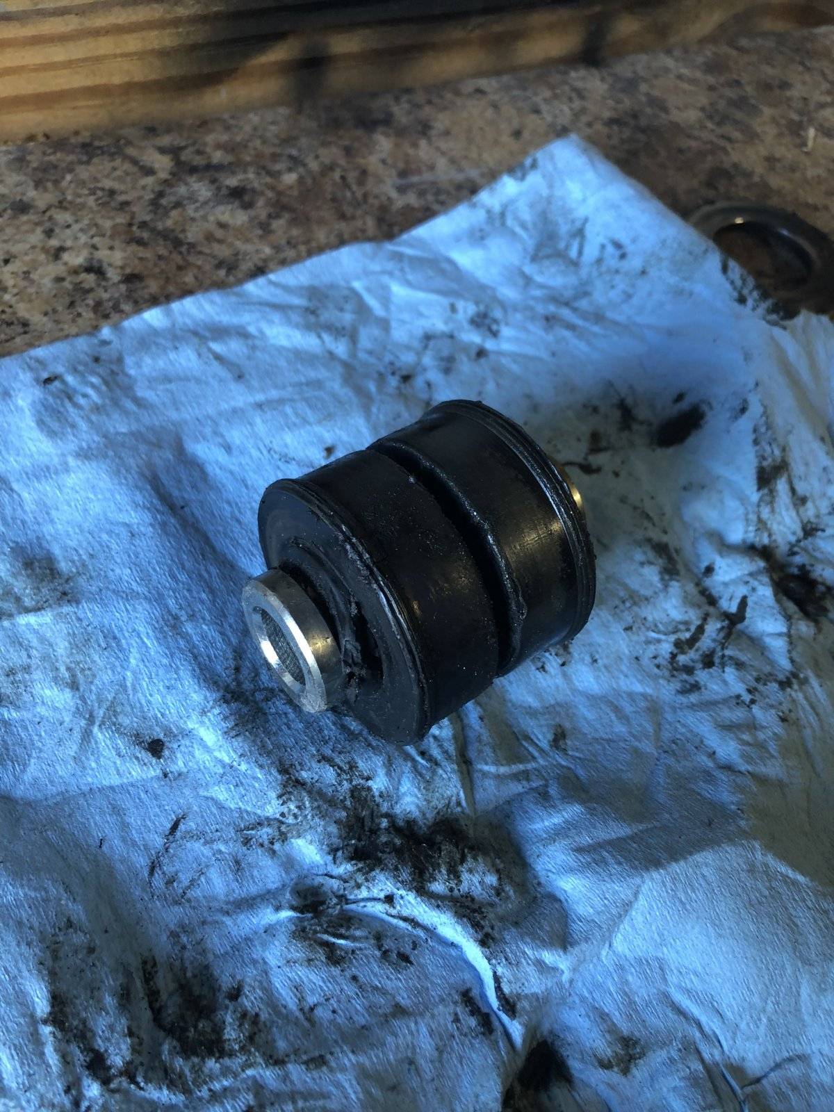

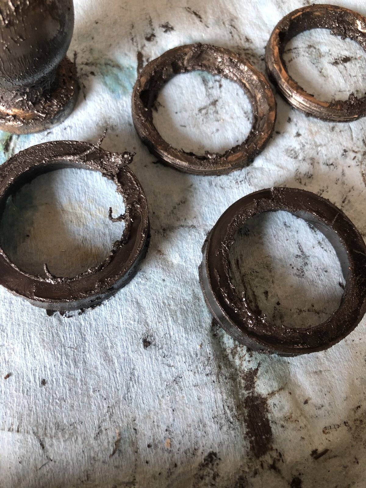

On a trip to town this morning the rear axle was moving around like crazy. Every stop and acceleration I could feel the axle moving back and forth.

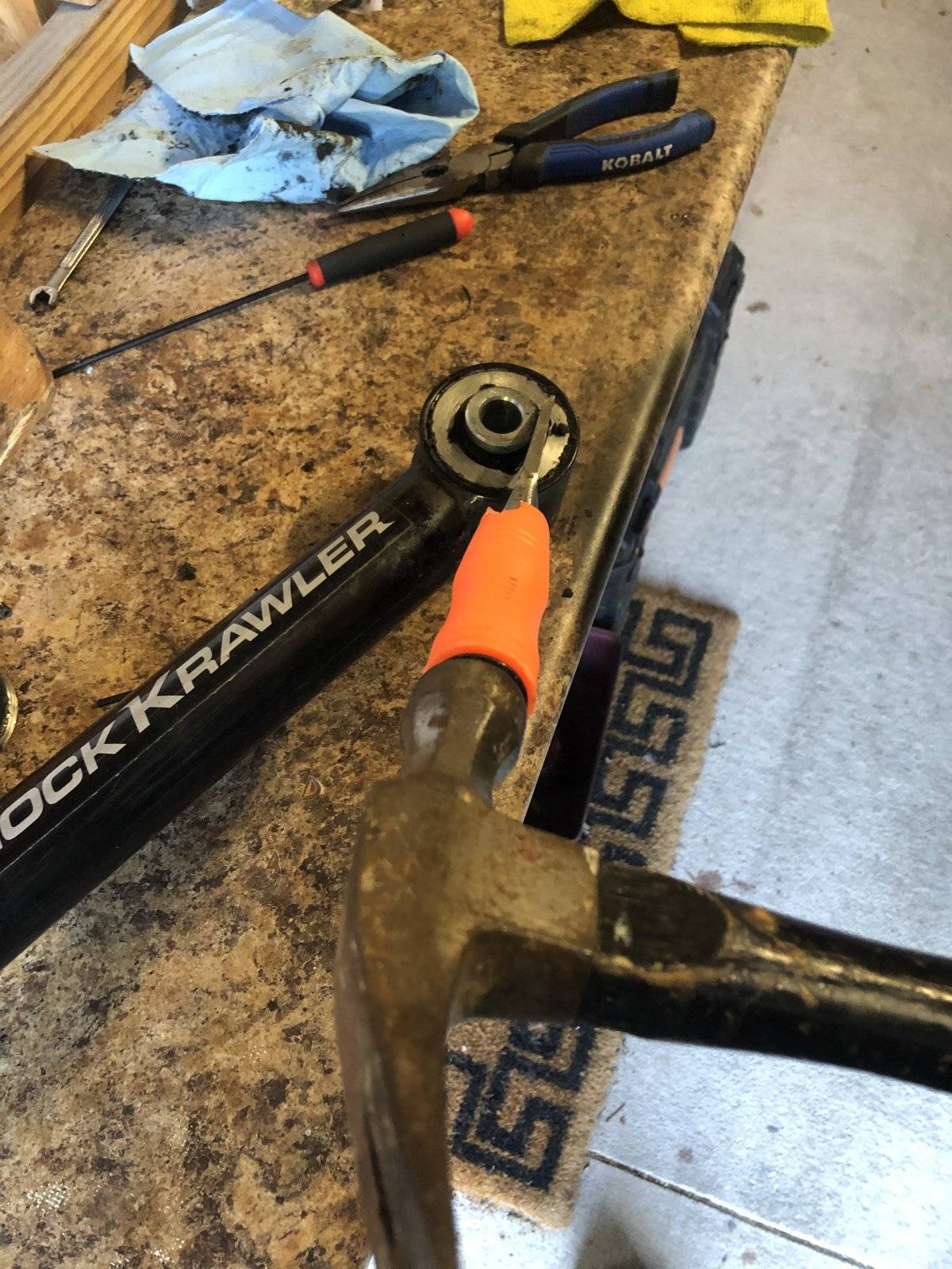

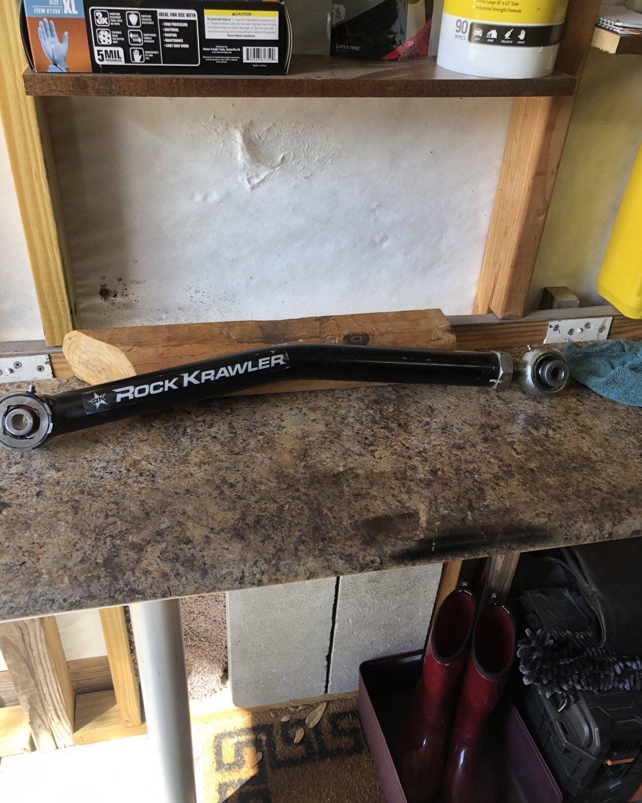

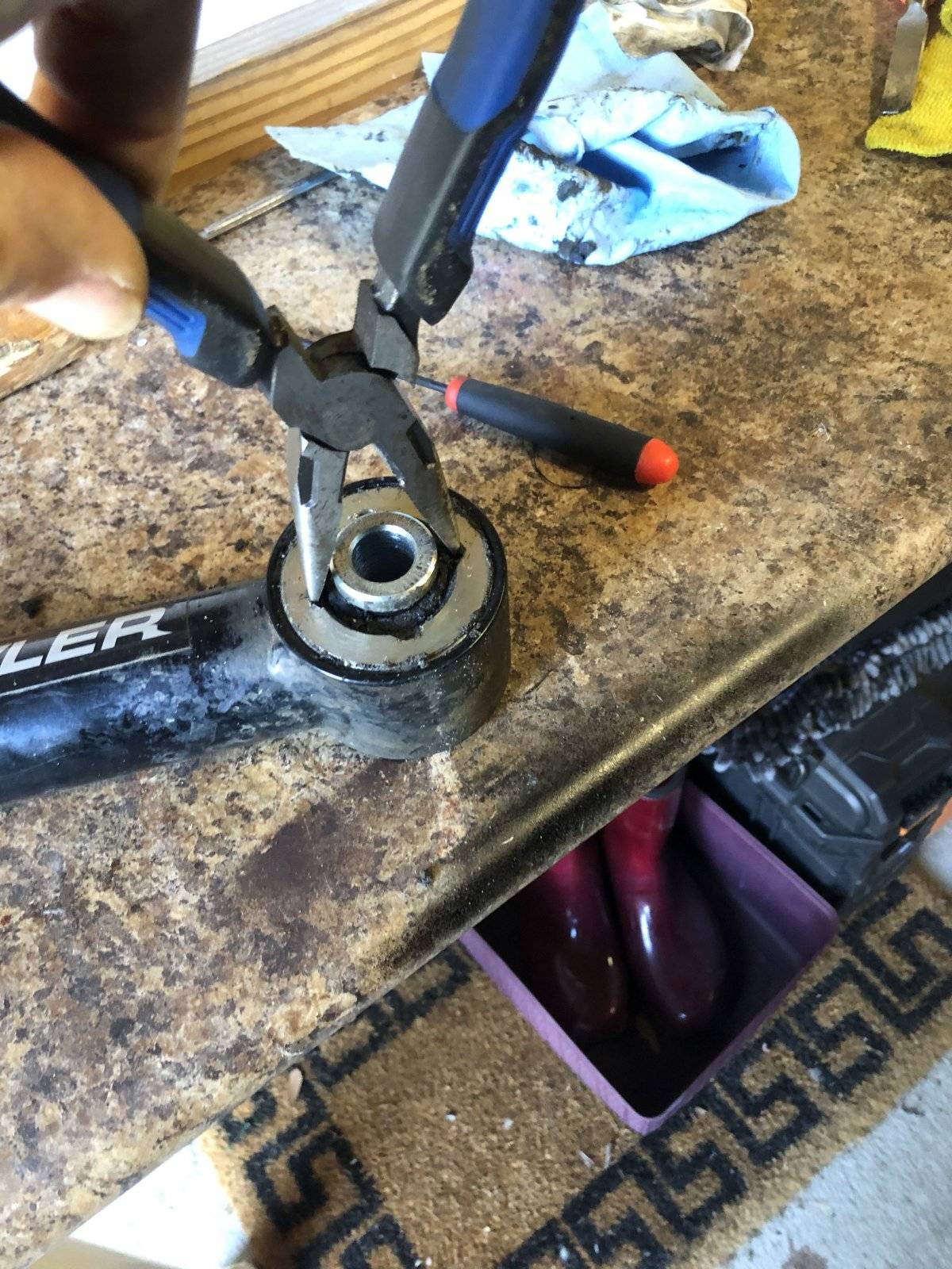

So when I got home I decided to tear into my rear lower control arms which are my number one suspect. I’ve been waiting on a spanner tool to take the retaining washers off with, but who knows when its gonna get here.
It sucked but I used a hammer and screwdriver to take off the retaining washers , once I got them off, things got easier. The bushings were so bad all I had to do was push them out with my thumb.....:facepalm:

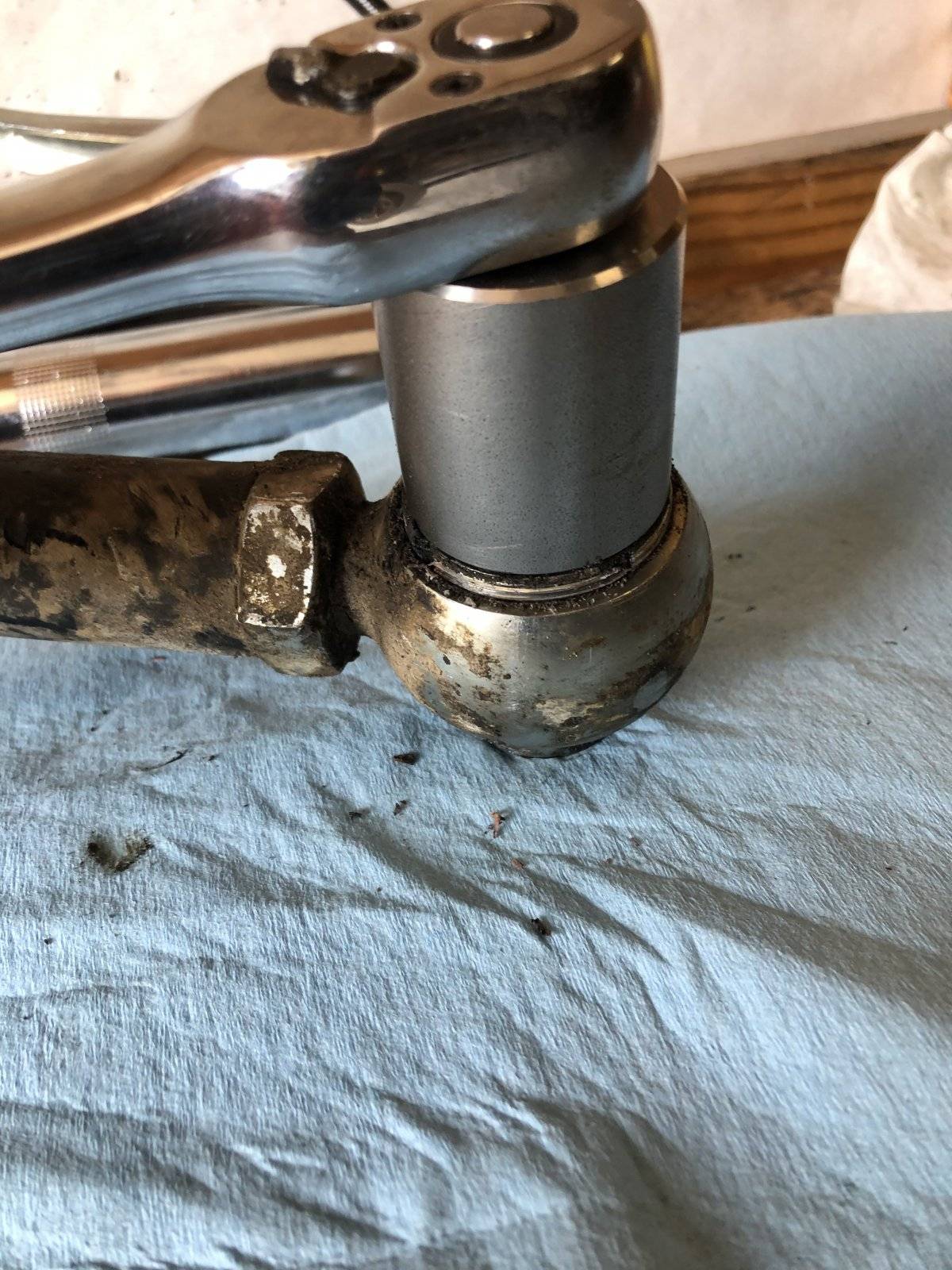

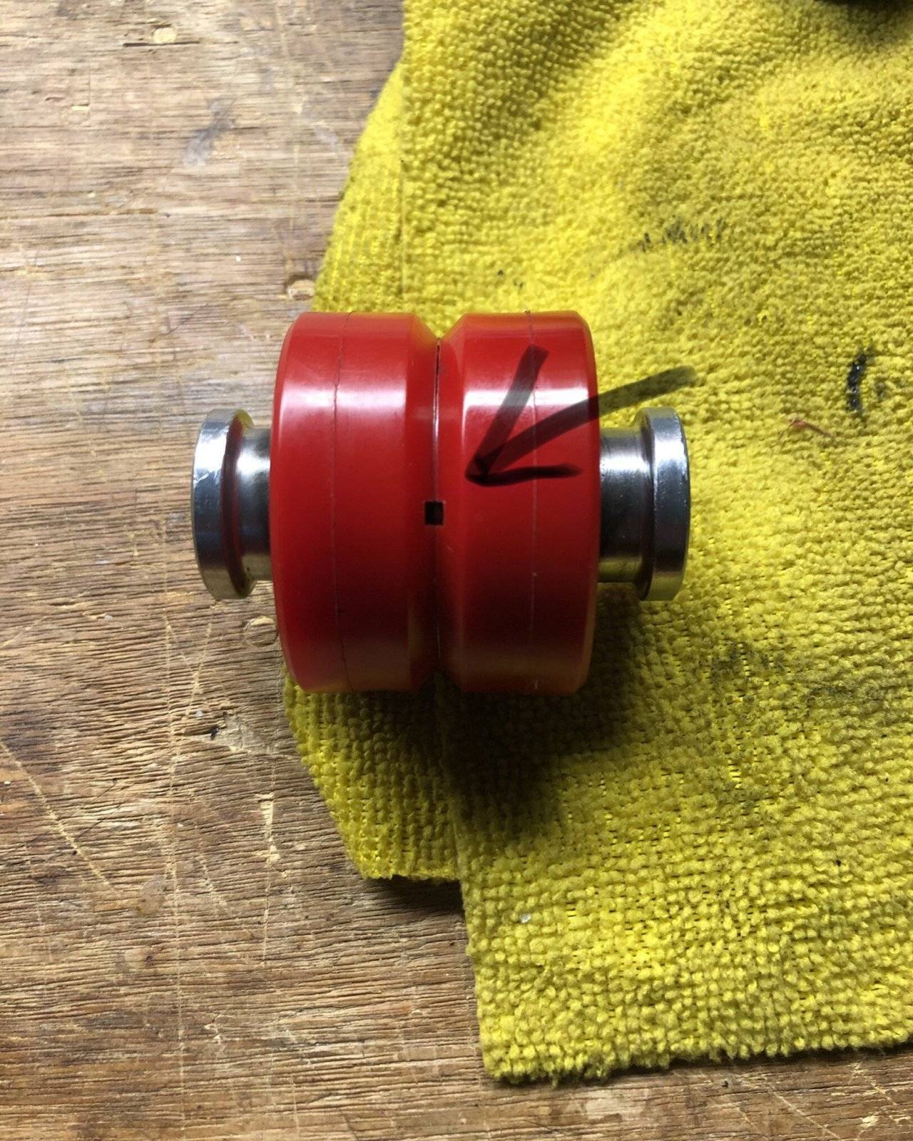

Getting the new bushings on the ball was the hardest part. I don’t have a fancy press so I had to use a vise. I used a 32 mm socket on one side of the vise so the ball would have room to get pushed through, and put the ball against the other side then tightened the vise until it popped on then turn it around and do same thing for other bushing.........
I used the 32mm socket to hammer the assembly into the arm. Then they give you stainless set screws so you can tell by looking at the arm that it’s got the newest bushings .........🙂

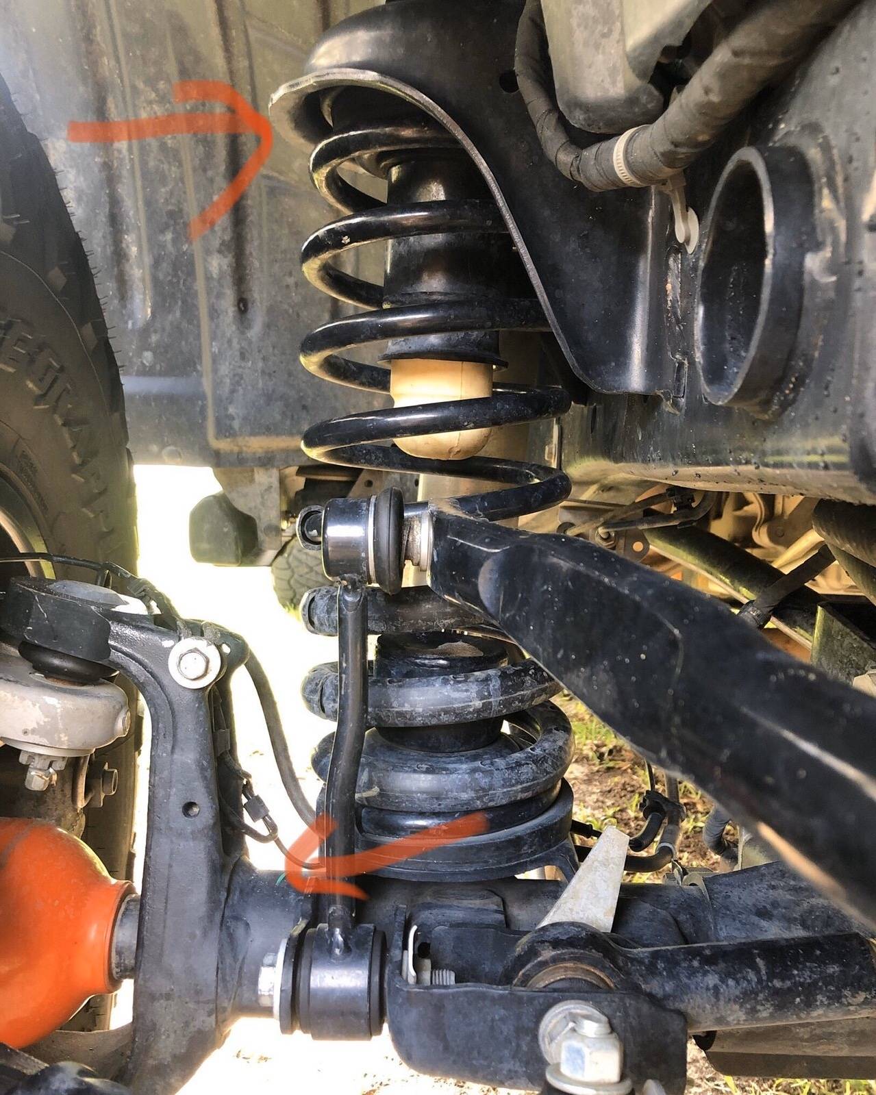

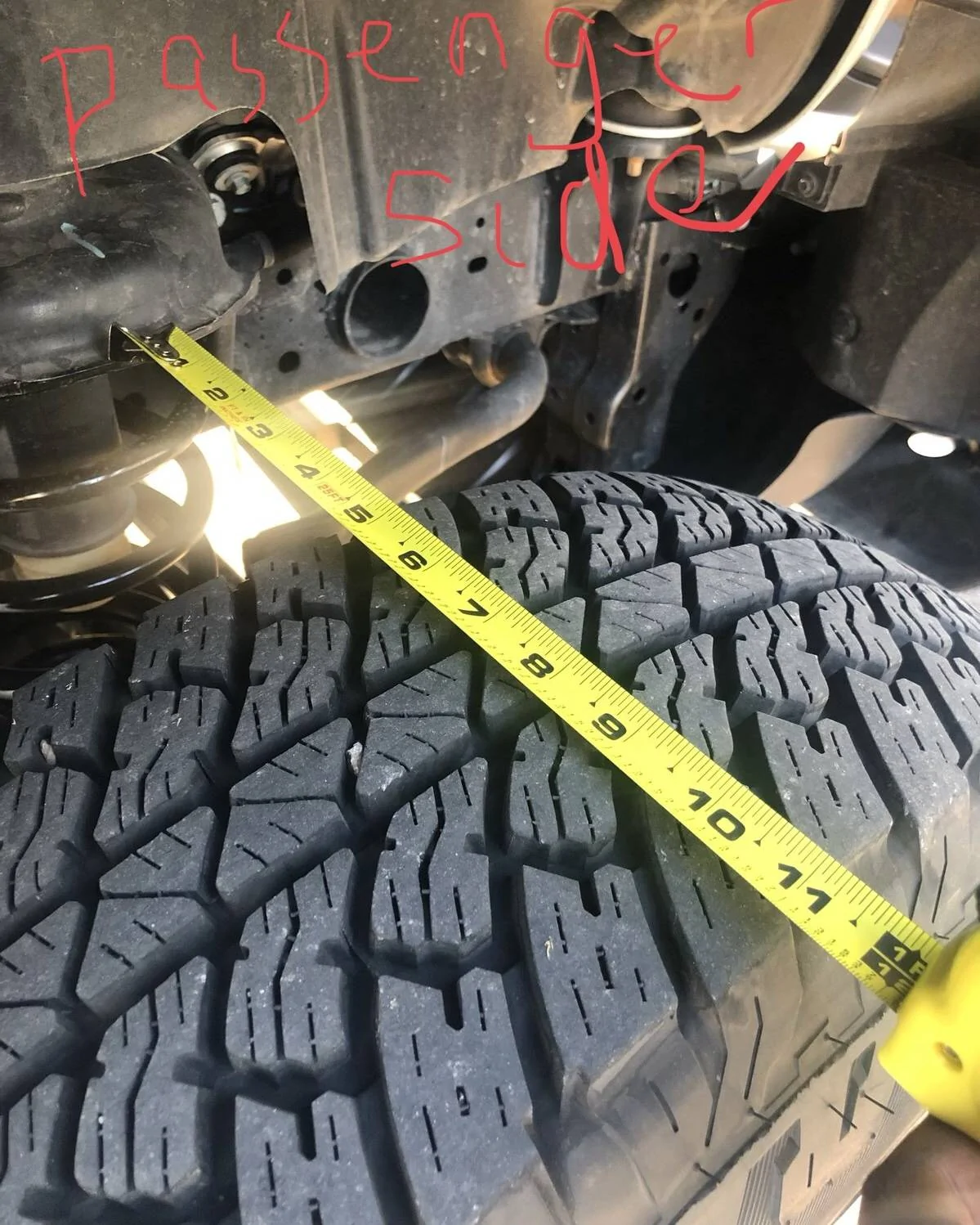

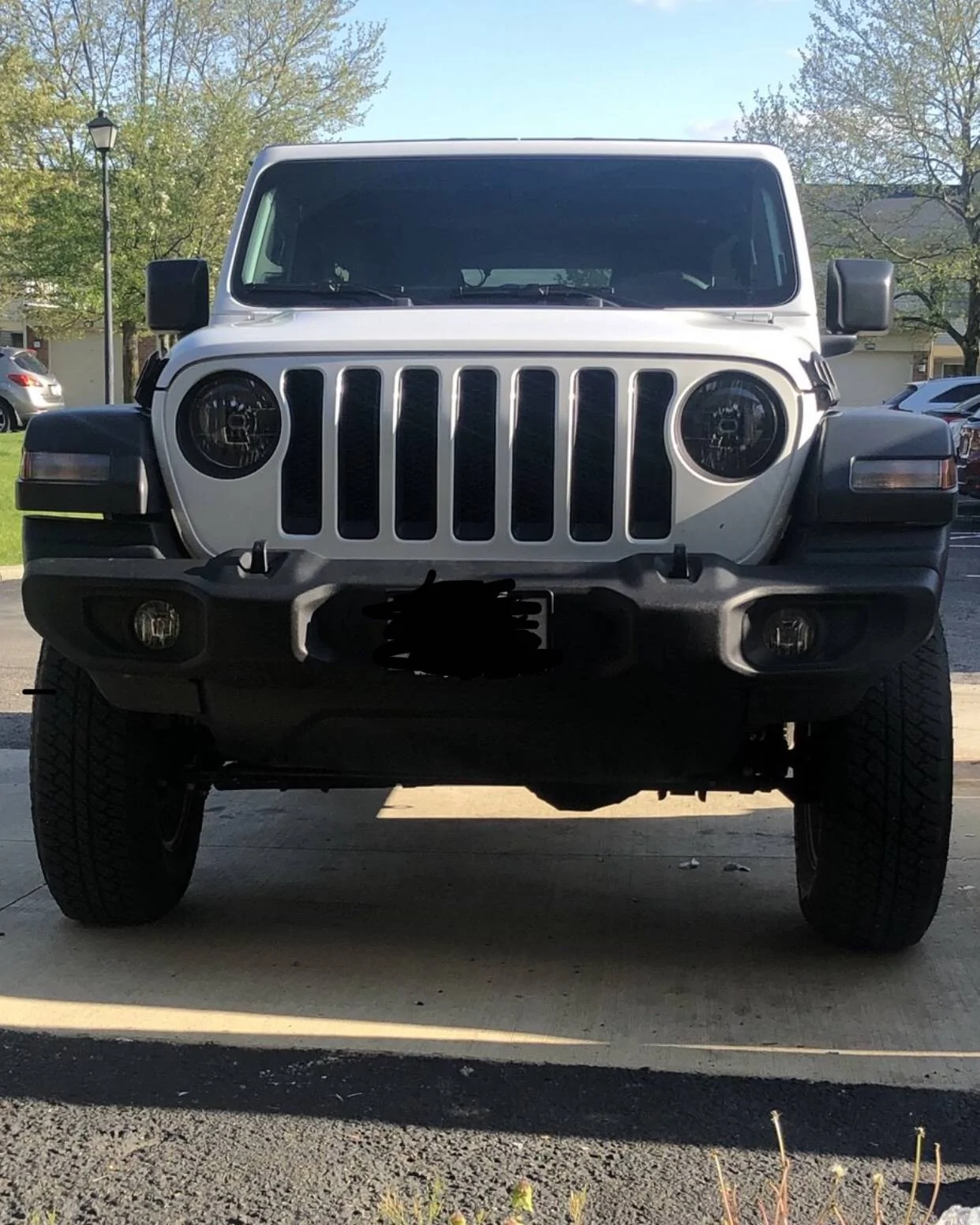

The Mopar 2” lift.......
I’ve installed over a dozen Mopar lifts over the last couple years on the JL. For whatever reason ( probably anticipating added weight ) the Mopar lift gives more than 2” of lift and they don’t include the parts to make it as it should be. When you get more than 2” of lift your caster is decreased and your axles shift, front to the drivers side and rear to the passenger side. Because everything on the alignment read out doesn’t show anything out of spec, that’s how they justify not adding parts to the lift kit.
Now you can drive it as is on the highway or light trails without issues. But if you’re gonna be off-roading and want it to drive better on the highway then you need to add a few things to the kit, the brand is up to you....
1 - front adjustable track bar to re-center the front axle.
2 - rear track bar relocation bracket if you want to keep factory rear track bar or an adjustable track bar
3 - front lower adjustable control arms to increase your caster ( around 6 or a little more is optimal ) to minimize if not eliminate wandering on the highway.
4 - front lower RK coil spring isolators. This is optional depending on how much spring bow you got and how hard you wheel it, the ones in the kit can collapse.
Some don’t care that things are a little off and are using the kit as is which is fine. There is no real ill effects short term but long term I think the factory lower control arm bushings will wear faster being in a slight bind. Again, this is in more extreme cases.
I have no science to back that up , only a couple guys that came to me a year and a half later with worn bushings. This could also be it’s just the way they use their rig, I don’t know. But I won’t install anymore Mopar lifts if the customer doesn’t have these extra parts with them........

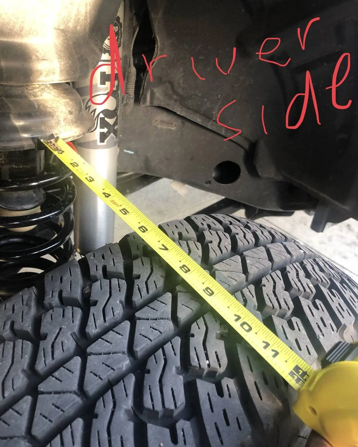

Here’s some pics of a more extreme example........
You can see the axle shifted
this axle was over an inch off...

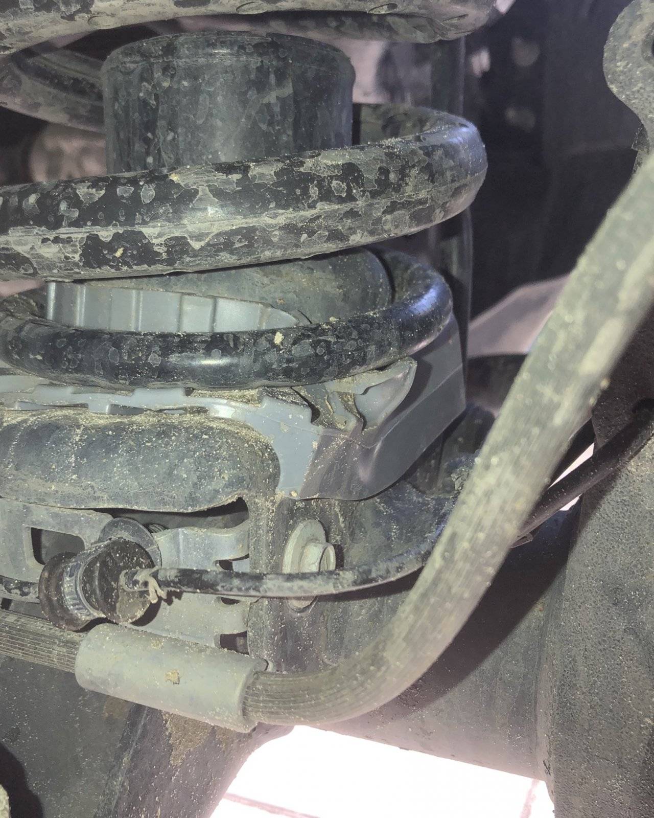

Here’s a collapsed coil isolator
Again this is just a guideline to what to look for and address if you have some of these issues with your Mopar lift. IMHO, if you do these few things you'll enjoy your lift a lot more............:)

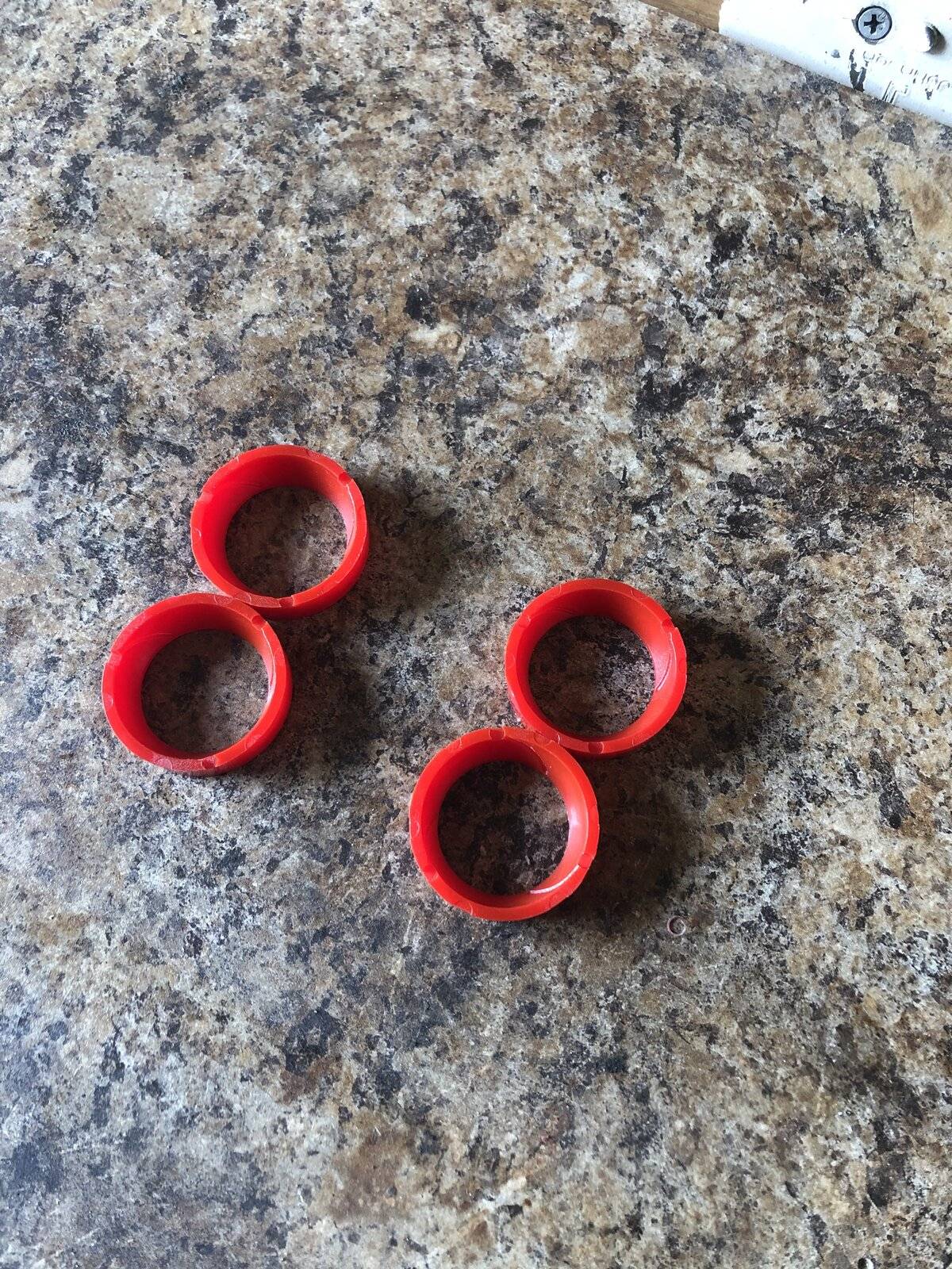

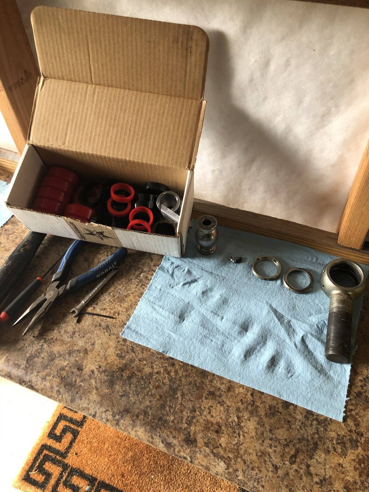

Got my front lower arms bushings in today. They weren’t as bad as the rears were........
My spanner tool still hasn’t shown up from RK, so this is how you take off the threaded retainer, hammer and chisel, when it’s loose I used needle nose to finish twisting them off.......:facepalm:

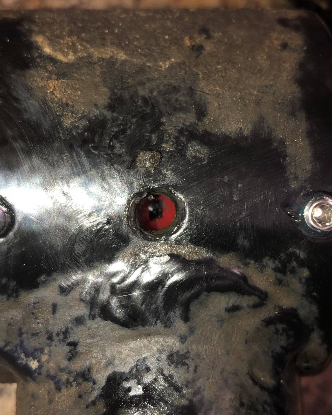

These bushings have notches for grease in 3 locations, you need to line up the two bushings so the notches line up........
Then when you press the assembly into the arm you need to try and line up the notch in the bushing with the grease fitting.......
Then install the threaded retainers, put in the two set screws with blue loctite and that’s it...... Brand new arms.....:)

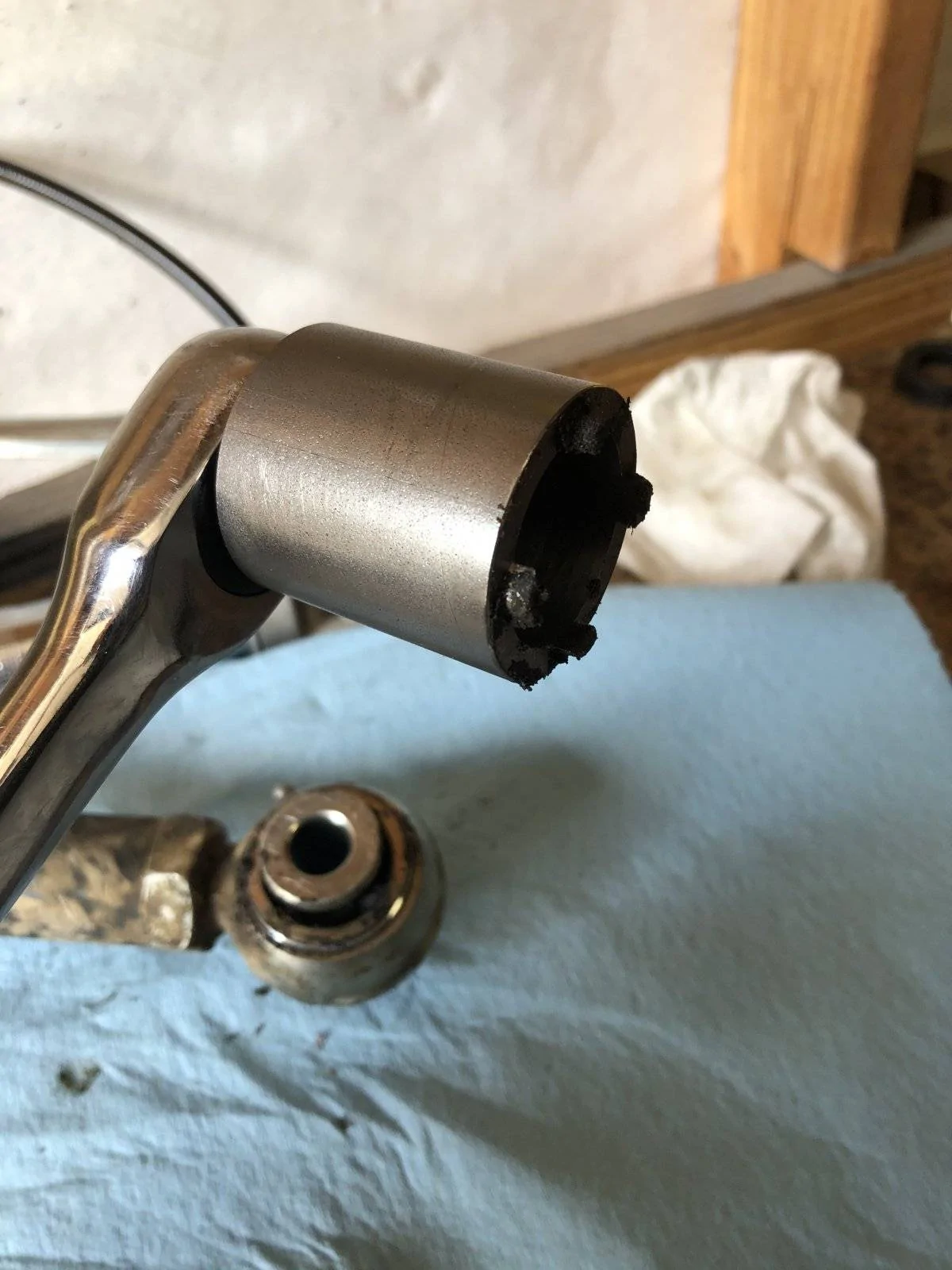

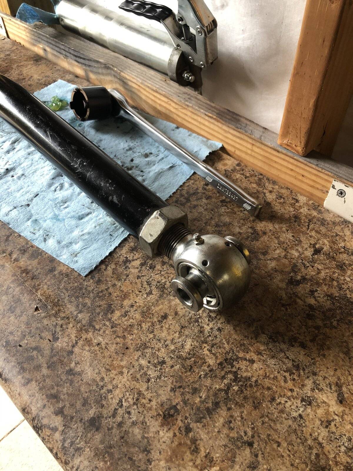

Moving on to my rear uppers rebuild. They were really worn......
At least my tool finally showed up, cut off a 1/3 of the time......:)
