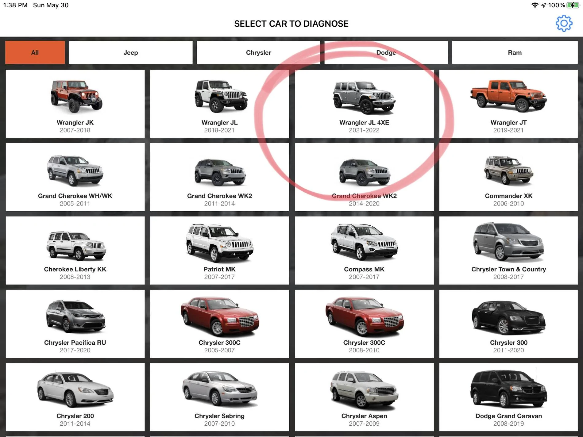

You might want to delete the JSCAN app and download it again as the 4XE is there, I did not look to see if the modules or other items were there but it shows up as a choice

It's there but it's missing 4xe specific modules related to the hybrid system, recharge, etc. I know they exist as people have reported the dealerships mentioning them to people that get charging issues.
Those are the ones I'm most curious about.
From seeing their Facebook group it looks like the 4xe was just added.
