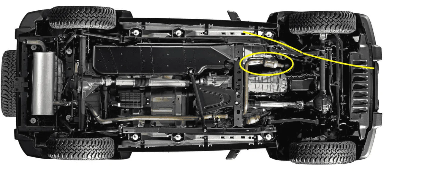

Am looking for some guidance on running an air hose line from my ARB compressor to my front bumper. Currently the air chuck is next to the compressor under the passenger seat.
I'm looking for suggestions on what air hose to get for this purpose and the best way to route it to the bumper. I was thinking of going through the drain plug, across the frame and to the bumper. Maybe needing like 10-12 ft of hose?

Easiest way is through the grommet on the floor board and follow the frame. You could also run through the firewall but thats difficult AF.

Cool I think that's my plan for now. I ordered a 120 inch hose and will go through the grommet along the frame and try to avoid the exhaust. Something like this:
Jeep Wrangler JL Compressor air hose route location Screen Shot 2023-08-15 at 3.28.04 PM

May look at the plastic tubing so you can cut to length and not guess for a distance.
