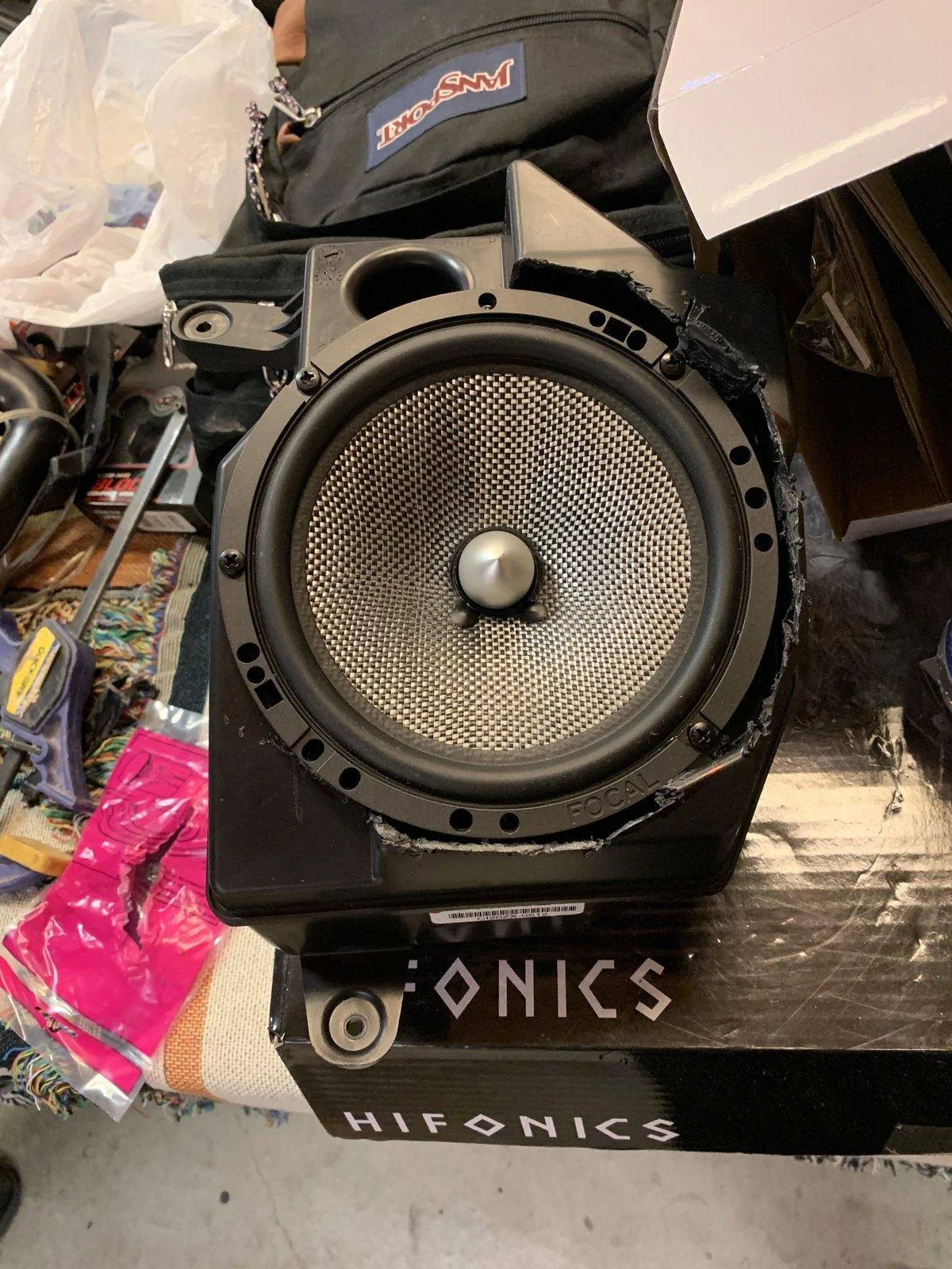

I had to take out the speaker casings from the knee speakers to enlarge the opening to fit the new 6.5s.
Nice job on the installation. If I could make a suggestion on the front knee speakers. When you install a speaker you want to isolate the front of the speaker from the back. The holes around the edge of the speaker will cause cancelations and It will affect the sound quality.
There’s a couple of things you can do to fix it. I’d cut the raised sections off the factory pod, to create a flat surface. Then make a new panel out of 1/2” or 3/4” mdf or high quality plywood. Seal the panel to the factory pod. The panel should cover the whole front including the port. Another, maybe easier, solution is to use a speaker pod, JP 1014, made by Metra.
The replacement pod for the knee speakers allows you to add a 6.5” speaker. With either option I’d also suggest adding dynamat to the outside of the pods.
