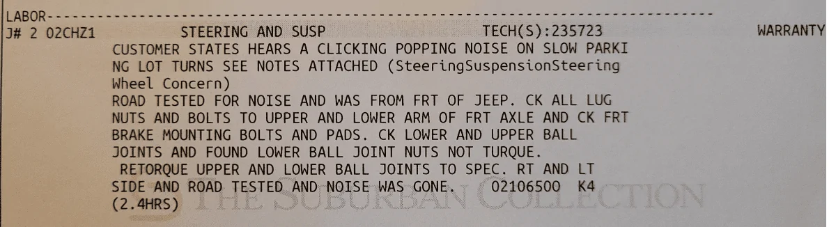

I have a 21 Rubicon Ecodiesel with about 5k miles. I notived a metalic click when i turn the wheel going slow. Sometimes it wont make it but usually it does and its when turning left or right. Its coming from somewhere under the car in the middle and sounds a lot like a snap. The dealer heard it too and said they havent encountered it before and cant locare it. I read that some people have this problem and its the ball joint not torqued. However the deale checked it and said that wasnt it. They ordered me both front axle shafts thinking its something internal. I highly doubt this since the sound comes when you turn the wheel. Im going to go to another dealer for a second opinion but wanted to ask your thoughts.
Incase you still need answers, had the same issue. See attached for fix.

My car is still at the shop for an oil leak, which I have posted in another post. But I told them this and they claim they replaced the ball joints and it no longer clicks. I have not been able to personally confirm this since I dont have access to the vehicle. Thank you all. It appears that it indeed is the ball joints.
