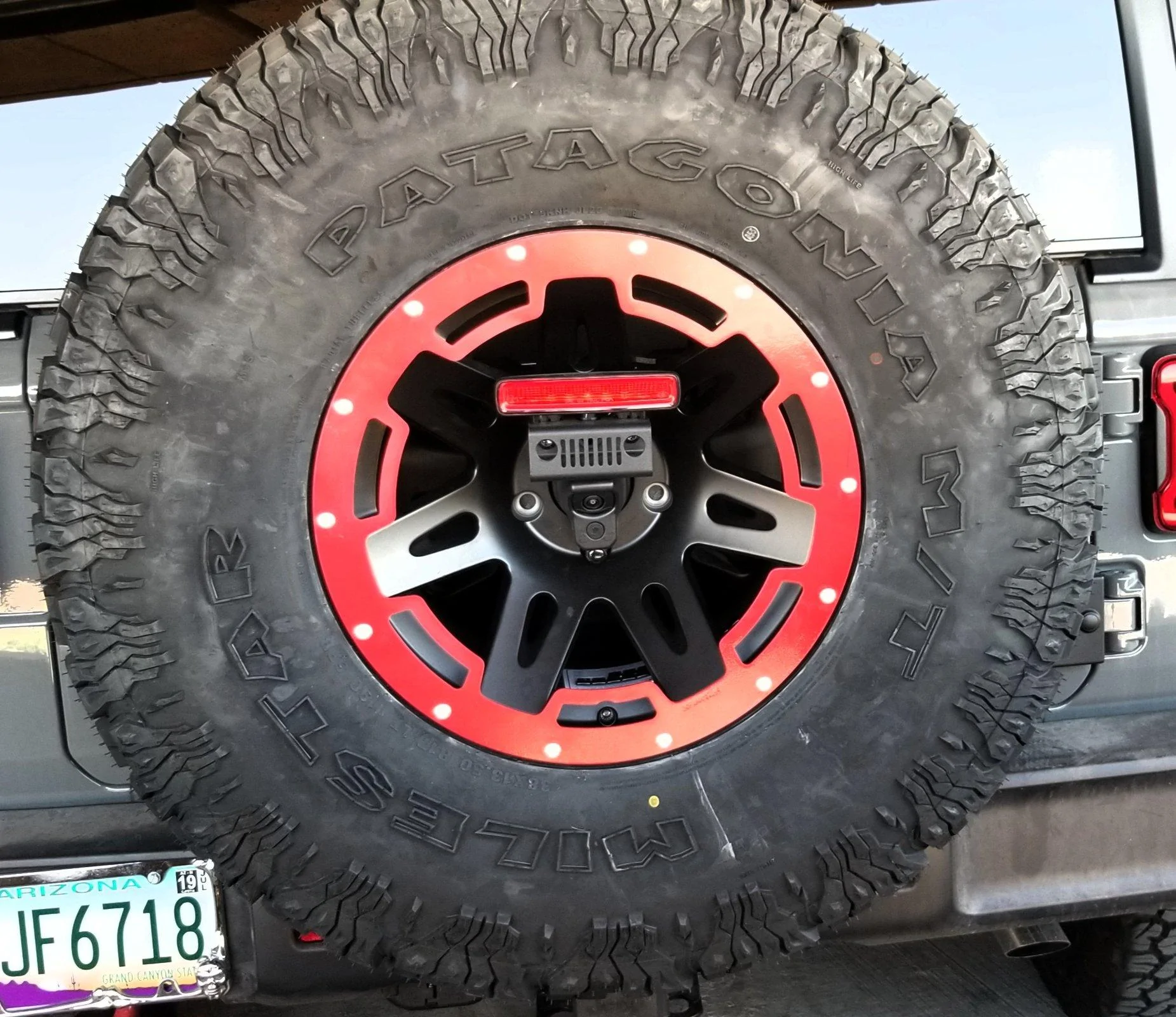

2018 JLU Rubicon
I didnt have any issues with mine. Mounted on a 17x9 Rugged Ridge XHD wheel.
Ive since removed it though, in favor of relocating my license plate to the spare.

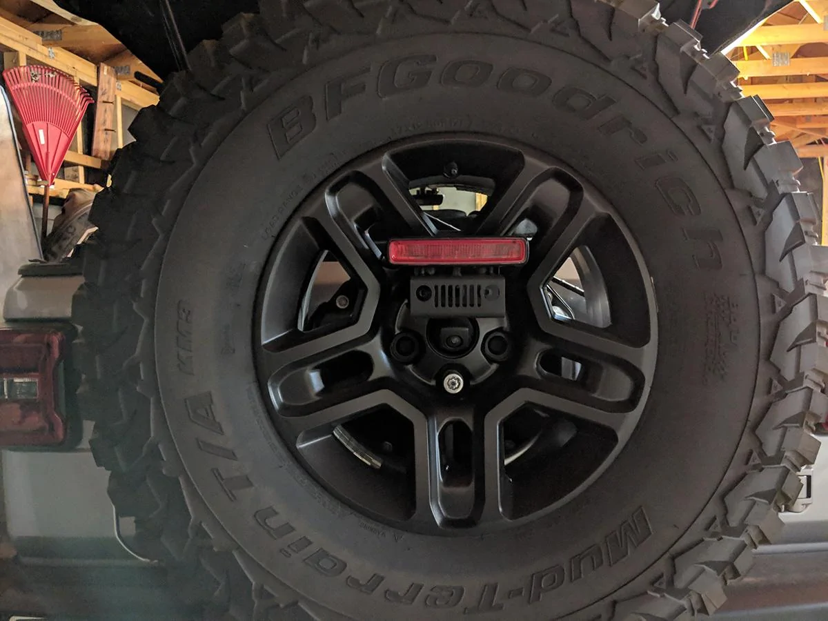

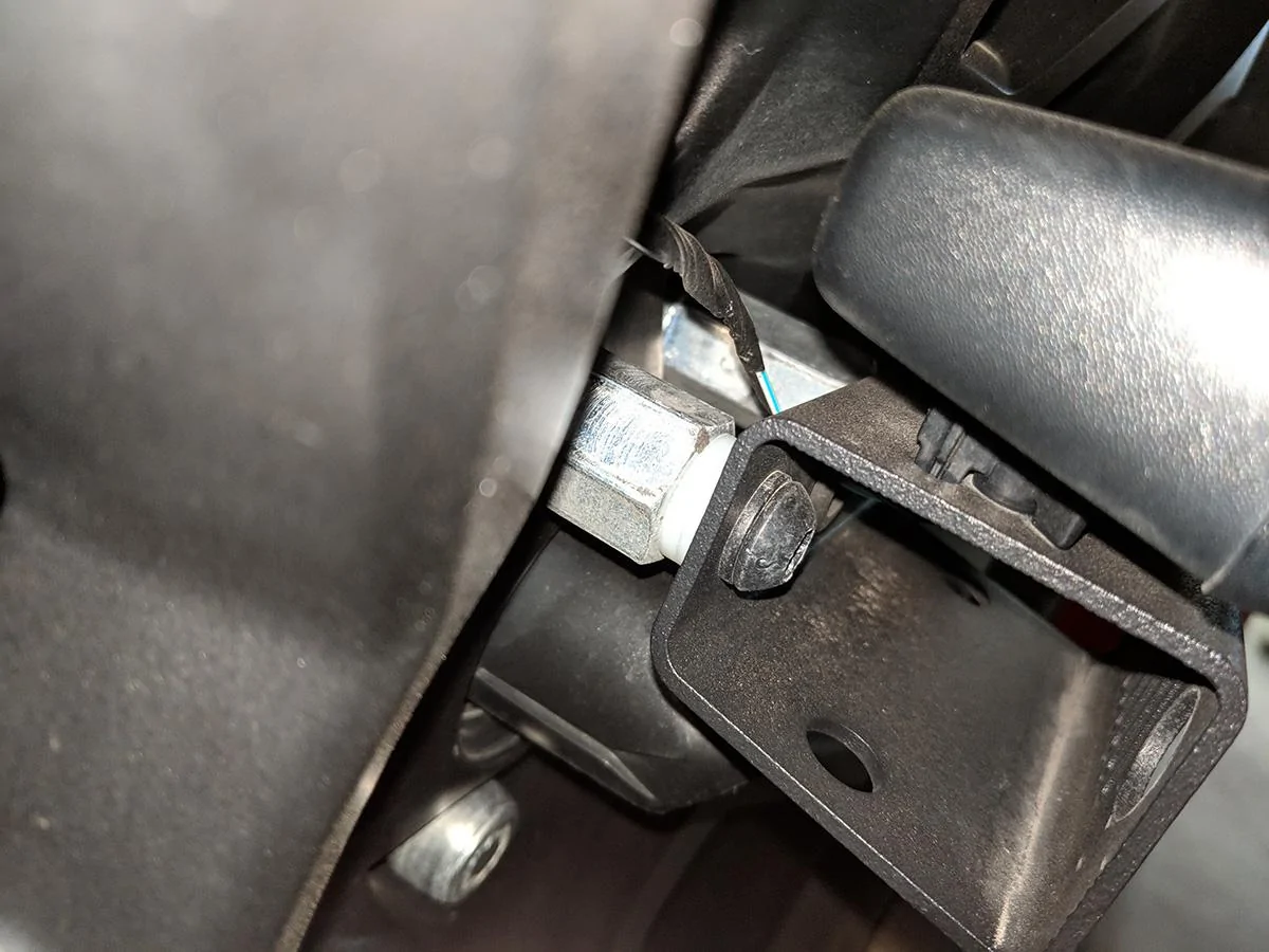

It's not just the lug fitment you've gotta worry about, but the distance as well. I've got the Mopar Off-Road Slotted wheels and I actually had to buy some plastic washers so that the metal bracket would clear the wheel.
