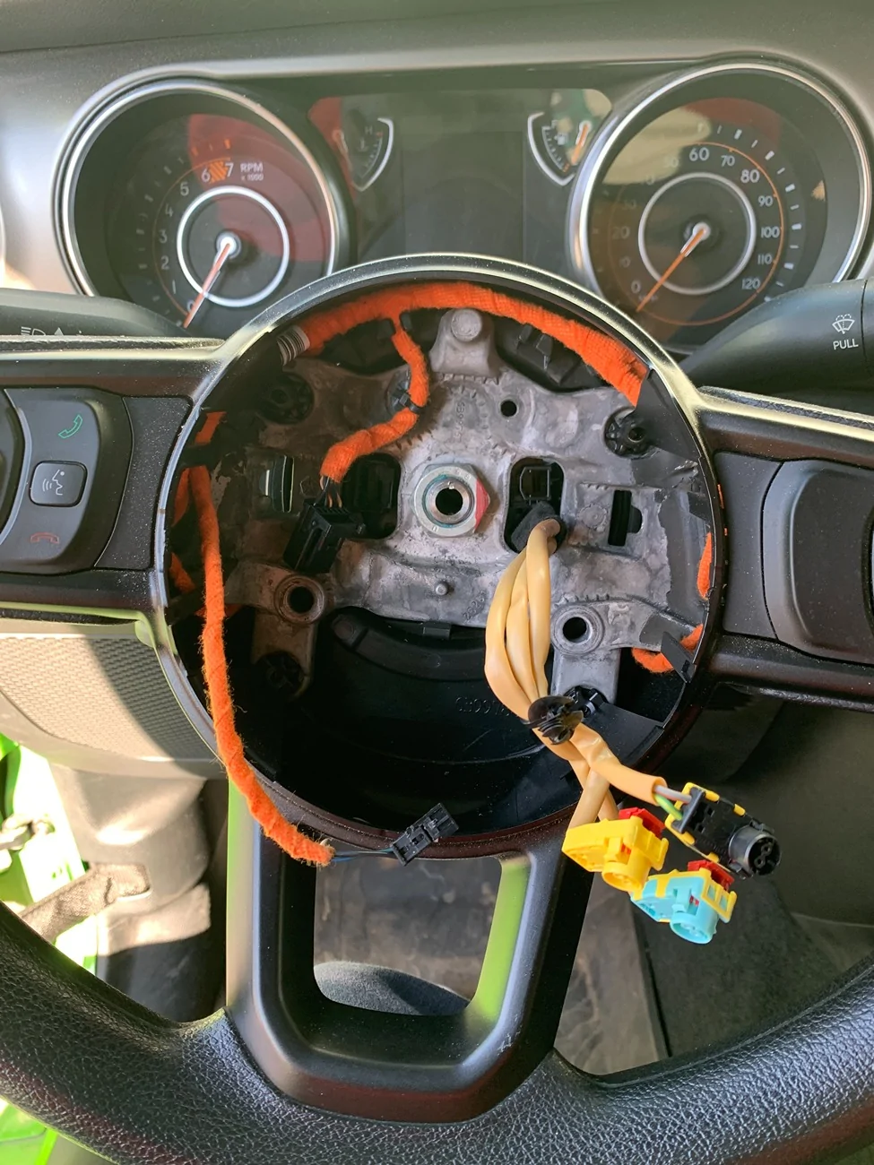

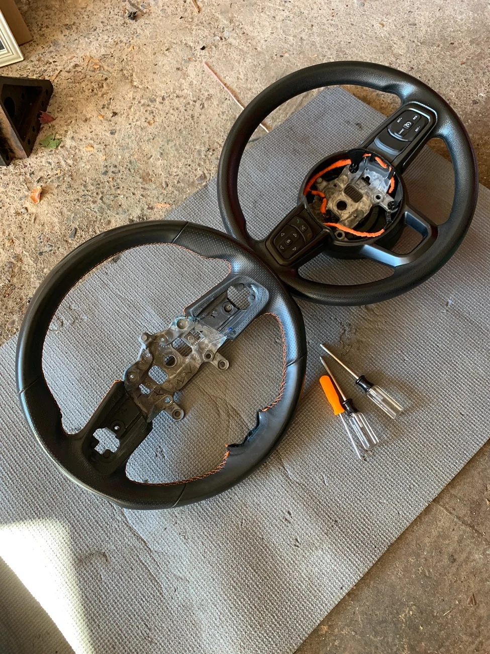

I swapped the base Sport wheel for a leather-wrapped version in my JL, it was easy. Fortunately, you can't really mess up the steering wheel orientation, just remember the airbag harness goes through the right side of the steering wheel.
Jeep Wrangler JL Changing a JL Steering Wheel IMG_7790
1/2" impact made quick work of the nut below the airbag that holds the wheel on. I'm sure you can do it with a regular ratchet, but I got the gun, so I might as well use it LOL. Once the nut is removed, you just have to carefully fish the airbag harness through as you're pulling the wheel off.

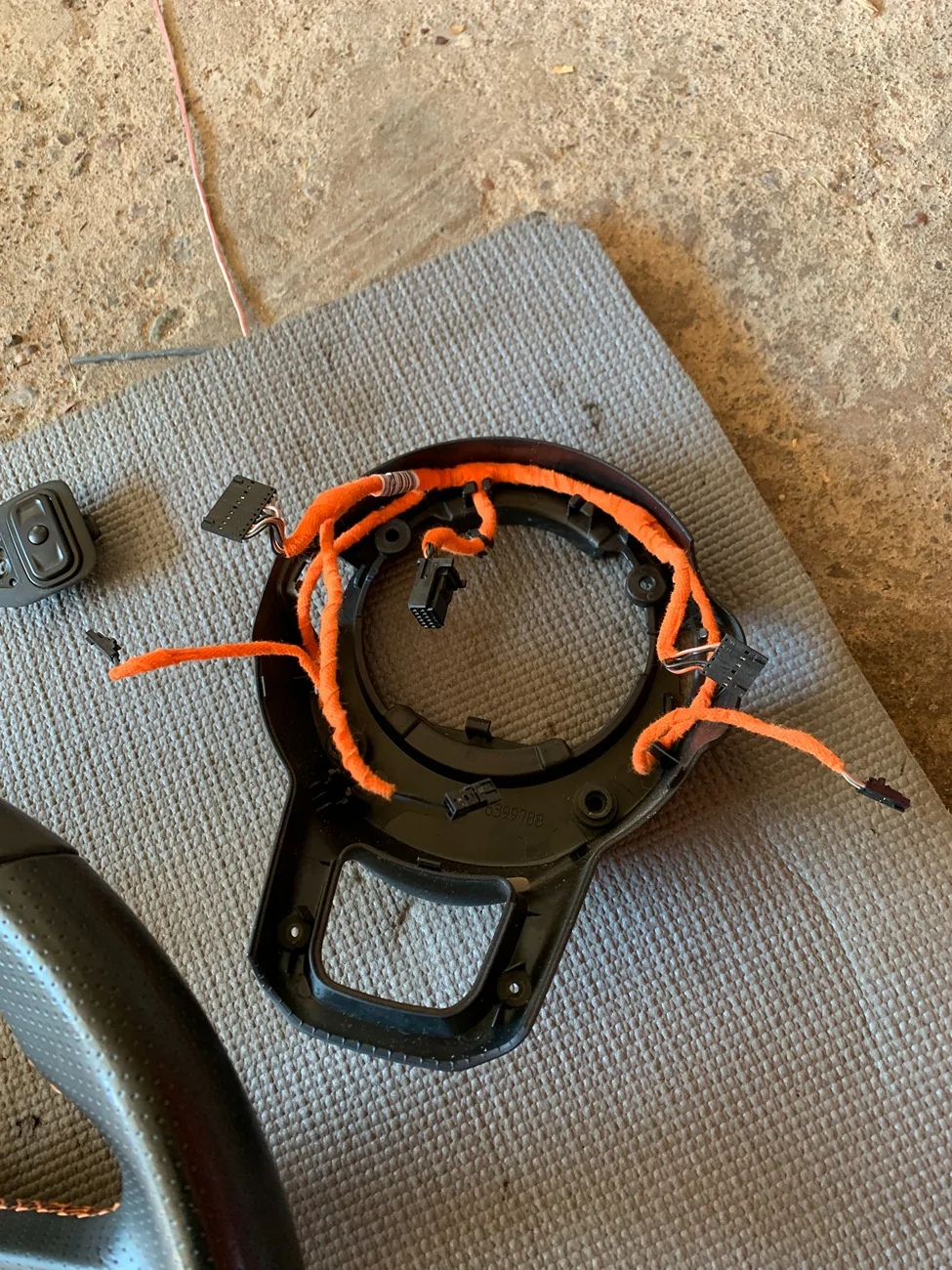

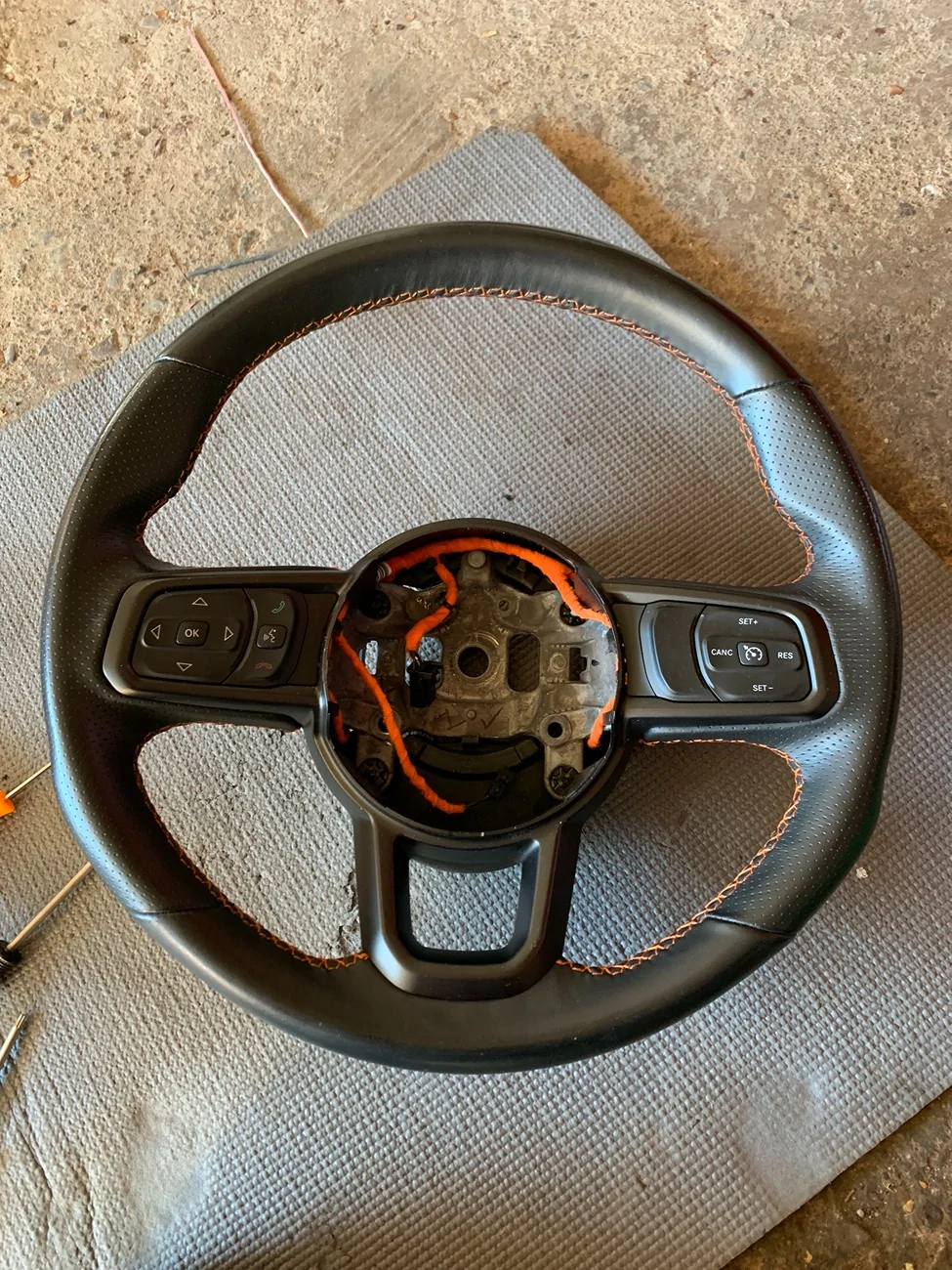

I kept the radio/cruise control/ hands-free harness attached since I was reusing the original black trim on the new steering wheel. If you want to upgrade and add the paddles as mentioned above you'll need a different harness.
Either way, follow the routing carefully so all of the buttons fit flush like they did before. Here's my OEM wheel on the right, new one on the left. I don't have the heated steering wheel option so I bought one on eBay without the heating element - it was cheaper.
Jeep Wrangler JL Changing a JL Steering Wheel IMG_7791
Jeep Wrangler JL Changing a JL Steering Wheel IMG_7792
Jeep Wrangler JL Changing a JL Steering Wheel IMG_7794
Just transfer over the different sections and your new steering wheel will be ready to go in no time.
