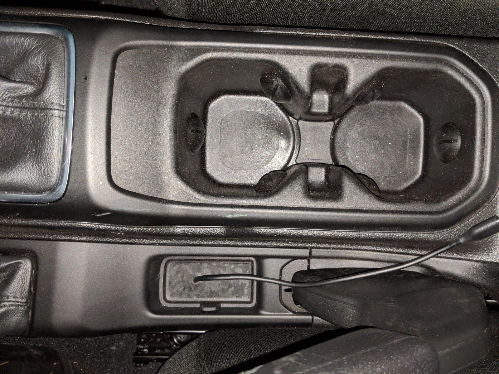

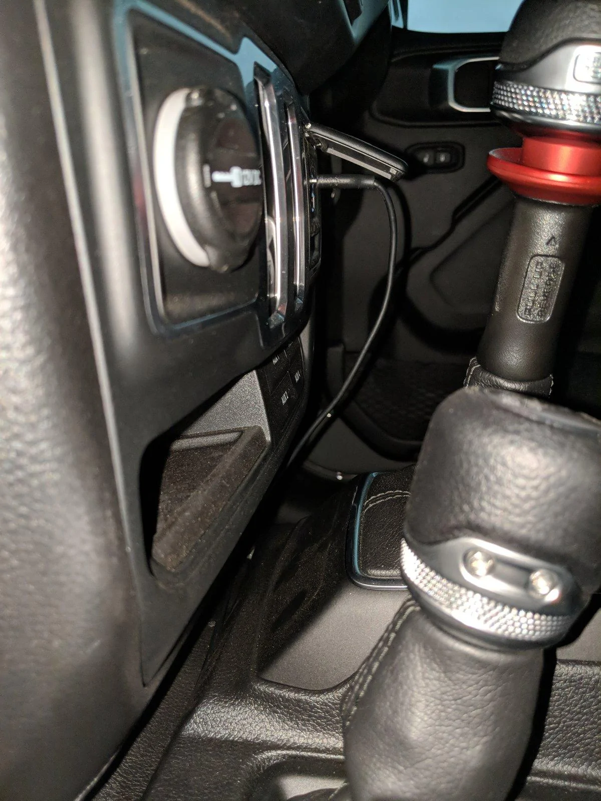

I went a little different direction. I widened the hole in the small coin stash cubby under the parking break with a drill (located under the rubber pad).
Then I fished the cable from underneath the plastic trim and ran it under the edge of the gearbox plastic trim up to the Media slot.
I prefer USB-C connection that USB-As my Google Phone charges very rapidly through USB-C.
It keep the console/transmission area tidy with no cables and allows me to use the port I prefer.
Having that media door wedged open doesn't annoy you? That's what I'm trying to solution.

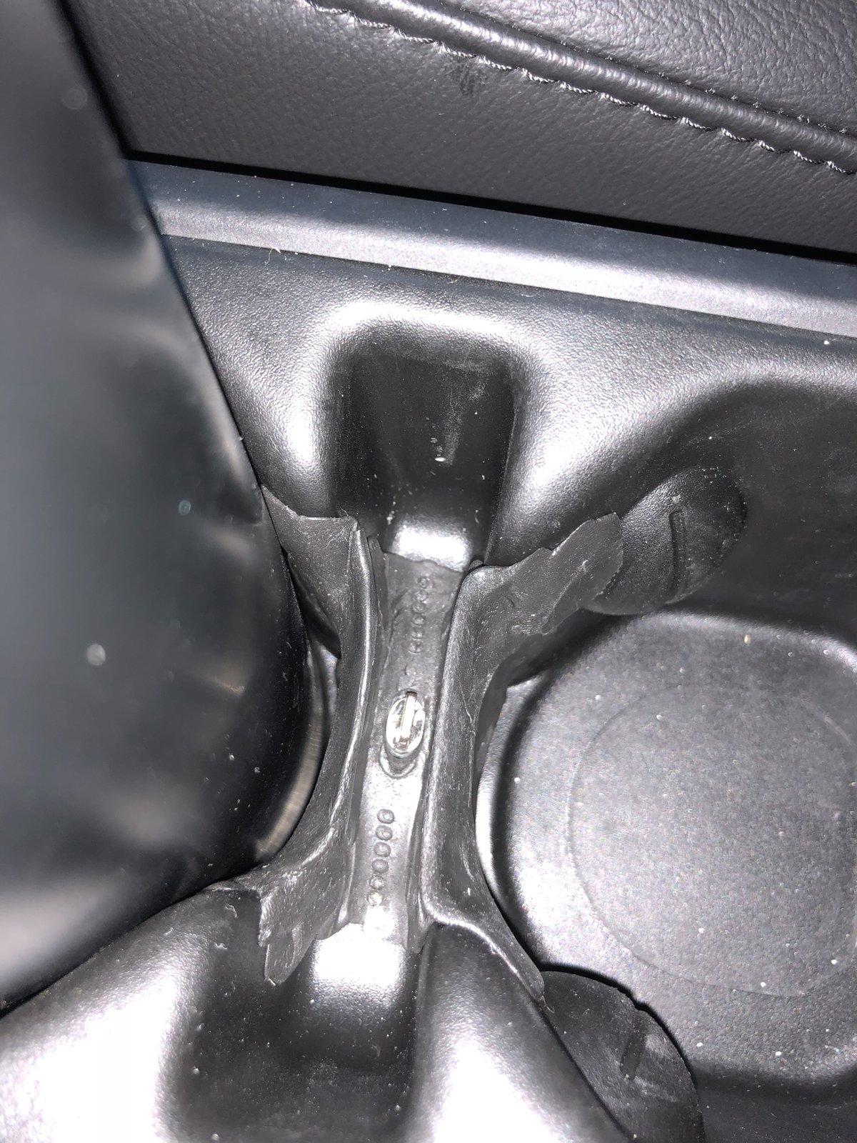

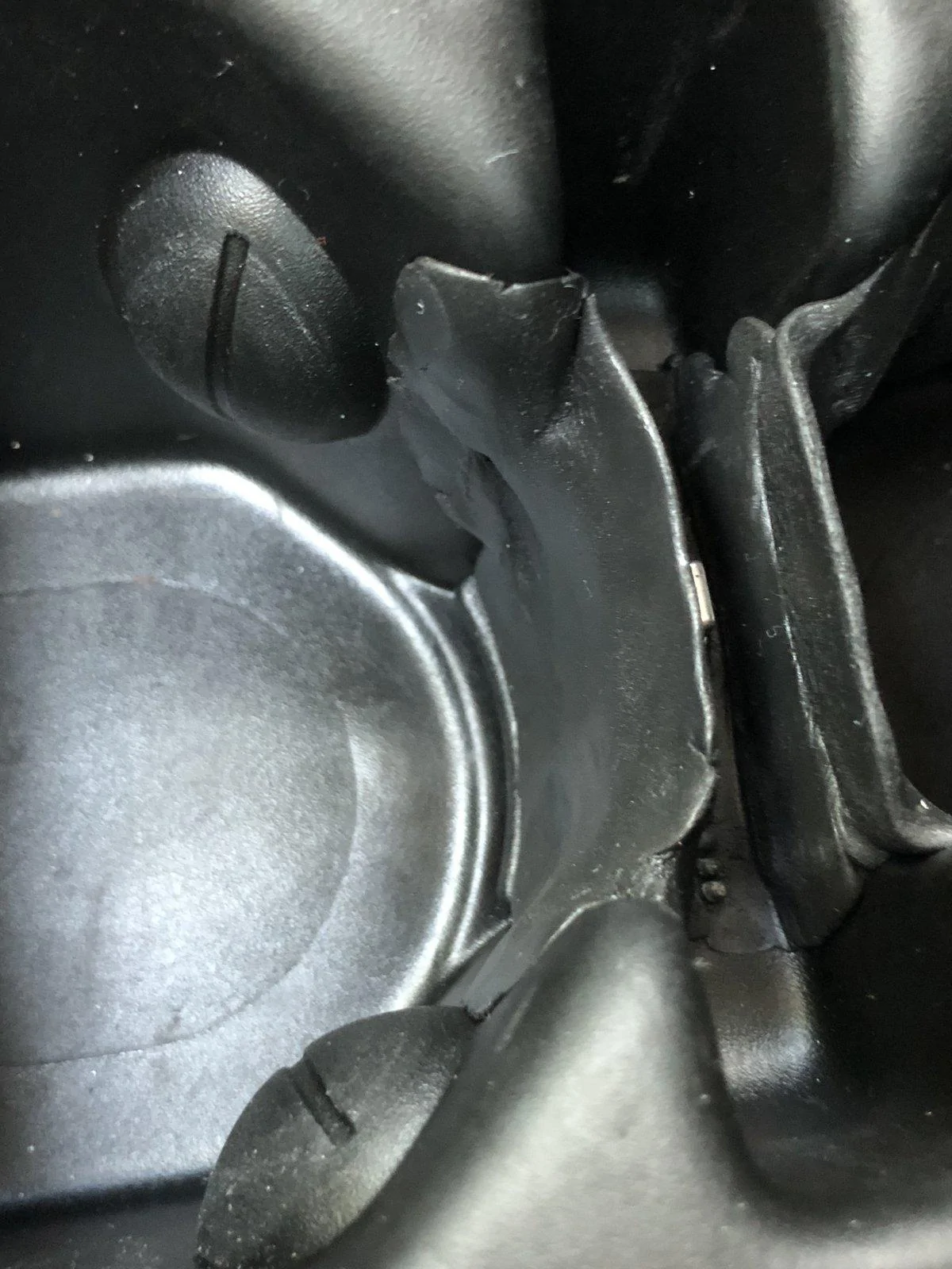

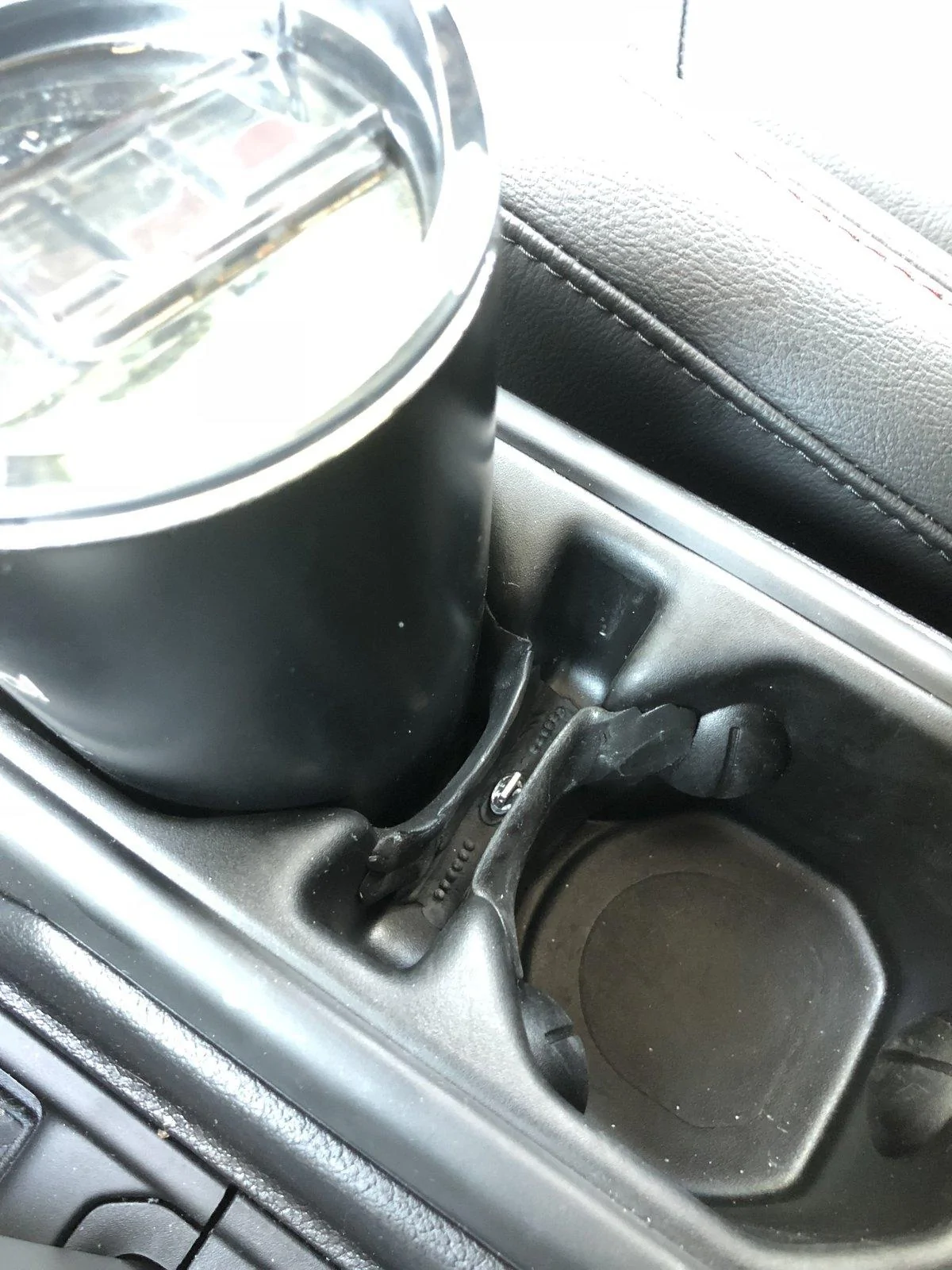

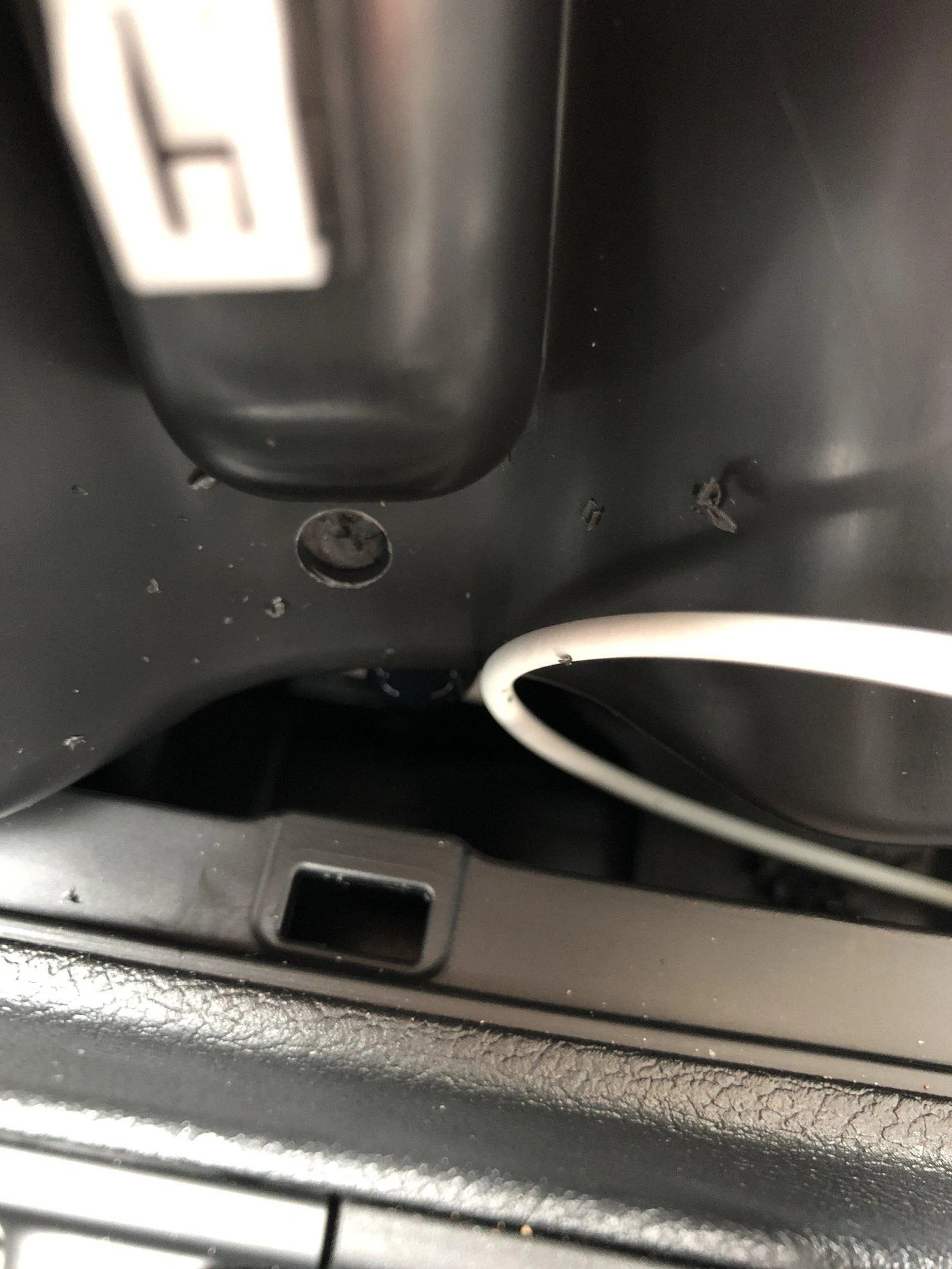

Here’s another pic I found that I took. This is the driver’s side of the cup holder. You can see a tab at the top that snaps into the corresponding slot. Also there’s the hole I drilled.
Great mod but how did you remove the cupholders? Are you remove the hard plastic around the cupholder or just the rubber?
When I look on this thread it looks like it is not good to remove just the rubber:
https://www.jlwranglerforums.com/forum/threads/jl-front-cupholder-removal.9089/
vhfan5150
Sean
Feb 15, 2018
190
271
Cincinnati
Bright White JLU Rubicon
Oh man it feels like it's been forever since I did this. If I recall correctly, I did remove the entire plastic section. I believe it just pulled up. You have to be careful and not pull up too far as the ambient lighting wires are connected at the bottom middle of the holder and they don't give you much spare wire to lift the holder up too far. I just drilled through the rubber and plastic at the bottom side where it shows in that blurry pic.

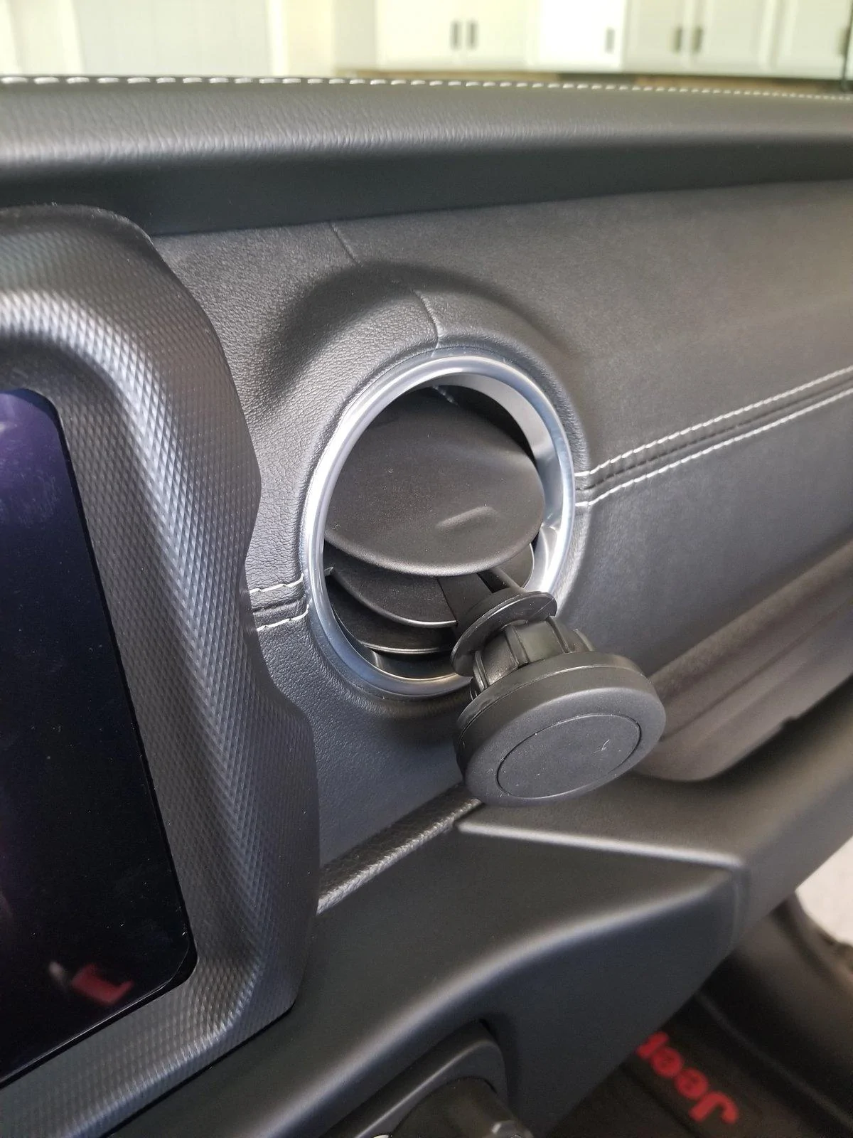

Received a free mount from the FCA affiliate rewards program. Won't work with my phone case though. The red piece is magnetic and has an adhesive on the back.

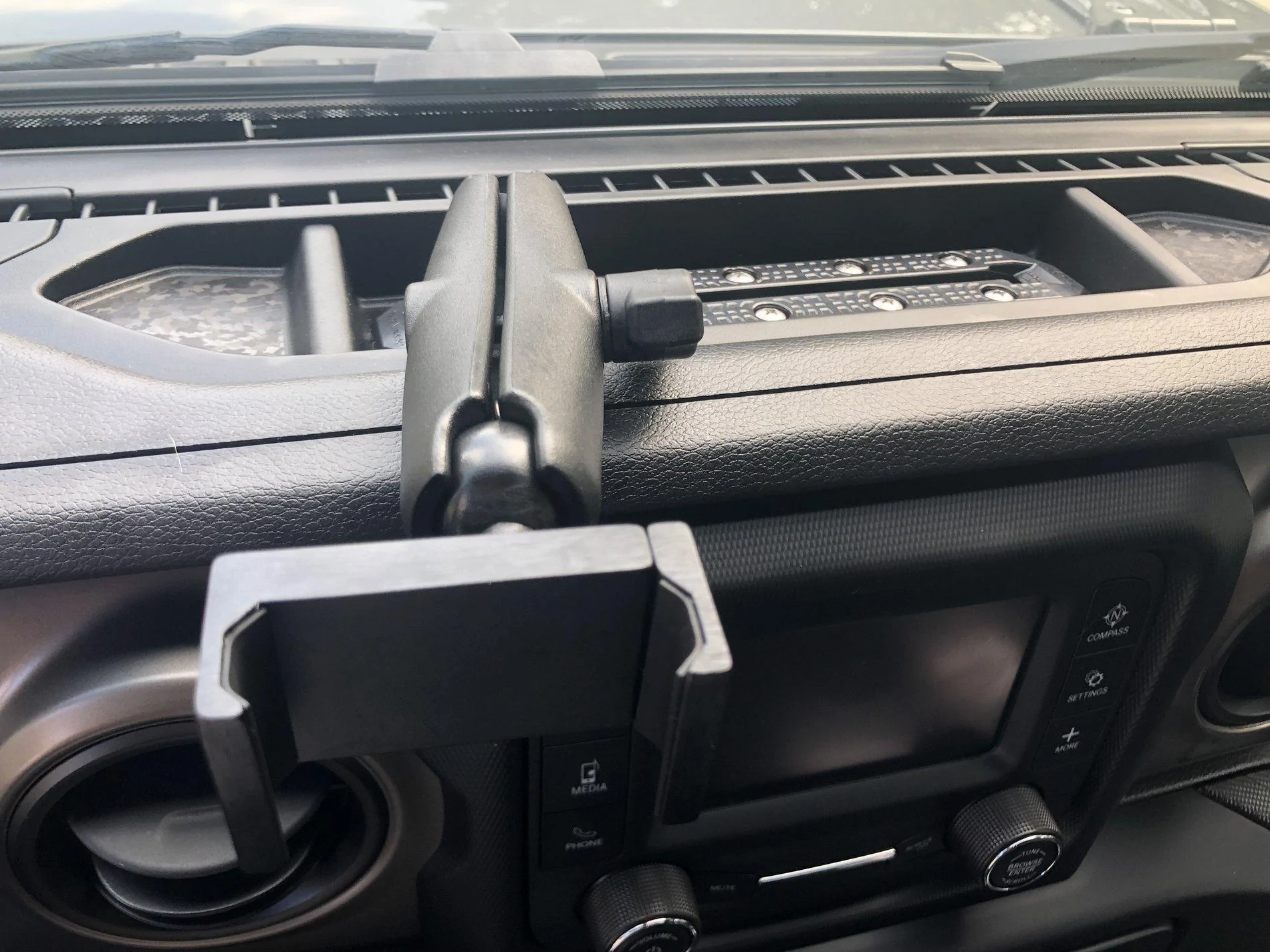

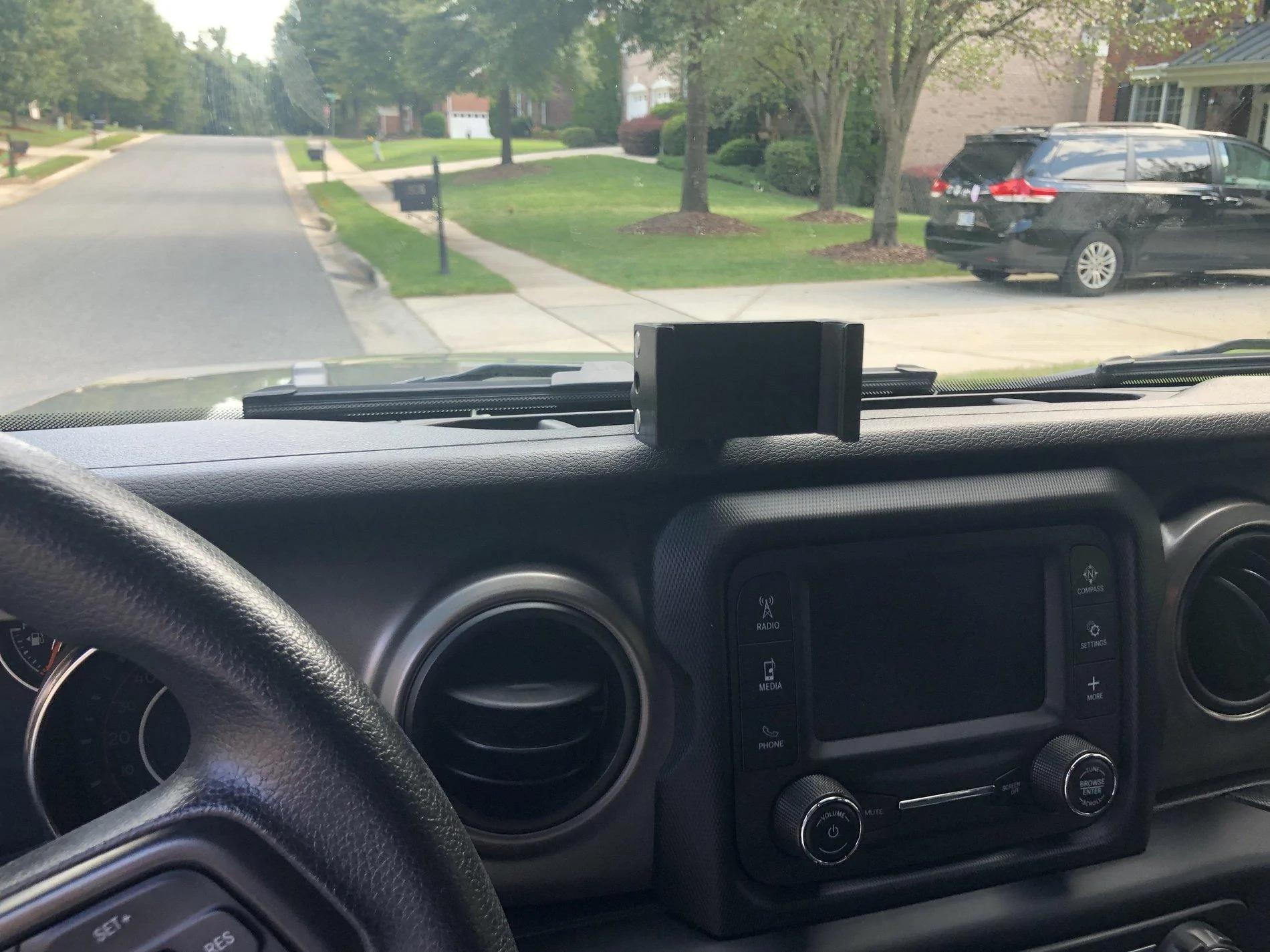

Hello,
Here’s what I did to mount my phone. I spent about 70 dollars total. I think I have a solution that is comparable to the rail options on the market for half the price. It seems there are pros and cons to all the options but perhaps this is an alternative for you.
I can add more mounts, move things around, etc. For example, I have a go pro mount that can easily be added.
My next step is to run a USB port to the top of the dash so I don’t have wires hanging.
Thank you
