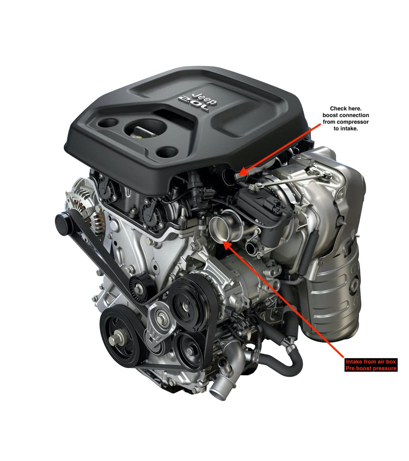

Sounds like you blew the turbo hose off of the intake pipe. When the boot pops off it creates a very loud whooshing sound as the turbo spools up. You also see a major drop in power because you no longer have turbo boost coming into the motor. Check the hoses coming off of the turbo and make sure all of the hose clamps and connections are tight. You will probably have to remove the plastic engine cover to see them.

It could have blown off the intercooler too. It looks like a radiator on the front.

There is also a connection point under the cover at the intake manifold. Are you able to hear the air whooshing sounds when you rev it at idle? I have had similar issues with several turbo Diesel engines.

There could be a rupture too or a split near the clamps.

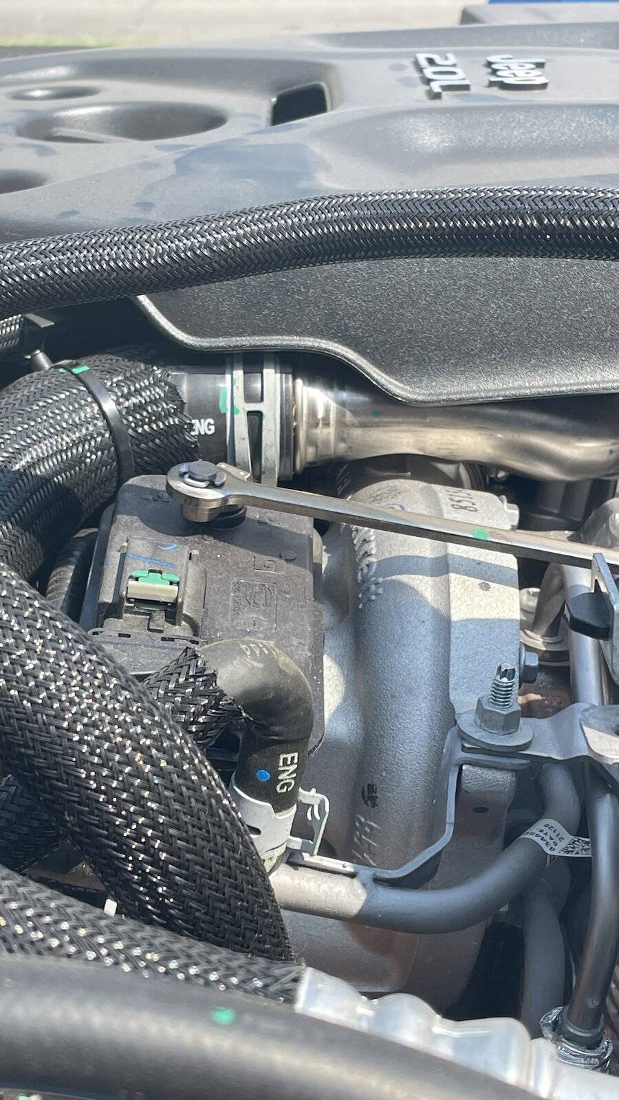

Ladies and Gentlemen for all that were interested,
Just heard back from the dealership and it looks like my intercooler tube had popped off due to a loose clamp from the factory. Side note, they also told me one of my ball joints was very loose = and was causing popping every time I turned, also due to a loose nut from the factory. Weird!
All in all, problems solved!
