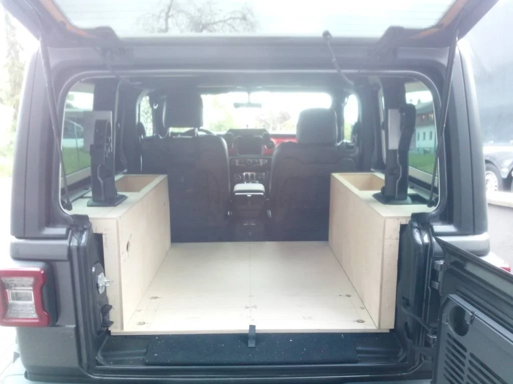

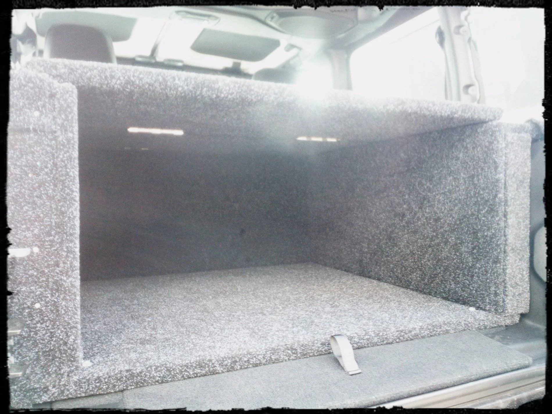

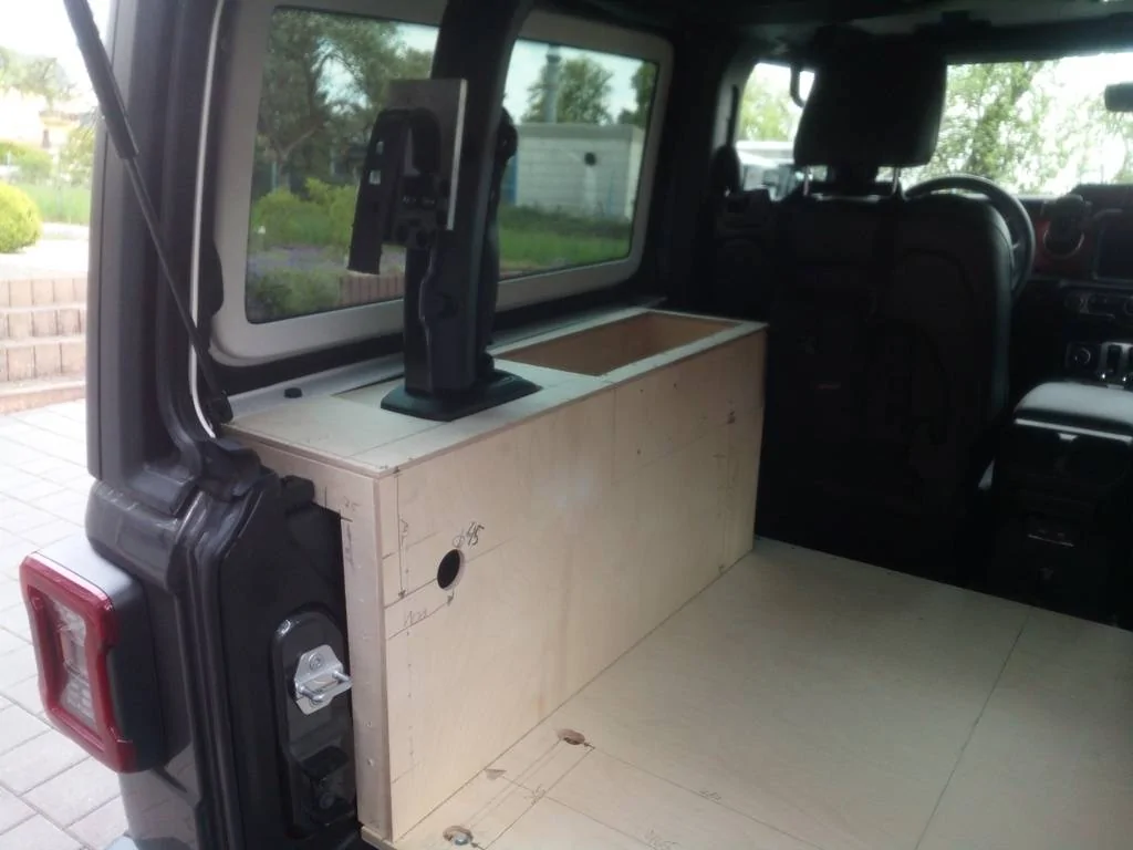

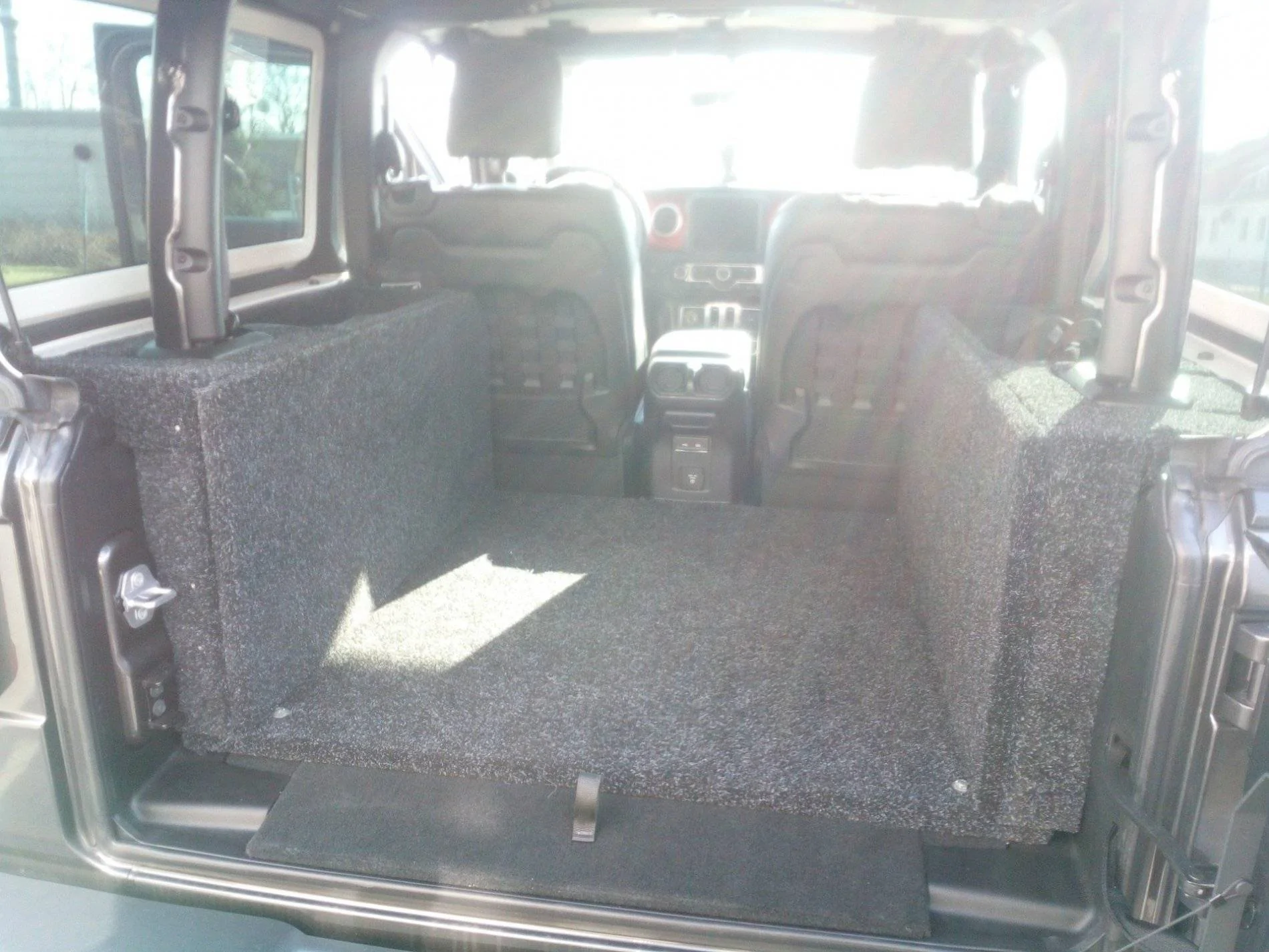

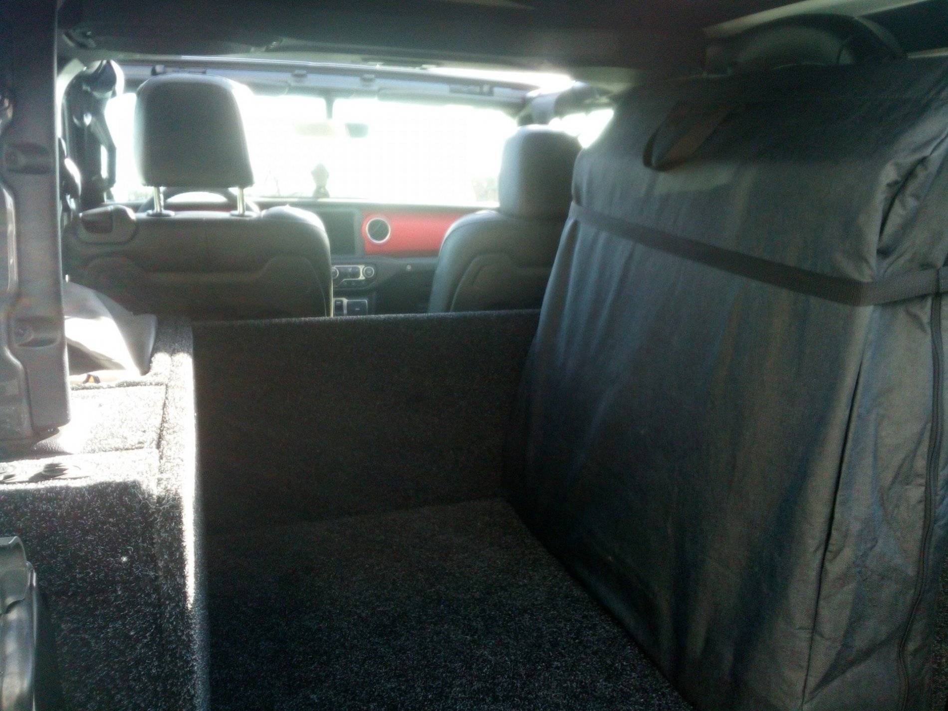

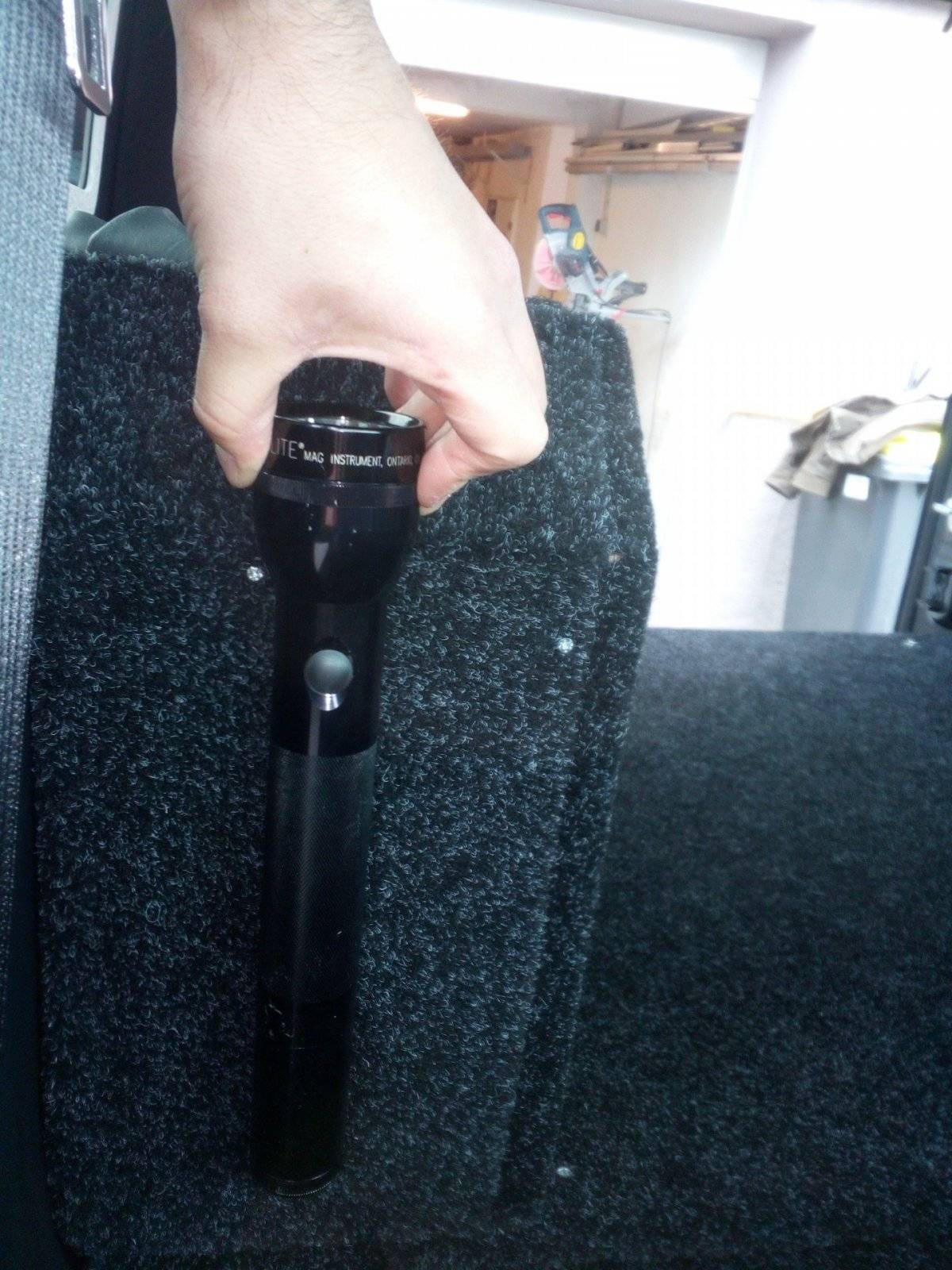

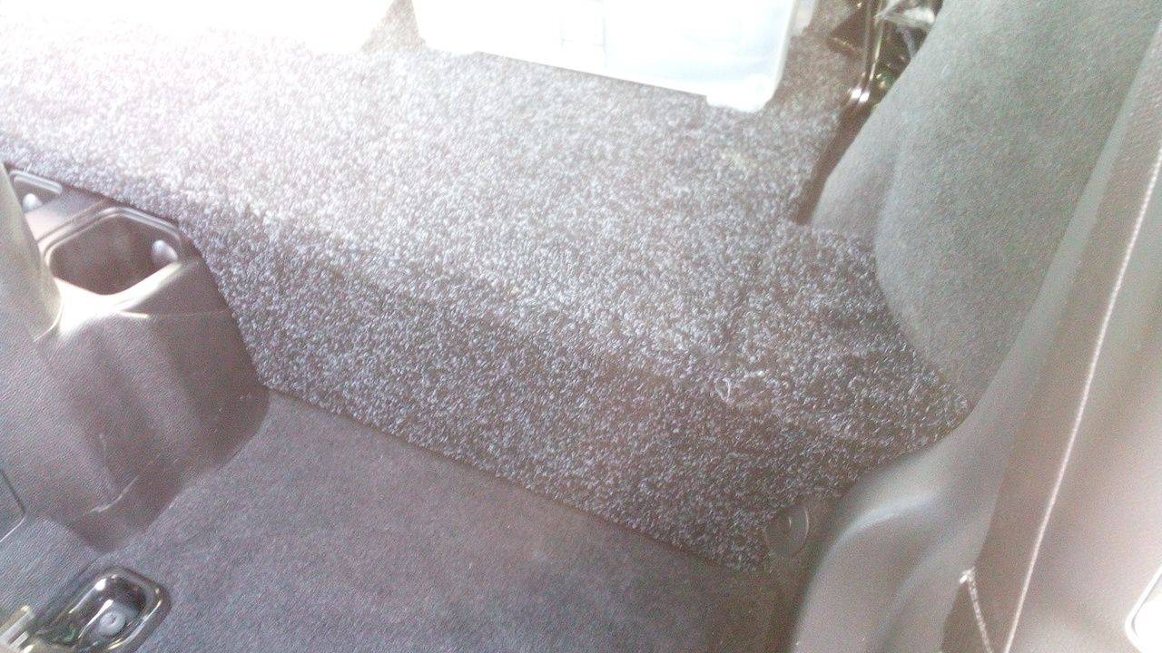

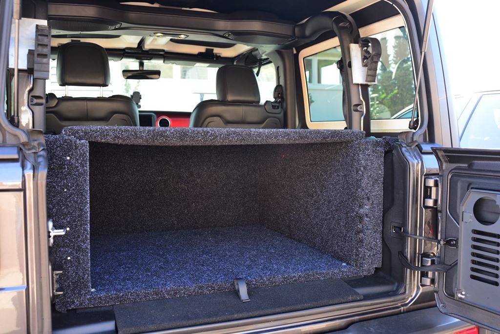

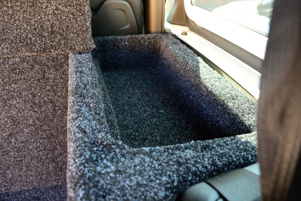

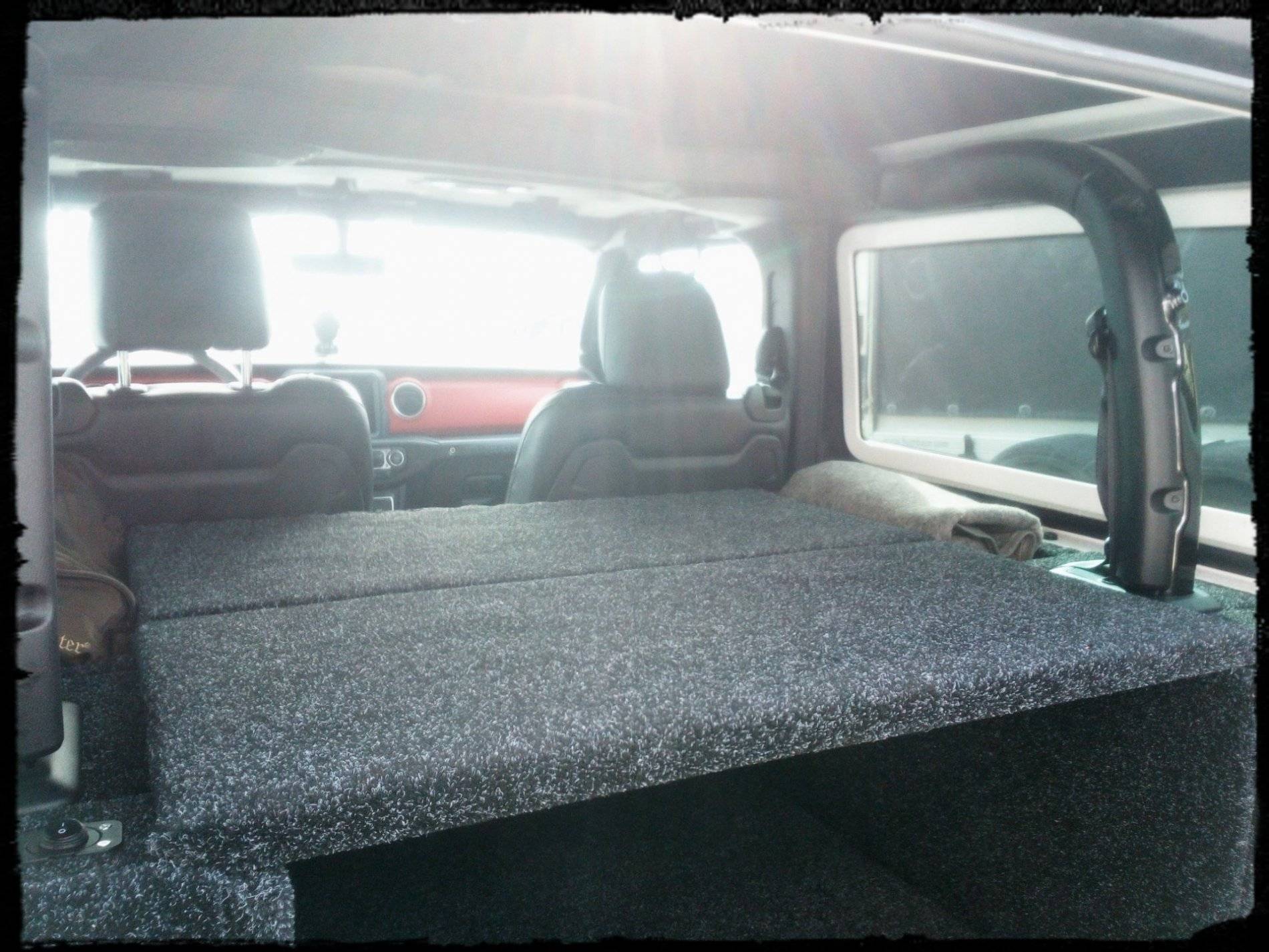

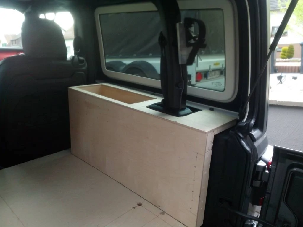

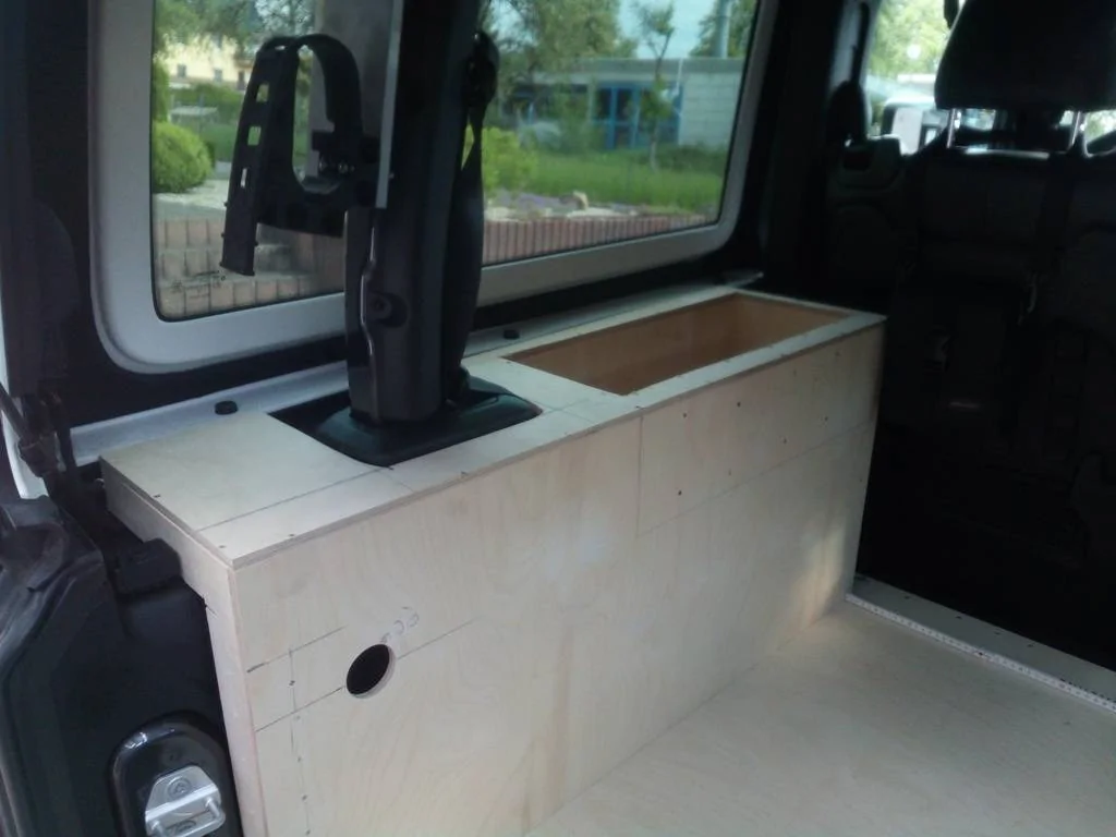

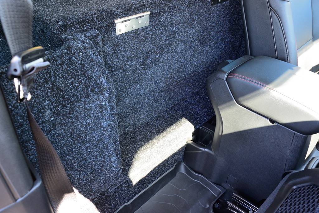

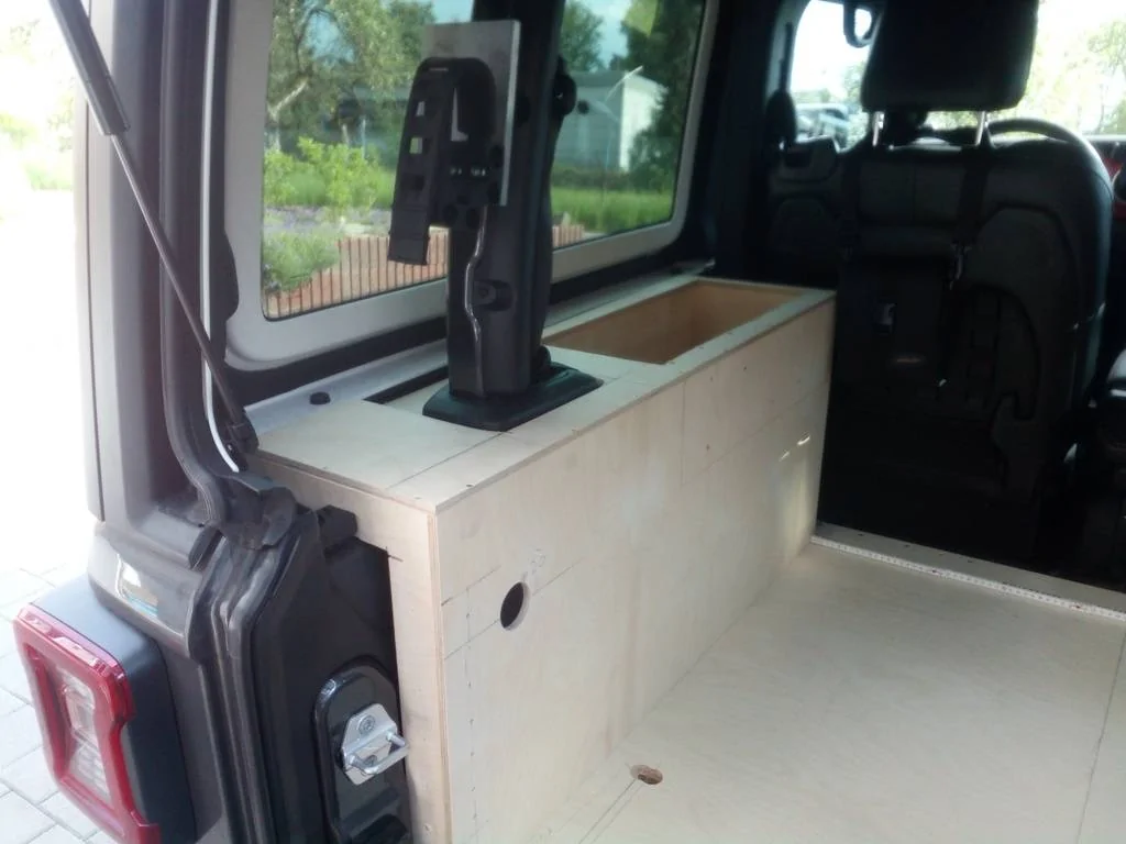

wanna show you the actual status quo of my plans to build a cargo drawer.
What has been done till now?
- base plate, mounted to the OEM cargo net points

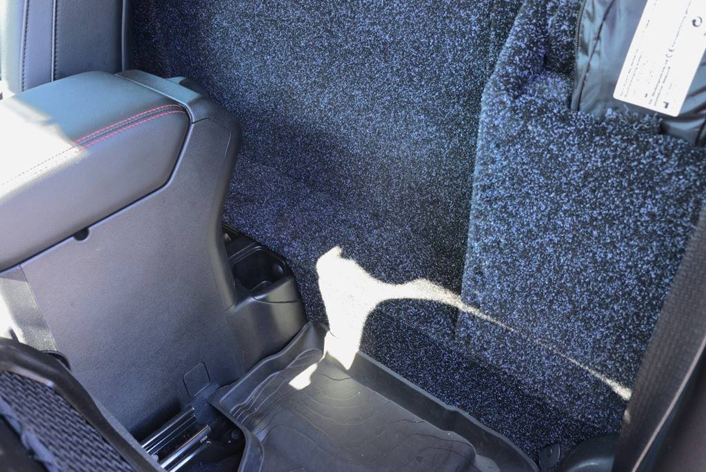

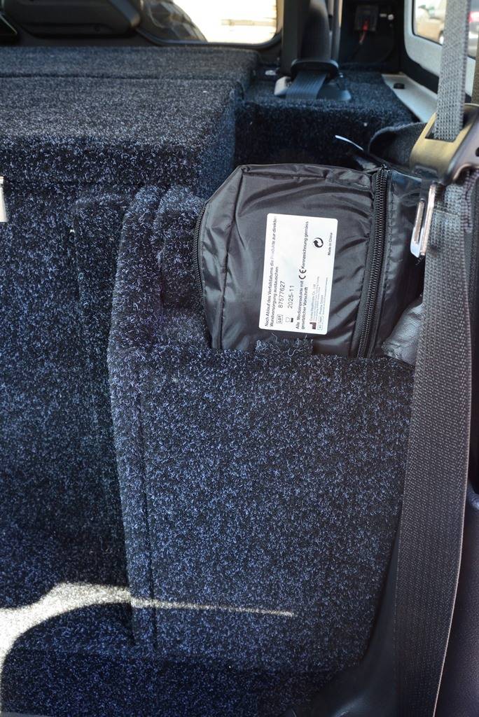

- left and right side panels with small storage compartments
- back wall to protect the seats and gain some storage between cargo drawer and seats
- foldable cargo plate that can handle about 100 - 120kg
- 12V 160Amp power supply and dual USB 3.0 charger
What still has to be done?
- drawer on the left for camping kitchen
- drawer on the right for some needed stuff
- airline system for fridge on cargo plate
- cargo net beween seats and cargo area to protect driver and passenger
