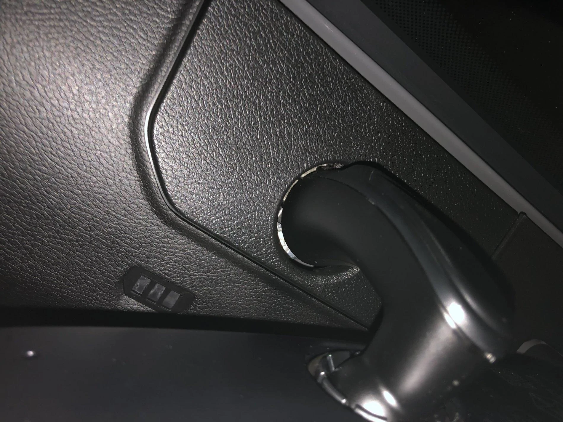

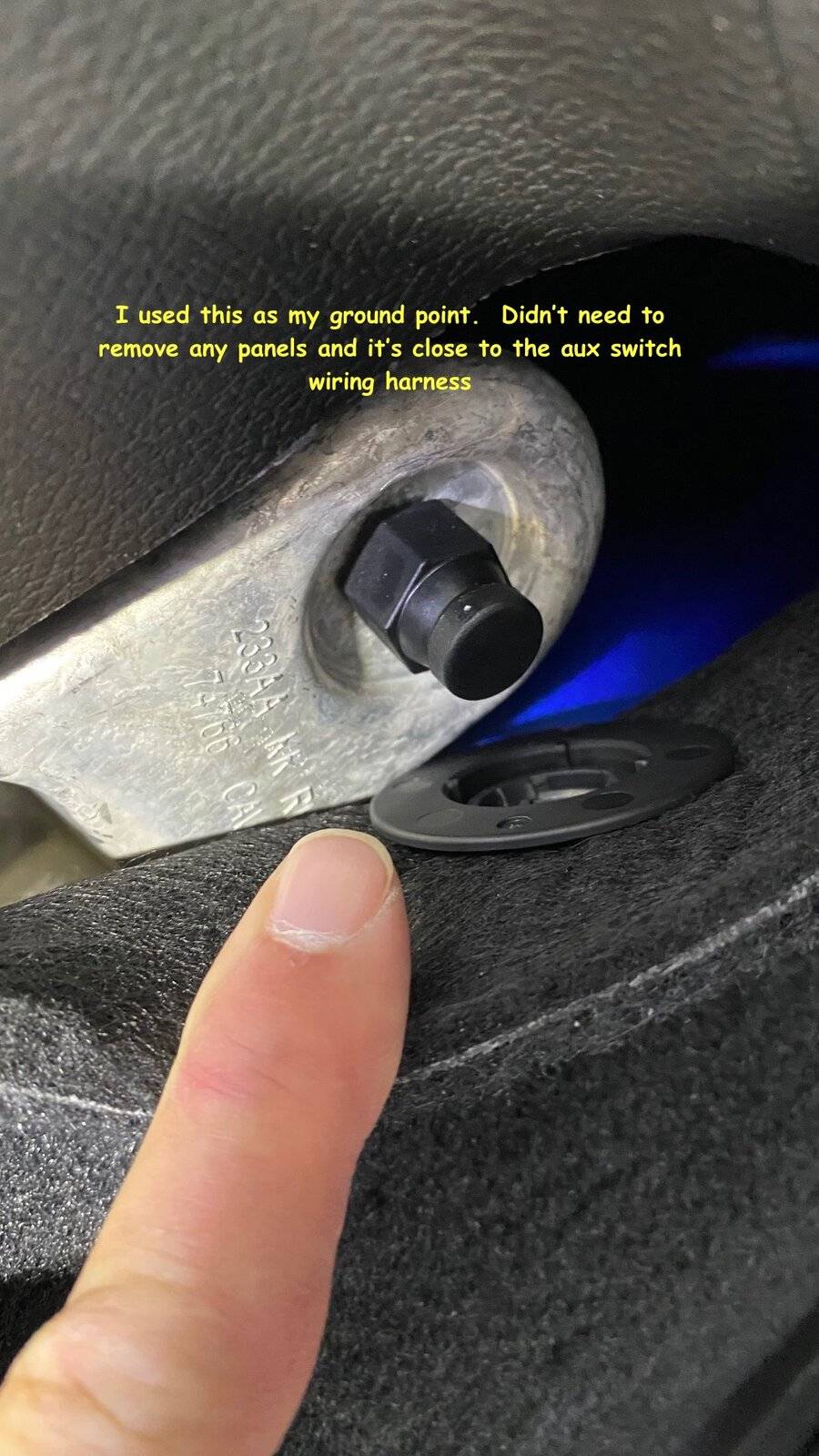

I want to share what I used as my ground point for my hardwired install. I used the bolt that's part of this carpet "button" on the passenger side transmission hump as it was really close to the aux switch internal wiring harness and didn't require removing the ride-side kick panel.

Thanks to this thread, I was able to install my dash cam (Blackvue DR900X-2CH) with minimal fuss. This thread was was great for figuring out where I wanted to tap into the wiring and where/how to route the wires. So thanks!

Can you show how you installed the cam and where it is? Thx!

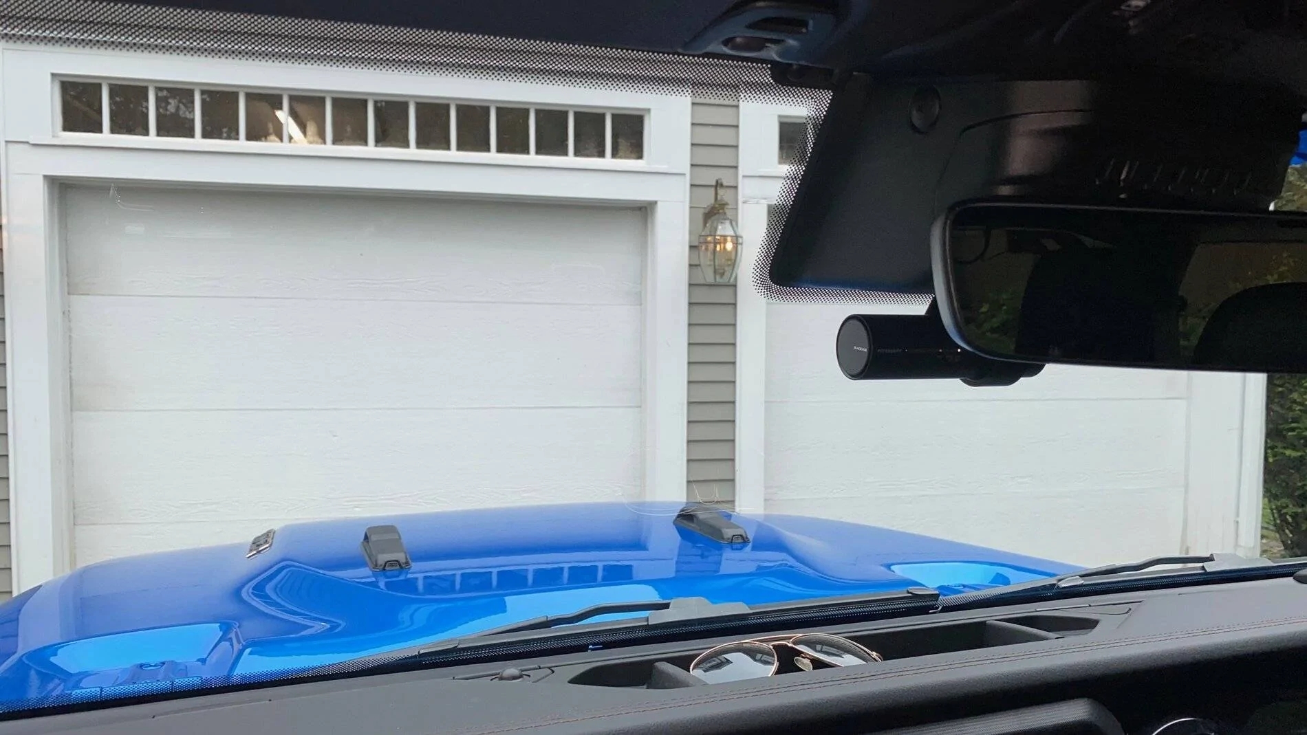

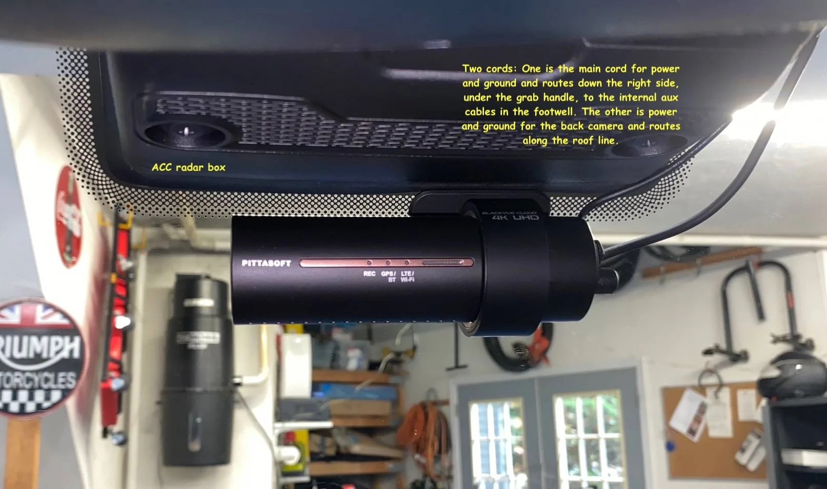

Placement: I installed it just below the ACC radar box. I didn't want it to obstruct my view or my passenger's. Looking from the driver's seat, almost all of if is behind the mirror which is what I wanted. There is a smaller back camera stuck to the back window (Center top of glass).
Routing: The two cables on the front camera go up to the right of the ACC box to the top of the windshield where they are just tucked in out of sight (no fasteners).
One cable is the main power and ground for the camera and routes down the right side, under the grab handle to the footwell where it ties into the internal aux switch bundle. Since that bundle was to the left of the footwell and didn't have much excess length, I grounded the camera in that area under the carpet button seen in my previous post.
The other cable is the power and ground for the back camera which I routed from the front camera, along the roof (passenger side), to the back window. I routed at the roof line instead of along the floor because both cameras are mounted near the roof.

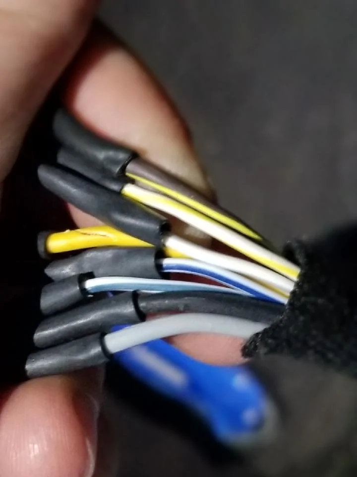

This is incredibly helpful! As a novice, I have a question about wiring my dashcam. I have the factory installed aux switches, and I found a wire bundle in the passenger kick panel, but my wire colors do not match what others have shown. Does anyone have this bundle type? (My underhood wire bundle does match forum pictures.)
Is there more than one bundle in the kick panel? Thanks!

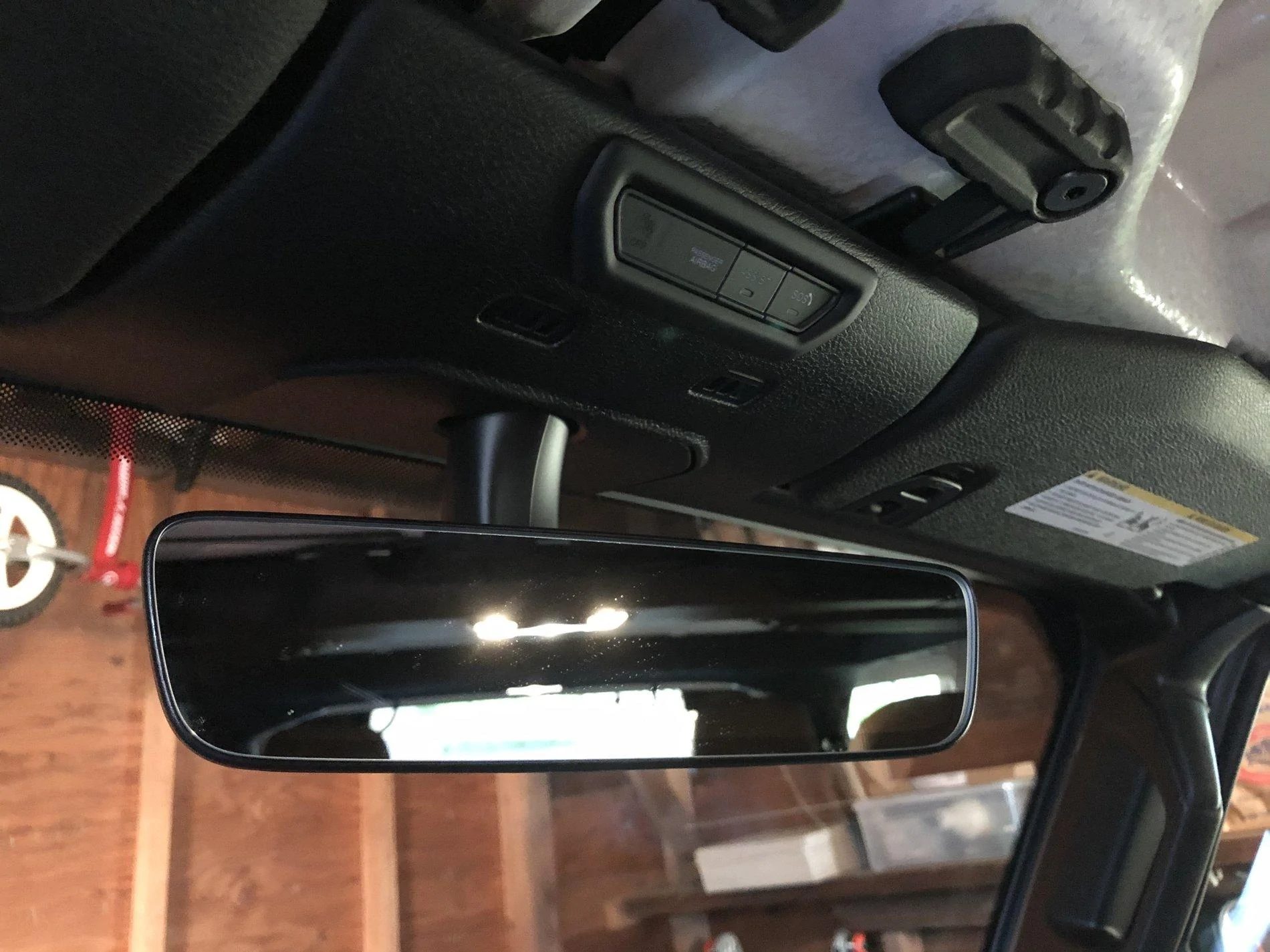

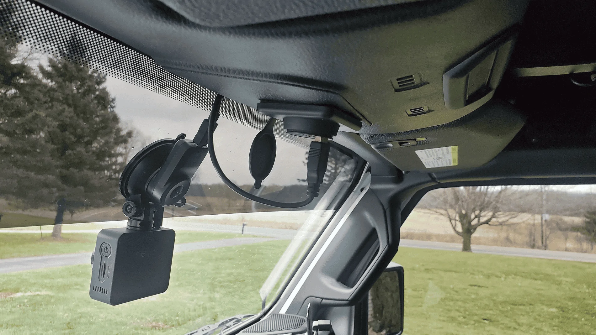

I removed my rearview mirror as I could not see out the back because of the bigger tire.
I installed a USB port in the spot where the mirror hooked in at and then plugged my dash cam into it. There is wires that you can easily tie into from the mirror. Even if you kept the mirror, it would still be easy to install a USB plug up by the mirror and tie into the mirror wiring.
