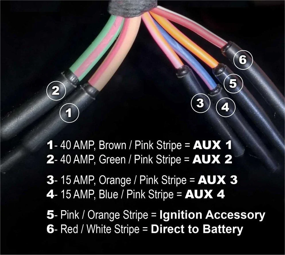

@Texcal
With factory installed Aux, in the front passenger foot well, you will find the Aux bundle. This bundle has a Direct to battery wire, an ignition switched wire and also Aux 1, 2, 3, 4 wire.
No settings need to be done in UConnect for direct to battery and ignition switched wires.

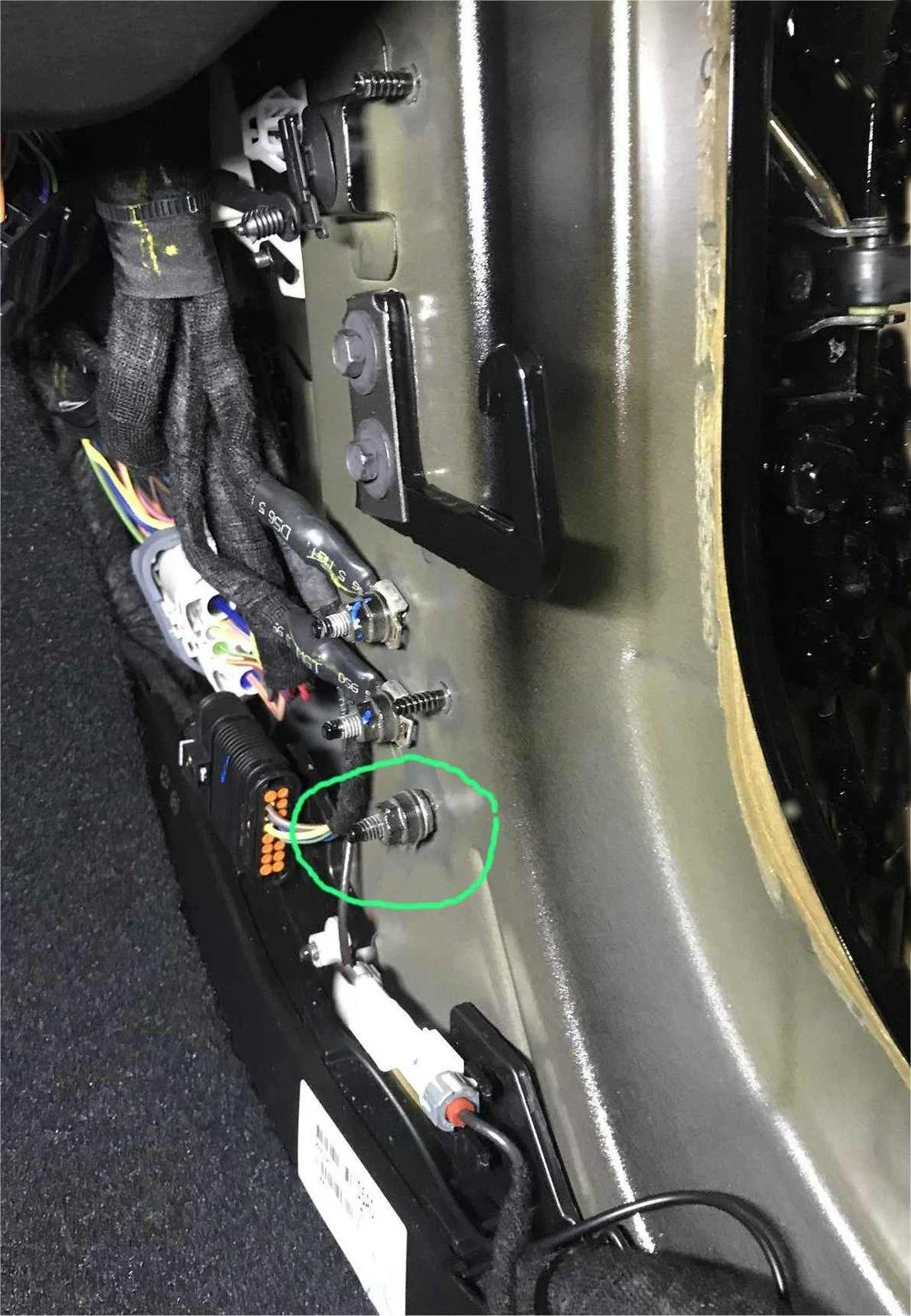

There is also an easy to access, ground point in the front passenger foot well.
By the way, you will find an Aux bundle in the engine compartment, right by the Main battery. That bundle only has Aux 1, 2, 3, 4 and no direct to battery or ignition switched wire.
Here is a pic that shows wire colors and Amp..
Jeep Wrangler JL Can i splice here for dashcam? 12v source wires
Here is pic of ground point in front passenger foot well:
Jeep Wrangler JL Can i splice here for dashcam? footground
