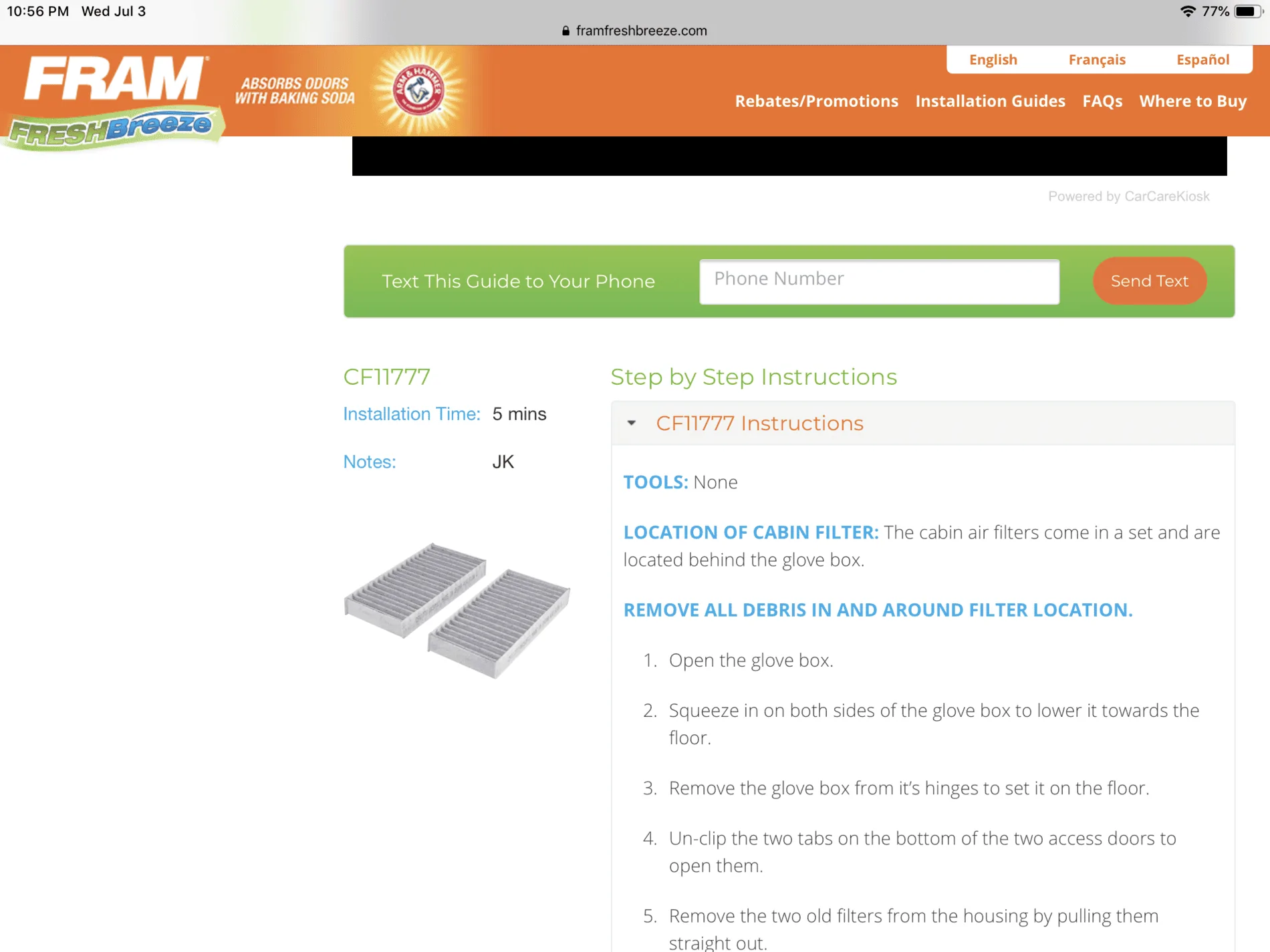

Yea I know 2018 Wrangler in their system is for the 2018 JK. Bosch makes the same mistake when you use their product finder. You have to select 2019 which they don’t have a product for. Just read the comments on amazon, many people bought it (including me) and found out the hard way.
Many dealers and service reps couldn’t differentiate the 2018 JL and the JK, don’t expect third party websites to..

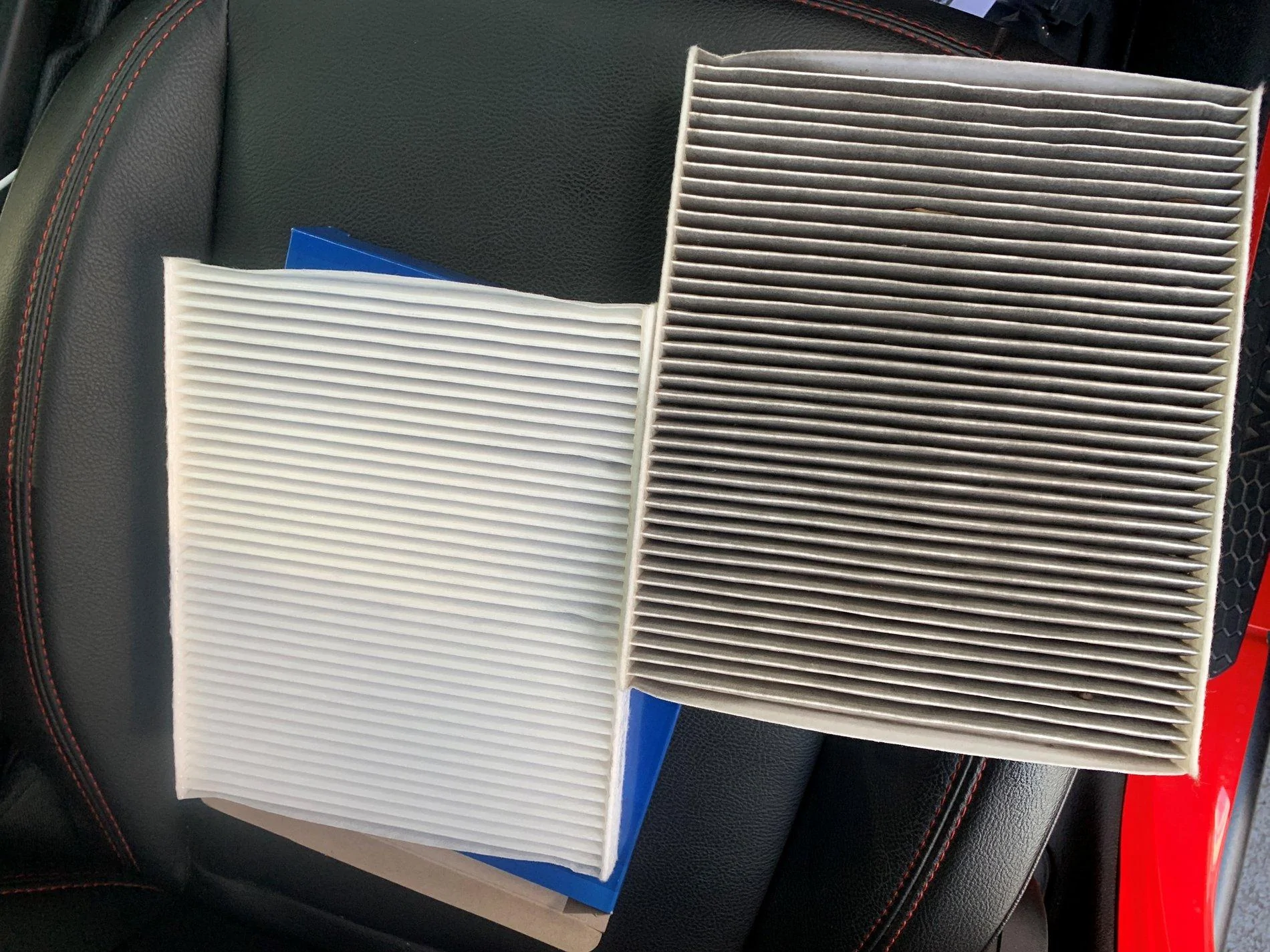

So I was a little lazy with doing anything with the cabin filter on my JL. After seeing how this thing looks after only 12m/12k miles I think I'm going to be replacing every 6 months going forward.
Sure the manual says every 20k miles or one year, but let's be honest is $10-$15 extra a year REALLY going to break your wallet?

Nobody seems to know anything about the filter in the JL, but everyone has an answer. The end-result? Poor sods like this:
This is for the K&N, I just ordered one.
K&N VF2064
who are now waiting on a package they'll be sending right back to its point of origin.
UPDATE: I'M THE A**HOLE; K&N VF2064 FITS. PAY ATTENTION TO THE DIMENSIONS IF YOU ORDER ONLINE! Be skeptical if the picture has two filters (the OEM filter is one nearly square filter) but check against my measurements below for a sanity-check! As of this post (28-Jul-2019) Autozone et al. still lists the JK filter for the JL! If you just want to go buy a $15 FRAM filter from Walmart or $20 STP from Autozone, refer to the list below.
Every store I've seen is selling the JK air filters. I bought an air filter from Autozone that they'd looked up with their system (which is not unlike their site's search system), and when I got home is when I made my JK-filter moment.
