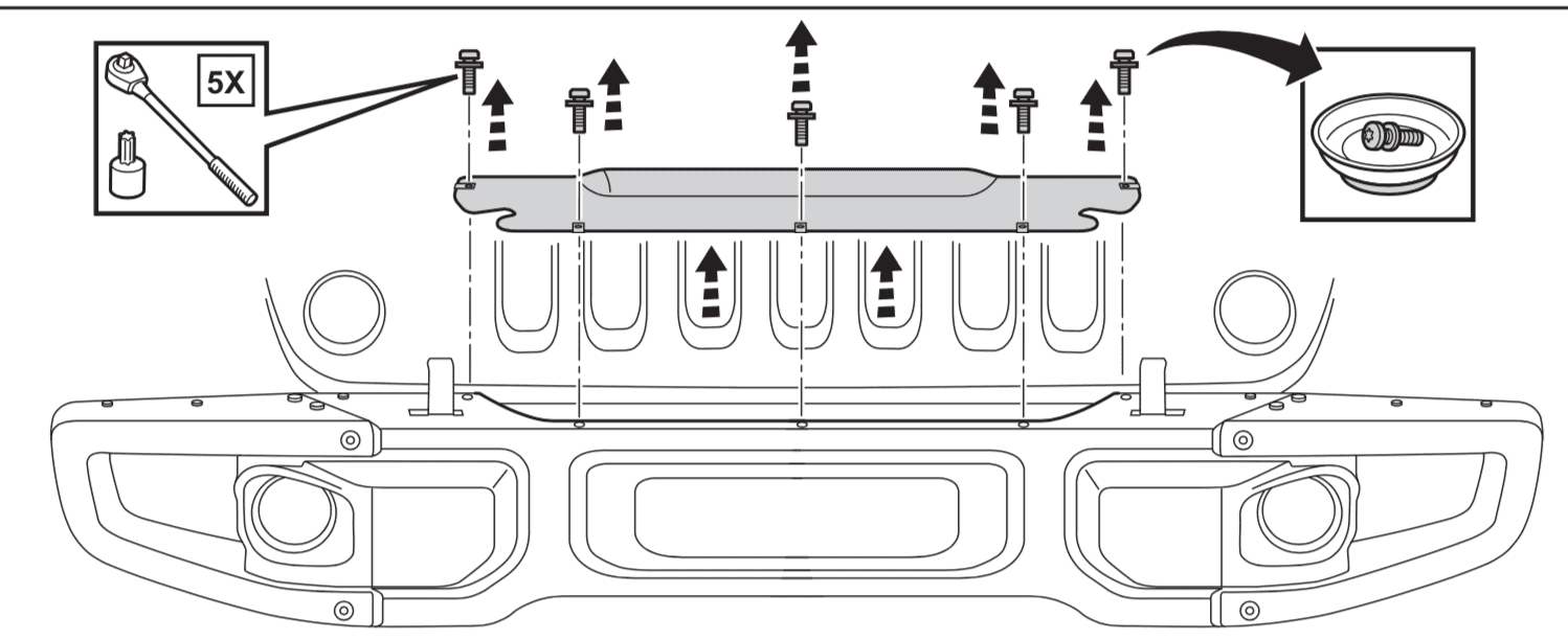

I can't find the thread at the moment, but I know some folks on here have removed the "strip" that's in the middle of the plastics front bumper, giving them access the bolts underneath to mount brackets to.
This is the diagram for the steel Mopar bumper, but the plastic one also has a similar piece in the middle.
