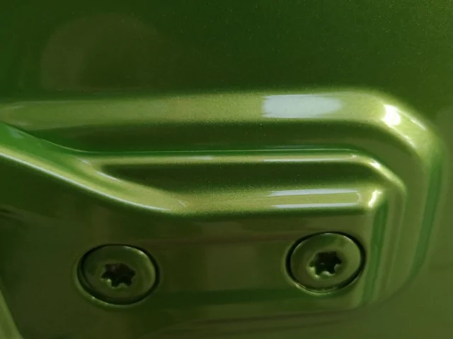

Is the hinge painted after being mounted to the door? If you were to remove it ot put grease being the contact surface with the door, the paint seal/seam would be broken?
It’s painted after it’s all mounted
In my experience, there was no “paint seal” between the hinge and the door. Some say you’ll damage your paint around the hinge when you take the hinge off, but I didn’t have that issue. It’s not even painted well around the hinge, you can see some of the bare metal even with the hinge on. I don’t think you’d have an issue taking the hinge off if you wanted to put some sort of sealant on the bare metal. Toughest part is breaking the torque bolts

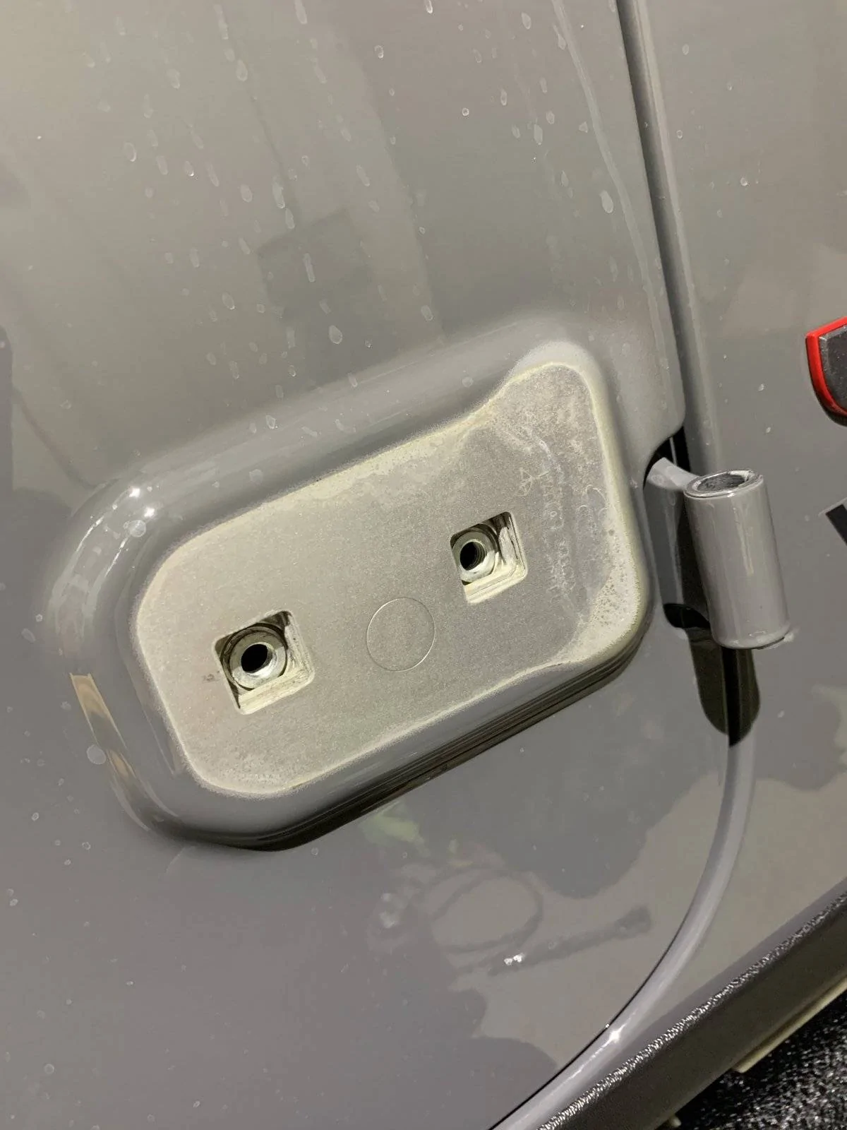

That would be my main concern is causing damage to the paint once the hinge is separated from the door. Don't want a noticeable area that shows a crack in the paint. Is the FluidFilm ok to use without removing hinges and breaking the paint?
Yeah it’d be fine to use fluid film without removing the hinges, I’m just not sure how far it’ll penetrate underneath the hinge. This what it looks like after the hinge is removed. The white residue is some glue that they use from the factory. It broke really easily once both bolts were out. Other than that, there’s no paint damage at all. Only concern would be the paint on the torx bolts. They really didn’t look bad at all, at least on sting Gray. I did have them powder coated black tho and I used a latex glove on my torx bit when I put them back on so it wouldn’t f up the paint

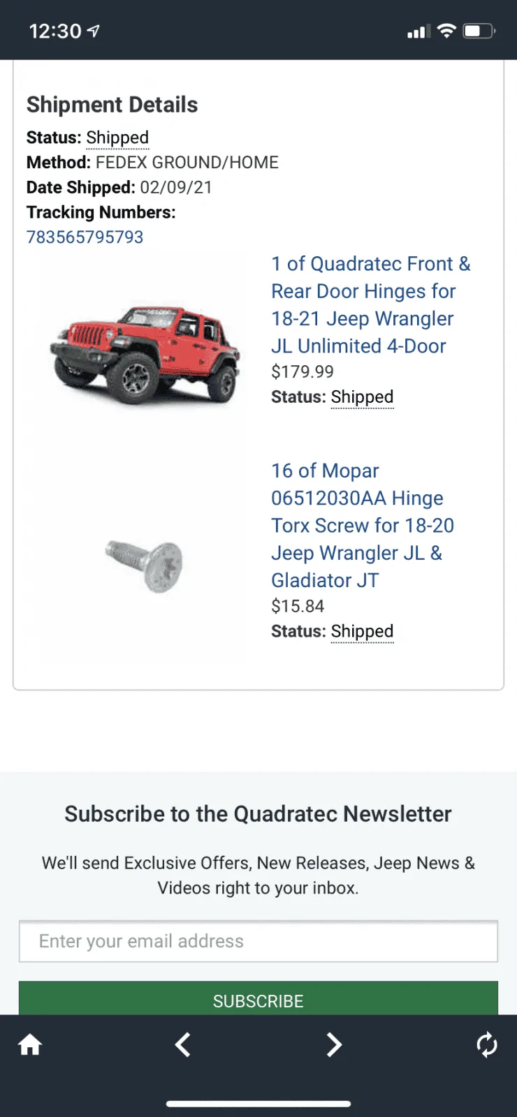

Andy,
Can you tell me which hinges you bought?
Also did you buy new bolts or reuse the existing? I would like to buy new and need to know the size.

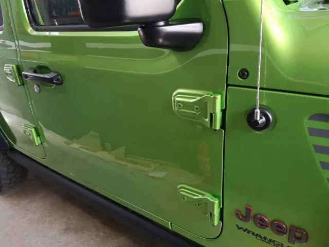

Sure, happy to help. This is what I got, all from quadratec. They are zinc die cast hinges, they come black but can be sanded and painted
