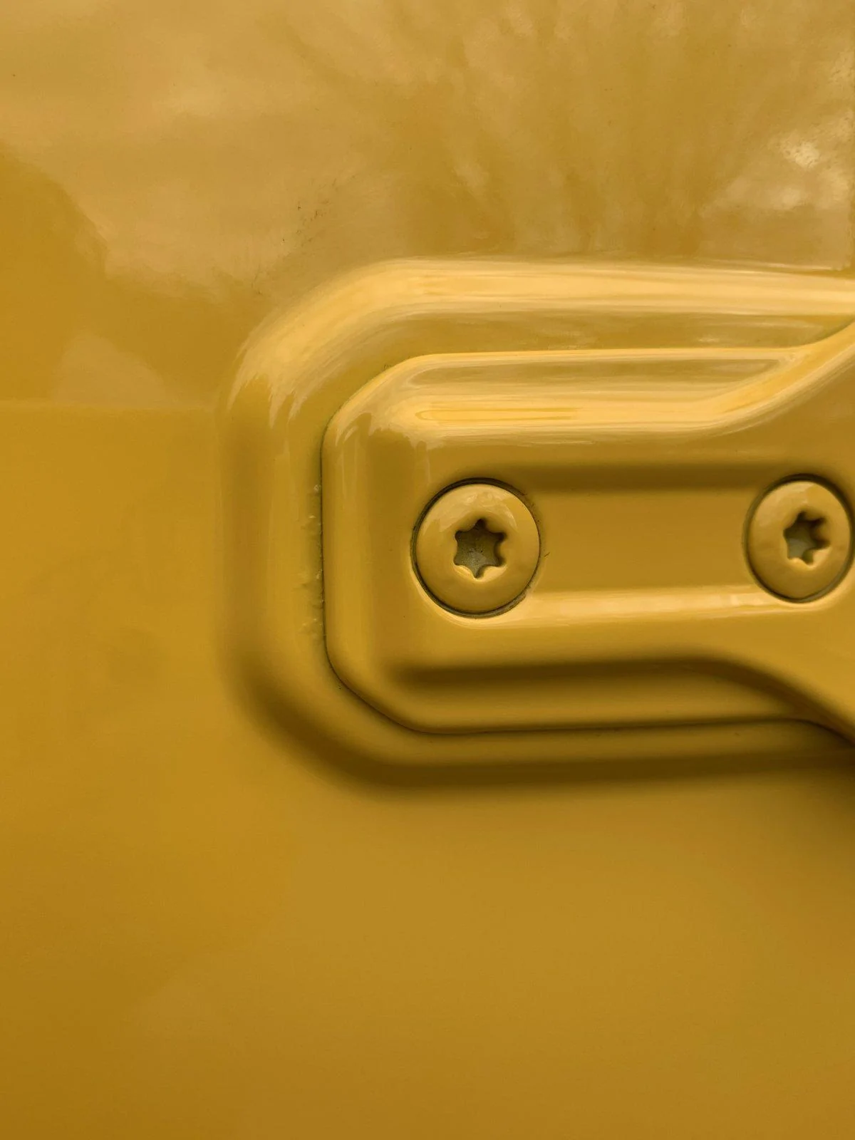

Looks like I have some paint bubbles starting as well. So far only 1 hinge.
Pretty sad since I keep this in the garage as it is my 3rd car. I think this has been only driven in the rain 3 times.
