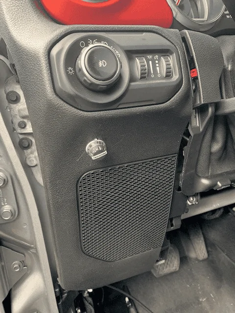

Anyone install a Prodigy ID yet? I'd like to do it over on the left side under the light switch, if possible (this is a Redarc in this pic; I like the Prodigy ID better with it's digital screen). I have not taken delivery of my JLURD yet, but I will check this out.
