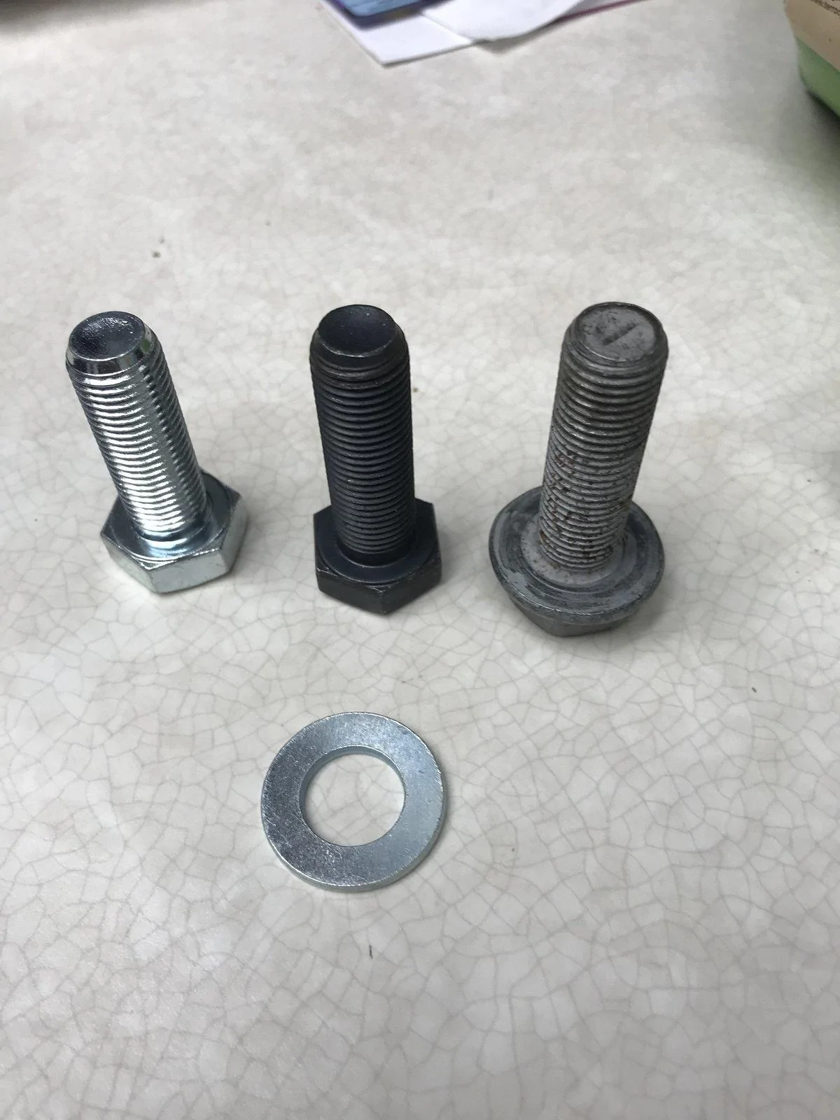

Unfortunately it fell out.
I found the size though. M14 1.50 x 40mm
Had ace hardware size it. Found a temporary solution luckily. Hopefully jeep has some in stock Monday.
Used the middle bolt. Factory is on the right.
Jeep Wrangler JL Brake caliper bolt size 7FADB762-2BBA-4BA5-A392-BC8977C6BD94
EZMFE
Oct 31, 2018
304
235
UT
Good to hear you have a temp fix :like:
Could you let us know the part number they give you at the dealer? I'm curious to see if one of these - 6104257AA, 68004084AA
