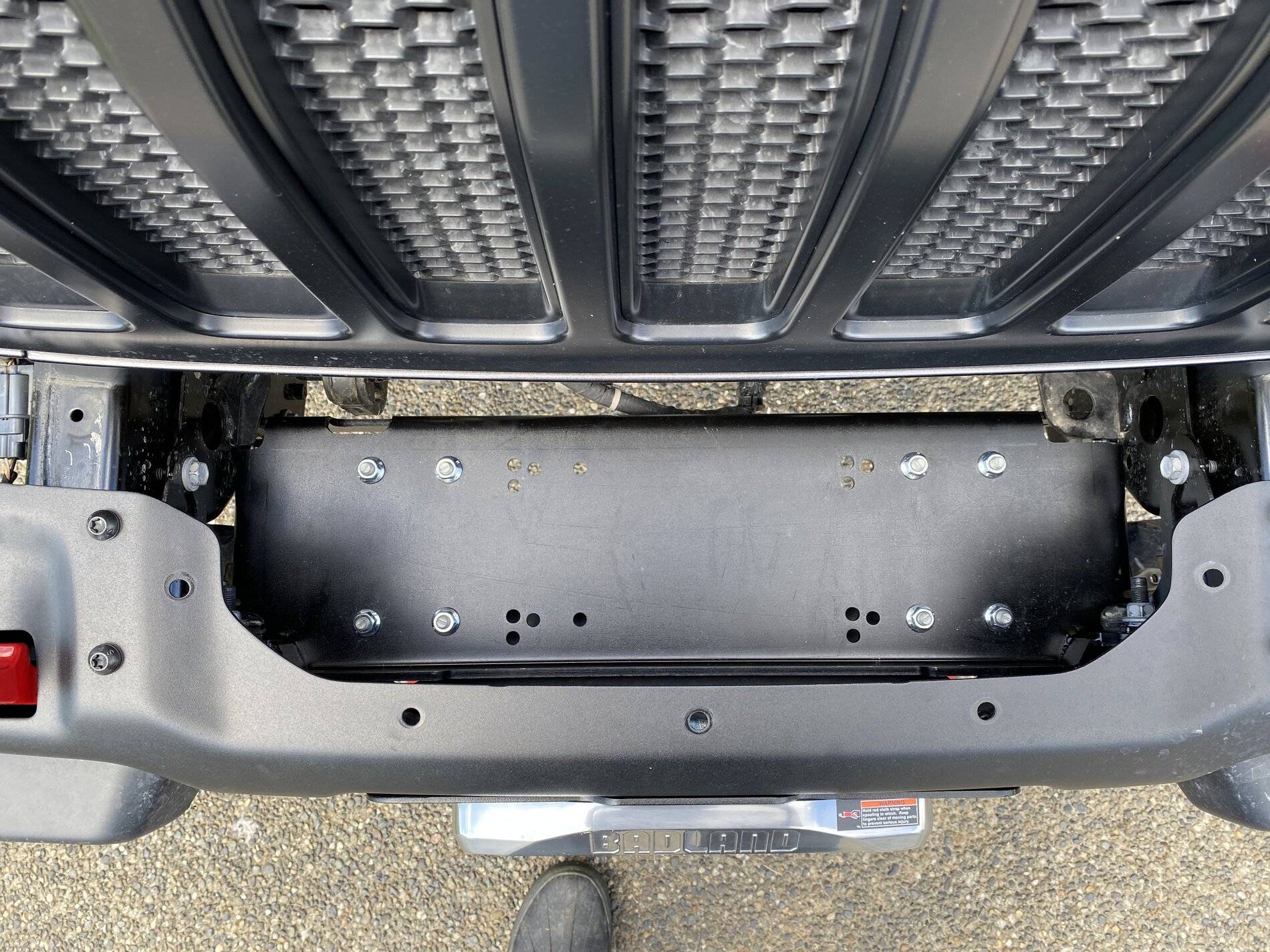

First Steps) Clayton Offroad 3.5" overland+, 37" Irok Radials, Hutchinson Rock Monster 17x8.5" wheels, 5.38 gears, Apex 12k, Maximus-3 Winch plate (purhcased), Iron Cross tire carrier plate, ViAir 400p Automatic (purchased) with 7-pin adapter
At this point, my wife's family farm came up for sale and I had to stop purchasing things. The winch plate sat in my garage, and I was basically back to concept 1. I had bumped to the 3.5" lift because I thought the flexibility would be nice of exceeding 37" tires. Some of my first outings I was already dragging my belly. I was starting to read about driveshaft issues with 3.5"+ lifts. I thought I'd operate as-is until I tore my CV boot, then upgrade.

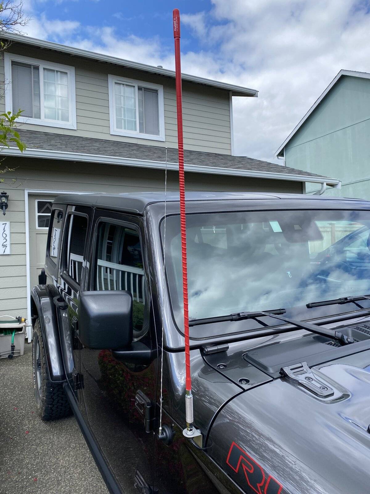

I had my CB radio installed at this point. The Maximus-3 Geo-lift convinced me that the drop-brackets for the front control arms helped pinion angles enough I didn't have to worry about a new driveshaft. I chose to drop to the 5.13's because of the slightly higher strength (to my understanding), and I realized to push beyond 37" tires would put me in a position I would need to consider axle upgrades. It seems 37" tires can be handled with the JL D44's if you're careful, but I'm not so confident in 38.5 or 39.5 sizes. The DV-8 tire carrier didn't require a new bumper, so that seemed prudent. I also bought the hi-lift brackets from Dominion Offroad for tucking under the hard top.

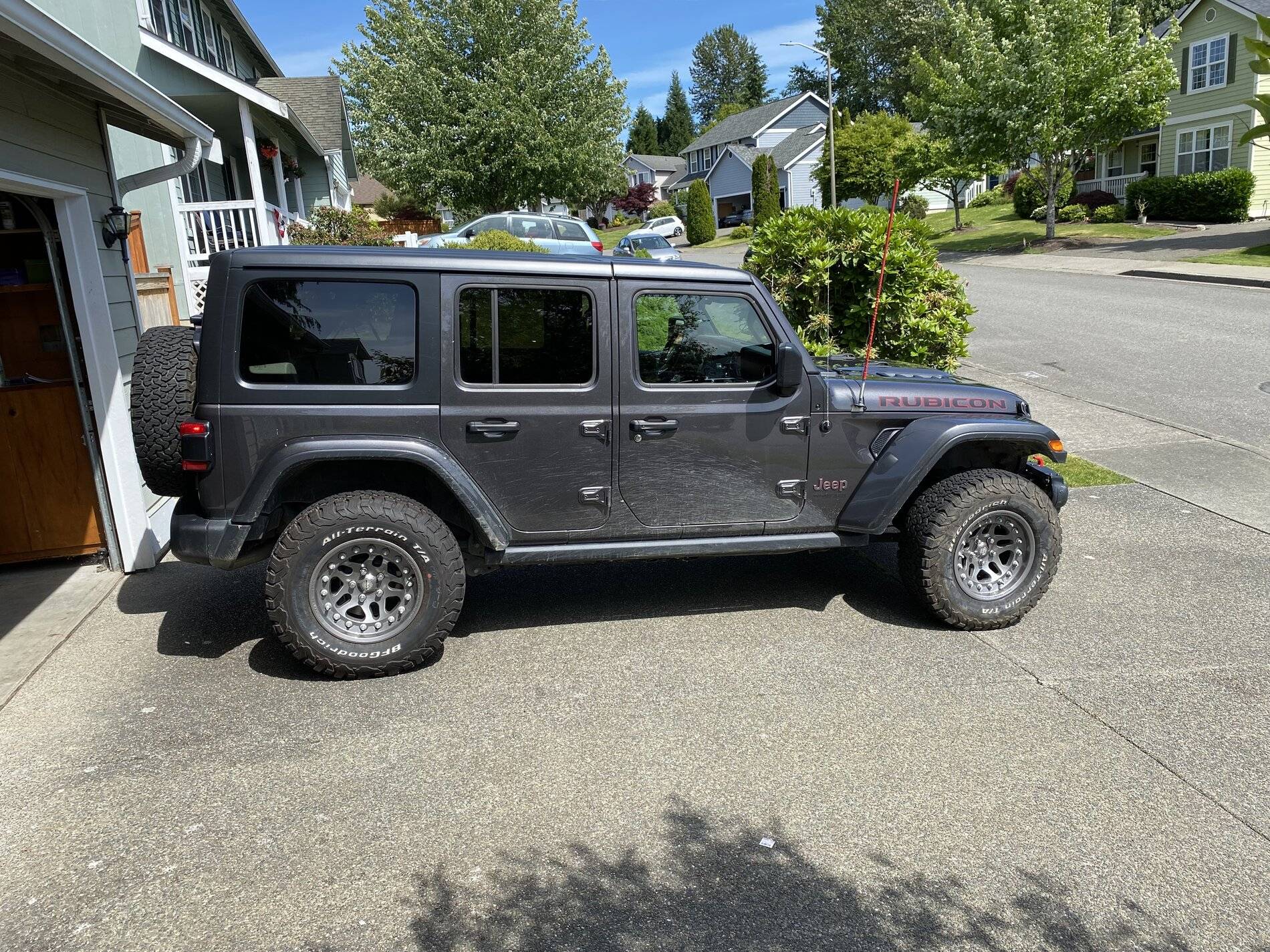

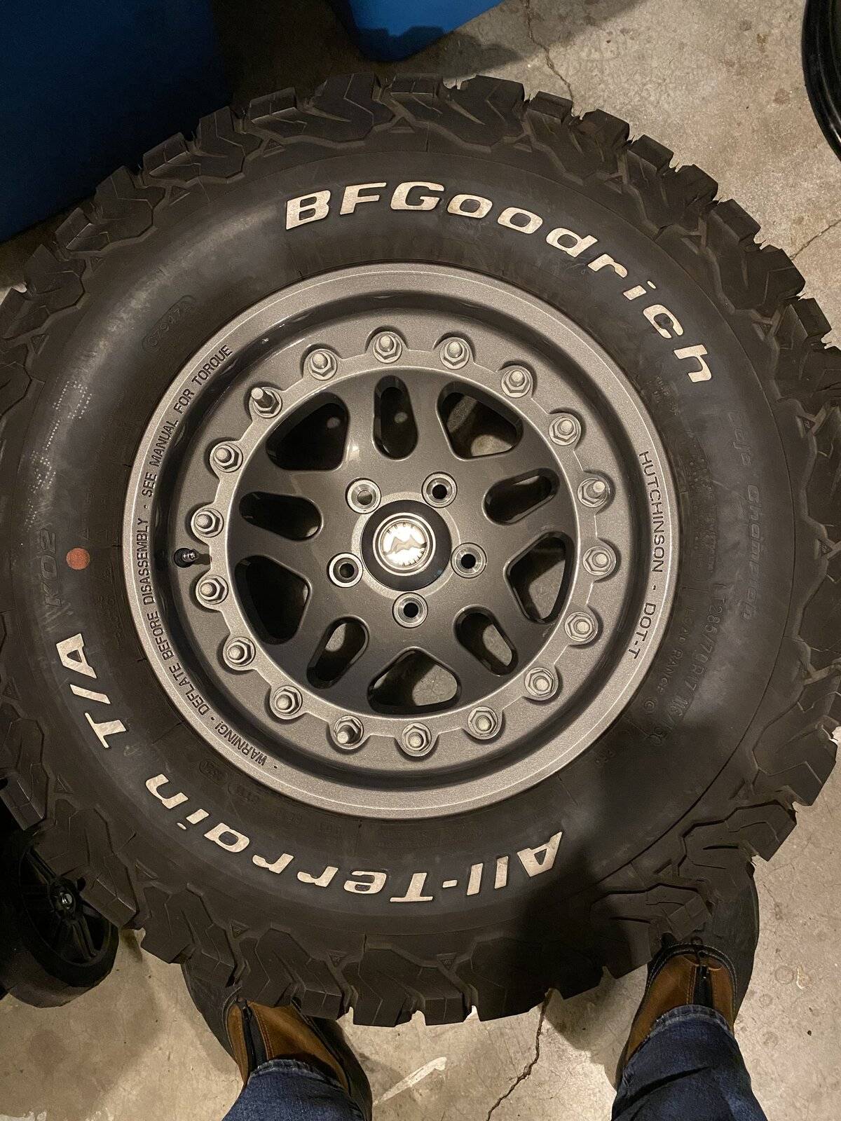

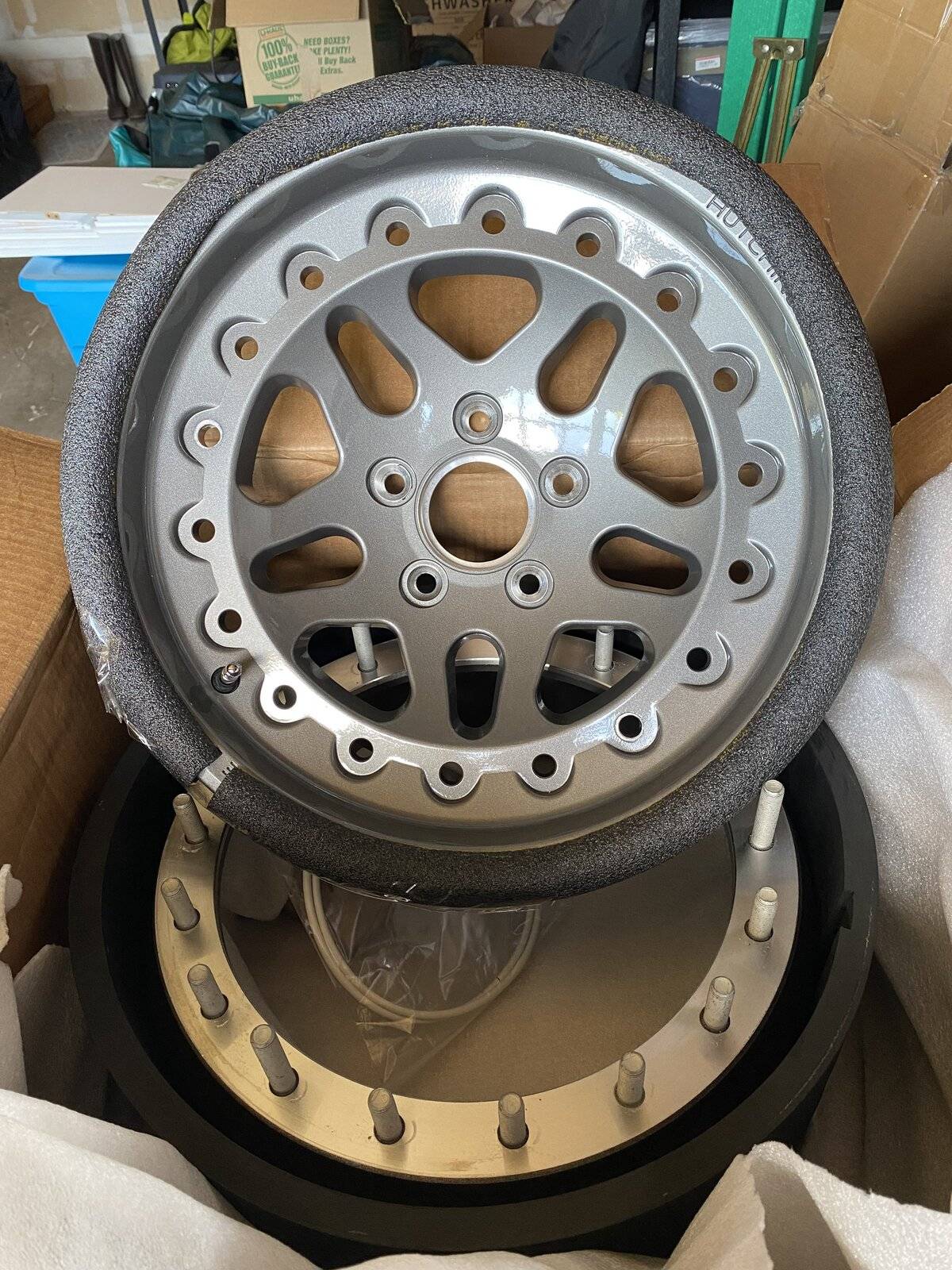

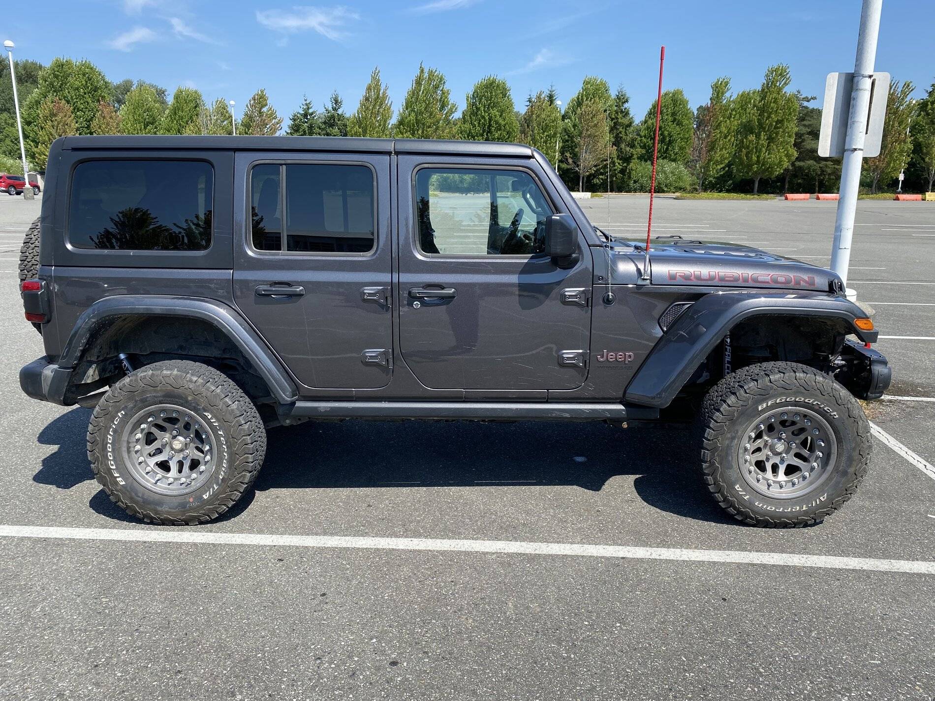

Got my wheels installed. That was a workout dismounting those tires. I'm glad I never have to fit a bead over a wheel again.
I started by doing a spare tire during the week. I discovered that the new wheels don't fit on my stock spare tire carrier. The stock rims do though. It looks like I have a bent lower bolt.

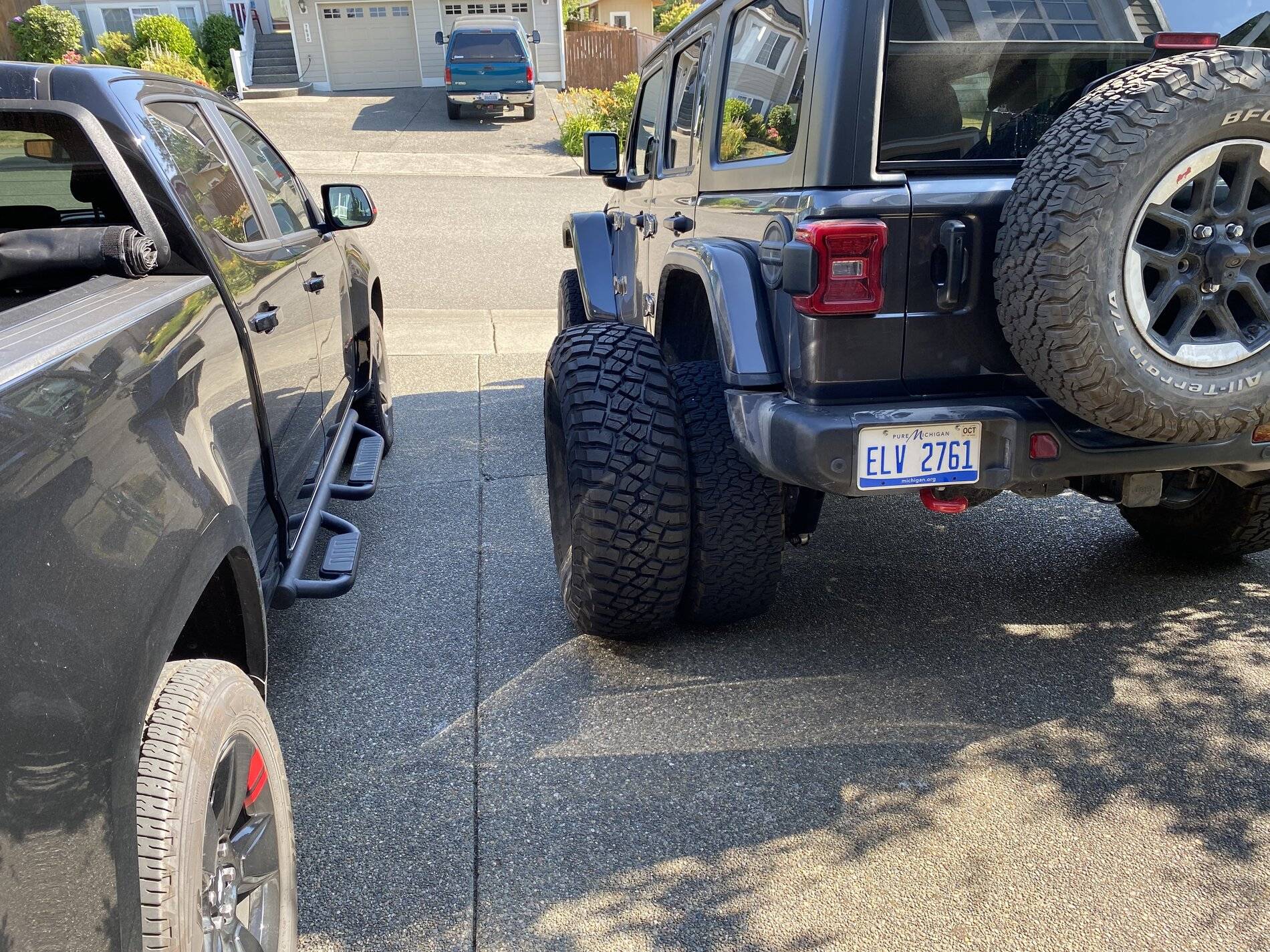

The new wheels are reduced in backspacing, so they do stick out a tad. Here are some photos when I only had the rear wheels mounted:
I've still got to do a shakedown run to make sure TPMS is working correctly. I had a brief period where I thought one wasn't, but I just had to restart the jeep and keep going. Once I had the next wheel on, the rear driver started working correctly.
I forgot to take a photo, but with the wider wheels I think I the tires run taller now. I had 2 next to each other and it looked like I gained about 1/4" to 1/2", both were aired up to 40 lbs.
Working on an incline was a bit scary, but I found the flattest part of my driveway I could and used wheel chocks. Now I'm smoked. That was a lot of 100lb+ bolts to torque multiple times. To anyone else thinking of doing these wheels, I'd recommend suspending the Jeep on stands or a post lift while in 4WD. It would have been a lot easier to torque the beadlock bolts on the Jeep than just loose on the ground like I did.

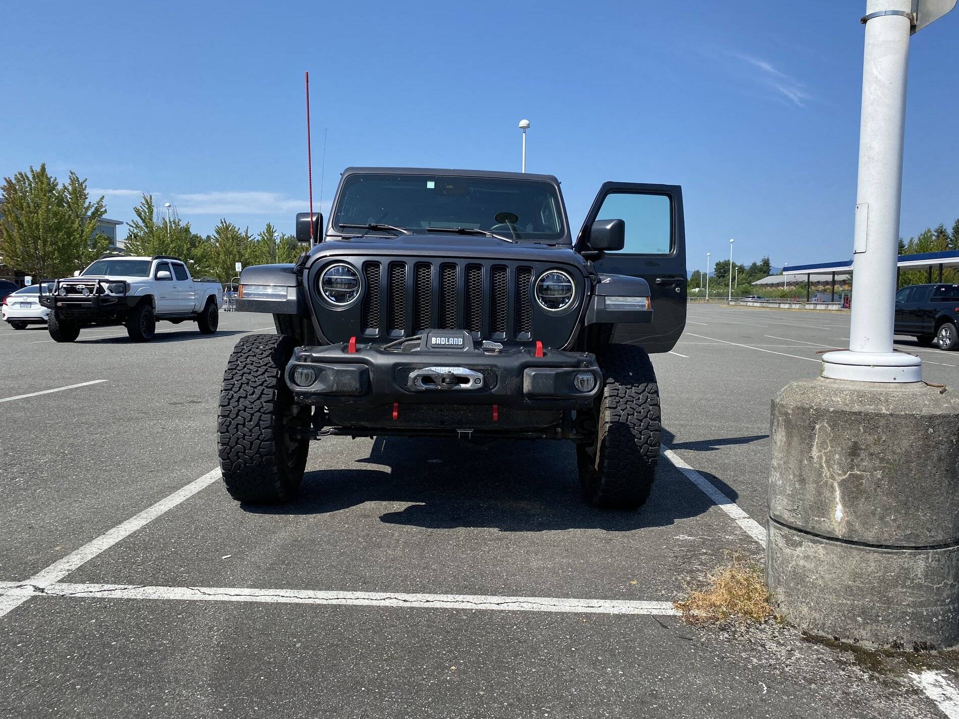

Lift and Tire Carrier showed up today. This weekend might be busy, but next up is the tire carrier instal. Jeep is going in for a bad purge flow valve tomorrow. Possible Timber Tamer run on Saturday. Either way I might get out Friday to Rieter for a bit.
Hi-Lift stripped a bunch of its paint off during tire bead-breaking duties. I’m not sure if that’s a defect or a mark that it actually gets used.

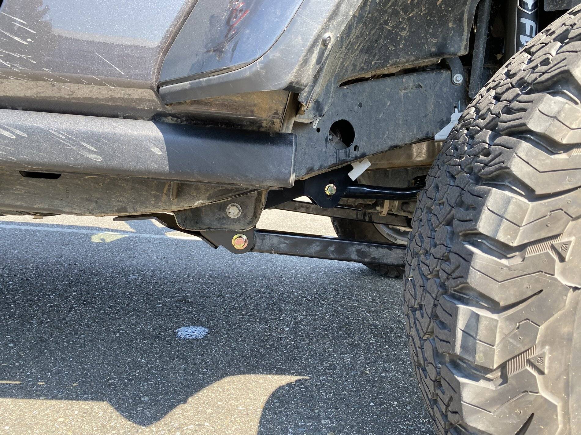

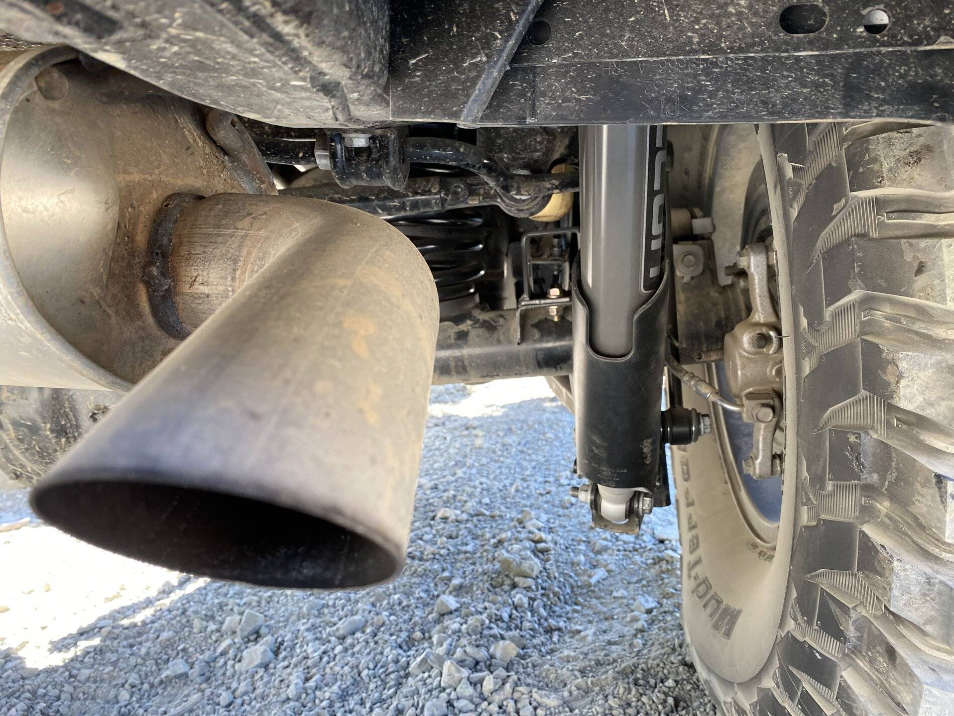

The lift is on! It took me 2.5 days, but it is done. Maximus-3 makes a great product. Instructions were definitely made for someone experienced though, which is not me.
I think I have to find the bolts that go to the auto transmission crossmember from the dealership. My manual didn’t have them, so I think I need them to finish bolting the correction brackets down.
It drives better than factory. I can’t explain it, but it “feels right” now. It corners as my instincts say it should, stays more stable, and it squats/dives in a much more natural way.

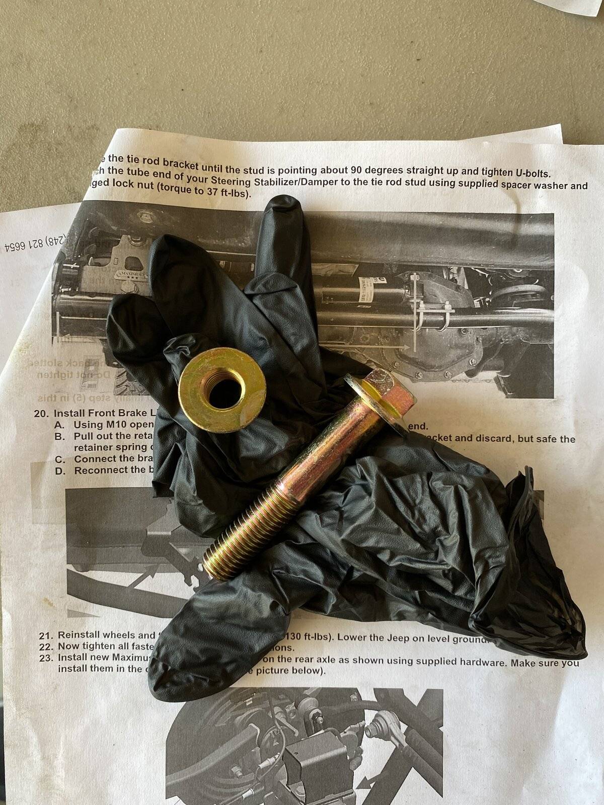

Only 1 mystery bolt. I think it was supposed to go on the steering stabilizer after relocation. I re-used an original bolt set there.

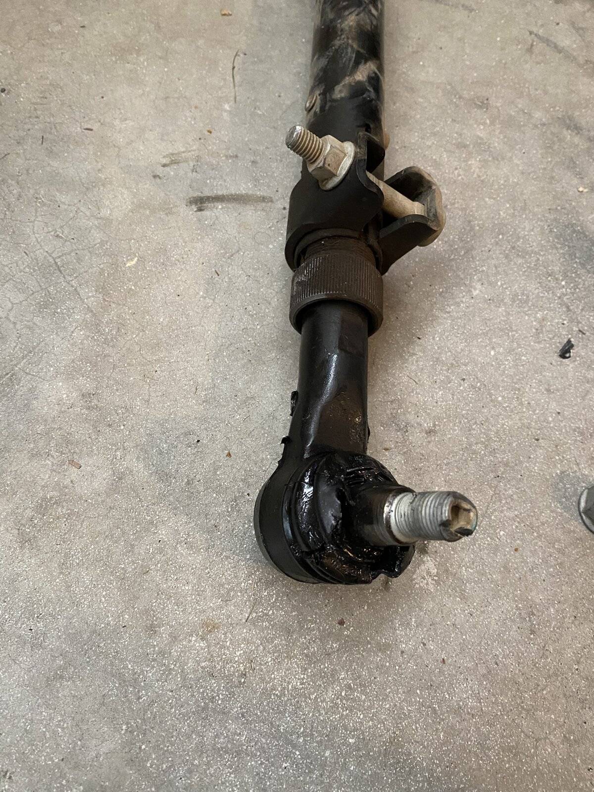

Mangled my factory draglink trying to get it off with a pickle fork. Ball joint separator did the trick though! I lost about 4 hours to that because my wife was out with her mom when I realized I was at a dead end.
KM3’s were ordered today after I verified I would only have to worry about bumpstop. They’ll be here next Friday. Might need to find a step that works with my sliders. It’s novel right now, but will probably get old. I may not clear my garage when I’m done, oh well. Made the hoist a bit of a waste though. I can look into moving it to my storage unit.
This was quite fun. 1 year ago I didn’t know what control arms, drag links, or beadlocks were. Now I did this!

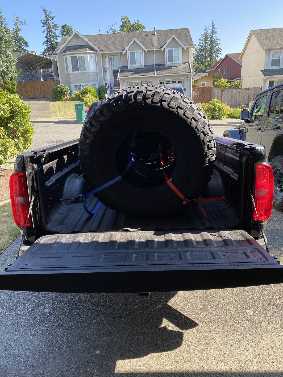

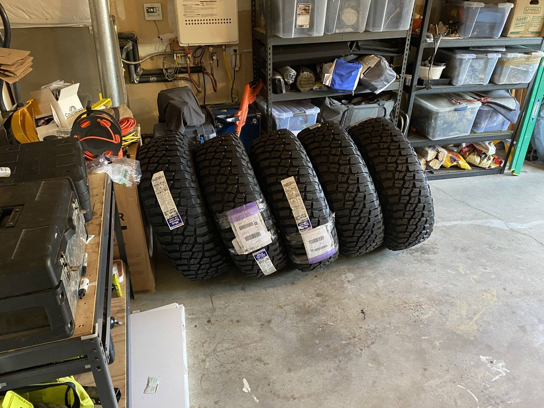

Tires arrived. Sliders arrived. I work this weekend, but I’m off next week. Tazer is all updated and ready to go once I swap tires. I’m hoping to spend 1-2 days in tires and then do my tire carrier. Sliders might happen after work between now and Monday, I think I only have to drill 1 hole through both sides of the frame.
Thankfully my wife has a long bed truck. It was snug.

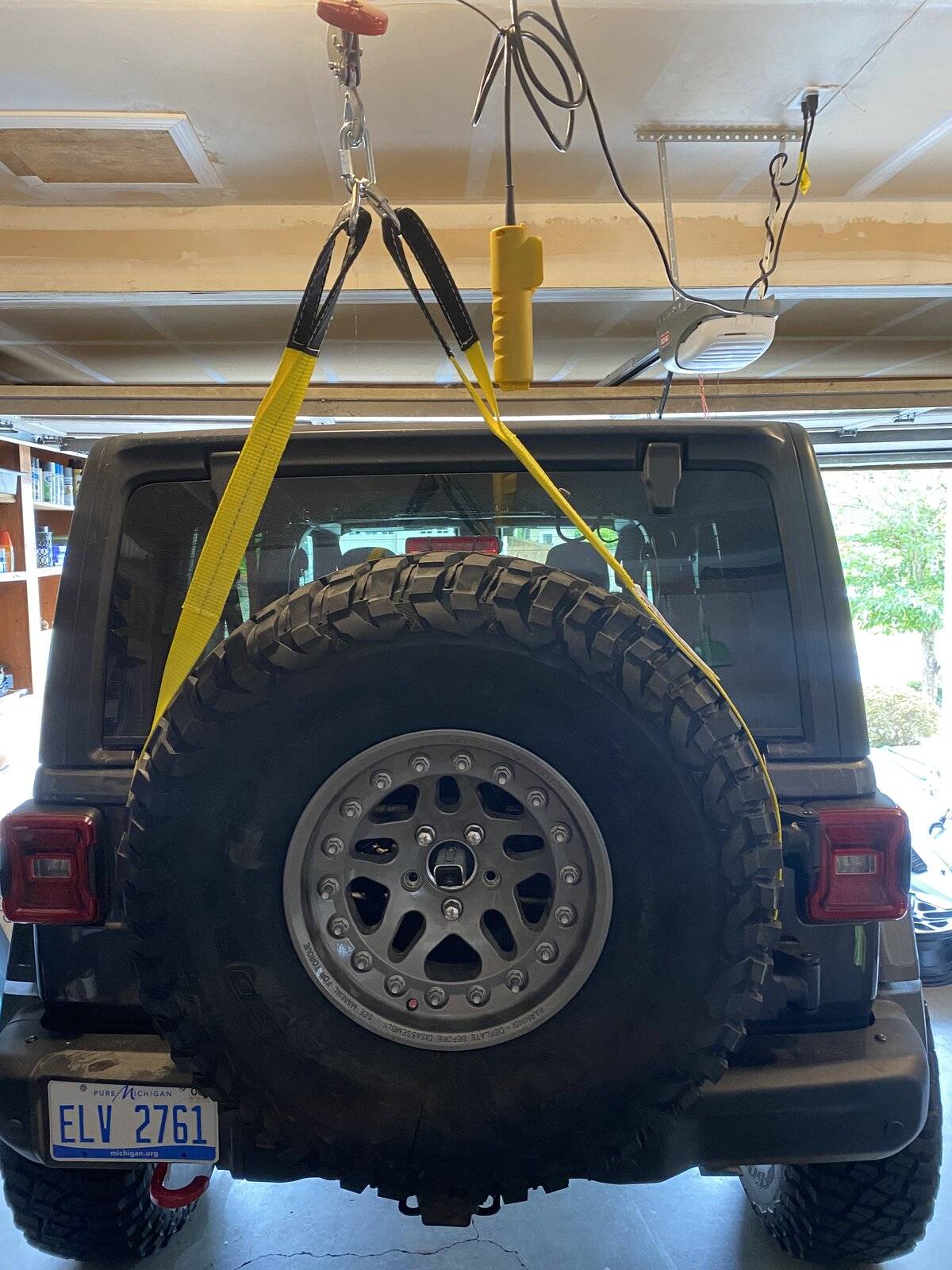

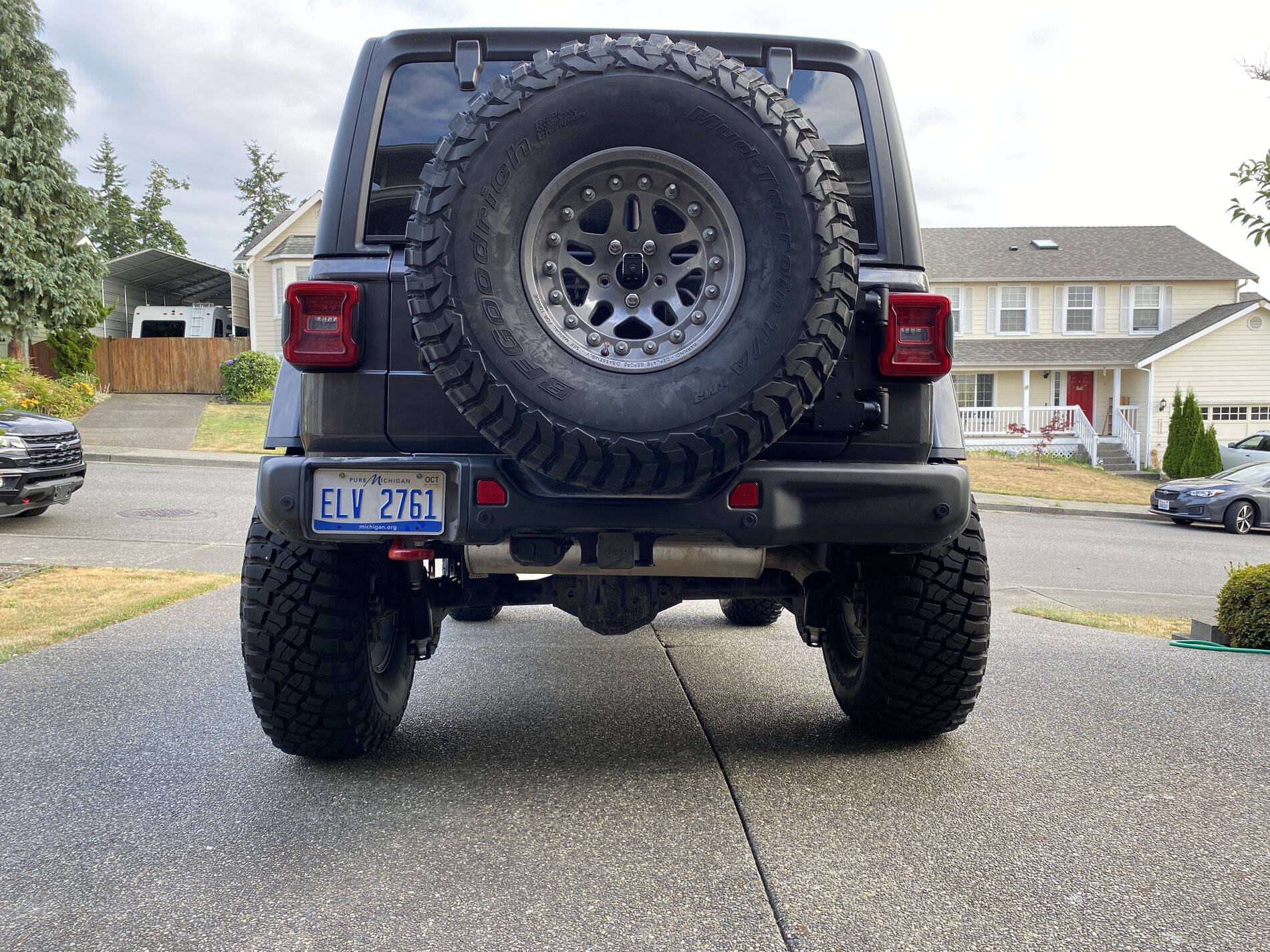

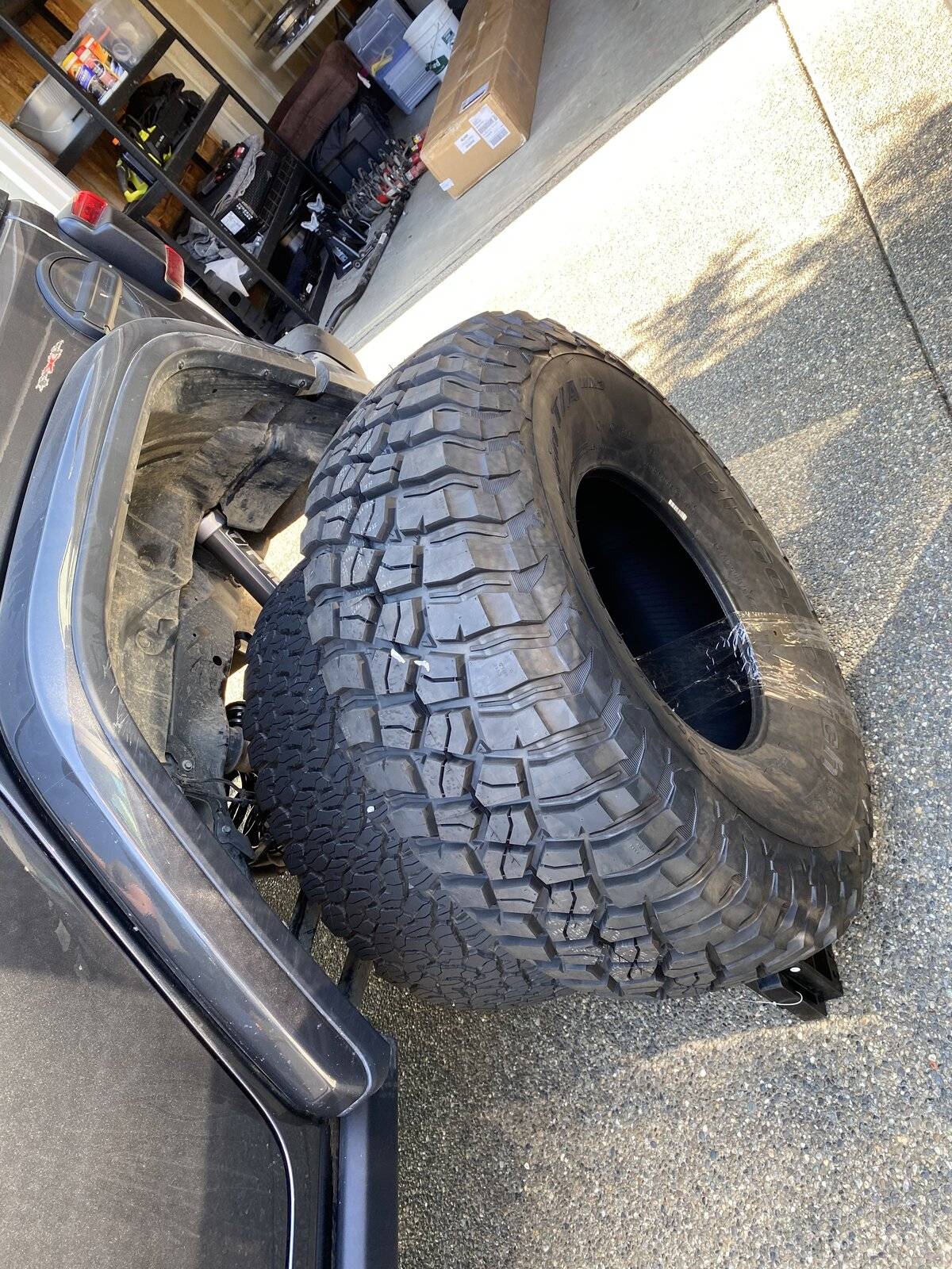

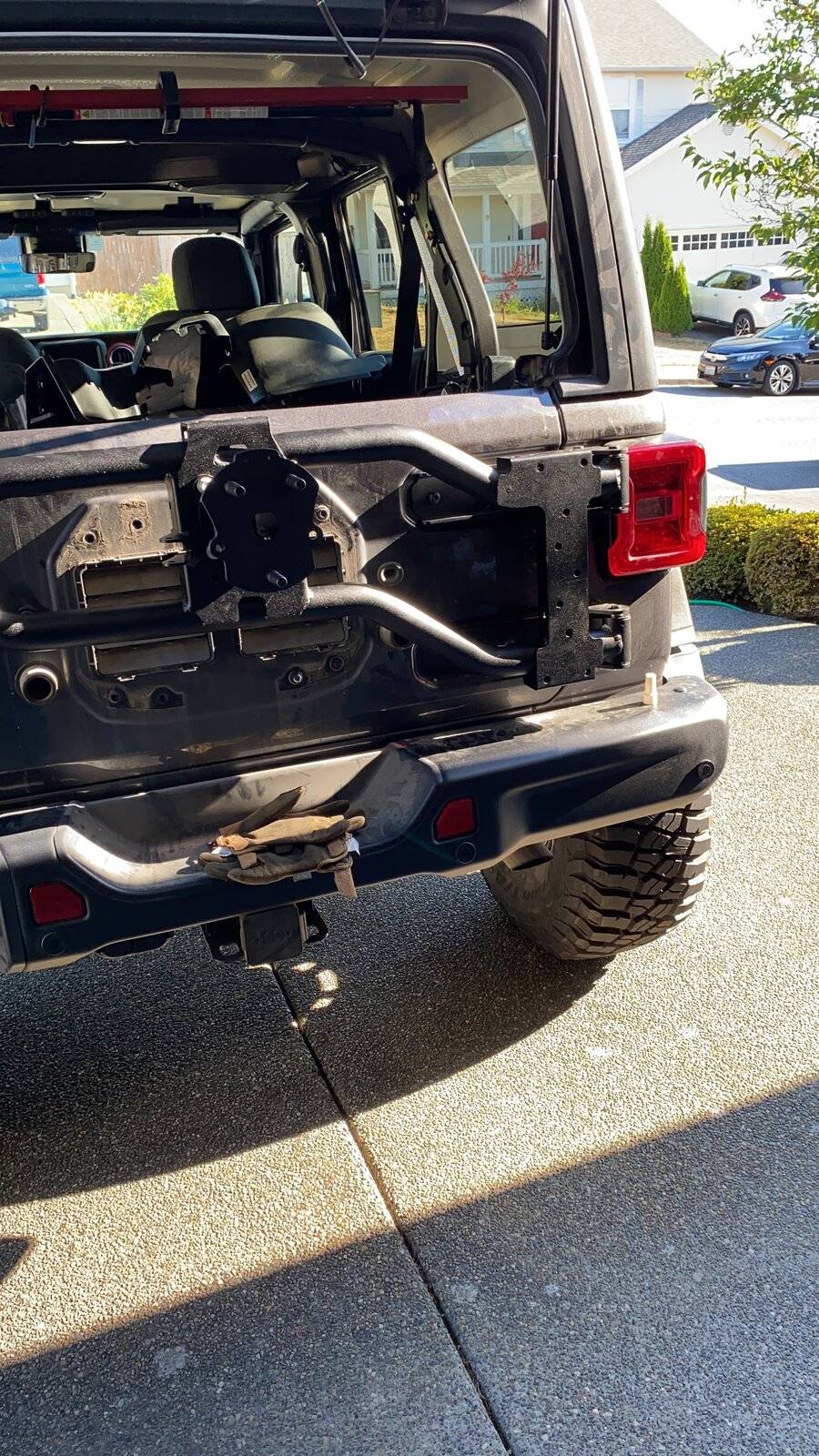

Tire carrier is on.
It is true the Maximus-3 carrier is off center when closed, but that is a function of the carrier being on a different swing axis to the tailgate. Totally worth it to me. I did have to adjust the tailgate after my first install to line up on closure. I also think I cross-threaded the top hinge, but with the reinforcement bracket I think I’m ok.
Wow, this is WAY off. I’m not sure if Jeep’s QC is the problem or MORE. I went without the insert there, I’ll probably have to jam some padding in there to stop rattles. Twin ARB is mounted though. I temporarily have an M-stud on there. I’ll measure out my lines for onboard air hookups at each rear door another day. I do have the 3/8” OD hose already and all the fittings, but I want to wheel tomorrow instead of screwing with it. Maybe Friday I’ll finish stage 2 of onboard air. I need to find someone to make brackets so I can mount the QDC fittings near the door instead of letting them flop.

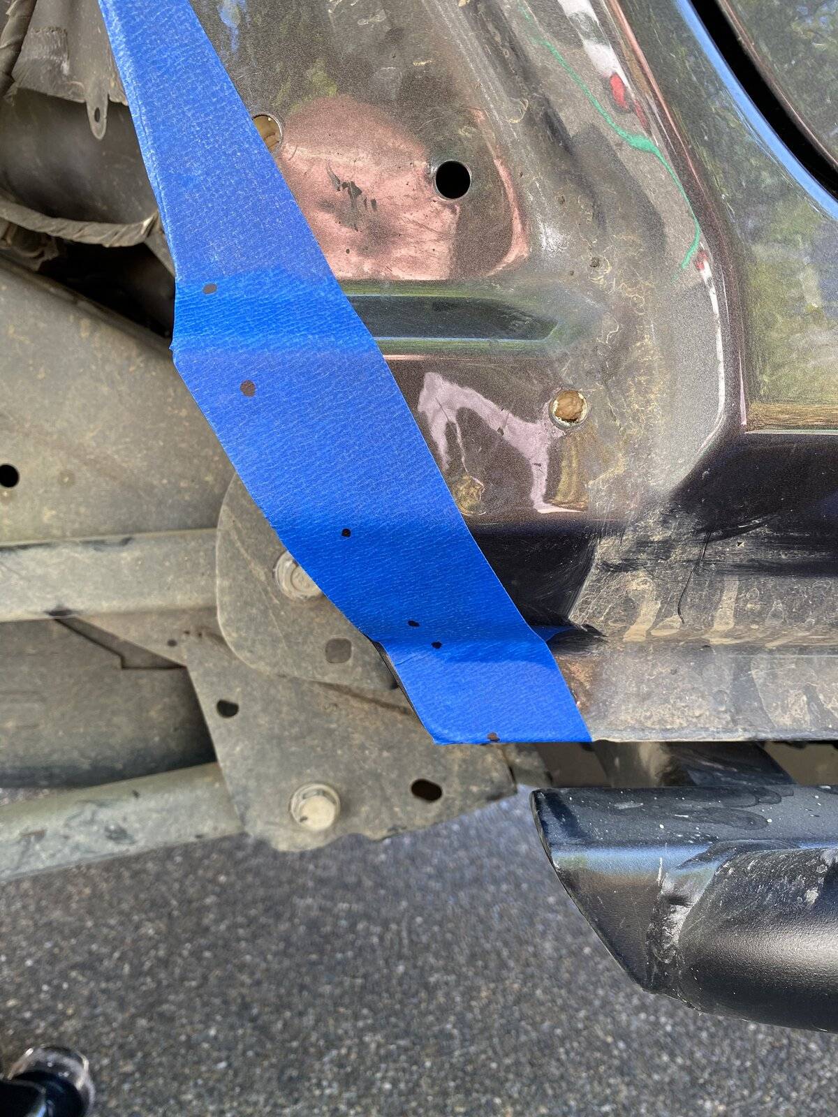

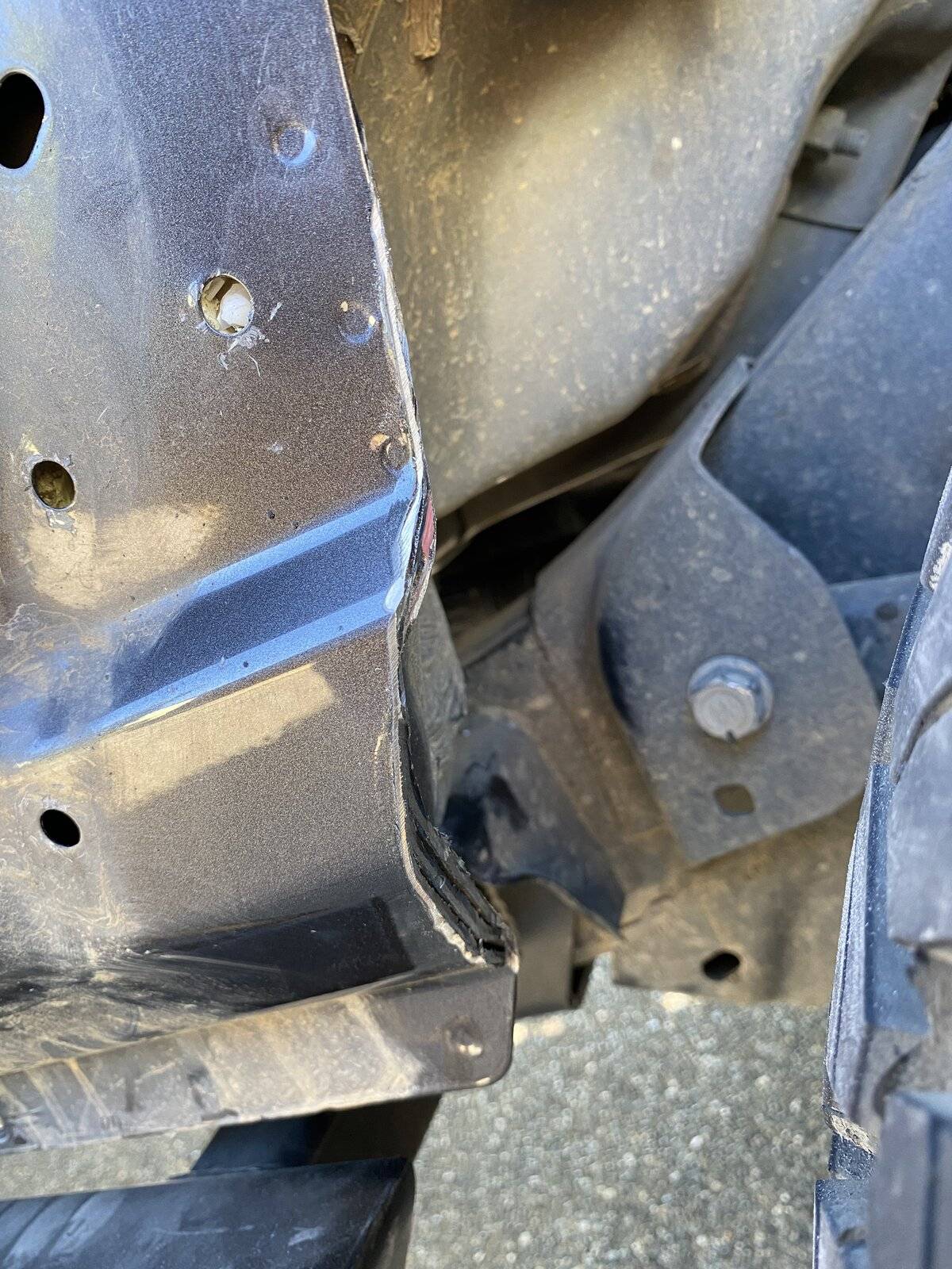

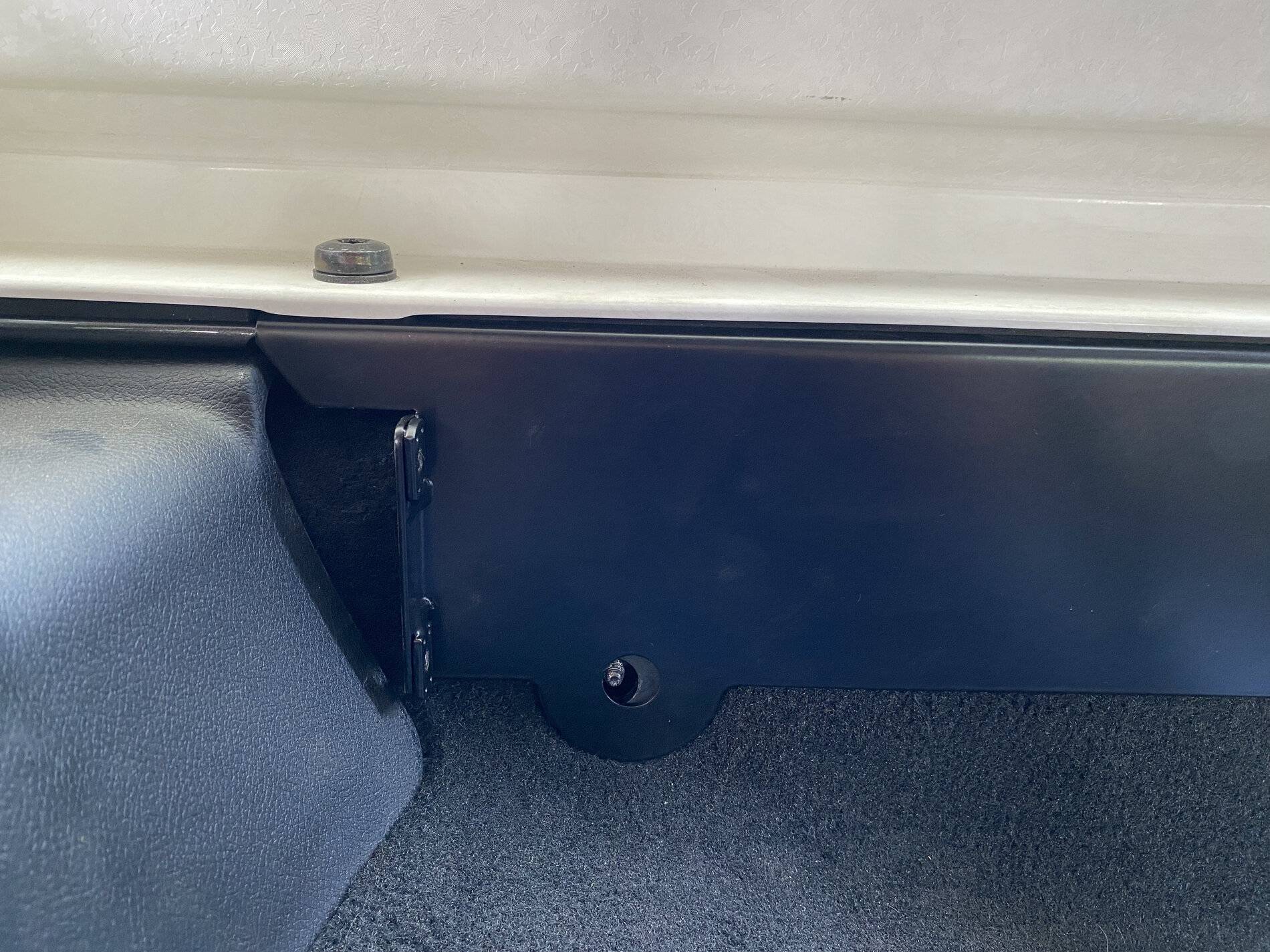

I spoke too soon. I'm rubbing in the rear. Bumpstop shims are on the way for now, but it looks like I'm going to flex it again to see my clearance on the non-rubbing side will allow me to push the axle back. Metalcloak looks like they're going to get my business for rear control arms.
The pinch seam is right behind that liner, so this is the front of the rear wheel well.
Still have room from the bumpstop. So shims for now, I'll see if I can remove some material and re-mold the liner to allow more up-travel. This is before I came down on my exhaust on the way out of Walker. Dented up that tailpipe pretty good.

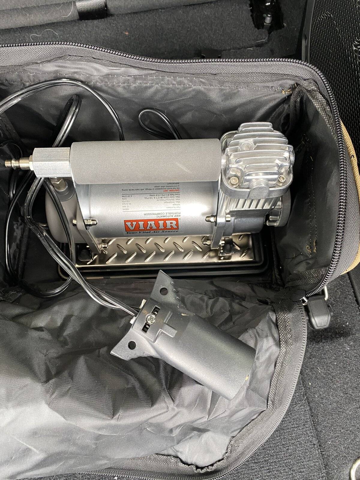

The real hero of the day for me though were these:
I made my own locking tire whips so I can level the air between tires. This was just the trial run, but I don't mind the fill time now that I just hit Aux4 and watch my gauge until they hit the PSI I want. Didn't take long with the ARB twin though! I'm waiting on a 90 degree elbow to arrive tomorrow to finish the first stage of the on-board setup. Then I'll have 4-tire inflation! Wiring is a bit amateur-ish, but it is only visible when I have the driver door open. It pops out near the lower seatbelt point and runs under my driver floormat to go out that drain. This allowed me to keep my distribution block inside the cab and out of the elements. Fuse is still off the battery lead (didn't need ARB's fuses). This is 3/8" OD air brake line, so it is rated for plenty of PSI. The whole system is rated for 200PSI+ working pressure, even though the ARB only does 150. I don't need an air tank, now that I'm not squatting over tires I don't care if it takes 2-3 minutes.

Pinch seam is cut, fenders are back on, and she’s in for regear. I think I had a ball joint fail on the way there. 4 death wobbles on a 20 minute trip. Felt like my wife’s grand cherokee when she had a ball joint go (while towing). Hopefully a re-torque buys me a few months, they don’t even have 8k miles on them. 4 tire inflation is working too. TPMS ate it again though. It still works, but chimes once per start and the light is always on.

How much trimming did you end up doing? Got pics?
Some Random Guy
Some Random Guy
Sep 16, 2020
588
793
Washington
2020 JLUR, 2018 Subaru BRZ
Comptroller
It didn’t take a lot. This is my clean cut.
This is the passenger side. The cut came out pretty bad. I drew a line inside those dots. The dots marked where the pieces of the body sheetmetal separate, so I didn’t want to get that far. If anyone does this, I actually recommend keeping the tire on to brace against.
