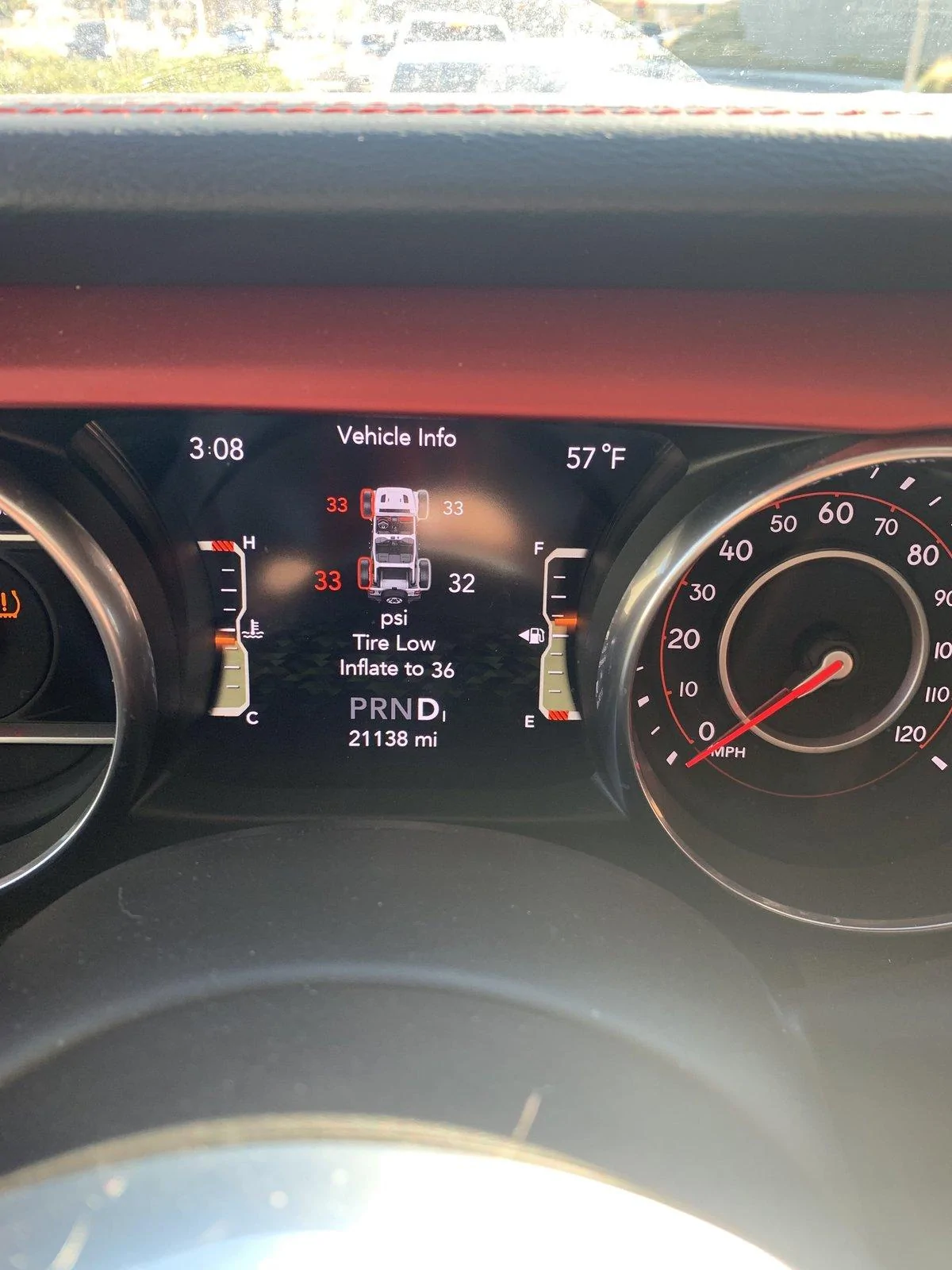

Tazeri want to disable my tpm sensor warning on my jl. What’s the best way to do that? I’m not interested in any of the other features that the tazer offers.
If you set it at 30 will get an alarm at 25, I don’t think you can go lower than 25 as it has something to do with what logic is hardwired innto the JLI used my Tazer JL Lite to lower the threshhold from 36 to 30. Tire pressure has dropped to 28 and no warning light. I'm guessing it has to drop to around 24 to trigger a warning. So far so good.
