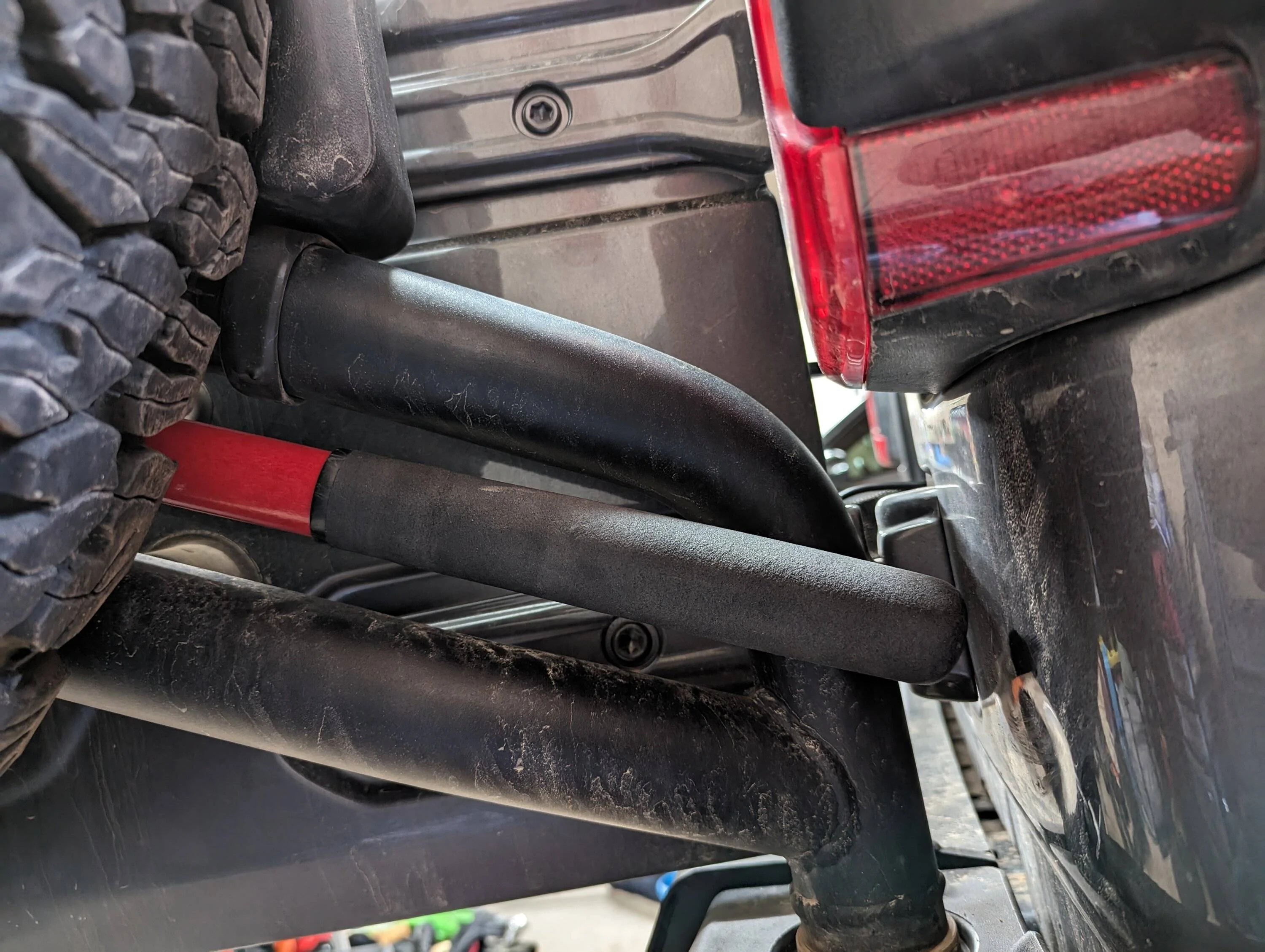

I bought a few and ended taking them all back but this one from Ace Hardware. It cost about $35 and seems like it'll last quite a while before rusting. I looked at the insanely expensive variants and their handle designs would have required too much effort to work around. And, of course, that'd be a lot of money dangling on the rear of my rig.
I cut 4.75" off the handle with a Dremel. The fiberglass is solid red (hollow center) and cut cleanly. Yeah, getting the rubber handle off and back on was a pain, but not horribly. Goo Gone works wonders on removing the glue from the labels.
I wrapped some electrical tape around it (to make it about the same thickness as the rubber handle) at the top point where it rests within the tire carrier. That should prevent any vibration as well as protect the handle.
It fits in there nicely and doesn't rattle. Yeah, you can see where my wife put a standard-sized shovel in there and the damage that it did when the tailgate got opened. Or maybe not since the Jeep is always dirty due to us living about a mile from the nearest paved road. And, of course, from taking it rock crawling quite frequently.
