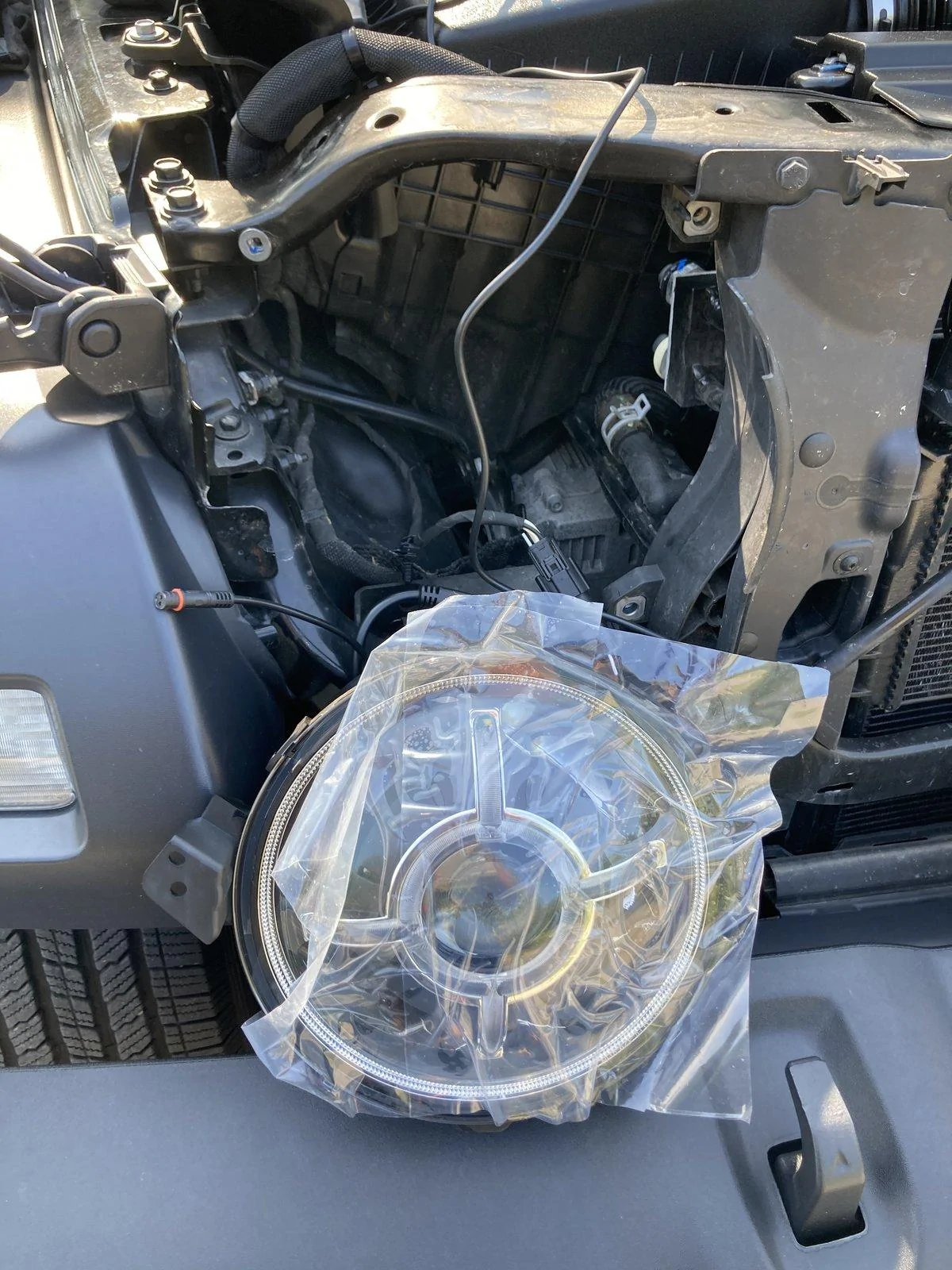

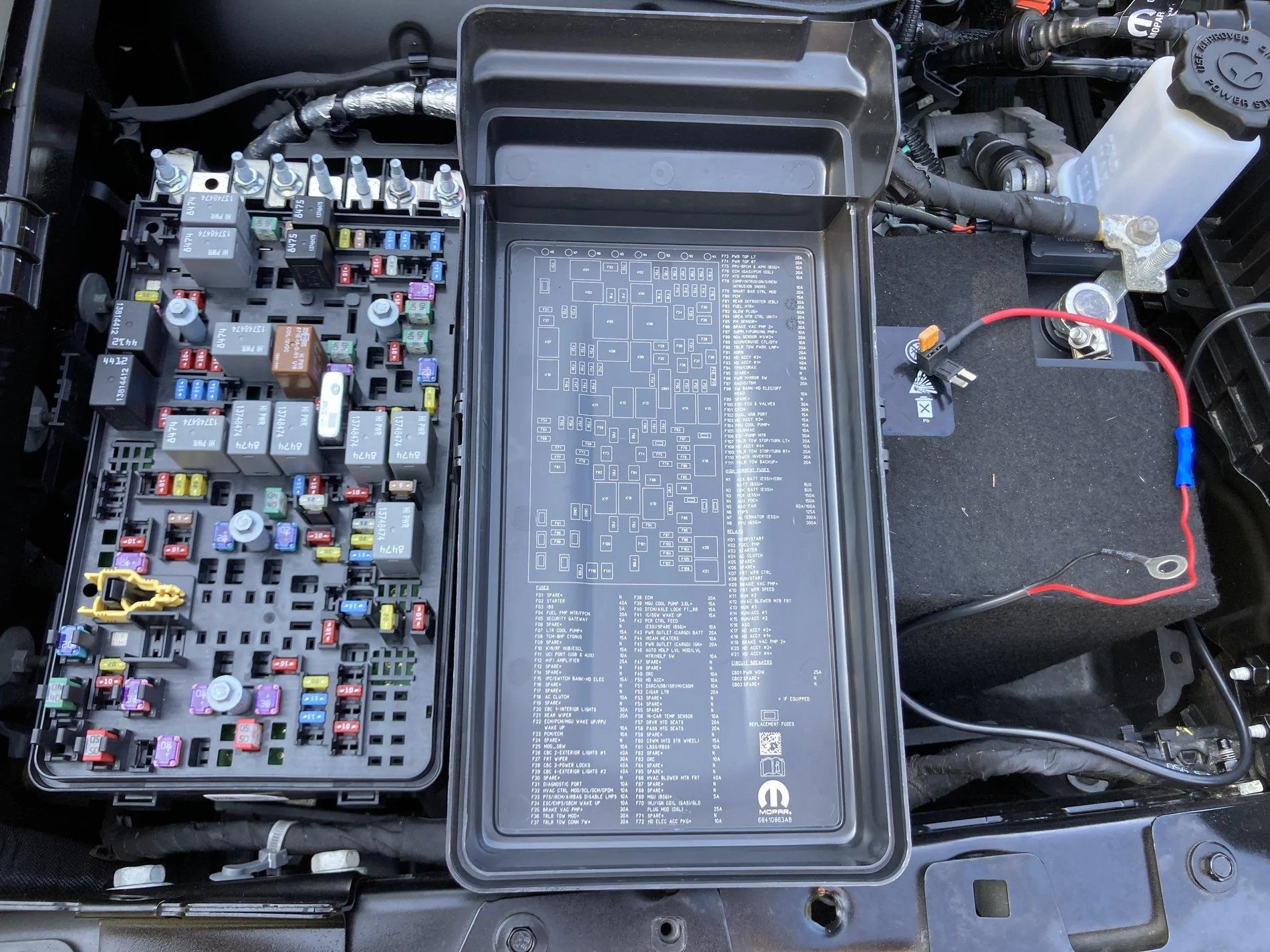

How was the halo feature to install?
In the package, you’re going to have an add a fuse kit. It plugs into the 12v outlet fuse IIRC. Or you wanna get saucy with it you can wire it into aux switches if you have them.
Takes no more than 10 minutes to get going. The kit includes everything you need. Run the fuse tap to fuse F52(Cigar Lighter) and the ground to one of the existing body grounds on the passenger side fender within the engine bay.

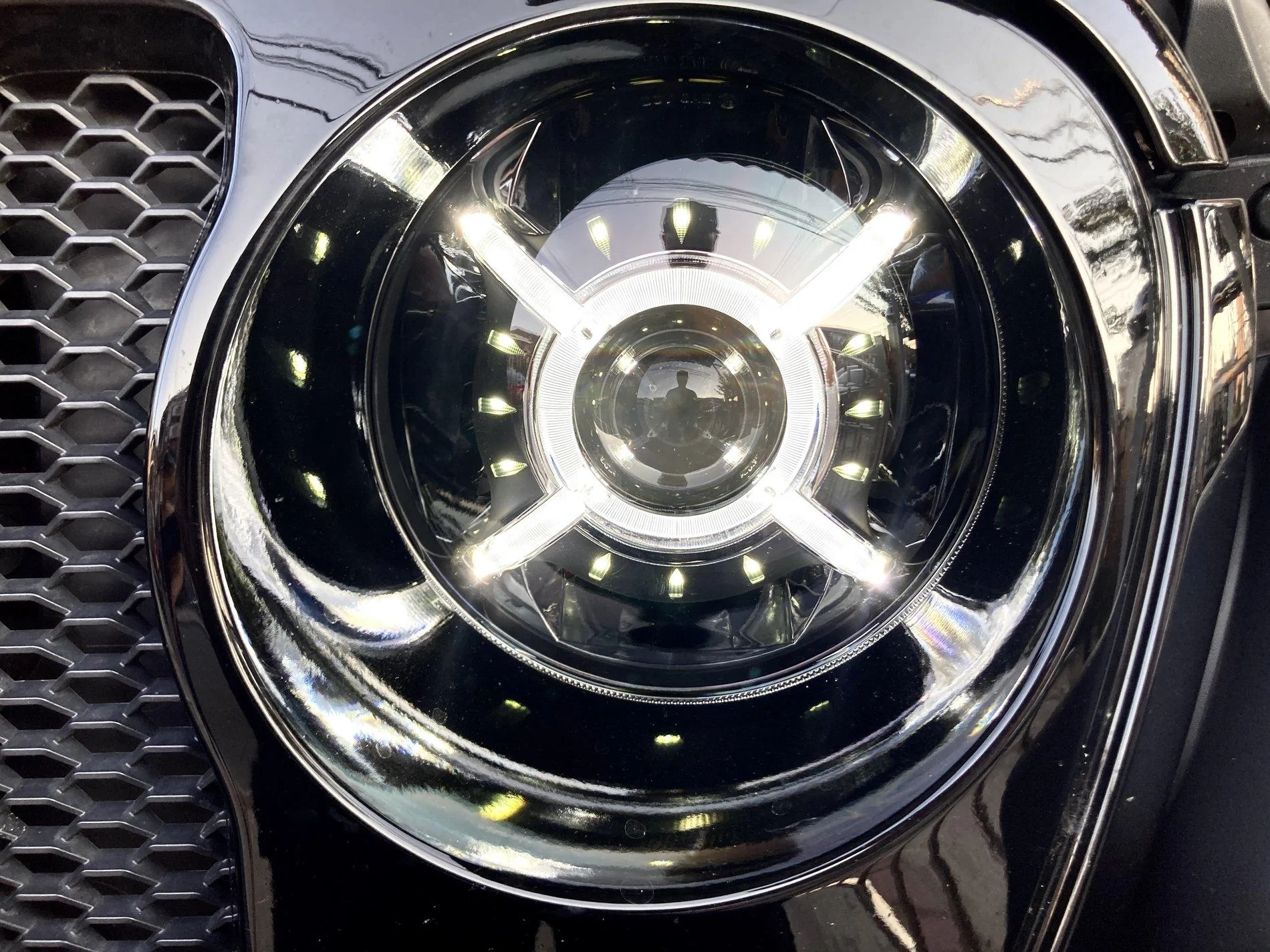

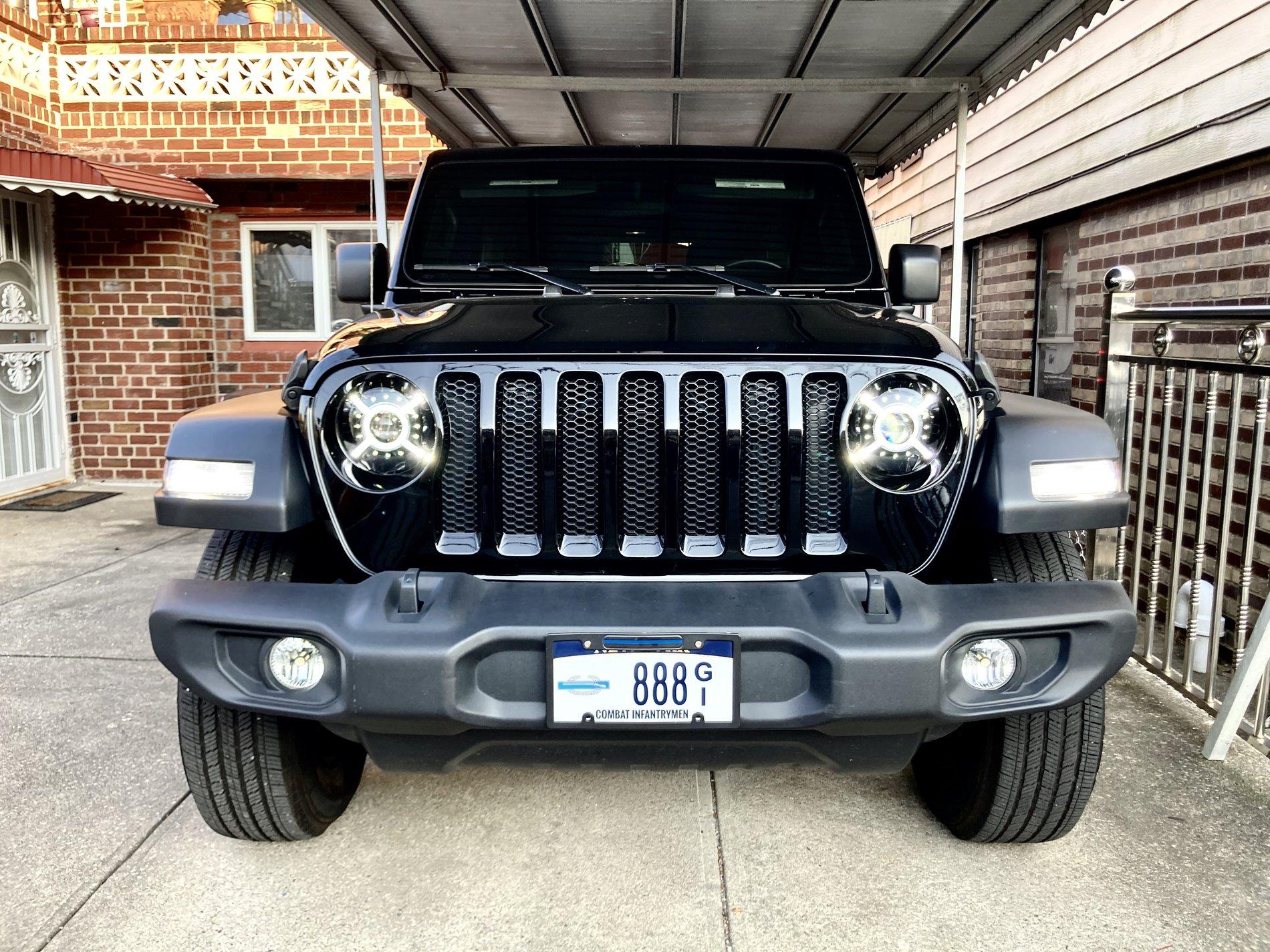

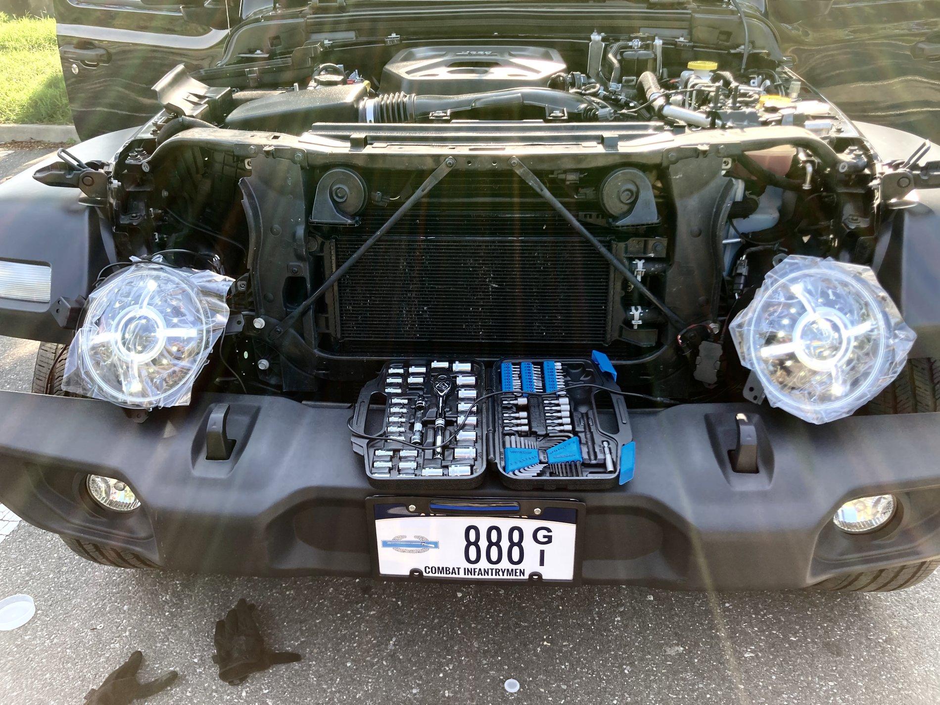

After countless hours of browsing headlight videos, eBay and Amazon I decided on these Atubeix headlights and I couldn’t be happier!
Got these on amazon last week for $399
https://amzn.to/3c0BuJZ
and just installed them today

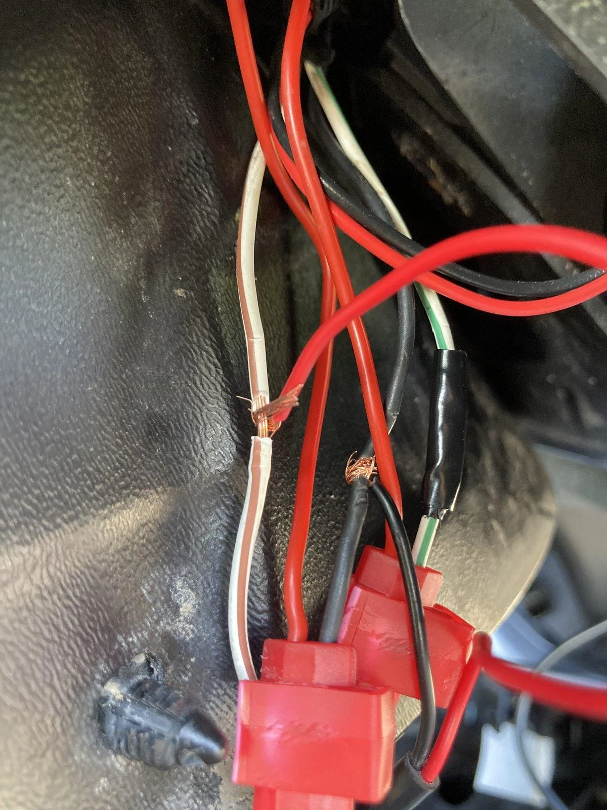

The only thing I had to do for my Sport (without led package) is just figure out where I want the X shaped DRLs to light up with. The instructions say fuse 52, but I only wanted it to turn on with parking lights and up, so i can go blackout if need be.
I found out that the big 40a fuse blocks are for the left and right parking lights so I wasn’t going to tap into that, but instead hardwired it to the passenger side parking lights (fender)
This mess was just for testing purposes. The red clips are for my switchback resistors. The brown and white wire is what you want to tap into for the parking lights. The green and white is for the amber turn signal.

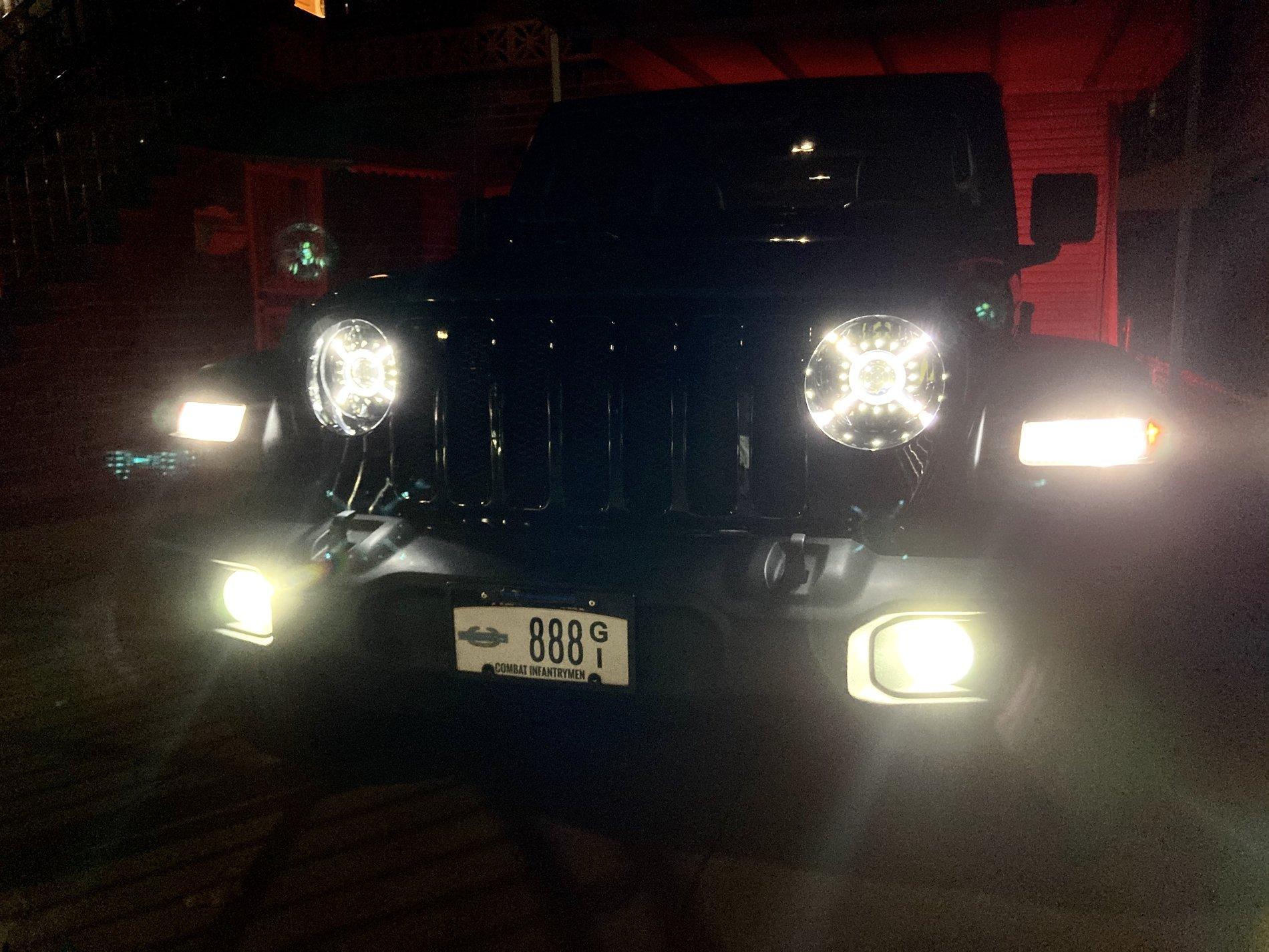

I was surprised at how incredibly detailed this design looked. Haven’t seen anyone else with this which makes them feel very unique.
I’ll try to get some better night shots, but the cutoff is incredibly sharp. The entire headlight almost looks too bright at how WHITE the lights look. Either way I’m in love and can’t wait to do some night driving!
I am loving driving with just the drls/parking lights on. That X is so seXy!

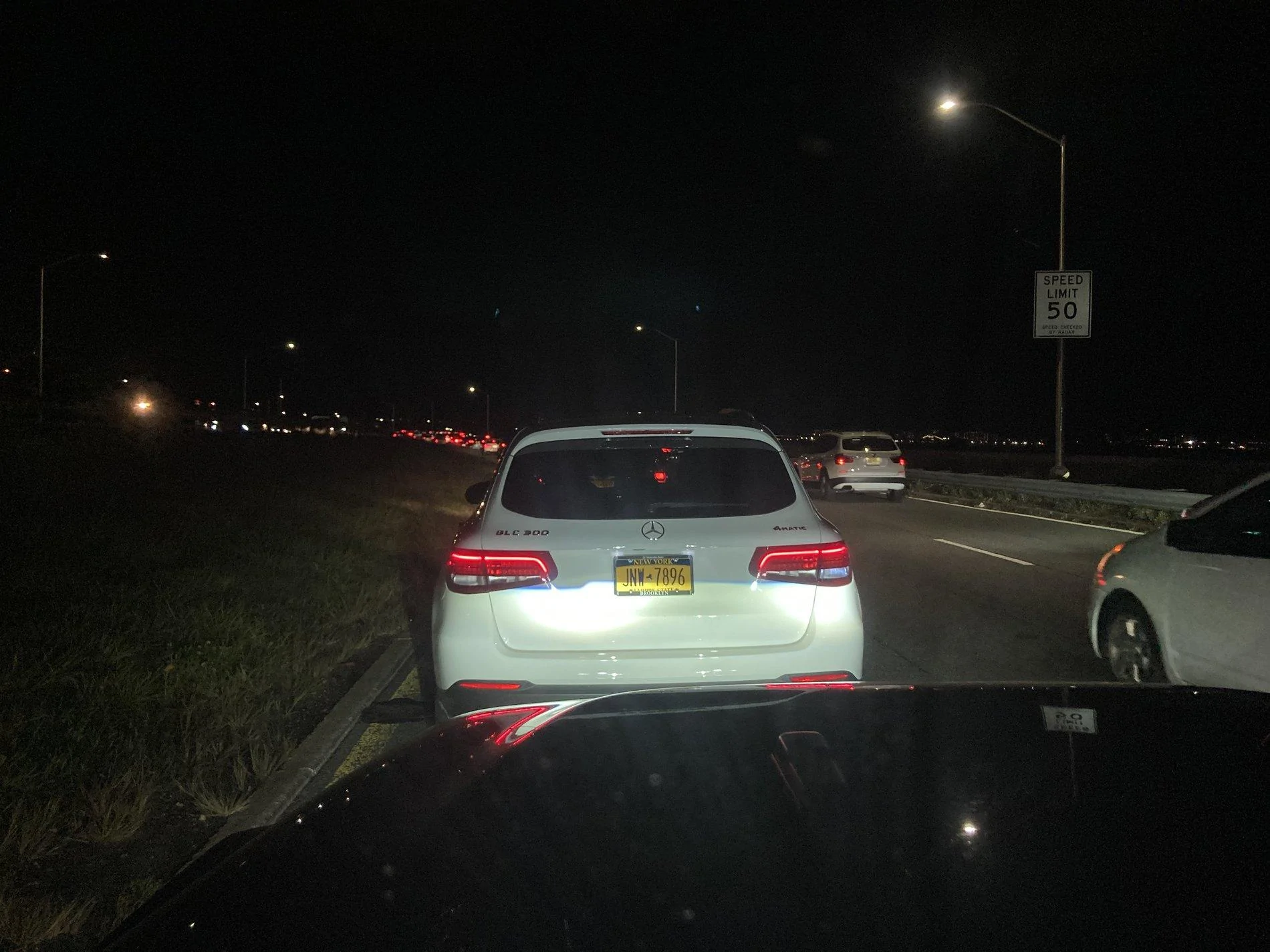

Cutoff is so sharp and bright. I feel like I never see or notice any other cars with cutoffs. Shouldn’t be that uncommon. It’s 2020. I’m always amazed at mine though
I can't express how sharp this cutoff is in person

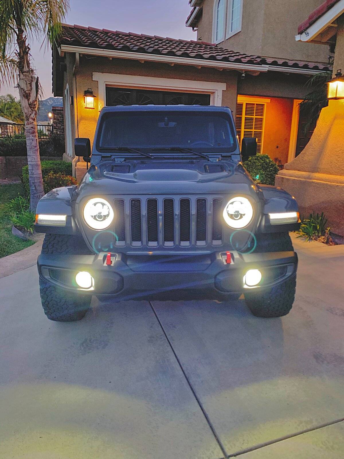

I couldn't be happier with my front end LED conversion
KiwiMaster 9" Halo headlights $227
Used OEM fender lights $150
Alla Lighting LED fog light bulbs $17
Bunker Indust LED smoked clear corners $36
