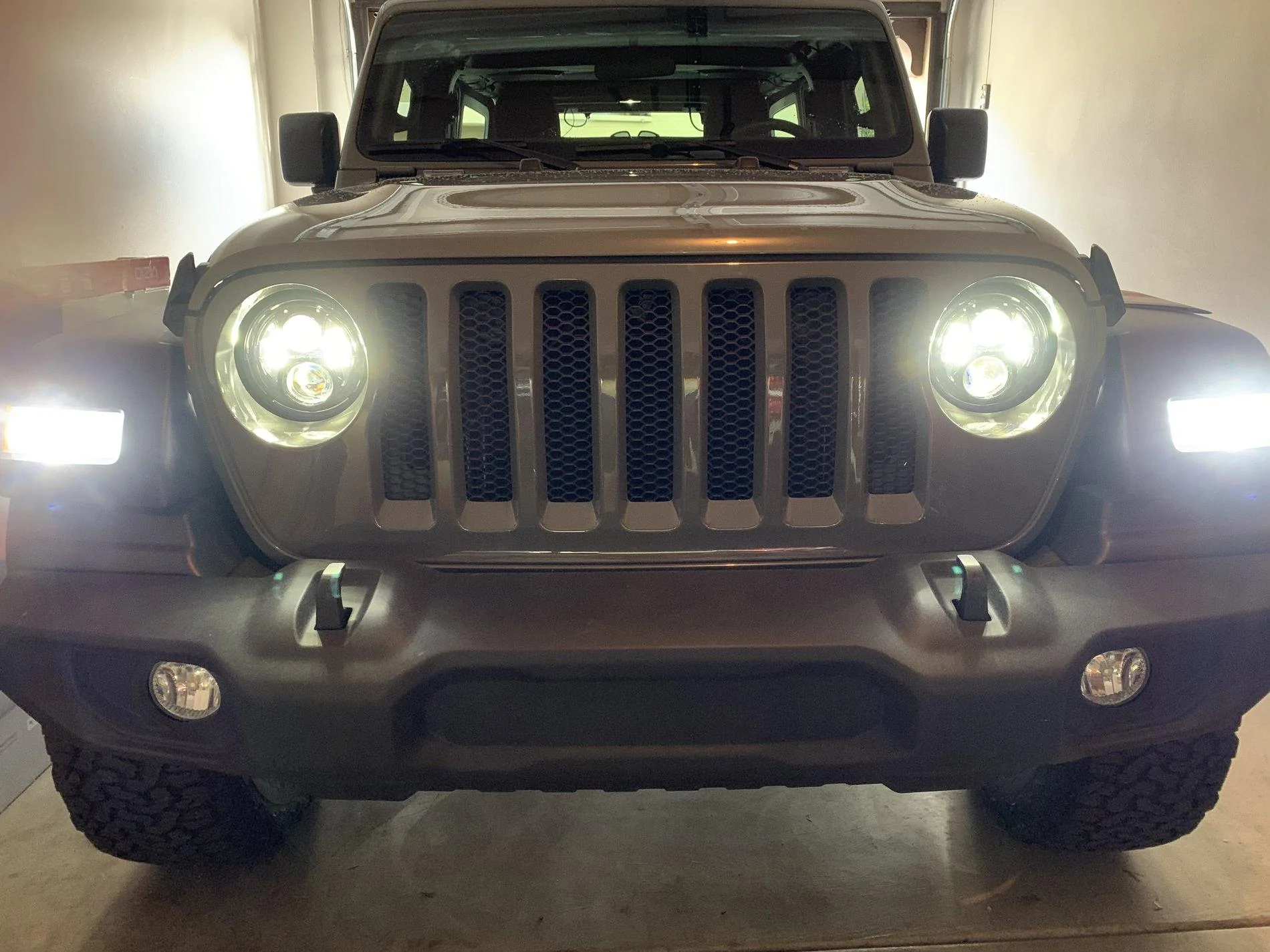

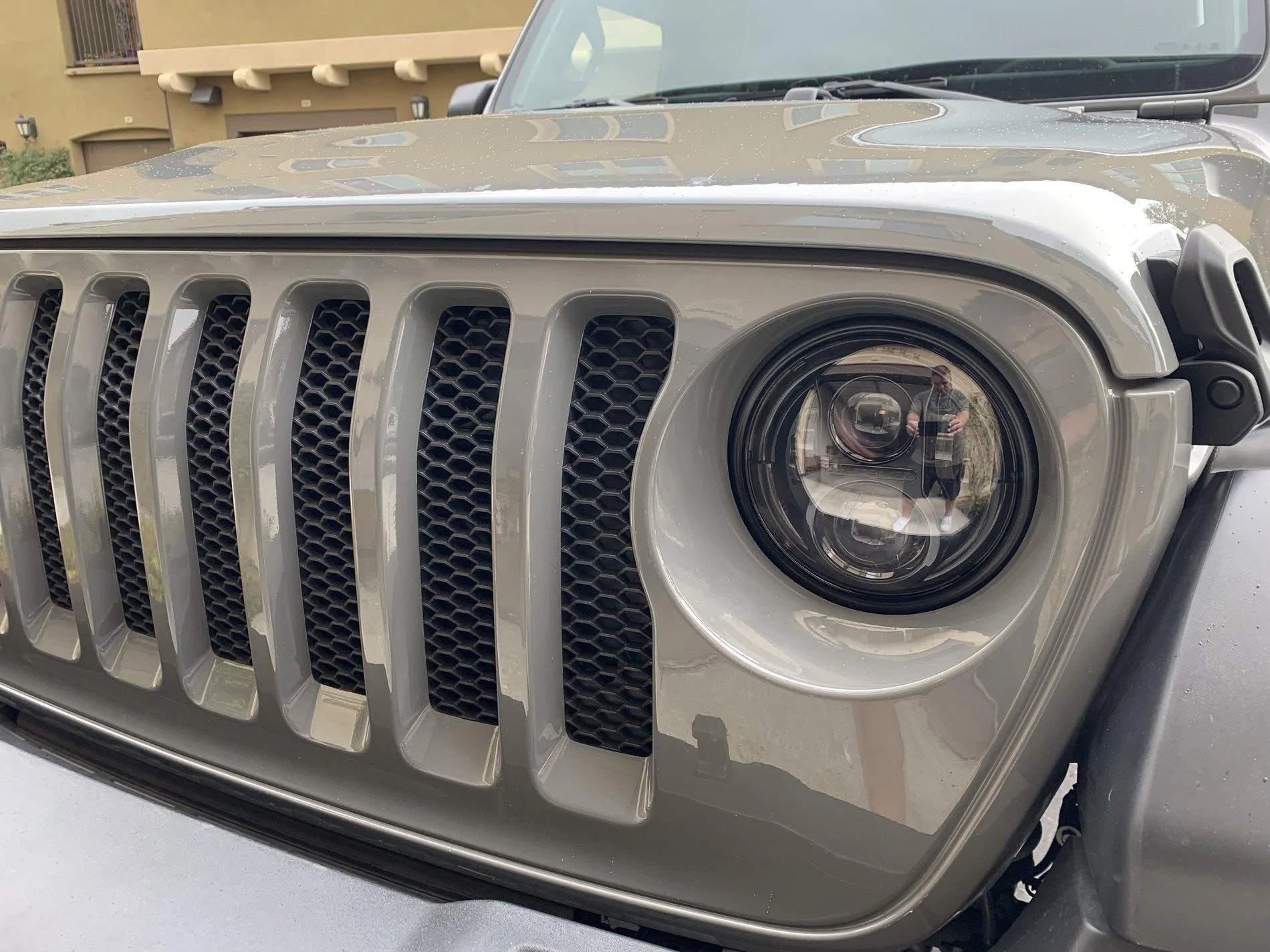

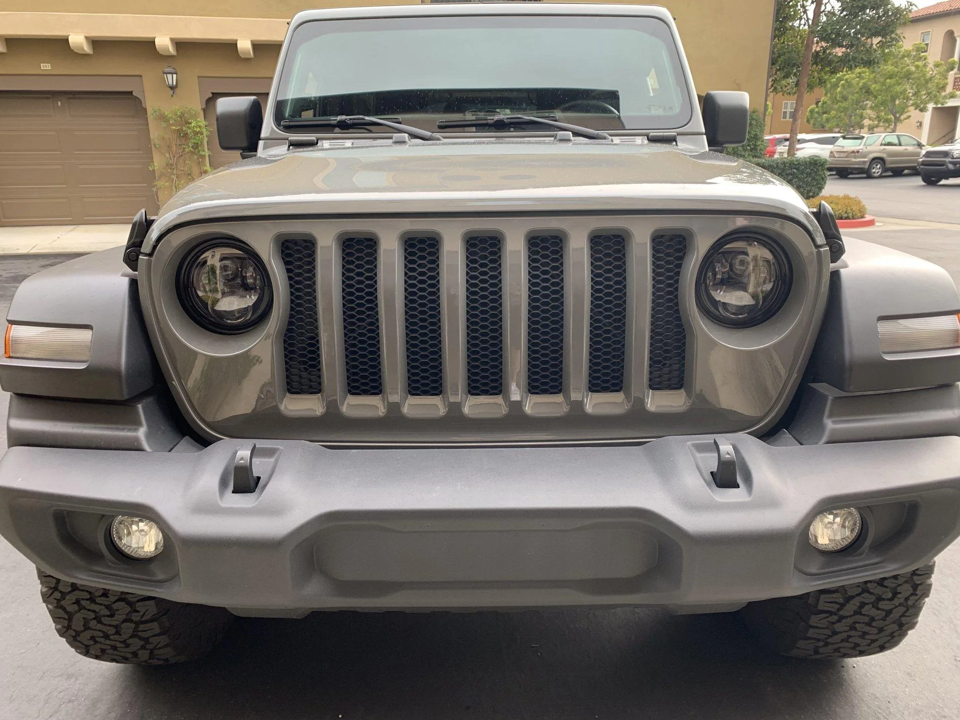

I dont have pics of the install itself if thats what youre looking for. Here pics installed tho.
The lights arent as yellow as the pic shows but I believe they are 5000k, not 6000k. They still need to be adjusted as well..
